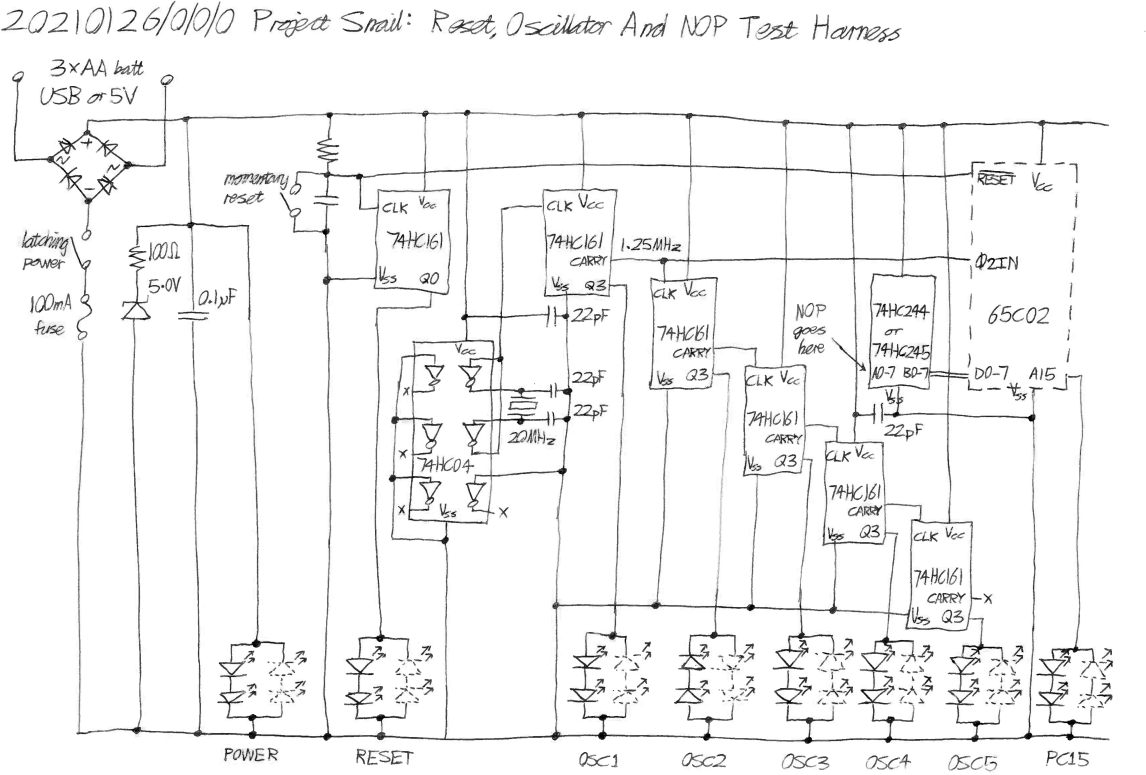

After two days of breadboarding, I had an LED blinking at slightly less than 1Hz. (16MHz divided by 2^24.) I had also made about 22 idiot-proofed indicator lights, two boards of binary counters. At one point, I had 19 logic chips and 14 sets of indicator lights running with 22pF of decoupling. However, this strains the battery and the lights noticeably dip in unison. That was a good place to pause.
The following day, I removed most of the counter chips from the breadboard and allocated the space for a W65C02. People buying bootleg 6502s are missing the experience of unpacking the genu-wine article. It does not have the gaudy in-your-face branding of Intel but the packaging has an understated class which is rarely mentioned on the 6502 forum.
The following description is not a good example of the art. The following is a "don't touch it - it's doing something" example of the art. My first attempt at getting NOPs was to wire power and ground. I then wired various control signals directly to power. (I know this is definitely wrong but, sometimes, it helps to actually do it wrong and confirm it for yourself. The alternative is to live on superstition and rumor.) I set opcode $69 (ADC#) rather than the standard $EA (NOP) due to the dead cycle which causes NOPping to progress through address-space at half the expected speed. I placed indicator lights on high address lines and powered up. Unfortunately, nothing worked. In particular, my debug boards, constructed a mere day before, both appeared to stop working. There was working power. There was a working oscillator. The first eight bits of the chain of binary counters worked. However, nothing beyond that appeared to work. Well, that's unlikely and that part of the reason why I made multiple debug boards.
I quickly resolved the first problem. I had inadvertently made a chain of eight 4 bit counters. 16Mhz divided by 2^32 will tick very slowly and superficially appears not to work. Placing the 2^24 divider further upstream restored the slightly slower than 1Hz blink of an indicator light. However, I did not obtain a matching blink from the 2^8 division of two counter chips followed by the 2^16 division of a 6502 program counter. At this point, I thought that maybe all that stuff about pull-up resistors might be relevant. After searching through my meager spares I found a 10k resistor. Just one. This led to an idea which should definitely make the experts wince. I connected the control lines on the left side (NMI, IRQ, RDY) via one common pull-up resistor. As I was moving the reset wire on the live circuit, it started working! I initially thought that it was due to mains hum and it only worked when my fingers provided capacitance.
The current configuration (which should not be replicated) has RES, NMI, IRQ and RDY all tied high via one common resistor. BE and SO are tied directly to power. There is no reset circuit. The oscillator is intermittent. I know this is terrible but it is steadily improving. It is also apparent that a lack of components is the limiting factor. Regardless, the current configuration has been sufficient to confirm that $69 (ADC#) cycles through the address-space and double speed compared to $EA (NOP) because the immediate instruction doesn't have a dead cycle.
Obviously, the circuit requires an oscillator module and a reset module. For reset, I purchased a Maxim MCP101, as used in the Gigatron design. Perhaps I should have purchased a Dallas Semiconductors DS1813, although given the heritage of Dallas and Maxim, they are possibly the same thing.
I also require a simple mechanism to get more than 8 bits of program into the system. Therefore, I am concurrently pursuing a computer with no ROM and a computer with no RAM. I intend to keep a NOP opcode behind a 74HC245 or similar. In addition to providing debug, it is also a hook for NOP slide video generation. This can be used concurrently with a hook in the binary counter debug board which can be used for clock stretching.
I enclose a draft circuit diagram which differs significantly from implementation and neither are good examples. I usually publish more formal diagrams but I've been too busy implementing. I hope that a doodle in the style of Forrest Mims, Garth Wilson and Donald Alcock is sufficient.

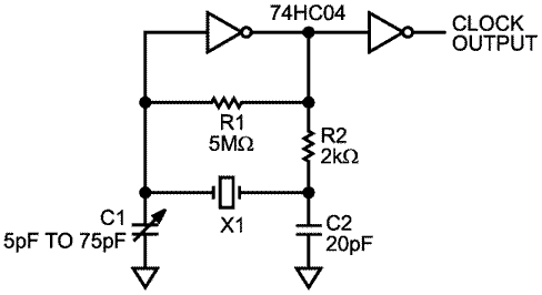

Here is a suggestion - you're using a 7404, a crystal and 2 capacitors to make the oscillator... It's good, "classic" and seems to work for you. I decided that I'd opt for a can oscillator from day 1. One DIP-8 sized chip. Might be more expensive (marginally), but it's one less thing to worry about.
You get bonus points for the fuse too.
Posts: 3526
Re: Project Snail: 65C02 Crawling At 62.5kHz

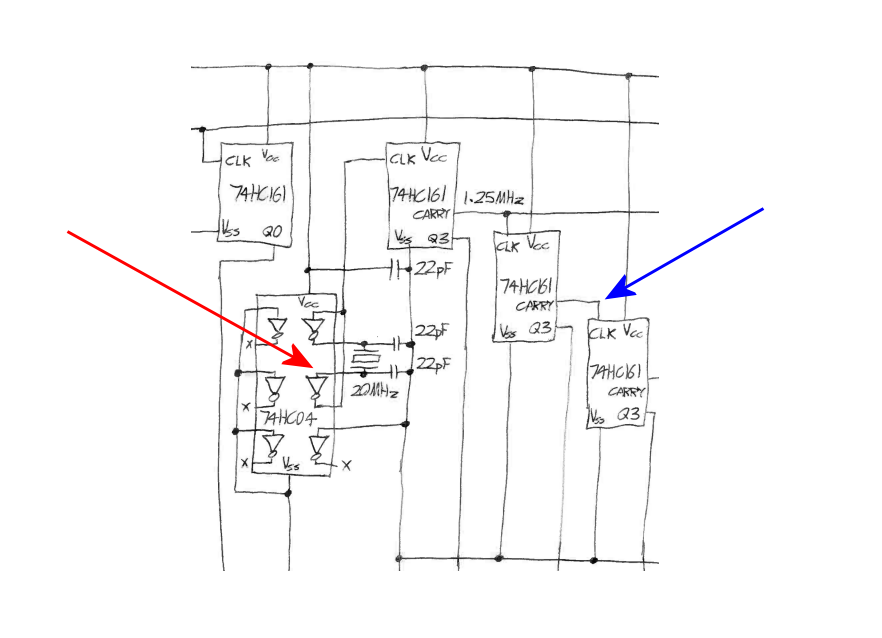

In your oscillator there's one inverter whose input is floating in terms of DC. This could easily explain the intermittent operation. The crystal does not provide a DC path. There needs to be a high-value resistor to supply input bias for a case like this.
You could try putting a large ( >= 1 MOhm) resistor from the inverter output to its input. This will cause the DC voltage to settle around 50% of Vcc, which is the linear region of the input stage. Ordinarily you'd *avoid* letting an input hover around 50%, but it's an unusual situation because the inverter is being used as a linear amplifier -- not the 'HC04's usual function!
Or, reconfigure the oscillator according to the second attachment (below). Also attached: a 74HCU04 datasheet; this chip is particularly relevant to linear operation, including oscillators. A web search with the terms 74HCU04 and oscillator will surely reveal more detailed info.
BTW, the manner in which you've cascaded the counters isn't entirely appropriate. That's because when the counter increments its Carry output may glitch briefly before assuming a valid state. Check the datasheet to see the proper technique. Carry ought to feed the next stage's Enable input (not Clock). Cheers,

Firstly, don't trust anything you read on the Intertubes. I have moderate difficulty with physical constants and arithmetic (most often in more familiar decimal). Adjust your expectations accordingly.
Secondly, thank you for help, especially to GARTHWILSON, Dr Jefyll and, less obviously, BigEd who makes a convincing argument to pursue hardware bug fixing as a distinct practice to software bug fixing. I remain astounded that I was one resistor short of a reliable circuit. I might have solved this eventually by following circuit diagrams more closely. Thank you for saving me from moderate frustration.
I have subsequently devised an unconventional oscillator arrangement, surveyed seven of the dodgiest NMOS 6502 suppliers which I could find on aliexpress (my favorite being the IC chip quality+++ Store selling the obviously legitimate and trustworthy 1pcs Mos 6502 MOS6502 6502AD R65C02AP MOS-6502 DIP-40 Can be purchased directly) and wrote assembly while waiting for components to arrive.

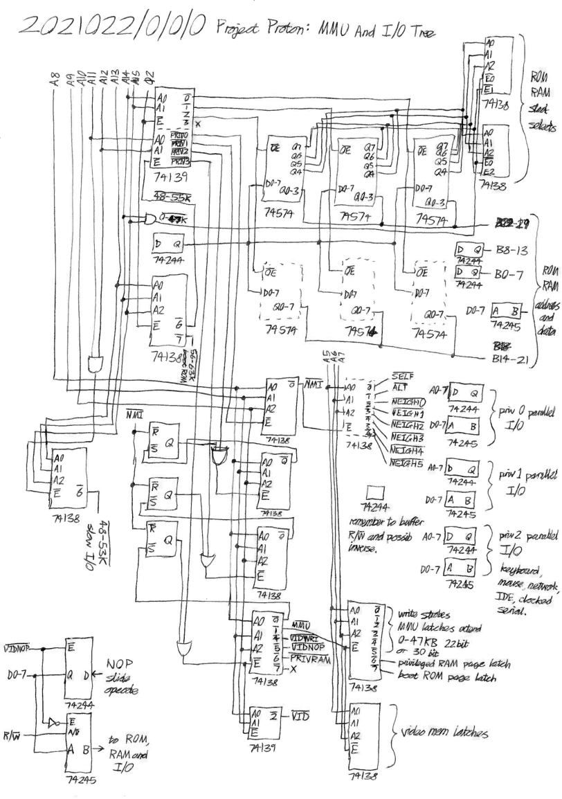

Project Snail is where this stream of ideas is assembled. I am most influenced by the memory maps of Apple, Commodore, Acorn, the Commander X16 project and W65C265. Initially, I hoped to implement a 3*16KB bank window scheme which extended beyond 16MB RAM, was 6502/65816 compatible while also simplifying application ports from the majority of legacy systems. Furthermore, early drafts of Project Snail (doodled in OpenOffice Draw) have chip stacked latches. However, I was disheartened that I was wilfully mis-quoted in this matter and I considered other pursuits permanently.

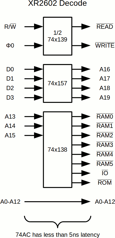

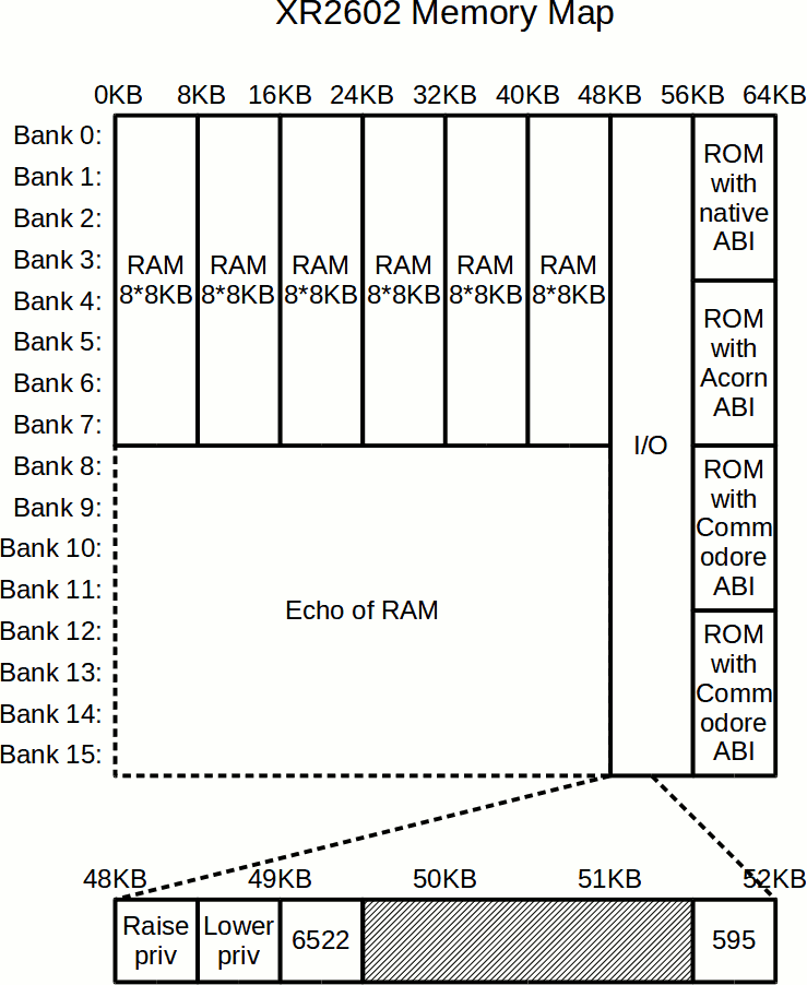

By relaxing pre-65816 hardware compatibility, I found that a 48KB RAM, 8KB I/O, 8KB ROM design may extend across all 65816 64KB banks in an unconventional manner while retaining very good compatibility with legacy software. This arrangement is smaller, cheaper and significantly faster the bank window design. In particular, multiplexed address latching, 8KB segment decode and read/write qualification are fully decomposed and run independently with (optimistically) 15ns latency using one 74HC157, one 74HC138 and one 74HC139. The memory map is as follows:-
$xx0000-$xx1FFF: RAM.
$xx2000-$xx3FFF: Optional RAM or I/O.
$xx4000-$xx5FFF: Optional RAM or I/O.
$xx6000-$xx7FFF: Optional RAM or I/O.
$xx8000-$xx9FFF: Optional RAM or I/O.
$xxA000-$xxBFFF: Optional RAM or I/O.
$xxC000-$xxDFFF: I/O.
$xxE000-$xxFFFF: ROM.
I hope you can appreciate how this simultaneously approximates a Commodore VIC20 with optional RAM packs, an Apple II (16KB or 48KB), an Acorn BBC Micro (16KB or 32KB) with banked ROM, a Commander X16 and W65C265 (with I/O on $00DFxx) while allowing considerable flexibility for niche applications. Indeed, in addition to wanting a secure, neo-retro desktop computer which is capable of circuit design, I also want a portable text to speech system. With systems such as the Toynamics Timio (the modern equivalent of Speak 'n' Spell), or suggestions that a handputer may also be a vehicle computer or desktop computer, I do not see these requirements as contradictory. There are limits on power envelope, form factor and expansion but they are reasonable.

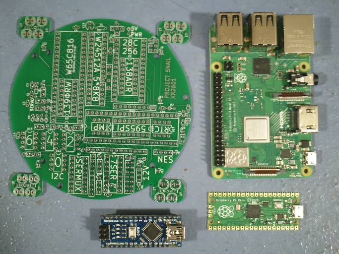

I've been studying Raspberry Pi variants in detail. The Broadcom ARM VideoCore chips have some original thinking, including the ability to set I/O pin function in octal. Chuck Peddle pioneered Data Direction Registers and this was a very good idea. However, modern systems make a mess of this idea to the extent that pins may have five unrelated functions in addition to integrated pull-up or pull-down resistors. This may be configured in three or more subsystems. When someone gets back to simplicity, I look in more detail. Apart from digital I/O pins which are primarily to control a DRM DVD tray, the Broadcom VideoCore chips are exclusively serial. They boot from single channel, clocked serial MicroSD. They have digital serial video output. Early models have serial Ethernet connected via serial USB and later models have multiple switchable USB/PCIe interfaces. Even the audio is serial and has parameters to align audio cells with serial DACs. Perhaps someone should make a 6502 system with a few digital pins and every possible serial protocol.
There is a natural affinity with 6502 and ARM given that ARM was an outgrowth of Acorn. I believe that a 6502 and/or 65816 system with serial interfaces would be a natural compliment to ARM systems, such as Raspberry Pi. Although such as system would be less powerful with, for example, 2% of the processing power and 1% of the serial bus bandwidth, there are advantages. For example, deterministic clock cycle counts and DIP scale integration. In particular, low scale of integration of processor, ROM, RAM and I/O is an advantage because each may be scaled separately. It also meets the requirements of Right to Repair. When a RISC SoC fails, you may get adventurous and replace the chip. However, it is more likely to be ground to dust and heated to extract gold and suchlike. More commonly, it is just sent to landfill. While I'd like to exclusively exceed the official ratings of a 14MHz 65816, I remain open to substitution of scrap parts. Specifically, this requires a subset of functionality to work with a crufty NMOS 6502 of dubious provenance. Anyhow, one design may cover a continuum from 1MHz 6502 to 30MHz 65816 and this forms part of a larger continuum.

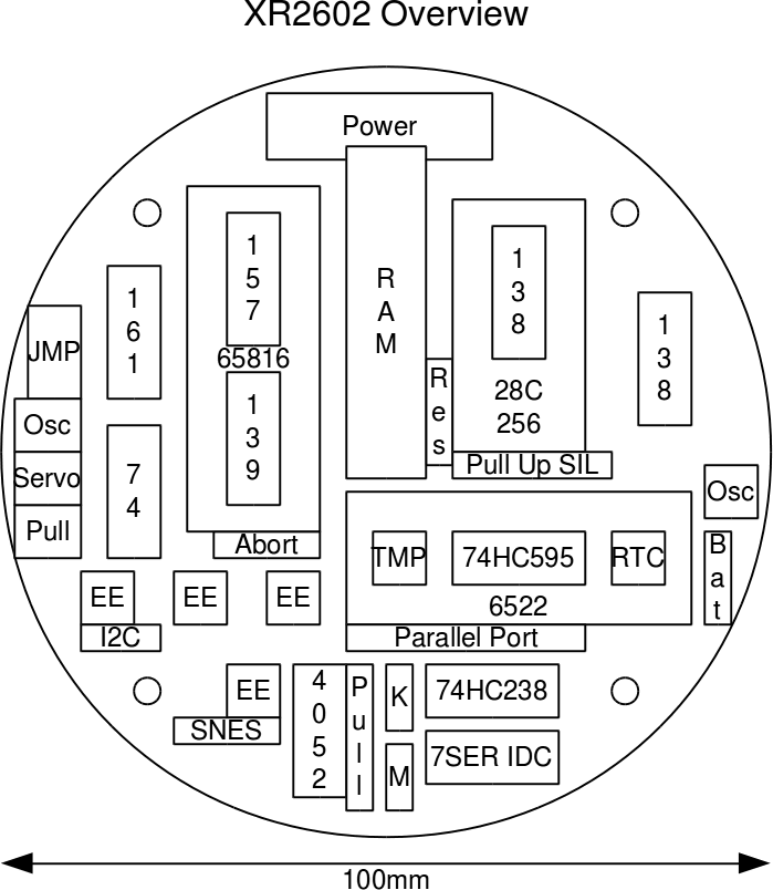

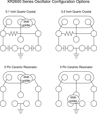

The system clock may be configured to work with a two pin ceramic resonator, three pin ceramic resonator, 0.1 inch quartz crystal, 0.2 inch quartz crystal or external clock input. One half of the TUIT100 board has DIP processor (inverted so the address and data lines tally), chip stacked USD0.50 skinny DIP RAM (which scales from 8KB to 384KB) and 28C256 EEPROM or similar. The other half of the board uses an arrangement of 6522, 74HC595 serial to parallel shift register, 4052 four channel stereo analog switch (SERMUX) and 74HC238. This is used to implement PS/2 keyboard, PS/2 mouse, SPI (covering MicroSD and SNES input peripheral protocol) and I2C. This arrangement requires approximately four square inches of board. I hope that it is possible to auto-configure between PS/2 and I2C. This would allow the two PS/2 channels to be re-purposed as I2C channels without requiring, for example, battery back-up configuration to be held in the optional I2C clock on the primary I2C channel.
6522 PortA is connected to the reversible, 14 pin parallel port (CA1, GND, PWR, PA0-PA7, PWR, GND, CA2). This may be connected to a XR2800 Series EEPROM programmer, KIM-1 style interface configuration or sburrow's preferred configuration for text LCD output. The yet another 65SIB variant, 7SER, uses a 2*8 pin reversible connector with active high select signals to simplify downstream termination when select signals are exhausted. 7SER devices should Buck convert 12VDC power with either polarity and should ideally be 50VAC tolerant from 33Hz to 400Hz. 7SER devices should use 5V data signals. Firmware may support stacked 74HC238 chips. This allows two or more sets of seven channels. 6522 PortB should be set to range 0-63 for 7SER, 64 for primary I2C, 128 for PS/2 keyboard or secondary I2C, 192 for PS/2 mouse or tertiary I2C. 6522 PortB should be set to 0-13 for 7SER bundle zero, 16-29 for 7SER bundle one, 32-45 for 7SER bundle two (minimal configuration) and 48-61 for 7SER bundle three. 6522 PortB should be set to 46-47 to read SNES input peripherals (minimal configuration). The SNES peripheral extension defines daisy-chaining and covers SP/DIF tunneling and virtual reality (which has a long association with 6502). I could have arranged the decode signals such that MicroSD channel numbers matched Commodore floppy drive numbers. However, CBM had a love/hate relationship with IBM. I suspect that Commodore channel numbers were copied from IBM OS/360 octal channel ranges. I understand that 0-7 was for paper tape, punch card, admin teletype, printer and plotter. 8-15 was for primary storage. 32-63 was for other uses, such as user terminals and WAN. However, I've already got the anachronism of PS/2 keyboard and mouse. I'm not adding octal mainframe channel numbers.

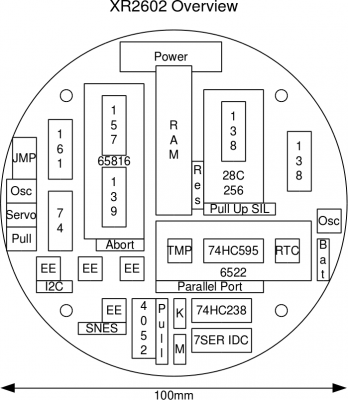

The simplified XR2601 omits clock stretching, address latching and a second tier of (optionally chip stacked) 74HC138 address decode. Jumpers select one 4*8KB bank from one 28C256. Each board may hold up to 4 megabits (512KB) of I2C serial ROM. The vaporware decompressor and cache allows binaries to exceed 64KB while minimizing decompression overhead. The four serial ROM sockets are copied from 6502GPD, although, in limited space, I failed to copy the beautiful, physical symmetry of this design. Nor did I follow horizontal/vertical discipline and the 432 pad design required 18 vias. The 525 pad XR2602 reduced this to 10 vias. The forthcoming XR2603 may reduce this further. A digital thermometer may be located centrally. Unfortunately, the typical LM75 I2C variants are intended to work over a large temperature range and I presume they are not available in DIP because this reduces problems with thermal expansion. Therefore, fitting any variant LM75 will require an adapter.

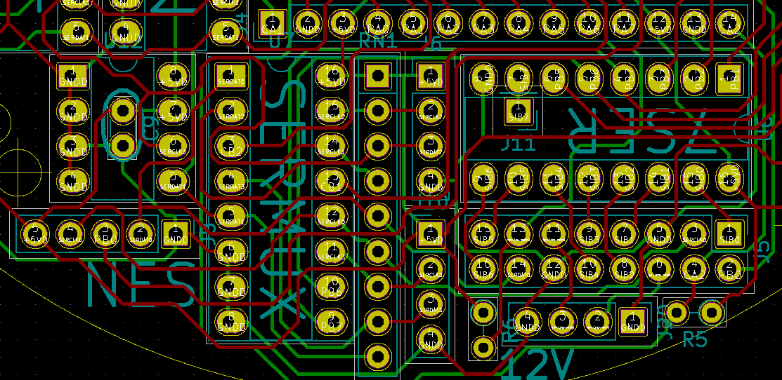

The base configuration of the XR2602 requires multiple fly wires to function. This is partly because I ran out of space. (This is unsurprising with 25 DIP chips on a 100mm diameter disc.) However, it also allows configurations where partially populated boards may provide additional parallel ports, SNES peripheral inputs, I2C chains (for serial EEPROM), SPI (for bulk storage) or other purposes. Unfortunately, this requires threading the data bus through the pull-up resistor SIL and other craziness. It will also vastly reduce the maximum operating frequency. Regardless, I am now considering a chip stacked cross-over configuration where two or more cores write to each other's RAM. This is intended to be compatible with dual core clock stretching. The XR2602's enigmatic PRIVAB is a 74HC74 where one half implements a privilege bit for the otherwise unused active high 6522 chip select and the other half will hopefully convert a level triggered /ABORT into an edge triggered /NMI1. This may fail to trigger during other interrupt cycles but it is primarily a developer over-ride.

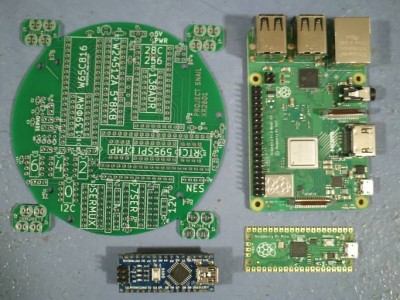

Due to my limit soldering ability, I have devised bespoke DIP footprints. These are like large pads commonly found in the 1980s but they only extend on the inside. This is sufficient for soldering 0.3 inch/0.6 inch mixed chip stacks without unnecessarily extending the width of a footprint. Actually, anything which has more than three pins and isn't an interface connector uses a bespoke footprint. Even the four-way idiot proofed power connector and clock stretching, three position jumper footprint are bespoke.
I have several problems to overcome. XR2602 clock stretching interferes with 6522 periodic interrupts. This is unsolved. The optional DS1307 I2C RTC has a spare pin which may be configured as a periodic interrupt. Or perhaps I'll stack four or five 74HC161 counter chips. However, either option may preclude use of CA1 via the parallel port. If fitted, the 7SER interrupt pull-up resistor restricts use of CA2 via the parallel port. (CB1 and CB2 are used exclusively in a clocked serial configuration.) In the current arrangement, SNES peripherals clash with 7SER but it is sufficient to develop each separately. Audio and video are unsolved. The current recommendation is text LCD via the parallel port, SPI OLED or the (oddly named) Gameduino which is SPI graphical LCD.
This will keep me occupied for a significant period but I hope this will lead to a platform with broad support for SNES hardware, Apple, Acorn, Commodore/Commander/Feonix software and more bespoke hardware and software.
Edit 1: Ongoing struggle with numeracy.

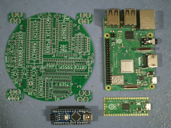

XR2601 with Raspberry Pi, Raspberry Pi Pico and Arduino Nano clone shown for scale.
XR2602 with Raspberry Pi, Raspberry Pi Pico and Arduino Nano clone shown for scale.
XR2602 parallel port and serial multiplexing for 2*8 pin 7SER connector, internal I2C bus, PS/2 keyboard, PS/2 mouse and SNES input peripherals.

I have a not so brief message to anyone working on their own computer design: Don't despair if it takes years to complete. I joined the 6502 Forum on Tue Aug 11, 2020 and was working on 64 bit extension for 6502 but unable to maintain interrupt performance as address-space scaled. After reading through the forum archive by Sat 19 Dec 2020, I strongly considered making a 6502 computer. Even if I failed, I would learn more about interrupts. Well, shortly afterwards, many ideas percolated including video, compression of executables and various multi-core designs.
On Mon 22 Feb 2021 (one year ago today), I spent about 5.5 hours - highly caffeinated and pacing - while doodling a mad superset of (the now deprecated) Project Proton. My intention was to not implement all of it but to have every conceivable, compatible feature in one place and then trim down the required subset for implementation. So, yes, this doodle does look like a 3*16KB page banking system into a 30 bit address-space, 4 tiers of address decode to I/O, 24 cards on three parallel buses, doorbell strobes to a cube of neighboring cores, dual core bank switching where one core handles video (sadly, incompatible with clock stretching) and a 4 tier privilege system.
I settled on memory map of 48KB RAM, 8KB I/O, 8KB ROM and suggested similar to cbmeeks on Tue 16 Feb 2021. I planned to describe how this arrangement was compatible with an 8 bit Apple style card bus and 4 tier privilege system on Thu 21 Oct 2021. I enclose a tidied diagram of the memory map. Regardless, by Tue 28 Sep 2021 my consideration of a privilege system was public.
plasmo's VGA6448 video in a RAM socket encouraged my mad ideas because I planned to partially decode the 30 bit address-space into 16 segments for 28C256 EEPROM or 62256 RAM. Multiple video displays from the same sockets would be a huge bonus. By Sun 25 Apr 2021, I had discarded all parallel buses but not the 3*16KB bank switching. I was decreasingly influenced by jfoucher's Planck and increasingly influenced by 6502GPD from Thu 24 Dec 2020 which has banking at $1000-$8FFF and incoporates sockets for 4 serial EEPROMs. After a particularly long ramble around the Shannon capacity of clocked and unclocked serial protocols, I found that it is possible to interface SPI, I2C, PS/2 and SNES peripherals using one 6522 and three other chips. This sufficient for interfacing UART, MicroSD - and possibly video too!
I was quite late to watch Dave Murray's My Dream Computer (Part 1, Part 2), although references to it are plentiful. I initially thought that the rather large prototype board was an over-sized prop for the purpose of describing the design with more clarity on camera. This was shortly followed by "Holy Cow! That's the actual board!" Projects on the 6502 Forum are rarely larger than 160mm*100mm and it occurred to me that the prototype Commander X16 could be considerably reduced in size. After one cycle of complicating and simplifying a design on paper, I began another cycle of complicating and simplifying a design in OpenOffice Draw. This would eventually be followed by a further cycle in KiCAD. From Wed 2 Jun 2021 onwards, my doodles in OpenOffice were hilariously optimistic due to an one-by-one error. I wrongly assumed that I could fit 0.6 inch DIP chips at 0.6 inch spacing. I therefore thought that I could fit I2C EEPROMs, processor, bank switching latches, four parallel EPROMs and an LCD interface into 3.7 inches. Regardless, the similarity to the Commander X16 prototype is intentional. Hey, what's wrong with starting from a credible board layout? The major difference is that I omitted stereo sound and placed dual 6522 in a similar location. Around this time, I began to appreciate the dual 6522 configuration found in many legacy 6502 systems. This was aided by 6502GPD's separation of system/user functionality.
By Sat 12 Jun 2021, I had devised a large number of DIP on both sides and mixed chip stack arrangements. Of most importance, I found that it was possible to place clock stretching and address decode under DIP 6502.
On Mon 14 Jun 2021, I switched to a highly optimistic, two storey DIP, 100mm circular arrangement. I wondered if I could arrange all of the chips radially at 12 or more angles. However, after working on numerous decorative and functional projects, it was highly apparent this would be a bad idea. Regardless, I hoped to have many of the chips facing inwards so that the rim would be ground and the inner part of the board would have a short, fat power rail. Actually, a draft version of XR2602 has a snail-like spiral for power. This is very pleasing but quite impractical. With 0.1 inch grid, I was working on points basis where 20 pins * 0.6 inch = 120 points. 100mm*100mm square board is almost 1600 points and 100mm circular board is approximately 1200 points. How hard can it be to layout a computer where each 6522 takes 1/10 of the board? Very.
But first, a back-check. By Fri 3 Sep 2021, I had spent an intense eight days confirming that the memory map was efficient. In particular, 74AC implementation may be faster, cheaper and more energy efficient than CPLD. Unfortunately, it has the very significant impediment that I/O is echoed in all 65816 banks. That isn't a concern when running legacy binaries in a system with a privilege bit. For many other cases, yes, this is a deal-breaker.
Layout started on Mon 29 Nov 2021 and was sent to manufacturing on Thu 30 Dec 2021. One layout attempt took more than 12 hours and this was less than 1/4 of the effort. I assume this is ridiculously slow but I don't intend to repeat this process too often. My design technique was fairly unconventional. I drew the minimum schematic and placed footprints concurrently. Then I kept adding features. I stopped at 25 chips because I ran out of space. Then I trimmed the design. XR2601 is actually XR2602 Version 10 simplified by specifically excluding bank latching, clock stretching, privilege system and second tier of address decode. I've no idea how much of this design works but the intention is to work from the oscillator outwards. This includes NOP test, Morse code, digital LED control and eventually working towards keyboard and mouse using an extension of SNES peripheral protocol. Given the current rate of progress, I expect this to take more than one year.
I've discovered the hard way that circuit board manufacture has a "proof-reading is best after publication" quality. I had no regrets for the first three days. This itself was alarming. And then the first mistake occurred to me. I didn't make the power lines double width. And then the second mistake. I've only clock stretched the 8KB ROM segment of XR2602. I was very concerned about using cheap, slow EEPROM and therefore +2 and +4 inputs of 74HC161 clock stretching are only allocated to $E000-$FFFF. The +1 input is kept high for compatibility with jfoucher's designs. With no other inputs, there is no clock stretching allocated to I/O in $C000-$DFFF. This is contrary to my own advice for making a fast system. The top tier of the address decode should feed back to clock stretching circuitry. This allows strobes to ripple through subsequent tiers of address decode while the processor is paused. Oh well. If two tiers of address decode don't limit performance then dodgy power distribution and ground bounce of a DIP processor will be the limitation. I might be adding bodge wires for power *and* clock stretching in addition to the intended fly wires for address decode.
Memory map for XR2601 (simplified design):
$0000-$1FFF: 8KB RAM.
$2000-$9FFF: Optional 32KB RAM in 8KB increments.
$A000-$BFFF: 74HC595 for SPI return and primary SNES peripheral chain.
$C000-$DFFF: 6522.
$E000-$FFFF: 1/4 28C256 selected with jumpers.
Memory map for XR2602 (full design):
$xx0000-$xx1FFF: 8KB RAM.
$xx2000-$xxBFFF: Optional 40KB RAM in 8KB increments.
$xxC000-$xxC1FF: Raise privilege and enter kernel via NMI vector.
$xxC200-$xxC3FF: Lower privilege.
$xxC400-$xxC5FF: System 6522 tied to privilege bit.
$xxC600-$xxC7FF: Reserved for 74HC595 or unprivileged 6522.
$xxC800-$xxC9FF: Reserved for 74HC595 or unprivileged 6522.
$xxCA00-$xxCBFF: Reserved for 74HC595 or unprivileged 6522.
$xxCC00-$xxCDFF: Reserved for 74HC595 or unprivileged 6522.
$xxCE00-$xxCFFF: 74HC595 for SPI return and primary SNES peripheral chain.
$xxD000-$xxDDFF: Optional I/O segments require chip stacked decode.
$xxDE00-$xxDFFF: Reserved for W65C265 compatibility.
$xxE000-$xxFFFF: 8KB ROM.
Unfortunately, I had to compromise on bank latching and I hope to correct this in the next iteration. A16, A17, A18 is tied to RAM address lines. Therefore, eight banks of partially decoded RAM repeat. I wanted A22, A23 tied to ROM. This would be upwardly compatible with 63 applications (one per bank of RAM) using multiple ROM ABIs. However, XR2602 only latches four bits of address: A16-A19. Therefore, the top bit of the RAM bank selection is tied to the bottom bit of the ROM bank selection. The scheme is not upwardly compatible. It also creates awkward limitations, such as a maximum of seven Commodore or Acorn applications but never more than four Acorn applications. This gets slightly more complicated when using portable binaries but only when obscure API calls are not available within one bank. I hoped to redundantly implement Acorn ABIs on $xxFBxx and Commodore ABIs on $xxFDxx to avert such cases.
Firstly, discussing double width power lines on 2022/02/22 is amusing.
Secondly, I intend to prototype as two layer and deploy as four layer with inner power and ground. Dave L. Jones and GARTHWILSON both recommend that power and ground should run between 0.1 inch spaced through holes.
Thirdly, I only considered via inductance. From the perspective of current carrying, eight times width feels insufficient when considering the return path of numerous address and data lines. (Dr Jefyll's recent advice about inductance and loop area is pertinent.) Even if it made no difference at all, double width power is a very helpful visual indicator when designing a board. In particular, power or ground should never terminate at any chip but should continue to form a mesh of power distribution. My less crowded designs follow this principle wherever it is easy.
Diagrams enclosed.
For boot-strap, I recommended a simplified, one chip version to gmc.
I was overly concerned by this limitation. It is possible for firmware to detect 20 bit/24 bit address-space. It is also possible to latch an extra four bits with 74HC573 on opposite clock phase. Or one additional 74HC157. Or possibly eight output SMD multiplexer. That doesn't fit onto my board. However, others may chip stack these without difficulty.
xr2602-memory-decode0-0-0.odg
(6.64 KiB) Downloaded 107 times
xr2602-memory-map0-0-0.odg
(6.28 KiB) Downloaded 91 times
I thought that it would be informative to draw a realistic doodle. This explains some of the finer detail, such as the pull-up resistors for the processor, data bus and four serial buses and the connectors for RTC battery, parallel port, I2C bus, PS/2 keyboard, PS/2 mouse, 7SER IDC and WS2812B/UART/servo outputs from EMU and M/X.
I will explain the oscillator section in more detail. The board area for the oscillator is intended to work with 0.1 inch quartz crystal, 0.2 inch quartz crystal, 2 pin ceramic resonator, 3 pin ceramic resonator or a directly supplied clock signal. Three of these five cases involve blobbing solder across joints. With minor modification, it is possible to include 0.3*0.3 inch canned oscillator or 0.3*0.6 inch canned oscillator. However, that would require more board and it makes half of the 74HC139 redundant. (Yes, 1/2 74HC139 is used to invert crystal. In favorable conditions, this works at 64MHz.) If you include canned oscillator option, I highly recommend connecting the spare pin to power so that a universal oscillator design works with the enable input found on some canned oscillators.
While experimenting with oscillators, I found that connecting the ground pin of a 3 pin ceramic resonator to the input pin causes it clock at double frequency. I do not expect this to be stable and I recommend against this configuration. After success with ceramic resonator, I wrongly assumed that quartz crystal would be a drop-in replacement and at least 10 times more accurate. In particular, I wrongly assumed that the inverting gate's input would start low, high or oscillating and that any state would be sufficient to start oscillation. Apparently, connecting a quartz crystal may place the inverting gate into a corner case where it sits in a midway state with no current flowing. It may spontaneously switch to a ticking state after a reset signal ceases and this will clock an uninitialized processor. Presumably, a ceramic resonator avoids this case because it is leaky and acts as its own kickstart resistor. This makes me wonder if a ceramic resonator should be avoided if they are less accurate and waste energy.

xr2602-base-board2-0-0.odg
(6.22 KiB) Downloaded 92 times
Sheep64 wrote:
While experimenting with oscillators, I found that connecting the ground pin of a 3 pin ceramic resonator to the input pin causes it clock at double frequency. I do not expect this to be stable and I recommend against this configuration. After success with ceramic resonator, I wrongly assumed that quartz crystal would be a drop-in replacement and at least 10 times more accurate. In particular, I wrongly assumed that the inverting gate's input would start low, high, or oscillating and that any state would be sufficient to start oscillation. Apparently, connecting a quartz crystal may place the inverting gate into a corner case where it sits in a midway state with no current flowing. It may spontaneously switch to a ticking state after a reset signal ceases and this will clock an uninitialized processor. Presumably, a ceramic resonator avoids this case because it is leaky and acts as its own kickstart resistor. This makes me wonder if a ceramic resonator should be avoided if they are less accurate and waste energy.
The only ceramic resonators I've used were with PIC microcontrollers. You tell the intended type of oscillator in the configuration word. Since the XT (Crystal/Resonator) and HS (High-Speed Crystal/Resonator) modes are both good for either a crystal or a resonator, it took a little digging to figure out the difference. It turns out it's in the threshold for the input high voltage. I've used the three-pin resonators, grounding the third pin, and got the expected frequency, not double.

These fun but ridiculous considerations lead me to consider a memory map for applications. By default, each application gets its own 65816 bank with a maximum of 48KB RAM. Bulk data, such as display and storage buffers, are placed within an application's bank whereas meta-data is held outside of the application's bank. This arrangement provides a modicum of integrity because an NMOS or CMOS 6502 binary should only scribble over buffers within one bank. This leaves file system, network and windowing unaffected. 65816 bank zero is also used to maintain state for the sparkly effects.
$0000-$00FF: Zero page. Unused on 65816.
$0100-$01FF: Stack. Unused on 65816.
$0200-$03FF: Might be required for Commodore ABI compatibility. Otherwise may be unused.
$0400-$0FFF: Three 40*25 text planes for display. Configurations vary. May be re-allocated for storage or network buffers.
$1000-$1FFF: Storage or network buffers. 4*1KB blocks sufficient for Forth. Smaller allocations may work as a stochastic cache.
$2000-$BFFF: Portable binary and data.
(See stochastic cache and portable binary.)
This is an unusual 6502 memory map because the bottom 1KB may be completely empty. However, care must be taken. Under different operating modes, allocation and re-allocation within the bottom 8KB may become tortuous or contradictory.
The 3KB for display may operate in different modes which may include 40*25 traditional PETSCII, Latin1 or Roman/Greek/Cyrillic with or without accents. Where symbol representation is 8 bit, the other two planes may be RRGGBBII foreground/background. Whereas, 16 bit symbols only allow foreground to be specified uniquely. This is sufficient to implement a serious text editor similar to LocoScript. The 65816 executive may copy and translate symbols to occluded windows on the display; possibly with one cell border RRGGBBII drop shadow via configurable LUT. (This is a variation of Bill Atkinson's window regions.) In the trivial case, RRGGBBII is decremented to make a shadow effect.
Within the 8KB I/O range ($C000-$DFFF), I have derived a tentative solution for high speed I/O after studying Radical Brad's 20MHz, 32 I/O strobe implementation. There is a widespread technique to use multiple 65xx peripheral chips in a configuration where they all share one common active low chip select while active high chip selects are tied to different address lines. See Address decoding (Garth's primer) for recent explanation with diagrams. This type of arrangement leads to asymmetric I/O ranges which decrease in size. It is quite profligate with address-space and invites opportunity for bus contention. However, it is blazingly fast and requires minimal hardware. In particular, one chip, 2ns address decode is possible. Radical Brad applies the same technique to 74x138 chips with their active high and active low chip selects. This has the typical advantages and dis-advantages but allows practical designs with generous I/O to exceed 20MHz. If contiguous memory is unimportant, this arrangement is also compatible with the 74x157 hack to obtain fast 20 bit or 24 bit addressing.
So far, XR2600 Series designs have been a tussle between speed, size and stability where everything lost. They have either:
  • Failed to allocate 48KB for RAM.
  • Failed to allow multiple SNES peripheral input chains.
  • Failed to allow multiple 65xx peripheral chips.
  • Failed to allow 6522 to count accurately.
  • Failed to implement one fast tier of address decode.
  • Failed to apply read/write qualification correctly to raw address strobes. Actually, I only found that error after adapting Radical Brad's ideas.
In XR2601, concern for speed and simplicity clipped the RAM by 8KB to add one shift register without read qualification. In XR2602, concern for flexibility omitted I/O from clock stretching and omitted strobes from qualification. The quickest fix for latch qualification breaks 65xx peripheral support while the quickest fix for I/O fan-out breaks accurate 6522 timing.
After some pre-amble and 1.5 days seriously considering the problem, I found that parallel I/O decode, using 74x138, within the range $C000-$DFFF, must meet simple conditions:
  • Leading bits of the address must be 110.
  • Two bits must be zero.
  • One bit must be one. This is quite trivial, given the leading bits.
With two zeros in every address range, it is possible to divide an I/O range into half-of-a-half-of-a-half in the following form:
1100............: $C000-$CFFF: 4KB range.
11010...........: $D000-$D7FF: 2KB range.
110110..........: $D800-$DBFF: 1KB range.
1101110.........: $DC00-$DDFF: 512 byte range.
11011110........: $DE00-$DEFF: 256 byte range.
This arrangement has W65C265 compatibility because it approaches the internal I/O in page $DF but doesn't reach it. It can also be adapted to the simpler case of I/O starting from $8000 by dropping one leading bit. Unfortunately, for some ranges, the number of significant address lines exceeds the inputs of 74x138. Fortunately, they can be hollowed out such that the *last* address-space echo does not incur bus contention:
1101x10.........: $DC00-$DDFF: 512 byte range.
1101xx10........: $DE00-$DEFF: 256 byte range.
With minor modification and future proofing, it is possible to define the I/O range such that each 74x138 provides one, two or four strobes but never eight (like Radical Brad's design) because each range uses one top-level address decoder running in parallel and there aren't enough inputs free:
1100ss..........: $C000-$CFFF: 4KB for optional VAN [Video, Audio, Network].
11010s..........: $D000-$D7FF: 2KB unused.
110110..........: $D800-$DBFF: 1KB unused.
1101110.........: $DC00-$DDFF: Optional privilege strobes, shift registers and video registers. This range may be qualified and clock stretched.
11011110........: $DE00-$DEFF: One primary privileged 6522 and four unprivileged 6522s or six unprivileged 6551s.
11011111........: $DF00-$DFFF: Reserved for W65C265 compatibility.
And the oft neglected clock stretch map:
$0000-$DBFF: No change.
$DC00-$DDFF: +1 clock stretch for large fan-out of address strobes.
$DE00-$DFFF: No change.
$E000-$FFFF: +2/+4 clock stretch for slow ROM.
With sparse address decoding, 16*16 pixel text mode and bank switching into one display line, bus contention will occur when attempting 4K video and erroneous clock stretching will occur when attempting 16K video. This is not a concern for a system which displays 1920*1080 or less. However, software written for this system should work on larger systems.
Although this memory map is primarily designed for implementation with discrete 74x138, several other options are available with differing limitations:
  • FPGA with 4 input LUT requires +1 clock stretch across $D000-$DFFF. This affects 6522 timer accuracy. However, if you implement with FPGA, you may not require any 6522.
  • FPGA with 5 input LUT works best if I/O spans $8000-$BFFF rather than $C000-$DFFF. Alternatively, Omit A12 from address decode.
  • Discrete implementation requires +1 clock stretch for 24 strobe fan-out.
  • CPLD with 6 input macro-cell is compatible with discrete implementation but may be slower and consume more energy.
Anyhow, the general principle is that it is possible to run numerous 74x138 in parallel. One decoder provides strobes for six RAM chips, one ROM and provides clock stretching signal for slow ROM. The remainder are sensitive to decreasing spans of the I/O segment. This is achieved in an upwardly compatible manner which superficially appears to defy the six input limit of 74x138. With restrictions, the same memory map is compatible across CPLD and FPGA.
After staring at boards intermittently for almost five months, I will further stare at boards. Ultimately, I think that I'll have to redo about 20% of the layout. That might take about 10 hours.
Edit 1: Moved primary 6522 out of page $DF.

I wasn't ready to design circuit boards. Indeed, I'm still not ready. I don't think that I'll ever be ready but I had time and opportunity to push my limits.
After designing boards in Nov 2021 and Dec 2021, ordering boards in Dec 2021 and receiving boards in Jan 2022, I have only looked at them. Part of my procrastination is that the accompanying EEPROMs are caught in the chip shortage and aren't expected before Jun 2023. The only time that I've warmed a soldering iron this year was to assemble XR1155 5 volt Christmas lights. That was in Feb 2022. Actually, I'm saving the 2021 Christmas programming challenge for Jul 2022.
After further staring at boards, I think that I will only use them to wire power, ground, address and data. This is faster, more compact and more reliable than the equivalent 60 wires on a breadboard. However, it is a marginal use of resources. Superior address decode fits on one 5cm*7cm perfboard. Asymmetric clock fits on the same perfboard. So, for a while, XR2600 Series is going to be a one circle, one rectangle implementation. Even if my work had no error, a board received in Jan 2022 would require bodging to work in a manner more similar to Radical Brad's design published in Apr 2022.
The upside is that I have a coherent plan for video and audio - and even networking. This extends to trunked audio conferencing over LAN. Previously, my plan for video was a "here be dragons" something-on-the-end-of-SPI which was encouraged by Commander X16's VERA becoming available separately. Thanks to insight from Radical Brad, it is possible to have optional, memory-mapped, stereoscopic view-ports for video or simultaneous banks for audio buffer and network buffer.
In the medium-term, I've been thinking about re-designing one quadrant or so of my circular design. The lack of 28C256 and relative abundance of SST39SF040 requires me to replace 28 pin DIP socket with 32 pin DIP socket. This can be achieved by moving the power connector. The difficult part is that optimal address decode requires a minimum of four 74x138: one for RAM/ROM, one for unqualified 6522 and two for qualified strobes. The first 74x138 fits under ROM but the latter three may become a curious example of chip stacking.
I'm considering 3.3 volt only. This reduces energy consumption and simplifies interface to MicroSD. In other places, it makes minimal difference, if any. In the case of 1 volt peak-to-peak output signals, it merely requires different resistor values. Regardless, it is less impressive to have 3.3V CMOS system run at 20MHz when it is equally difficult to make 5V CMOS system run at 30MHz. If you want the most impressive figures, 5V (or more) is essential.
