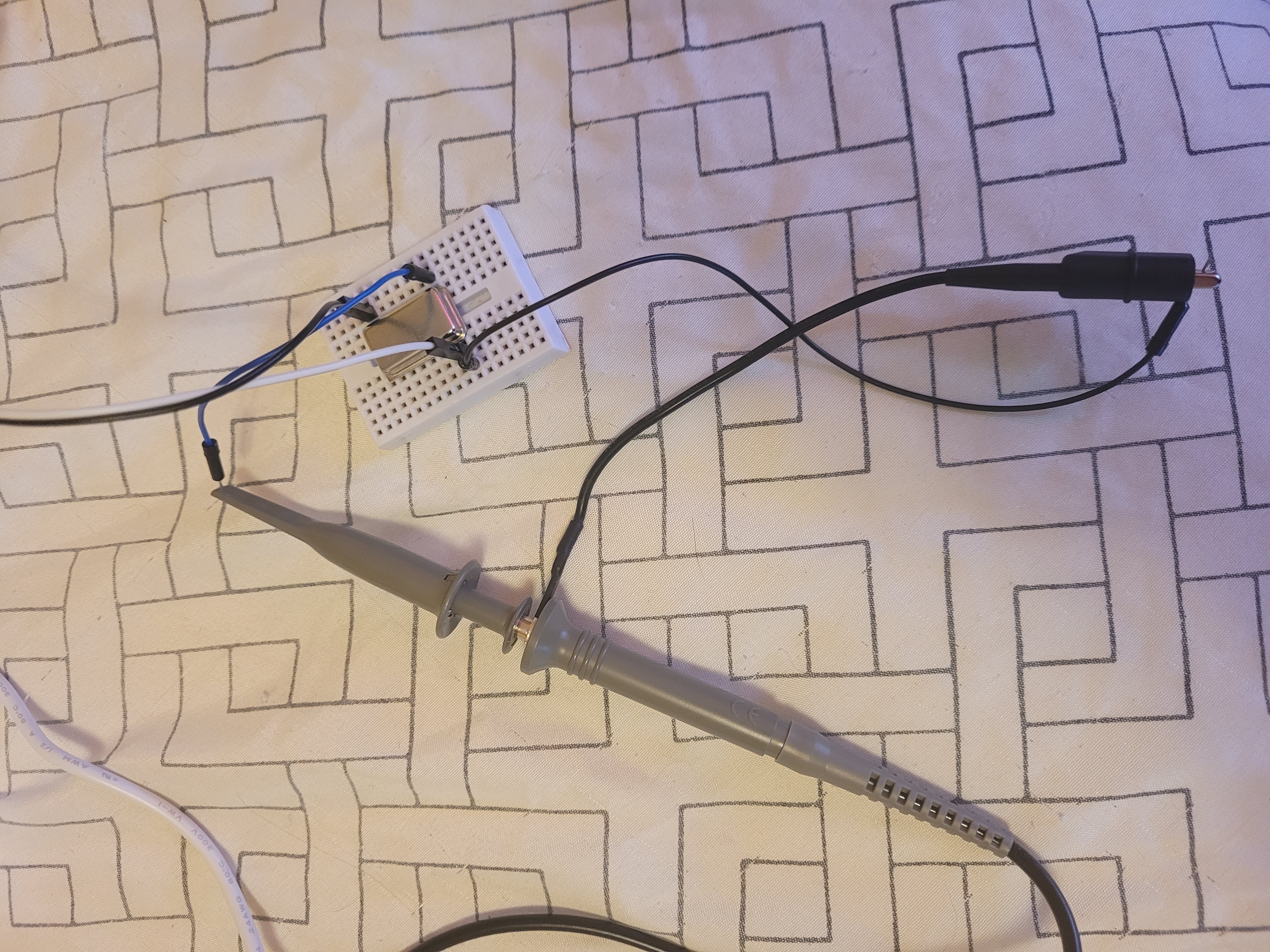

I live in the states, so I'd expect 60Hz if that were the case?
I've used probes quite a bit for troubleshooting lessons in Devices II, usually on OPAMPs. Admittedly we've never spent much time drawing schematics or creating actual circuits in my classes, we mostly went over theory and formulas.
But yes, the probe is connected correct,
Probe connected to GRD and CLK.

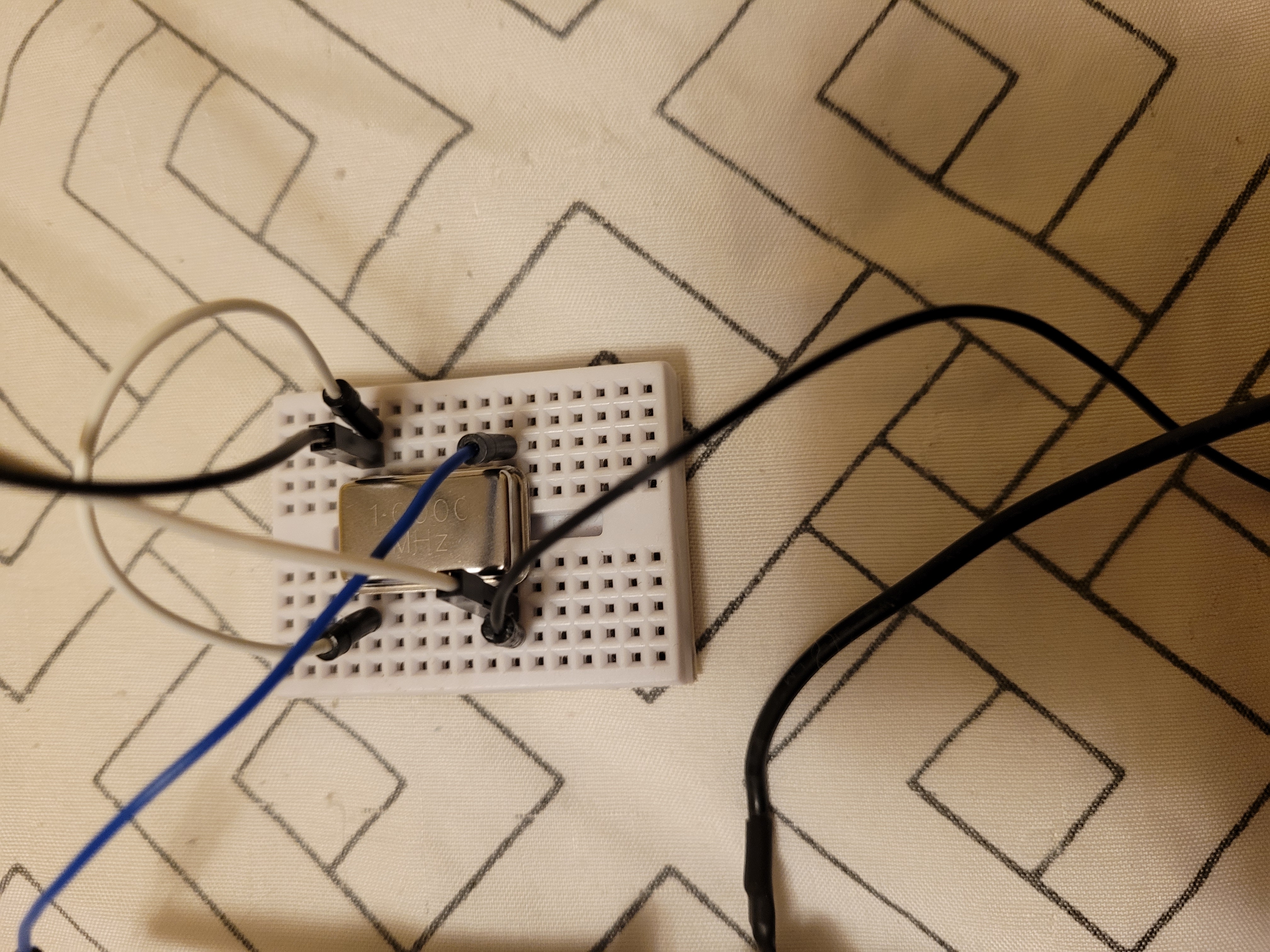

What about the fourth pin on that oscillator? Besides the Gnd and power pin and the Output, some units also have an Enable input that needs to be tied high. As an experiment, I'd just go ahead and try attaching that pin to +5.
And your little test circuit could use a bypass cap, BTW.

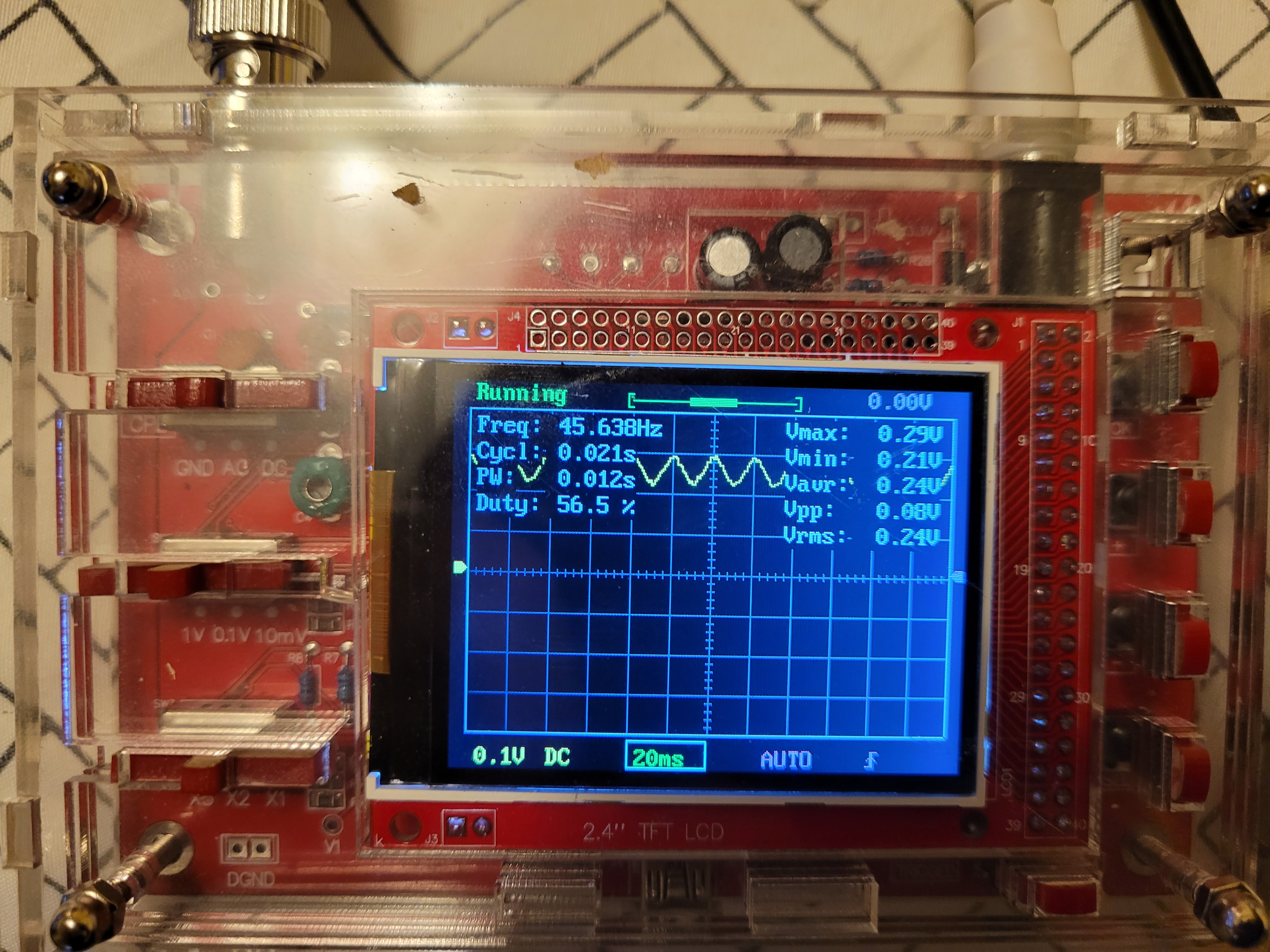

Ok, so I continued to get around 50Hz measured when I tried connecting 5v to that last pin.
Test Oscillator
Test Oscillator
Scope
Scope

The scope is working correctly! I tested it's 1KHz output and it worked just fine, I also got 50Hz out of the oscillator, and the voltage was peaking around 2.5v.
Looking at the pic you posted, you forgot another critical piece of information: it's not only peaking at around 2.5 V (actually 2.9 V in your image; I assume that the 'scope display is not compensating for the 10x probe), but Vmin is 2.1 V. So from a TTL point of view there's no signal there; it never swings below 0.5 V to become a '0'.
But as leepivonka points out, it didn't occur to me to look at the 'scope specs. I don't see anything for sampling rate there, but it does say that the time base range starts at "10μs / Div", which is not a good sign; if it sampled fast enough to capture a 1 MHz waveform surely they wouldn't make you display ten cycles of it in a division, making it unreadable. (The picture of a running screen shows a 140 kHz waveform.) So yeah, I'm thinking that probably this 'scope can't be used to check this clock.
No fear, though; you can run the W65C02 at any speed, so if you can get hold of a slower crystal, or divide this one down per Ed's suggestion, that will let you check the clock. If neither of those options is handy, I'd start by hooking the clock back up to the CPU, pulling up/down the data bus to generate a NOP, and then trying your 'scope on the high address lines, which I hope might be down in a range that your 'scope will show. On a CPU running at 1 MHz, and at two cyles per NOP, A0 should be changing at 500 kHz, A1 at 250 kHz, and so on all the way up to A15 at 15.25 Hz. (Someone check my math there.) And this is exactly what I saw on both NMOS and early CMOS 6502s, last time I tried this out. However, I don't know if the W65C02 behaves in the same way, maintaining the address bus value throughout the entire cycle until it needs to change it.
(If this does work, you also now have built yourself a handy tester to see how high your 'scope goes. :-))

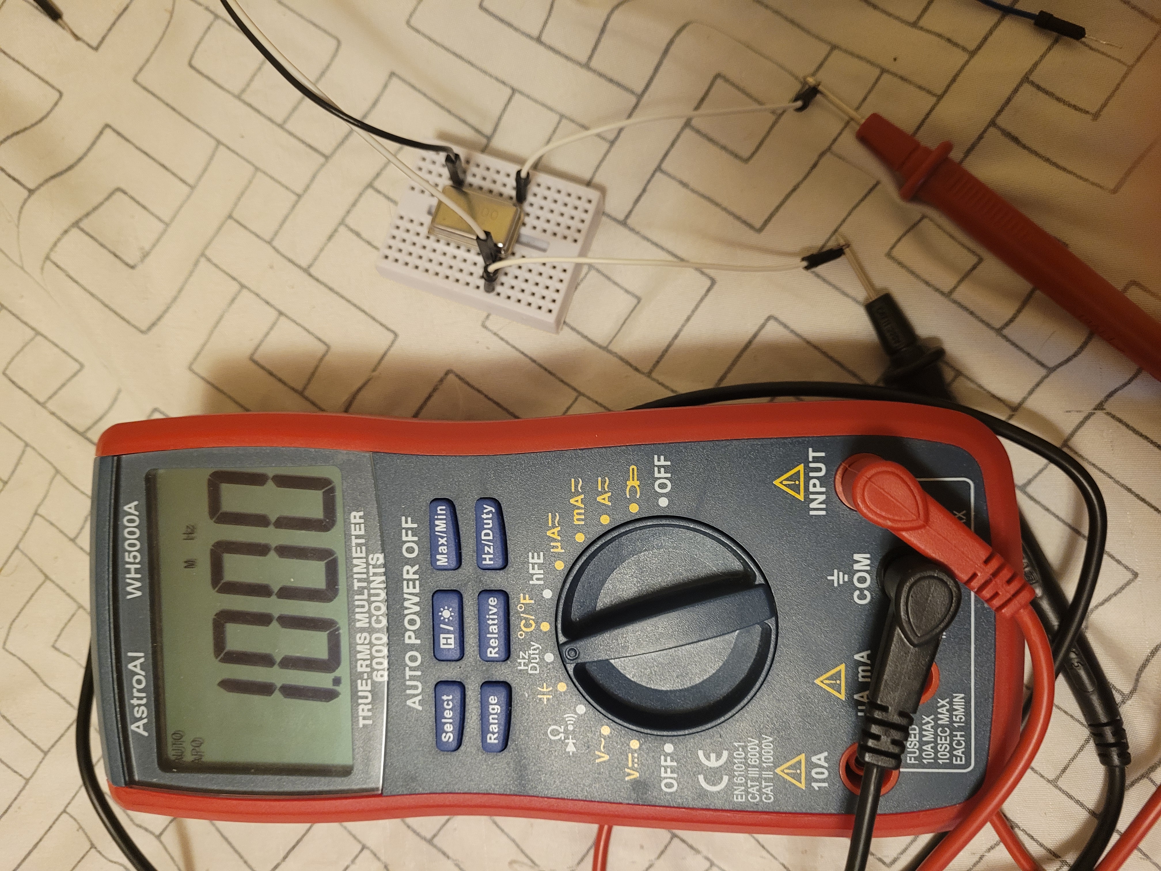

Ok, guys, I do have a meter that can read frequency, and to be honest, I don't know why I haven't tried it yet, slipped my mind I suppose.
So, I can either use the scope for checking pulled address lines, or the meter for checking the oscillator outright (if it can,) or I can purchase a slower crystal.
Then get back to debugging the CPU?
(Side questions, using a smaller crystal would let me see the LED's change correct, if it was slow enough of course?
When I last tried it, the LEDs that came on stayed on, and the ones that were off stayed off. I assume that is because was not receiving a clock signal?)
Thanks again for the help you've all given me so far, and I hope Christmas is treating you all well!

Ok, so, the oscillator works correctly, tested it with the multimeter, I should've done that from the beginning, would've saved us all a headache, I imagine, my apologies.
But now that it is out of the way, I'd still like to figure out (see quote below:)
Meter reading crystal's output.

Ok, so, the oscillator works correctly, tested it with the multimeter...
That's good to see. But do remember, just because it's a 1 MHz signal does not mean that it's of the appropriate shape to properly drive the CPU, nor does the signal you see when the output is not connected to anything necessarily match what the signal is when the oscillator is plugged into the circuit. But this is definitely a good additional piece of data!
I'd do all three, since you're at a moderately early learning stage with this stuff. In particular, a slower crystal will give you a lot more flexability when walking through your circuits with your 'scope, since much more of the circuit will be visible to it.
