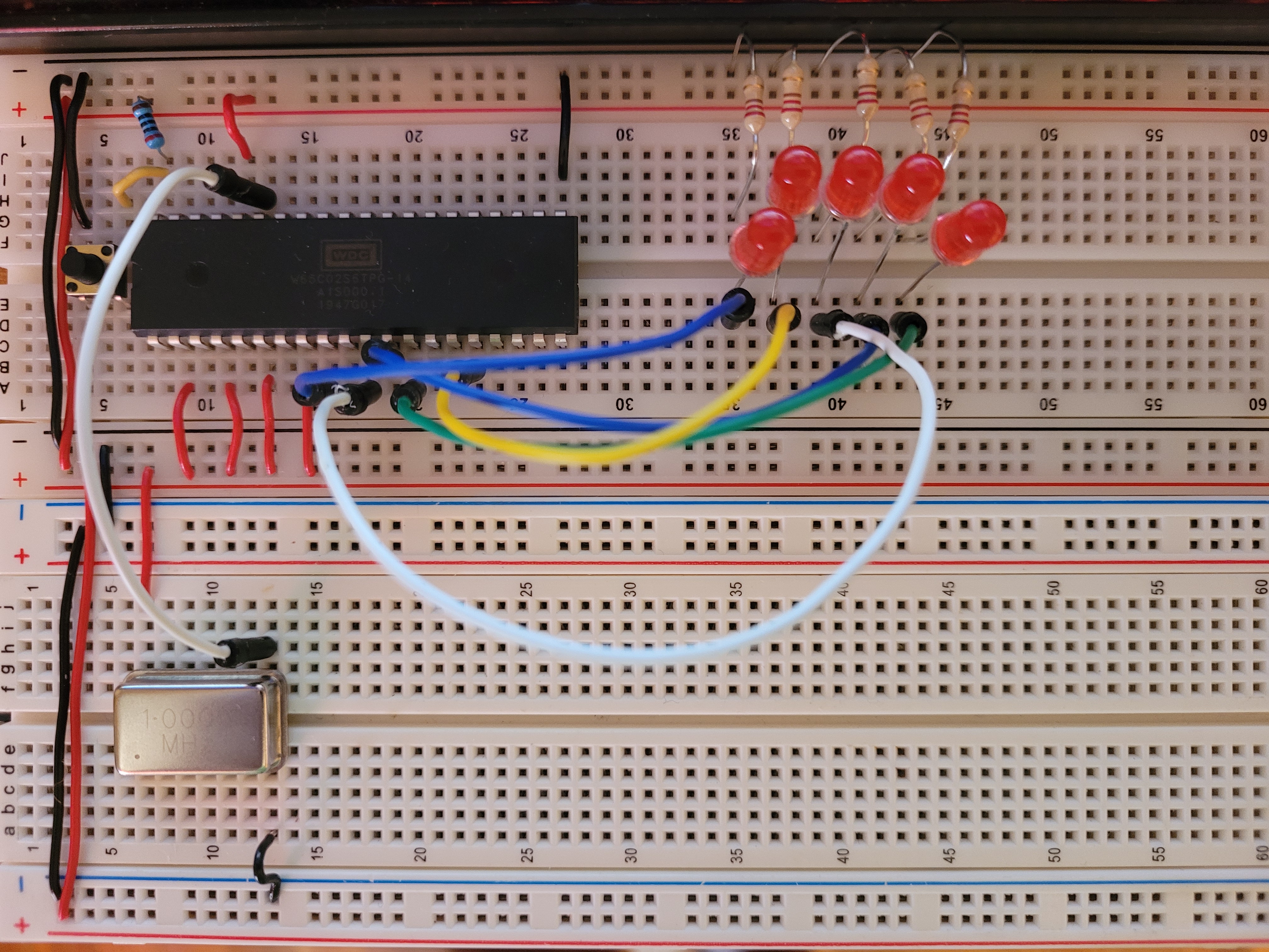

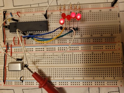

I've been building this 8bit computer and I'm kinda lost. I've been following Ben Eater's videos on it (as it is his kit,) and when I tried to use the crystal oscillator, my CPU would not output anything, I tried make a timer with a 555 chip, and that pulses only sometimes.
Lastly, only some of the CPU's address pins work, I checked the voltages with my meter, they never went high while the other would go low and high like they should.
What am I doing wrong?

Can you post a schematic (in monochrome) of your circuit? Also, I don't see any bypass capacitors in your circuit. Without the schematic we probably can't offer too much help?

I'm following Ben Eater's video series, so I hadn't made a schematic for it.
He hadn't used any capacitors (yet, the kit does come with them) so I hadn't either. I can make one, but I'll have to reinstall the software I used, I lost it after some computer issues I had earlier this month.

Re: Help: Crystal Oscillator is not working.
Post by hoglet »
You seem to be feeding the clock into pin 35; it should be connected to pin 37.
Oops, yes, I did. I fixed that and plugged it all up, but none of the LEDs are lighting up (they're connected to the address pins.)
I tried resetting the cpu with the button on the left (connected to pin 40,) with no luck.

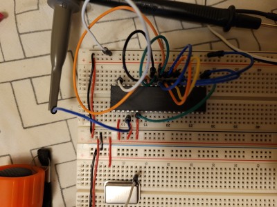

Ok, I checked the voltages on Power and Ground, they were fine, I checked all the others that were pulled high or low, also fine. At one point some of the LEDs came on, but I can't tell if that's meant to be correct.

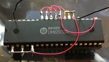

I did try making a NOP, and I think I did it right https://i.ebayimg.com/images/g/JTkAAOSw ... to go by.
I checked the lines again, and the data pins all were all in the Millivolt (different amounts) range (as was pin 6,) and pins 2 and 4 were 5 volts.
I couldn't get a frequency at all out of my scope.

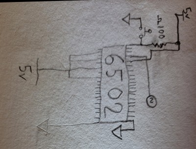

I've also drawn a schematic, please excuse my handwriting.
Testing NOP with probe.
LEDs on while testing pins for Voltage.
Schematic
Schematic

I do have a meter, and that very same scope. I've already checked some address pins with the meter, but some stay high always, and some stay low always.
Well, the meter generally won't give useful results on a pin that has a changing signal unless it's changing really slowly, at speed even humans would have no problem seeing. What you will see for a changing signal will depend on the meter, but I would not be surprised to see a pin that's on 75% of the time and off 25% of the time just show up as "5 V" or similar.
I also tried to make sure the oscillator was working correctly with the scope, but I couldn't get anything out of it.
Ah! Well, that could be because you're having difficulty with the 'scope, or it could be because your oscillator isn't working. That would definitely be step 1 to work out; no amount of debugging on the 6502 will help if it's not getting a clock signal.
You might start by checking to see if your 'scope has a test point that generates a signal (typically 1 kHz). Most do, as it's necessary to calibrate the probe. If it does, you want to start by getting that working, and playing with the horizontal (time base), vertical (voltage level) and maybe trigger settings a bit so that you know in what direction you need to twiddle those to display a 1 MHz 5 V clock waveform on the screen.
ProfessorCagan wrote:
I did try making a NOP, and I think I did it right if this image is anything to go by.
That's this image, right?
No, that is definitely not the way you want to do it! You should never connect pins used for ouput directly to Vcc or ground; this can cause a short circuit through the chip trying to drive the pin, potentially accompanied by smoke, fire, and other such exciting things. Though in theory the CPU shoudn't be trying to drive the data pins when it's being driven by a NOP generator, this is difficult to guarantee.
Instead, connect the data pins to Vcc or ground through a resistor. (330 ohms to 1 kohm are typically good values.) These are referred to as "pull-up" (when connected to Vcc) and "pull-down" resistors; they'll bring the line high or low when it's not being driven by another device, but otherwise let that other device bring the line to its preferred value.
Also, it looks as if you've removed the reset button in your current build. You'll want a at least a pull-up on the reset line to keep it high when the system is running, and also you should put back the button or at least mention that you're using a jumper wire manually to bring the reset line low before you start testing, since without a reset signal after power-up the CPU may not start operating.
On a schematic diagram you need not include all the pins, nor put them in the same order that they're used on the chip, and it will be clearer to leave off unused pins. You'll also need either pin names or pin numbers on each connection to an IC on your schematic; it's good to include both as that will help to find errors. I've attached an example, again from Garth Wilson's site. The IC on the top is a 6522 VIA, but it's also a large 40-pin chip, like the 6502. You'll note that he shows here only the 21 pins (of the 40 total) that are of interest for the particular bit of circuitry he's explaining. (There's, e.g., a whole set of data bus lines that are not shown.)

The clock is crucial. Those little oscillators only need a supply and they will oscillate. With no other connections at all, you should see the clock going.
At some point you might start to wonder if the parts you have are good or bad. That's where it's very handy to have some spares. As a beginner, you might not have any spares, but if you think you might persevere with this hobby - and it can be very rewarding - it can be cost-effective to buy things in twos and threes, especially if postage is significant. And be sure to buy from reputable outlets: you might save a dollar or two buying from ebay, but you could cost yourself hours of debugging, or even cost yourself all your enthusiasm for the hobby, if it turns out you buy bad parts.

1MHz should show up (although not sharply) even with a cheap probe that's not really worthy of a 'scope beyond audio use; but assuming you have real scope probes, make sure you're on the x10 setting. On the x1 setting they're only good for a couple of MHz, definitely nowhere near what you need to show a 1MHz square wave as anywhere near square. Decent probes aren't cheap (even the cable they use is very special, not normal coax of any kind); so take care of them. Even for a 40MHz 'scope (which is probably the slowest of the real 'scopes these days), a pair of probes will cost $40+.
I would make sure the oscillator can has +5V and ground, and then see if it has output, even without a load, ie, with the output going nowhere in case wherever it's going has a short someplace.

No, that is definitely not the way you want to do it! You should never connect pins used for ouput directly to Vcc or ground; this can cause a short circuit through the chip trying to drive the pin, potentially accompanied by smoke, fire, and other such exciting things. Though in theory the CPU shouldn't be trying to drive the data pins when it's being driven by a NOP generator, this is difficult to guarantee.
and
The processor needs a clean, de-bounced reset signal to get started right. Without it, I could not predict what it might do, even with the data lines hard-wired as $EA (the NOP op code). I doubt it would damage it, but there's probably no sense in trying to go further in debugging before this is taken care of. The Reset section of the 6502 primer, at http://wilsonminesco.com/6502primer/RSTreqs.html, has some circuits you can use. Do go through the entire 6502 primer though. It should save you a lot of time and headaches and dramatically improve your chances of success. It is logically organized in 22 sections (pages). I initially wrote it many years ago to answer questions and problems that kept coming up on the forum; but I keep updating it (in fact I just went through it last week and fixed all the links that had gone dead).

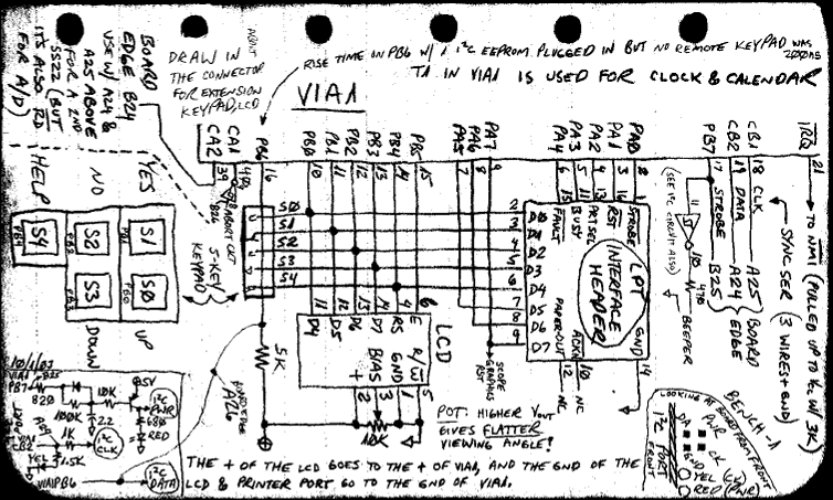

LOL, you would have to show my worst one! :lol: That one is in my tiny 3x5 QRG (quick-reference guide) ring binder for my workbench computer. After scanning it, I spent a lot of time trying to clean it up in the photo-editor software to make it readable at all (after the paper was quite yellowed and the pencil lines weren't as dark as they should be), so I wouldn't have to re-draw it, since there was so much to pack into a 3x5, showing all the I/O I have connected to VIA #1, a 65c22. There are lots of hand-drawn circuits in the 6502 primer though, especially in the circuit potpourri page, and in the page of QRG scans of the workbench computer tiny ring binder at http://wilsonminesco.com/BenchCPU/B1QRG/ (which I did before I knew how to operate the photo-editing software as well as I do now—shucks, one more thing I should go through and improve...)
There's a method to my madness. Part of the idea is to show anyone else thinking of doing their own website that you don't have to have fancy software. (Actually, there are parts of every schematic-capture software I've tried that I don't like, so I still do my schematics by hand, on velum up to 18x24", before I lay out by boards with CAD, which have been up to 500 parts, and using this method, I don't get any errors.) I make my web pages with a plain text editor, writing directly in html, and I don't use any CSS.

LOL, you would have to show my worst one! :lol: That one is in my tiny 3x5 QRG (quick-reference guide) ring binder....
Yeah, I was having trouble finding something that had a partial drawing of a big and fairly complex IC in it, as well as some other stuff. But also perhaps seeing that even pros make slightly messier sketches sometimes makes things less intimidating. And it's good that it demonstrates that you can and should put notes on your schematics.
Well, I have had good success with old NMOS 6502s by just using a jumper wire to ground the /RESET pin row for half a second and then pulling it out, though I know that's not ideal. But yeah, having a proper reset is certainly one of the things you should be looking at if you're sure you've got power and clock working.
Oh, and it just occurred to me: for every device on the board, connect a 0.1 μF capacitor from the power pin row to nearby ground. (You already have both power and ground on both sides of the board, which is good.) This is far from perfect bypassing (everybody well tell you that the cap should be as close as possible to the power pin etc. etc.), but even at some distance away from the power pins (a distance that would have some people here yelling at me, I'm sure :-)) I've found this makes a dramatic difference in the signal quality of the IC outputs.
I would also move the oscillator up on to the same board as the CPU: just move the CPU a bit more towards the centre, put the oscillator at the end of it with the Φ2 input pin, and hand-cut a short little jumper to connect the two. This will massively reduce the distance the clock signal has to travel and also reduce the power and ground distance between the oscillator and the CPU, which is a rough heuristic for some other things that make for a more reliable design.

I'm sorry I made so many mistakes, I'll start with the oscillator, the scope I have does indeed include a testing signal.
I do have some spare parts but it may take a while to get more, being a broke college student is fun!
So, if I have this right from reading the replies, I need to:
1. Ensure I'm getting a clock signal from the oscillator (with x10 set on my probe.)
2. Move the oscillator closer to the CPU.
3. Reconnect my reset button (or should I try out those reset circuits that GarthWilson linked?)
4. Include a 0.1 μF capacitor connected to power and ground for every device on the board.
5. Redo the NOP with pull-up/down resistors.
6. Test output again.
Am I correct in all this?
