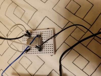

I live in the states, so I'd expect 60Hz if that were the case?
I've used probes quite a bit for troubleshooting lessons in Devices II, usually on OPAMPs. Admittedly we've never spent much time drawing schematics or creating actual circuits in my classes, we mostly went over theory and formulas.
But yes, the probe is connected correct,
File comment: Probe connected to GRD and CLK.

On the scope: I don't see much for specifications on it, but it does mention 1Msps - does this mean it can do up to 1M samples per second? If that's true, it won't be able to reliably show the fundamental frequency of a 1MHz signal, let alone any higher multiples to show how sharp the edges are. The 50Hz signal you're seeing could be the beat between the oscillator signal & the scope's sampling rate.
On the oscillator: 2.5v peak could just barely meet TTL voltage levels ( >2.4v hi, <.8v lo).
Check the 6502 datasheet for your CPU version - this may not meet the clock input requirements.
You could improve the signal by adding a pull up resistor (try 470 ohm to +5v) or running it through a 74hct gate (try 1 section of a 74hct04).
Most 6502 variants can run at clock frequencys down to 100KHz, any some down to DC. Check the datasheet for your CPU version for details.
PostPosted: Wed Dec 23, 2020 9:47 pm
OK, just checking.
What about the fourth pin on that oscillator? Besides the Gnd and power pin and the Output, some units also have an Enable input that needs to be tied high. As an experiment, I'd just go ahead and try attaching that pin to +5.
And your little test circuit could use a bypass cap, BTW.

PostPosted: Thu Dec 24, 2020 2:30 am
Posts: 730
Location: Tokyo, Japan
The scope is working correctly! I tested it's 1KHz output and it worked just fine, I also got 50Hz out of the oscillator, and the voltage was peaking around 2.5v.
Looking at the pic you posted, you forgot another critical piece of information: it's not only peaking at around 2.5 V (actually 2.9 V in your image; I assume that the 'scope display is not compensating for the 10x probe), but Vmin is 2.1 V. So from a TTL point of view there's no signal there; it never swings below 0.5 V to become a '0'.
But as leepivonka points out, it didn't occur to me to look at the 'scope specs. I don't see anything for sampling rate there, but it does say that the time base range starts at "10μs / Div", which is not a good sign; if it sampled fast enough to capture a 1 MHz waveform surely they wouldn't make you display ten cycles of it in a division, making it unreadable. (The picture of a running screen shows a 140 kHz waveform.) So yeah, I'm thinking that probably this 'scope can't be used to check this clock.
No fear, though; you can run the W65C02 at any speed, so if you can get hold of a slower crystal, or divide this one down per Ed's suggestion, that will let you check the clock. If neither of those options is handy, I'd start by hooking the clock back up to the CPU, pulling up/down the data bus to generate a NOP, and then trying your 'scope on the high address lines, which I hope might be down in a range that your 'scope will show. On a CPU running at 1 MHz, and at two cyles per NOP, A0 should be changing at 500 kHz, A1 at 250 kHz, and so on all the way up to A15 at 15.25 Hz. (Someone check my math there.) And this is exactly what I saw on both NMOS and early CMOS 6502s, last time I tried this out. However, I don't know if the W65C02 behaves in the same way, maintaining the address bus value throughout the entire cycle until it needs to change it.
(If this does work, you also now have built yourself a handy tester to see how high your 'scope goes. :-))
If this doesn't work, I'd do a quick check of the /RESET line, triggering your 'scope for a one-shot capture when you press the button, if it can do this. If you're having a good day it will look fine, but if the reset line is a big bouncing mess when you press the button, you might want to consider building a proper reset circuit.
If none of that works out, while you're waiting for a slower oscillator maybe try building a manual-step clock so that you can click a button to cycle the CPU, and see if that, with a NOP generator, produces some expected results on the address lines.
BTW, 32.768 kHz oscillators are really common and cheap, and well within the range of your 'scope unless the picture is a complete lie.
