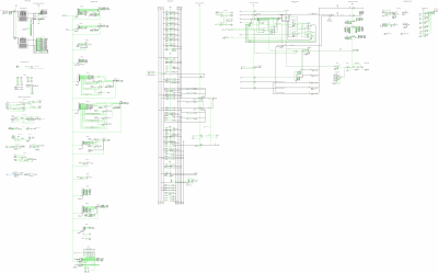

Rather than creating a detailed block diagram, I thought I might simply publish the Logisim file. It has the significant advantage of being already complete and accurate -- two important things that a detailed block diagram currently lacks! :wink:
For those that do not have Logisim, I have include here a png image which can be zoomed into to reveal all the CPU circuitry:

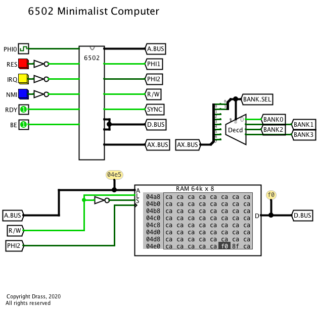

For those that do have Logisim, I am using Logisim "Evolution". When you load the C74-100 circuit file, you will be greeted by the following:
To set the CPU running the Dormann Test Suite:
  1. Right click on the RAM module and select "Load Memory Image"
  2. Load the file "Test_6502_RAM_Image" included in the attached zip file
  3. Set the RDY and BE pins to "1"
  4. Start the clock
  5. Press the "RES" button.
The Dormann test suite will begin to execute. You can then navigate to the "6502" module to watch the CPU execution up close. Of course you can also type your own program into RAM, point the RESET vector in high memory to it and press the RES button.

  • C74-100 Critical Path (V1).pdf -- a detailed listing of all signal paths through the CPU with estimated tpd
  • C74-100 Decoder Values (V1).pdf -- a table showing the encoding used for both microinstruction and instruction decoding
  • C74-100 V1.circ -- the Logisim file
  • Test_6502_RAM_Image
Disclaimer: Please consider all this material in draft form and subject to change without notice. The main objective for this model is to test out the ideas. As such, implementation details may differ materially from what is contained herein.
As always, I would be happy to answer any questions or provide any additional explanations.
It looks very professionaly done and works very well.
Maybe it needs to be clarified that this is intended to run on Kevin Wash "Logisim Evolution" fork, a.k.a Logisim Holy Cross Edition; unless I am using a wrong version, it actually does not load on the mainstream reds-heig version. Just in case you were not aware of it, the Holy Cross edition also features the File Viewer component, which when properly formatted, allows you to visually display the assembly source file, with the currently fetched instruction highlighted. I really love that.
From your simulation I learned that it is a lot more effective (read faster) to just build the model out of native logisim components, than attempting to emulate 74xx ics down to logic gates as I've been doing so far. Btw, I like the D.IN, D.OUT trick to get memory out of the 6502 subcircuit.
Definitely, but you do need to keep the 7400 series ICs in mind as well. In this case I’ve marked various Logisim components with the 7400 series equivalents I intend to use. I’m also careful to reflect the correct pinouts. For example, I put inverters in front of inputs which I know are active-low on the 7400 series ICs but are active-high in Logisim. That keeps the logic straight from the start.
yes, I saw that. Since I already had many 74xx ics modelled in sub circuit boxes I just have now replaced their down-to-logical-gates implementations by native logisim components at the bottom level, and it’s definitely much faster. The the same higher level boxes still remain though. That makes the model look closer to the schematic in general, but it looses the sense of digital diagram that you get by using the native components right at the top level.
