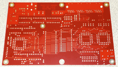

POC Computer Version One Revisited.

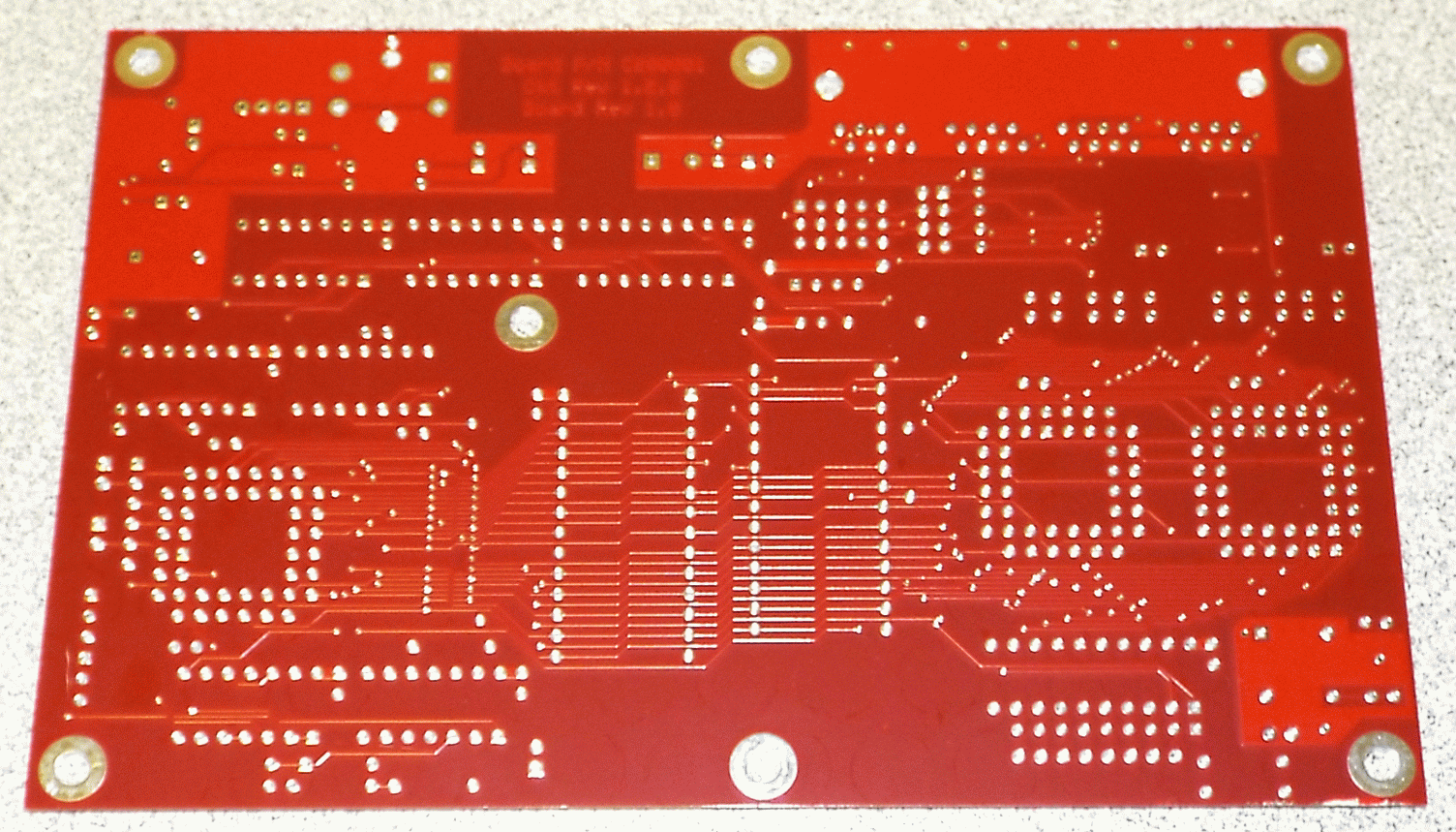

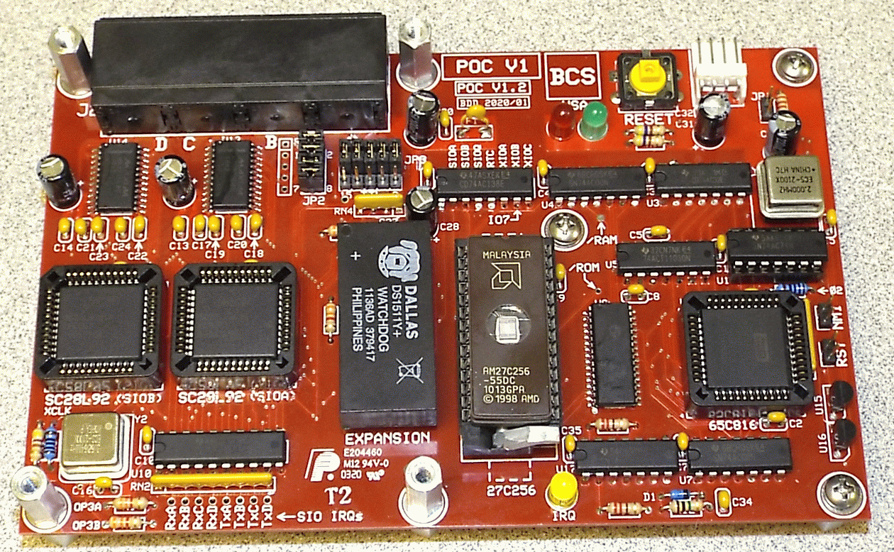

POC V1.2 is assembled.
PCB Component Side
PCB Component Side
PCB Solder Side
PCB Solder Side
Above are photos of the bare PCB. For some unfathomable reason, I decided to get red boards this time. It wasn't a good idea, as the relatively bright color gave me some grief in trying to place and solder comoponents.

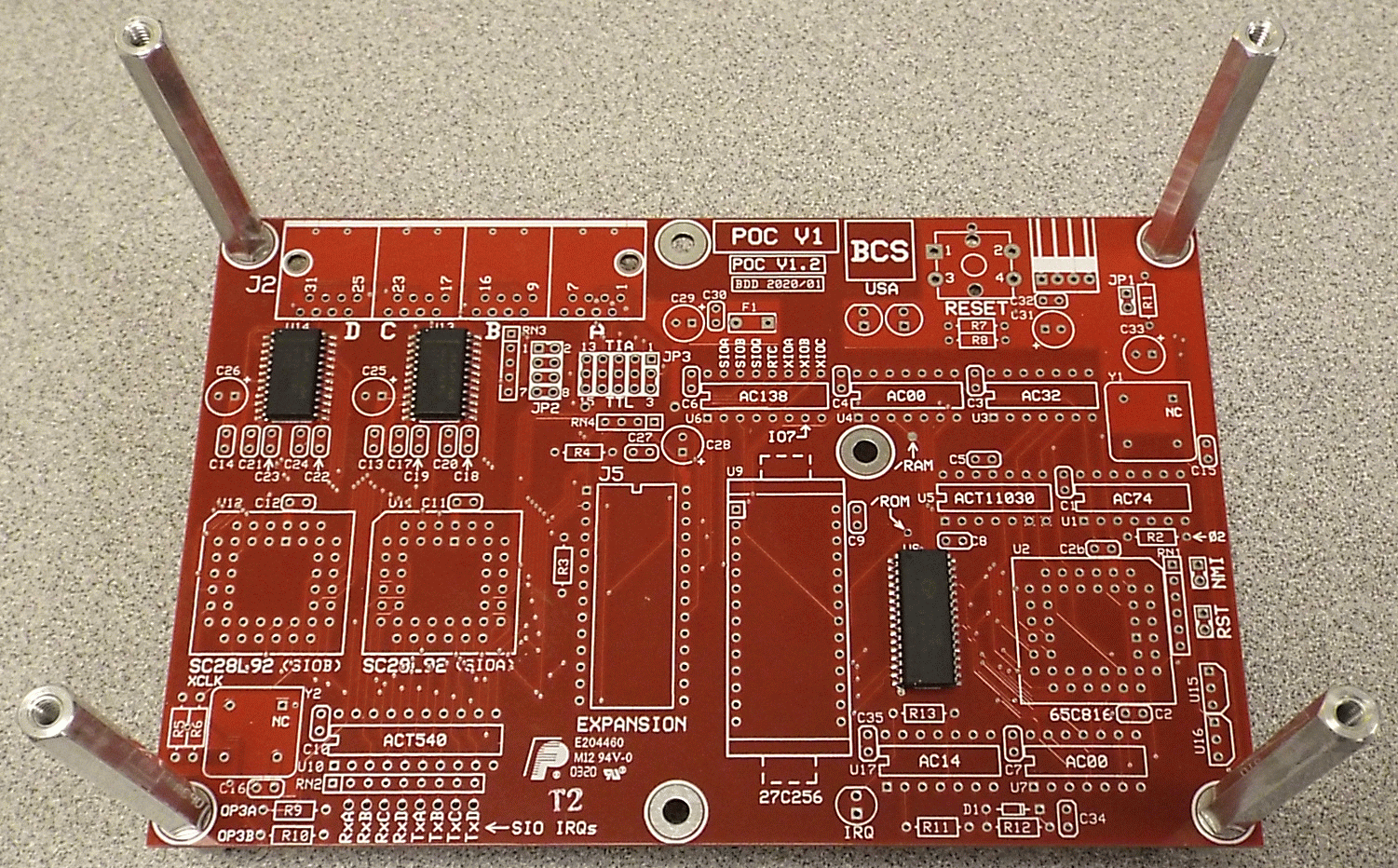

PCB w/SMT Devices Attached
Above, the PCB has the SMT hardware soldered. I mount boards on "legs" to facilitate assembly..

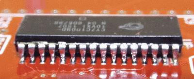

Close-Up of SRAM
Close-Up of SRAM
Above is a close-up of the SRAM, which is an SOJ32 package.

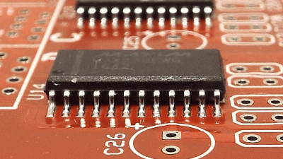

Close-Up of MAX238
Close-Up of MAX238
Above is a close-up of one of the MAX238 transceivers, which is an SOIC24 package.

Assembled Unit
Assembled Unit
Above is an overall view of POC V1.2. Immediately to the left of the power connector at the unit's top right corner is a reset push button. I got tired of shorting out jumper posts with a screwdriver to reset the unit. :D
Also, note the one chip at the middle of the right-hand side that is socketed. That is the Ø2 clock generator flip-flop. I made it removable so I can test some ideas about clock stretching, which will involve plugging a daughterboard into the socket. This, of course, assumes this thing actually works.

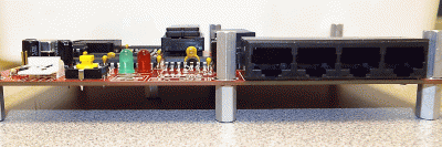

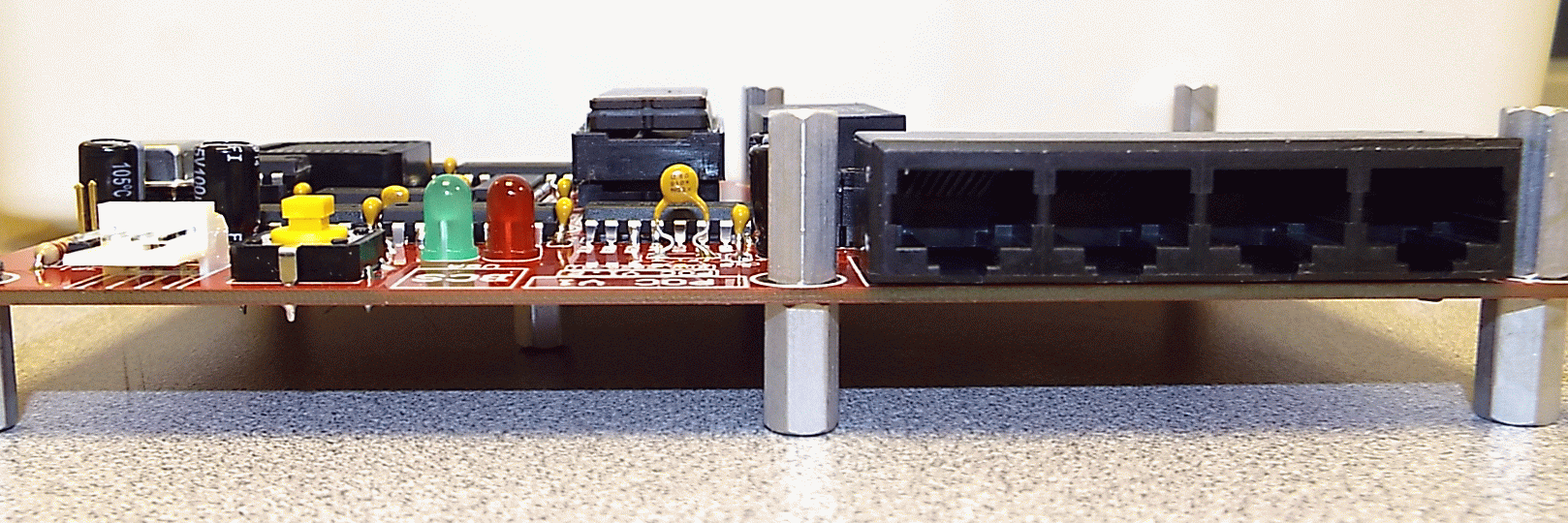

Assembled Unit Rear View
Above is a rear view of the unit, showing the four serial ports and the power connector.

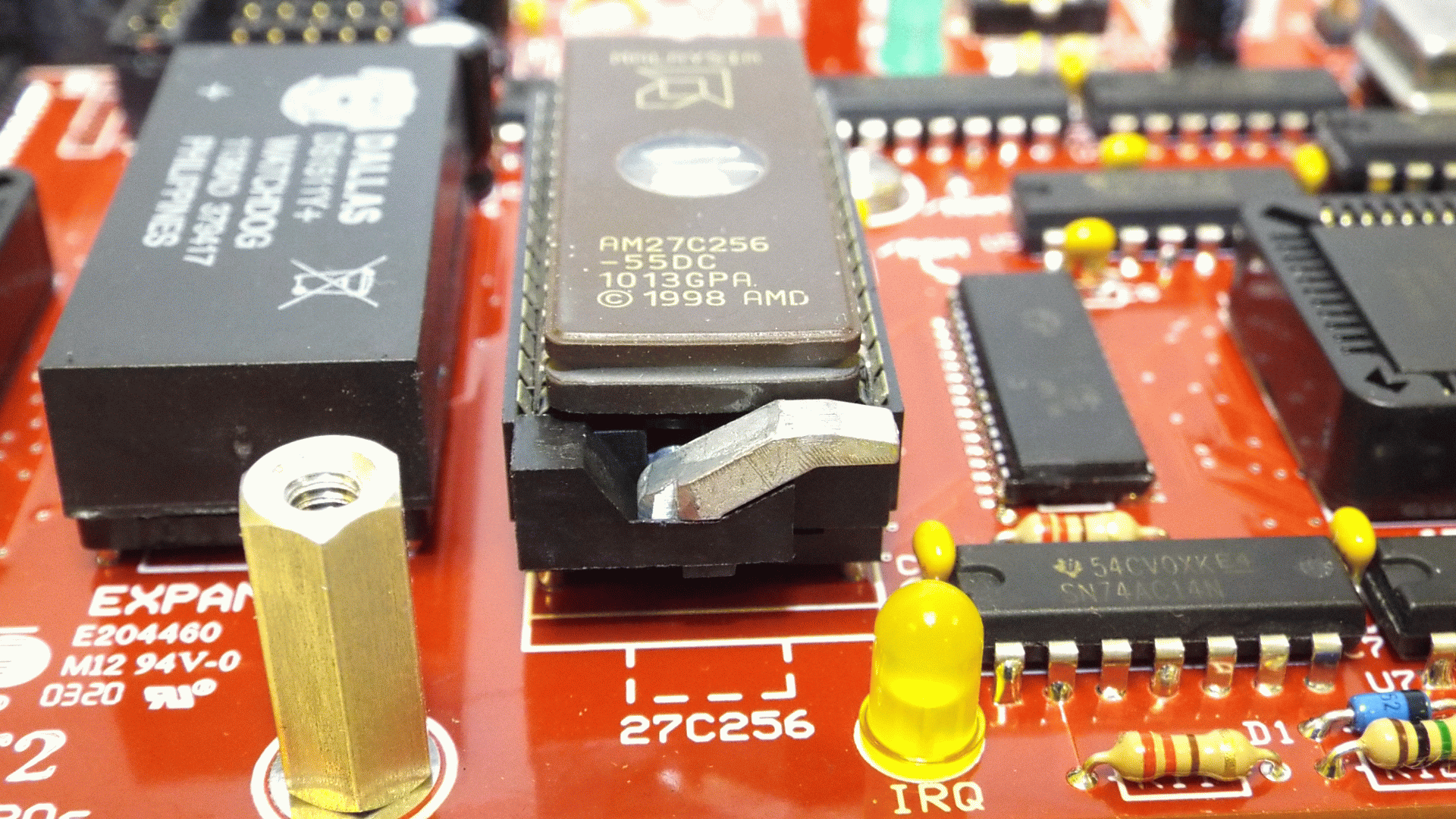

ROM ZIF Socket
ROM ZIF Socket
Above is a close-up of the ROM ZIF socket, which plugs into a standard DIP socket soldered into the board.
Next step will be to burn a ROM with some firmware and see if she goes or blows.
