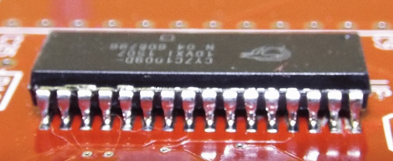

File comment: Close-Up of SRAM
Above is a close-up of the SRAM, which is an SOJ32 package.

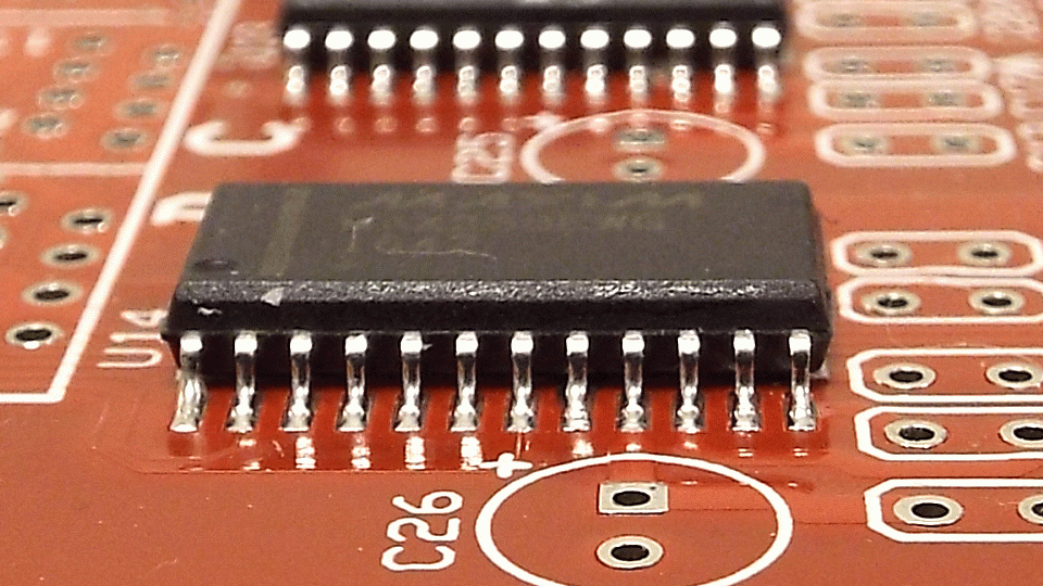

File comment: Close-Up of MAX238
Above is a close-up of one of the MAX238 transceivers, which is an SOIC24 package.
More photos in the next post.
