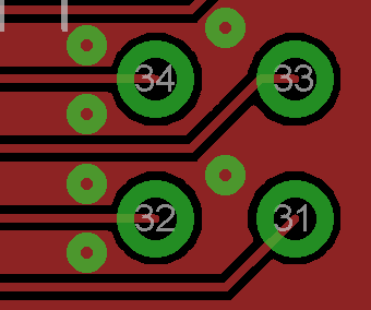

PostPosted: Tue Feb 05, 2019 10:03 am
In the 2nd part of the video Dave is showing the traces and the path of the return current. You can see that the ground "planes" don't actually extend between 2 neighboring pins of the DIP packages, even though you can see traces fit through there. If a trace fits, then the ground pour should also fit.
A simple way to improve this particular 2 layer design is to adjust the clearance parameter on the pours so that the ground planes will actually go between the pins. This is simple and free, and will probably get you a very decent improvement.
The defaults provided by the PCB design program may be too conservative for the capabilities of the PCB fab, so I would recommend first picking a manufacturer, find out what they offer in terms of clearance, track width, and drill sizes, and then use those settings in the PCB design program. Some manufacturers actually provide ready-made design rule files that can be imported in the program.
In addition to checking clearance and track width, it's worth it to take a good look at the pad size and drill diameter. Maybe the default drill and pad can be reduced a bit to fit more between. As an example, here's a screenshot of a 2 layer board (the 6502 sandbox) I did. It was designed for Eurocircuit design rules, as offered in their basic (lowest cost) option. As you can see, there's room for 3 wires between 2 pins @ 100 mil spacing, or, in this case, a single wire plus ground on either side.
Just a few hours of prep work here can save a lot of effort and performance later.

PostPosted: Mon Feb 18, 2019 12:10 am
Joined: Tue Mar 21, 2017 6:57 pm
Posts: 81
Well-spotted, dank je wel! We helped the pour algorithm a bit by manually running some dummy ground trace between pins. In a next spin I'll tweak with these settings, it makes so much more sense. I don't know if it will do much. There's a reason home computers came in faraday cages. Dave also makes a good point about the caps. I think at that point we can simply do a 4-layer board, but keep the 2-layer retro"look" with the pours as-is.
