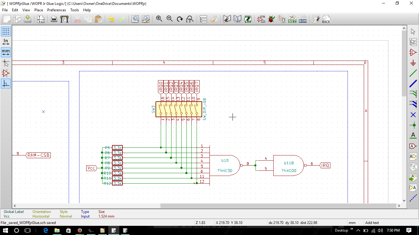

Here's my version with the 74HC30 Garth suggested. I also re-configured so that switches switch the IRQ lines, not the pullups as it did previously. That was a dumb mistake I only just now saw

If you want a DIP switch to cut off an interrupt, you need to put the switch in series with the IRQ\ line, not the pull-up. The way you show it, the IRQ\'s are still connected all the time, but if you remove the pull-up, the IRQ\ may go true full-time, which is the opposite of what you want.
Keep in mind that:
These things may or may not change your plans, but keep them in mind.
FETs have source, gate, and drain, no collector; but the term "open-collector" kind of remains from the TTL days. You'll also hear "open-drain." Either way, the idea is that a line is pulled to ground through a transistor when it's on, or left to float up when the transistor is turned off, whether it's a bipolar transistor, or any of the kinds of field-effect transistors. The effect is the same.
Keep in mind that:
- An I/O IC will not generate any interrupts at all if it's not set up to. You may only have one or two ICs generating any interrupts at all.
- Any given I/O IC might have quite a few interrupt sources in it, and you might only have one source in the whole IC enabled. Not a lot.
- However, if you do have multiple sources within a given IC enabled at once, a switch will cut them all off together, not allowing "line-item veto" so to speak. Depending on what the sources are though, you might also be able to stop one source or another from generating interrupts by removing the input that's causing them, for example by unplugging a peripheral that's causing interrupt-on-change, or sending data, etc..

I you look at my most recent schematic, I thought I fixed the switch placement problem.
I realize chips sharing a line will be switched as a group. Realistically, 8 lines seems like overkill for my plans, so in practice, I'm confident that none will have to share.

Re: Dan's 6502 build, aka, The WOPR Jr.
Yes, my apologies. I guess I forgot to click on the diagram to enlarge it, and just assumed the top was Vcc (or VDD) so you were switching the pull-up resistors rather than the IRQ\ lines.

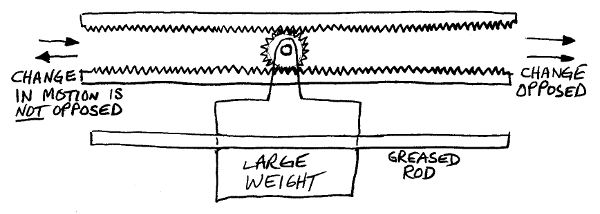

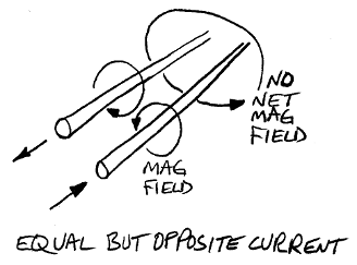

It has to do with inductance, quite different from what goes on in audio circuits which are comparatively high-impedance and low-frequency. Imagine a pulse going out a signal line, and its ground return current going the opposite direction two inches away because all the ground pins are clustered together at one end of the connector instead of being distributed. Suppose the load is three inches away. Now you have kind of like a single-turn coil, two inches wide and three inches long. That inductance is unwanted, and makes it take longer to charge up the input capacitances of the loads, and, along with the capacitance, forms resonant circuits that can ring badly, such that clean square waves become sloppy and their ringing following each intended rising and falling edge may cause unwanted multiple triggering or false inputs, or, less likely, even damage. If you put the ground return current really close to the signal line, it's like reducing the width of that coil so it is very small, and the total inductance drops way down.
But if the ground return connection is far away, an unwanted opposite reaction voltage will be induced in nearby signal lines instead.
I'll avoid getting into transmission lines just yet. It is interesting however that if you have, let's say, a place where the ground return current can return to the transmitting IC 2" away and one 0.2" away, the return current will take the closer one, because of mutual inductance. Unlike the other inductance, mutual inductance here is your friend. Consider this illustration:
Current in one conductor builds up a magnetic field around it, and a change in that field is opposed, and there's a pushback, which is exerted on the adjacent conductor as well. If that conductor can allow an equal change in the opposite direction, the pushback collapses, and it's easier to get good signal integrity. In fact, if you put the pair through a ferrite bead or core of some kind to concentrate the flux lines, that core can handle practically a limitless amount of current without saturating, assuming there's no common-mode current. In mechanical terms, I like to think of it this way:
The large weight slides freely on a greased rod; but it has a lot of inertia. If the two racks accelerate equally in opposite directions, you don't have to accelerate or decelerate the weight. But if the two racks accelerate or decelerate in the same direction, that change is opposed, because the large weight wants to maintain whatever state of motion it is in.
Similarly, if you have a PC board with a true ground plane, a signal trace's ground-return current will not take the shortest path back, but instead will flow directly under the trace, taking on the shape of the trace. For this to happen though, there cannot be any interruptions in the ground plane—which is why ground pours do not qualify, since they are not continuous. In audio circuits, the coupling between adjacent wires is by electric field, caused by voltages. In RF and high-speed digital circuits, they're by magnetic field, caused by currents. There is a way to use pours to supplement real planes; but if they're not done correctly, they can actually make things worse, according to experts in the field like Rick Hartley, Eric Bogatin, and Suzie Web whose lectures you can see on Altium's YouTube channel.
