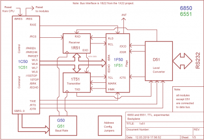

But when trying to build an UART which supports different baud rates, parity,
variable word length and things like one and a half stop bits...
while trying to be "compatible" to an existing chip...
unfortunately is a much more complicated things to do.
For instance, consider to have three different clock domains in your design: CPU, RX, TX.
There are two different approaches to this:
1) you could try to synchronize the RX and the TX clock to the CPU clock.
Downside is, that this gives you a jitter in RX\TX which might be tolerable at low baud rates and a high CPU clock...
unfortunately, somebody might want to debug a CPU running at a low CPU clock frequency at a high baud rate.
2) you could try to synchronize Data and control signals between these three different clock domains,
what would bloat/complicate the circuitry a lot.
Unfortunately, I had voted for 2), and that's where the project had failed:
the more I had tinkered with the innards of the RX module, the less it worked.
Well, my TTL 6545 was sort of the "Klendathu edition": plenty of bugs at a considerable size.
For the TTL 6850\6551 project, bugs play in a different class of weigth... while being "nuclear powered".

Here we go:
X50, experimental TTL implementation of a 6850, FAILED (that's why I had reversed the colors of the picture)
For "6850", plugged into the 1X51 backplane, we have:
1* 1C50, control module
1* 2F50, flag and status module
1* 2R51, receiver module
1* 2T51, transmitter module
1* G50, baud rate generator module
1* D51, RS232 level converter module
X51, experimental TTL implementation of a 6551, FAILED (that's why I had reversed the colors of the picture)
For "6551" plugged into the 1X51 backplane, we have:
1* 1C51, control module
1* 2F51, flag and status module
1* G51, baud rate generator module
What had failed, was the RX part (we later are getting to it), and the rest of the circuitry mainly was/is untested.
Noticed something ?
For economical reasons, the TTL 6850 and the TTL 6551 project both had used these modules:
1* 1X51 backplane
1* 2R51, receiver module //FAILED

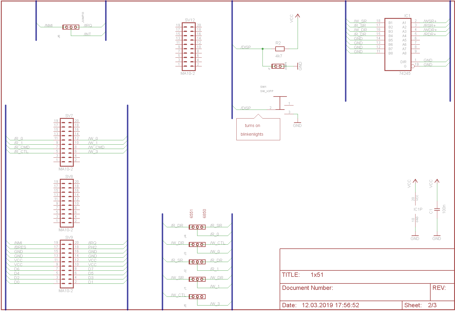

PostPosted: Tue Apr 09, 2019 3:25 pm
Posts: 1431
1X51 Backplane:

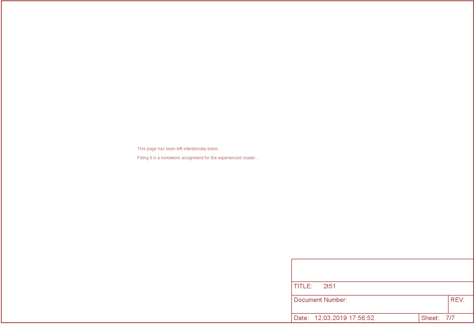

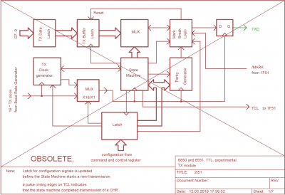

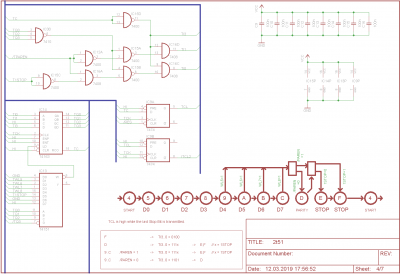

2T51 transmitter module:
If just looking at these schematics already gives you a headache... welcome to the club.

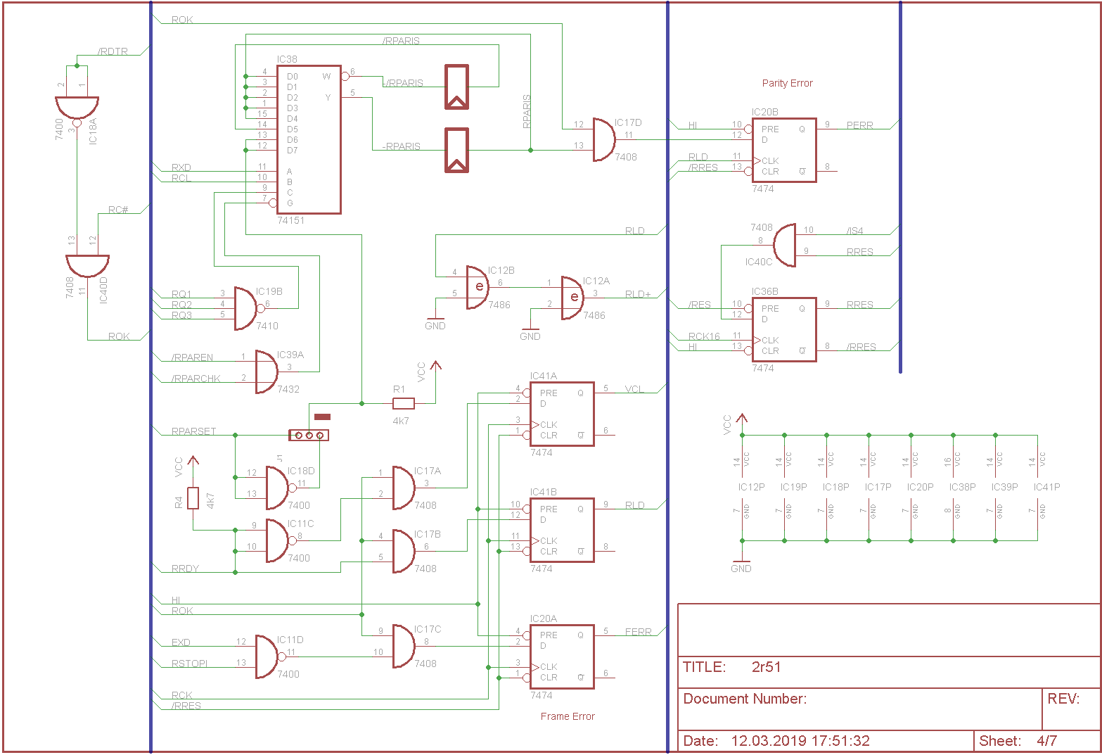

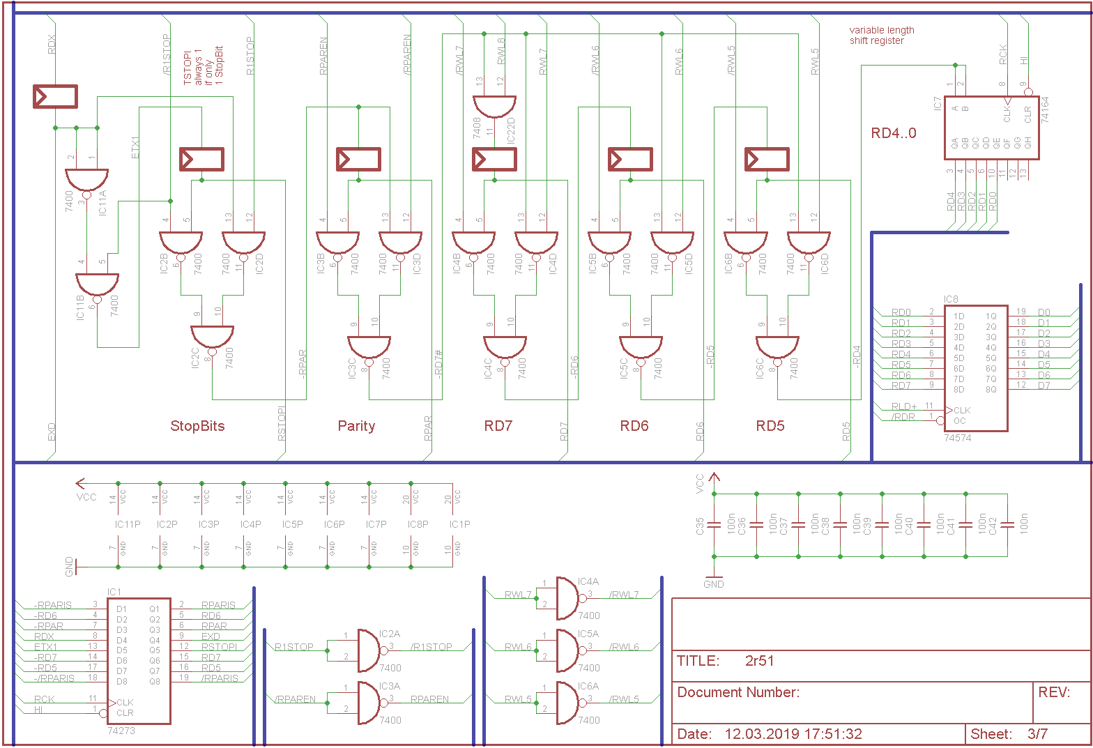

PostPosted: Tue Apr 09, 2019 3:37 pm
Posts: 1431

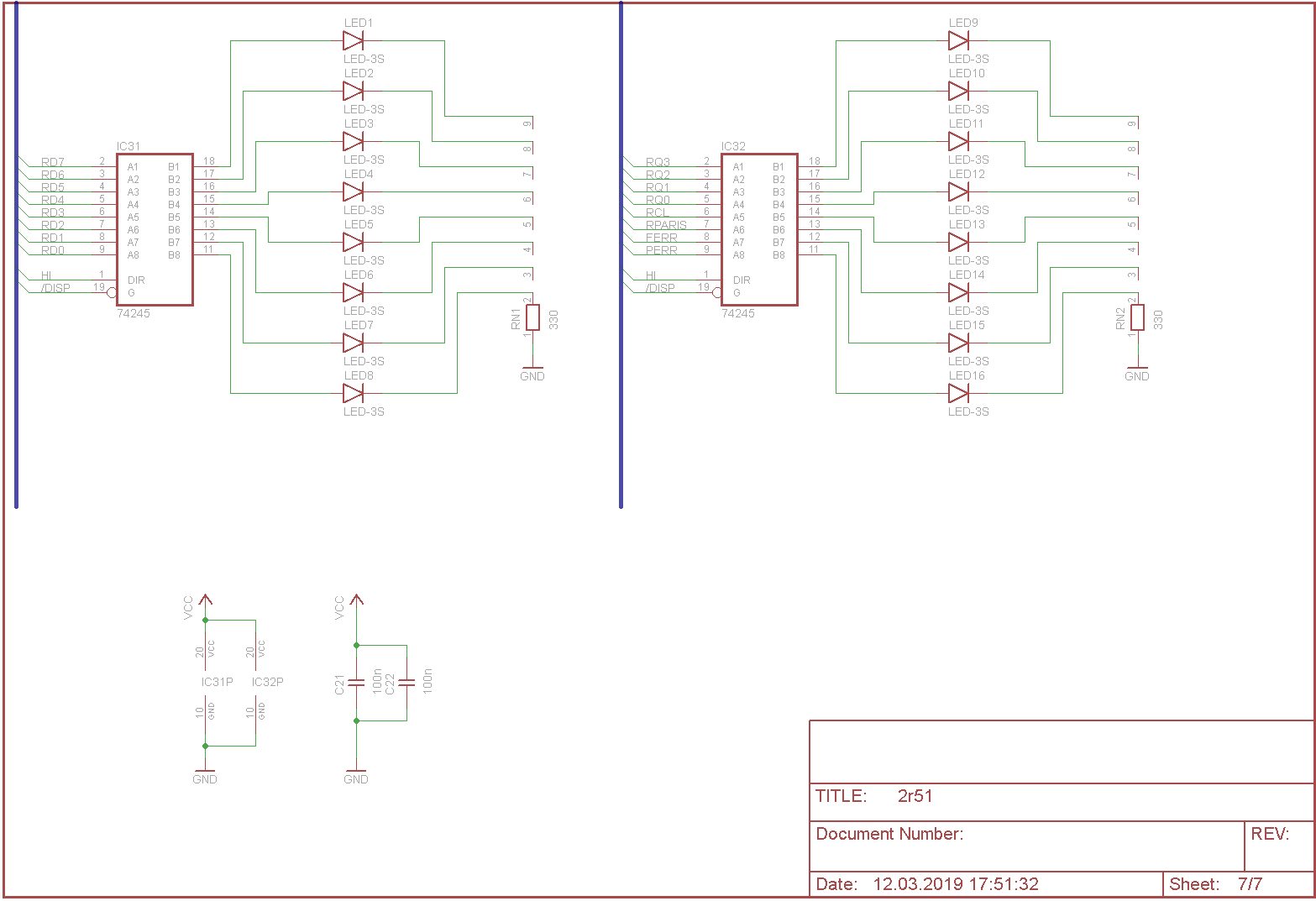

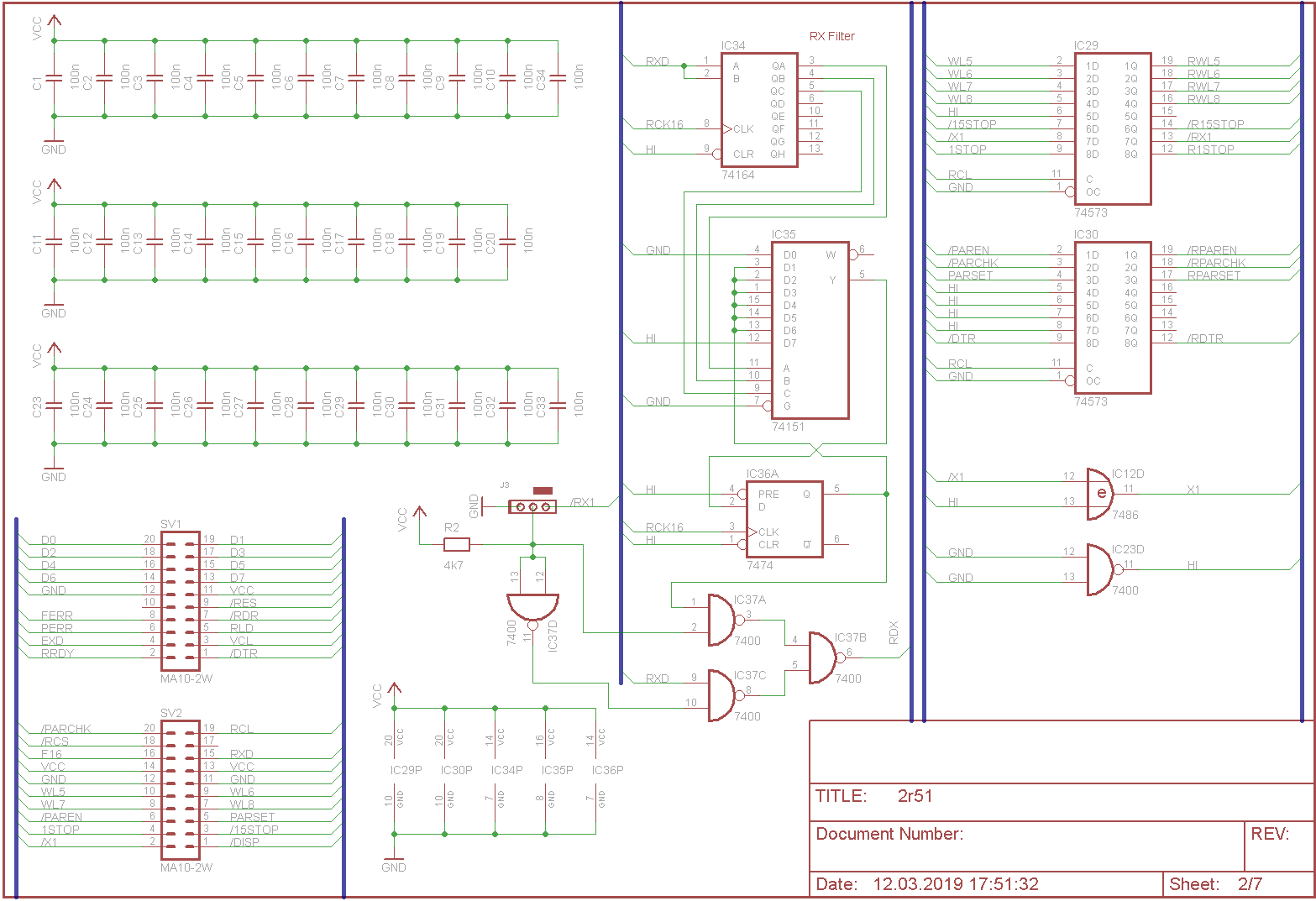

It stubbornly had refused to work.
And the more I had tinkered with its circuitry, the less it worked.
(The '2' at the start of 2R51 is the hardware revision. No digit means first revision.)
When trying to build a TTL RX module, PLEASE consider taking a different approach.
Also, that variable length RX shift register isn't a beauty, consider taking a look at the 74259 bit addressable latch, too.

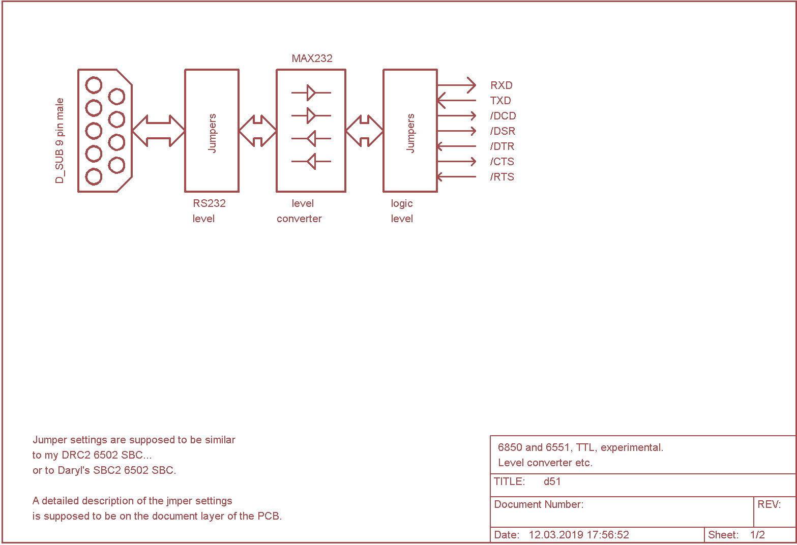

//Configuration jumpers are "borrowed" from Daryl Rictor's SBC-2.
//Daryl, thanks for making the SBC-2 schematics available to the public.

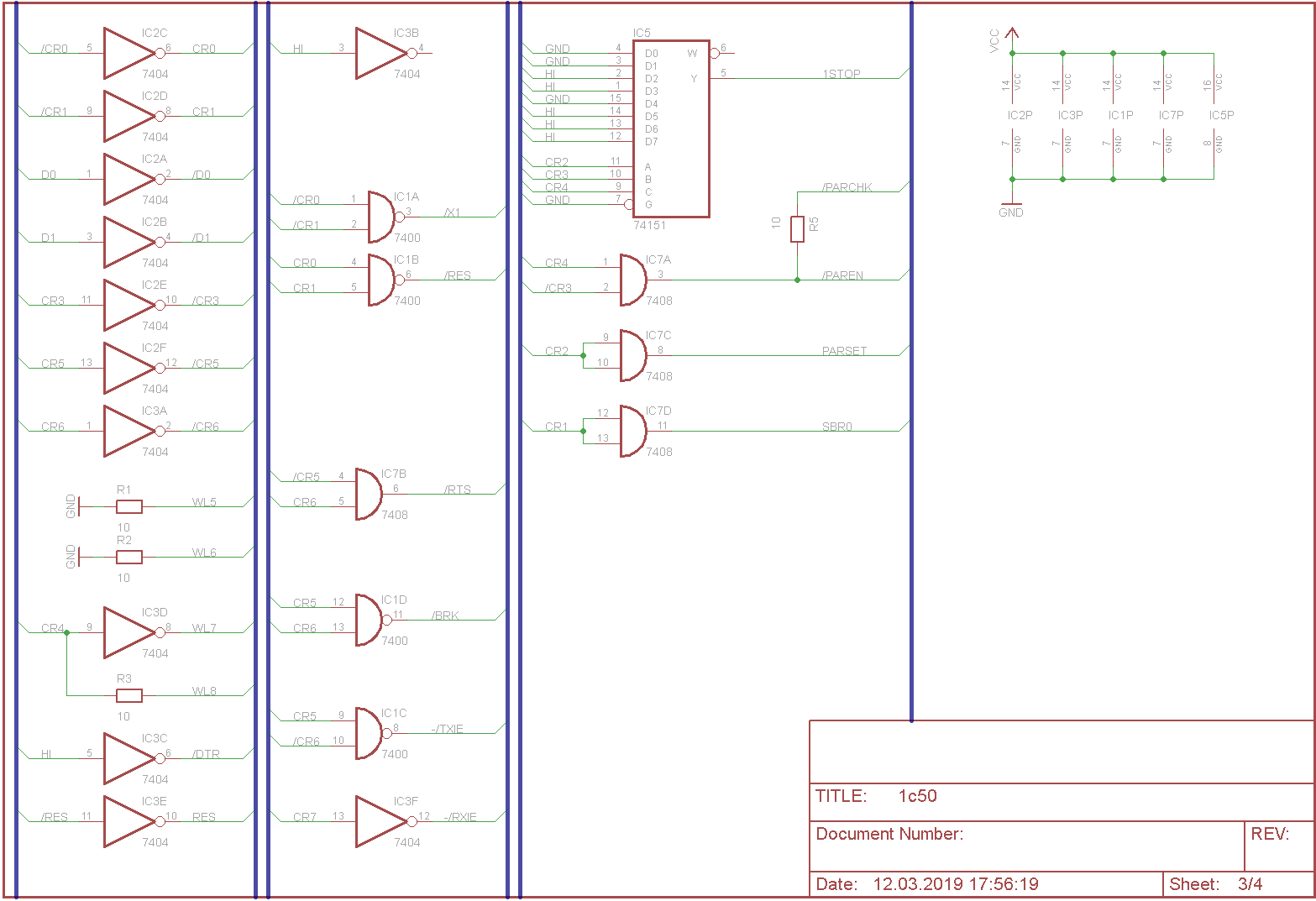

1C50, control module, TTL 6850 only:

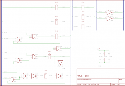

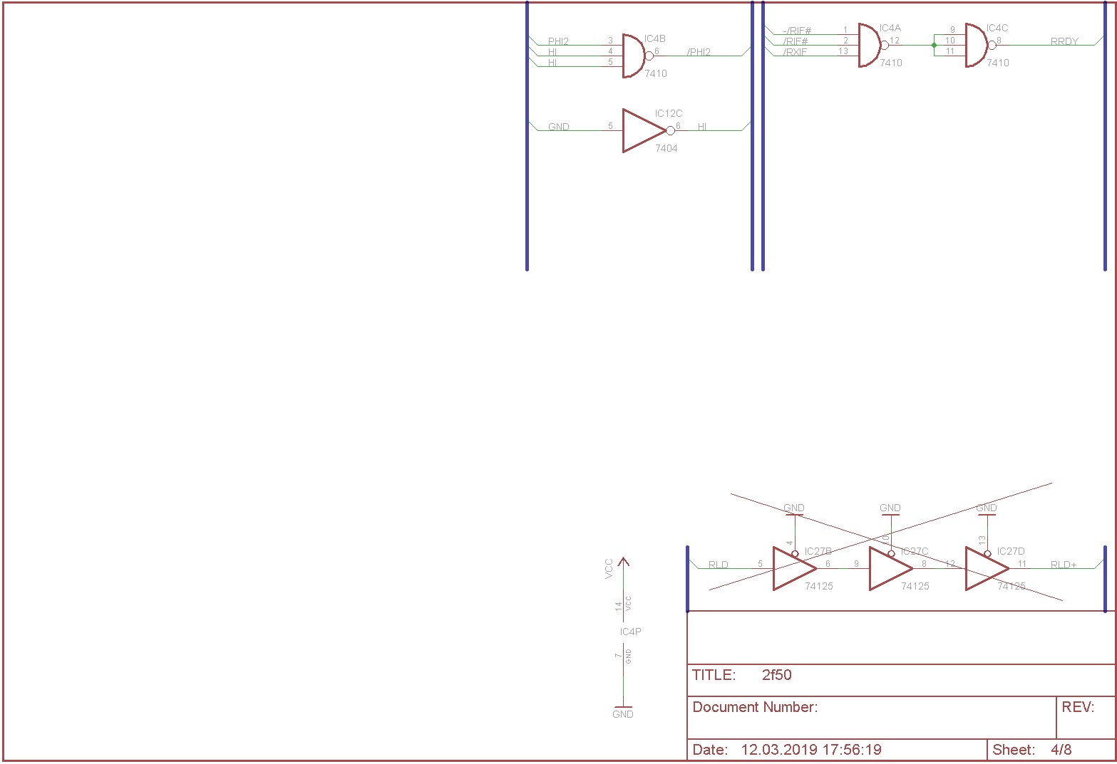

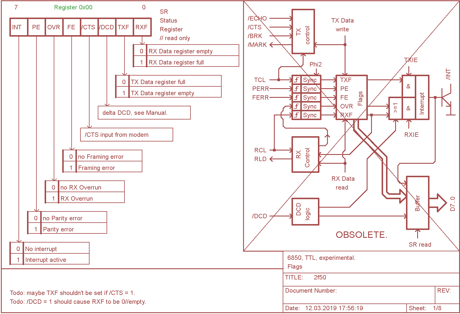

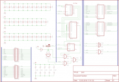

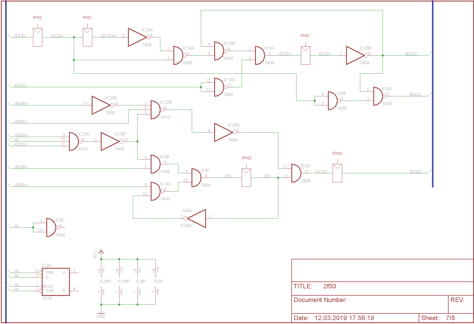

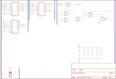

2F50, flag and status module, TTL 6850 only:

PostPosted: Tue Apr 09, 2019 3:51 pm

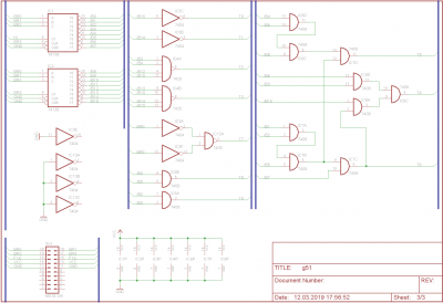

G51 baud rate generator module, TTL 6551 only:
Edit: the 100nF capacitors are hidden below the IC sockets.

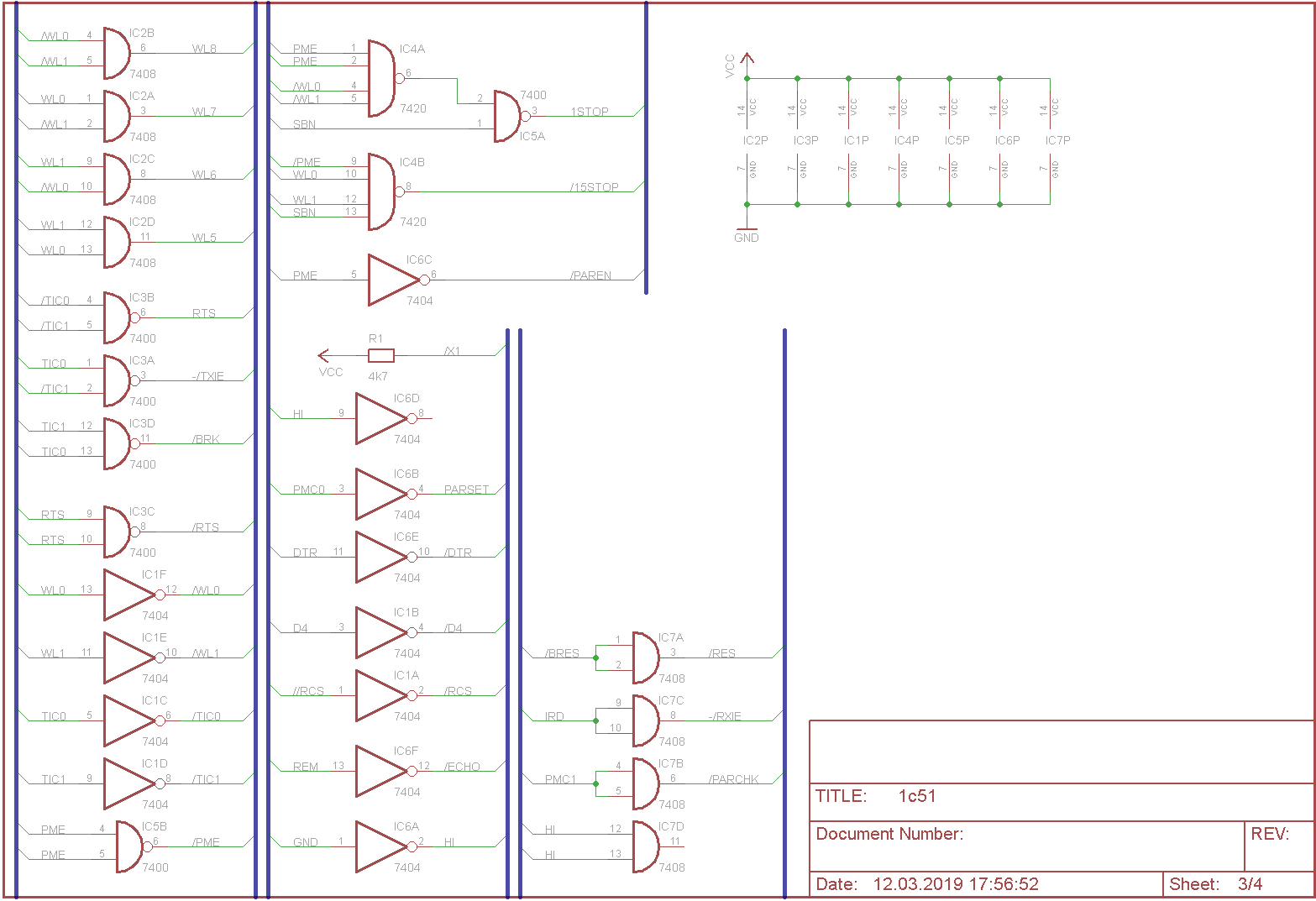

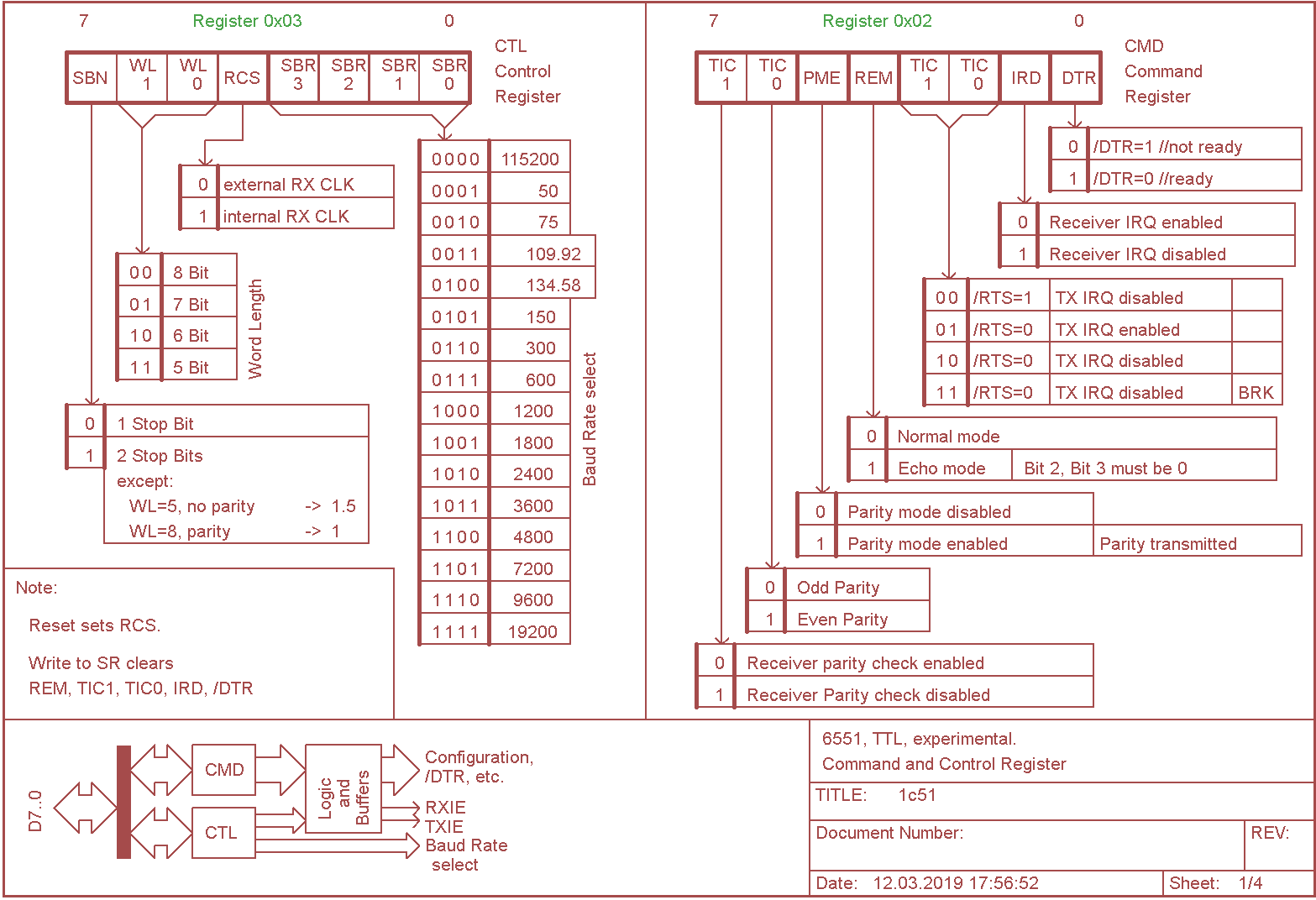

1C51, control module, TTL 6551 only:

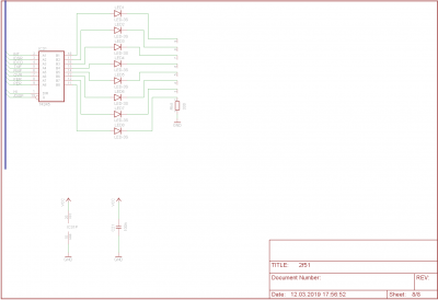

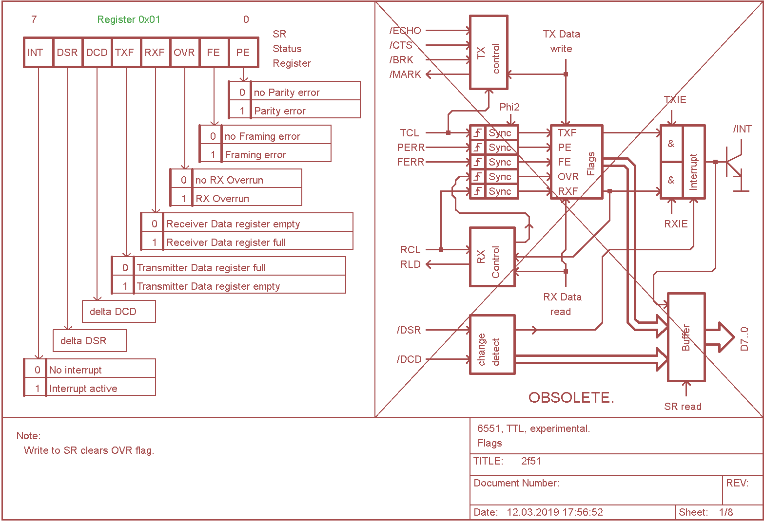

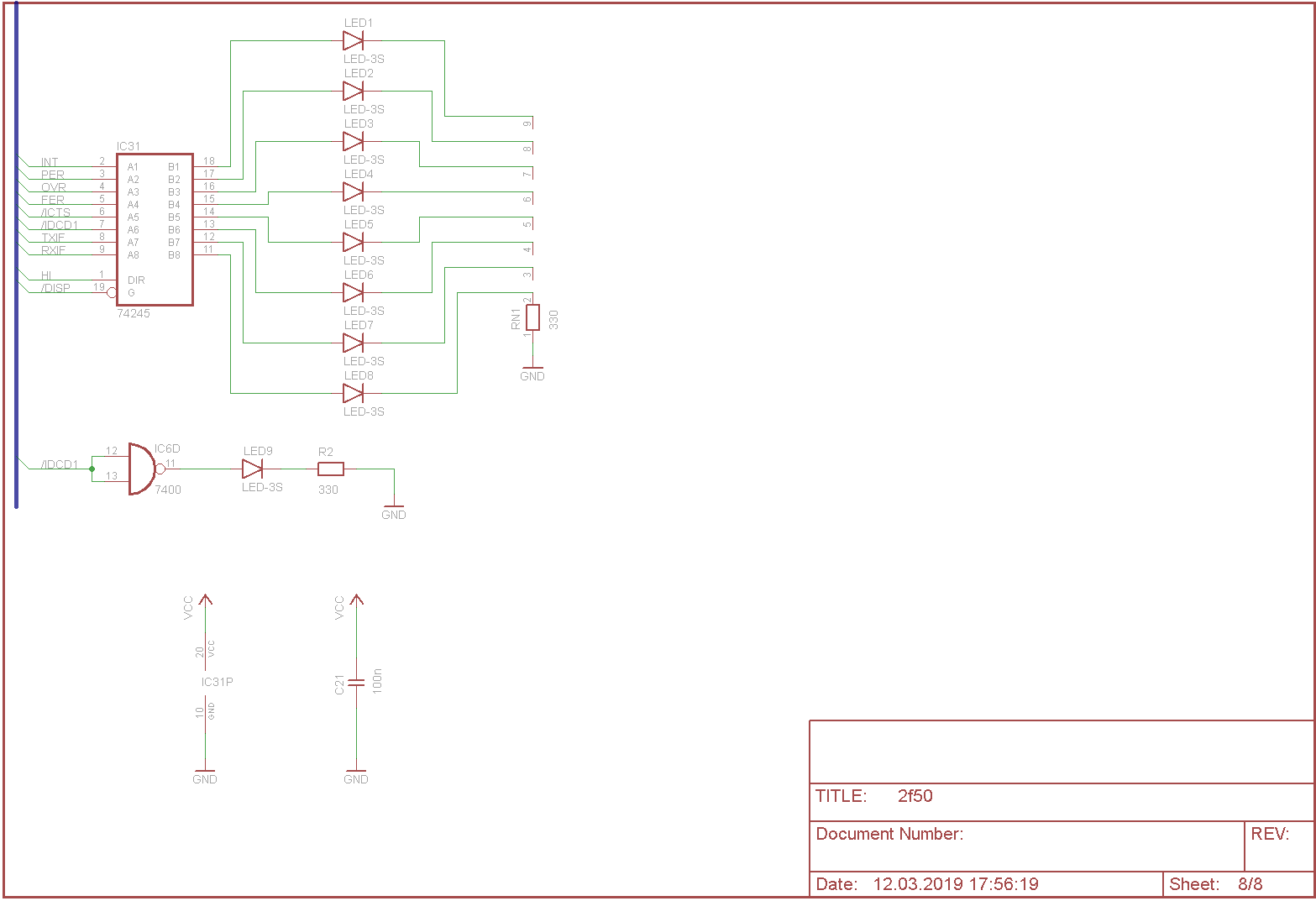

Posts: 1431

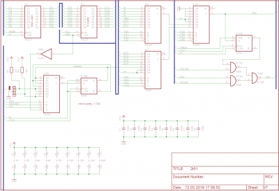

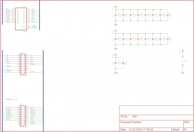

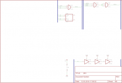

2F51, flag and status module, TTL 6551 only:
...and with this, I think the complete set of schematics for my TTL 65XX peripheral experiments now went through.
