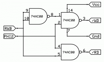

Welcome, creoguy! We'd enjoy seeing some photos of your project if you have any. Also they may prove helpful. (No need to use a third-party image hosting site, BTW -- on this forum you can attach images with your posts.)
Although you might find that this...
... alternative setup suggested by Hoglet and BDD works better, that's not to say your existing arrangement is incorrect -- it's not (as Garth points out later in the linked thread). That may seem paradoxical, but there are a lot of things that can cause funny behavior, and sometimes (especially when you're stuck) it's good to rock the boat -- to try something else. (There'll be some inadvertent changes along with those which are intentional.) I'm not convinced we're at that point yet, but anything that results in a happy outcome is fine with me. :)

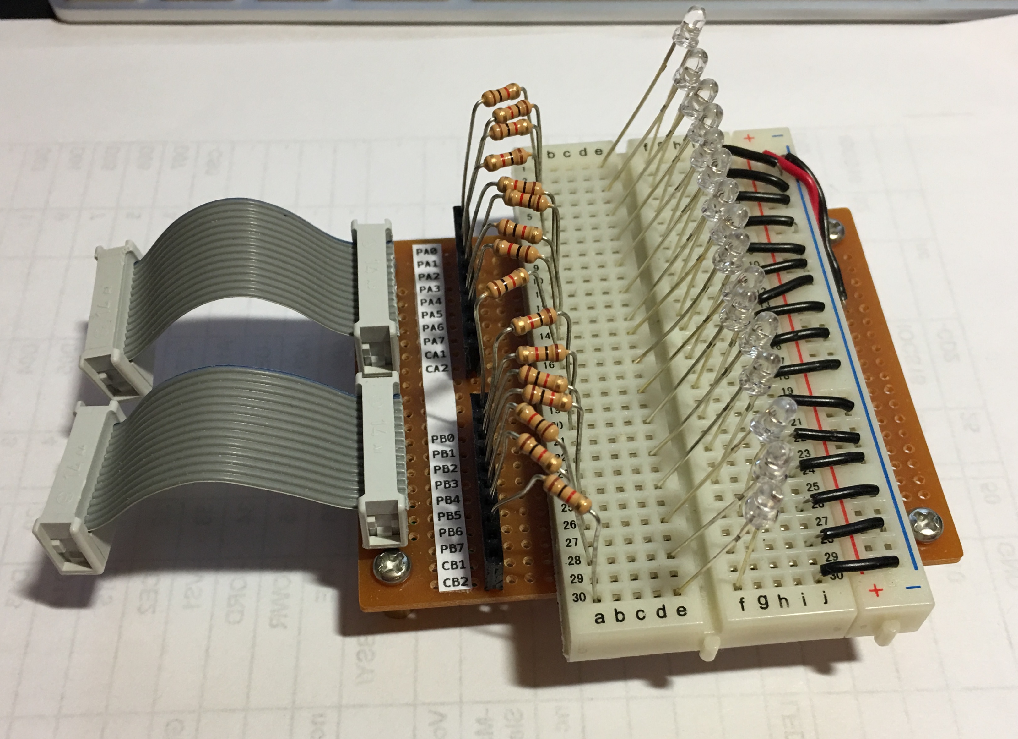

File comment: VIA output breakout breadboard

After verifying all that I assembled the OS (EhBASIC 2.22) and enter in the normal Hello World test, but I can't get it to actually run anything. With "10 PRINT "HELLO WORLD", I get the follow message, "Type mismatch Error in line 10" when I attempt to run it. With "PRINT 1 + 1" the unit locks up and I have to reset.
Any suggestions on what to check next?
It's still possible you have a hardware error (construction related, I mean -- not the schematic per se). But what I notice is that chrisabird's test code works with chrisabird's hardware design but EH Basic doesn't. Have you got EH Basic configured so it uses the same I/O addresses as the test code? That's one thing that needs to be checked. (Also I'm curious -- how extensive is that test code? Can you describe it?)
From the schematic I see $5000-5FFF is filled with images of the ACIA register set, and $6000-6FFF is filled with images of the VIA register set. (The waste of so many addresses is harmless.) But addresses in the range $7000-7FFF cause both the VIA and ACIA to respond. If EHBasic is trying to use those addresses then the results are unlikely to be good! :wink:
