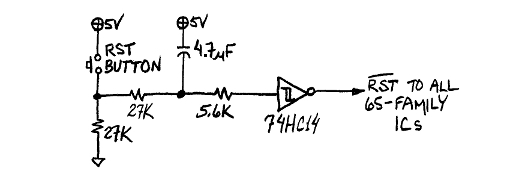

I agree HC logic is a better choice. BTW you can easily avoid the need for a 555 or DS1813 if you have an extra 74_132 section available. Here's a circuit from Garth's 6502 Primer (which is recommended reading, BTW). To replace the 'hc14 with 'hc132 just tie its two inputs together, or tie one of them high.

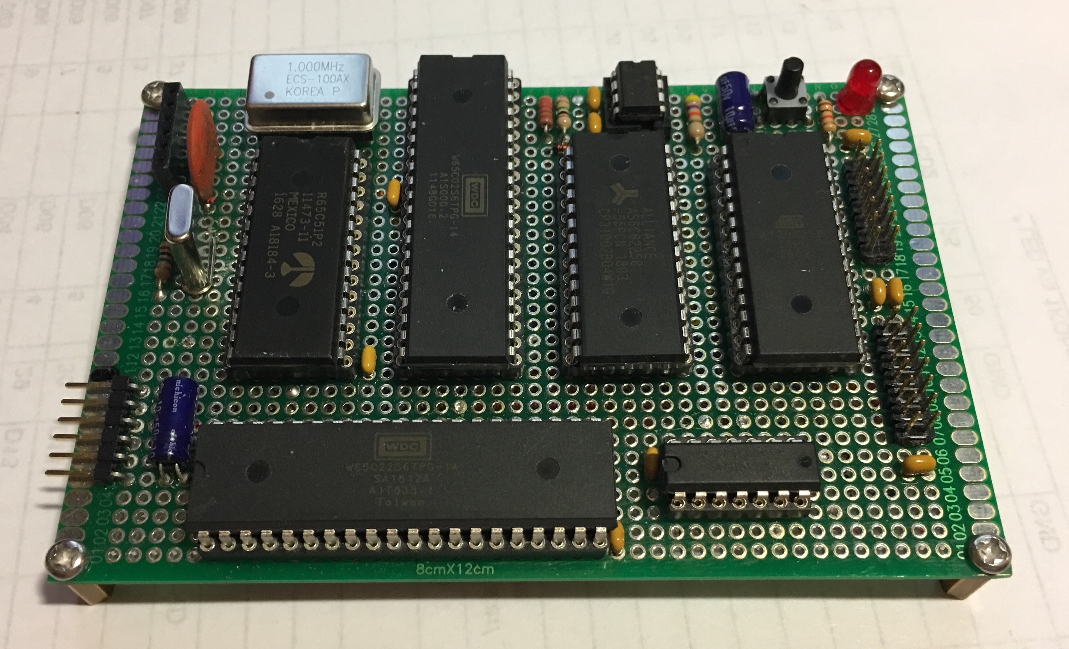

I've been powering it directly from the 5v FTDI cable that I'm using for communication with my computer. I've also tested it out with a 5v 2.5A cellphone supply that I modified with the same result. I have gone through Garth's primer, that is where I got the circuit for the 555 RST and also the setup for the VIA PA and PB output headers. I have bypass cap for all IC's as well. The 74HC00 came in the mail today, so I'll test it out later this evening and see if that make any difference before I start rewiring stuff.
File comment: 6502 SBC

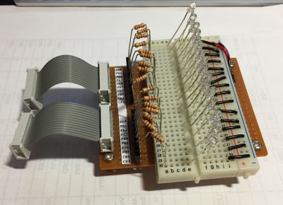

File comment: VIA output breakout breadboard
PostPosted: Sat Jun 23, 2018 2:35 am
Nice looking project! :)

After verifying all that I assembled the OS (EhBASIC 2.22) and enter in the normal Hello World test, but I can't get it to actually run anything. With "10 PRINT "HELLO WORLD", I get the follow message, "Type mismatch Error in line 10" when I attempt to run it. With "PRINT 1 + 1" the unit locks up and I have to reset.
