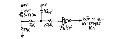

I agree HC logic is a better choice. BTW you can easily avoid the need for a 555 or DS1813 if you have an extra 74_132 section available. Here's a circuit from Garth's 6502 Primer (which is recommended reading, BTW). To replace the 'hc14 with 'hc132 just tie its two inputs together, or tie one of them high.
