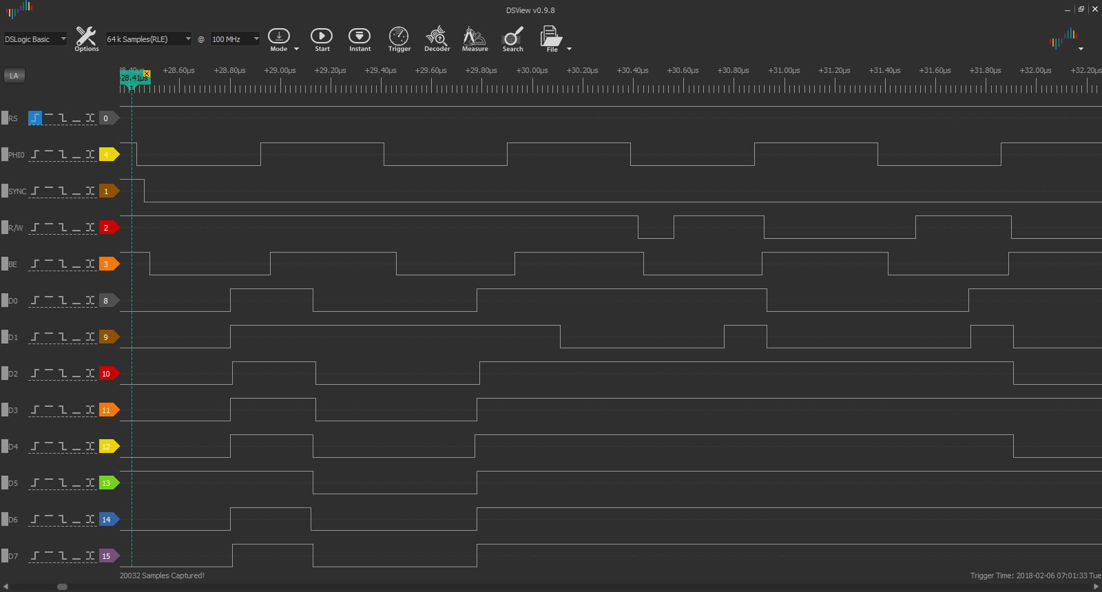

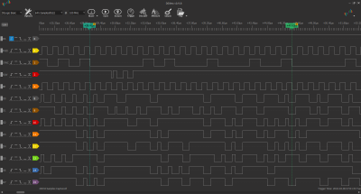

Just had enough time for a quick capture ...
It's easy to see the effect BE (AEC) has, causing some odd behavior in signals in various places as the bus is exchanged between the CPU and VIC. The first cursor in the capture marks the end of the SYNC cycle of the JSR $FD02. The second is at the RTS that follows. It seems the CPU is NOT making it back (good instincts Dieter :)). The value written to the stack appears to be $FCE9, which would be correct. But the RTS reads back $48FF ?? -- not good.
As a reminder, here is the code being executed:

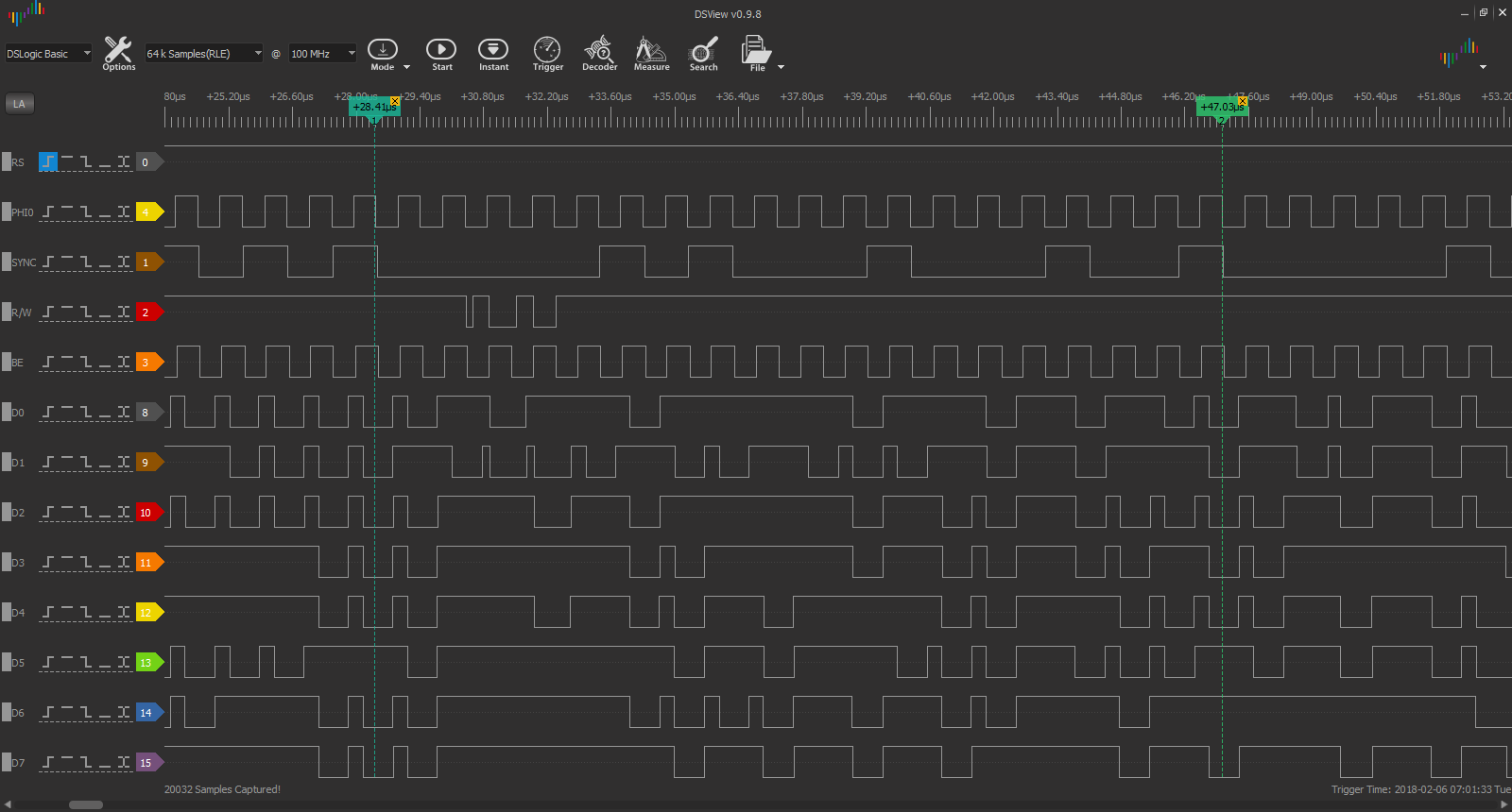

R/W sure looks a little strange on the first write cycle of JSR. It's going low early in Phi1 and it appears that the VIC chip is driving it high again when it takes the bus. Then the CPU takes it back low when it gets the bus back. Not sure what's going on there but it might not be benign. Here is a closer look at the write cycles (for reference, we're sampling at 100MHz):
Alright, gotta run ... :)

That R/W glitch to LOW starting at ca. +30.40us looks odd.
IMHO it looks like OurCPU changes its outputs (including R/W) faster after the falling edge of PHI2 than the 6510 does.
So OurCPU strobes R/W to GND for a short moment after the falling edge of PHI0 before BE (AEC) takes effect.
R/W then goes back to HIGH because of bus line capacitance versus R51, a 1k5 pullup resistor to +5V in the C64.
R51 is in the south west corner of page 2 of the C64 schematics.
But that R/W glitch doesn't explain why RTS is reading garbage.
Feels like something odd happens on the address bus at the falling edge of PHI0, too.
Edit: 'something odd' from "the point of view" of the 4164 DRAMs maybe.

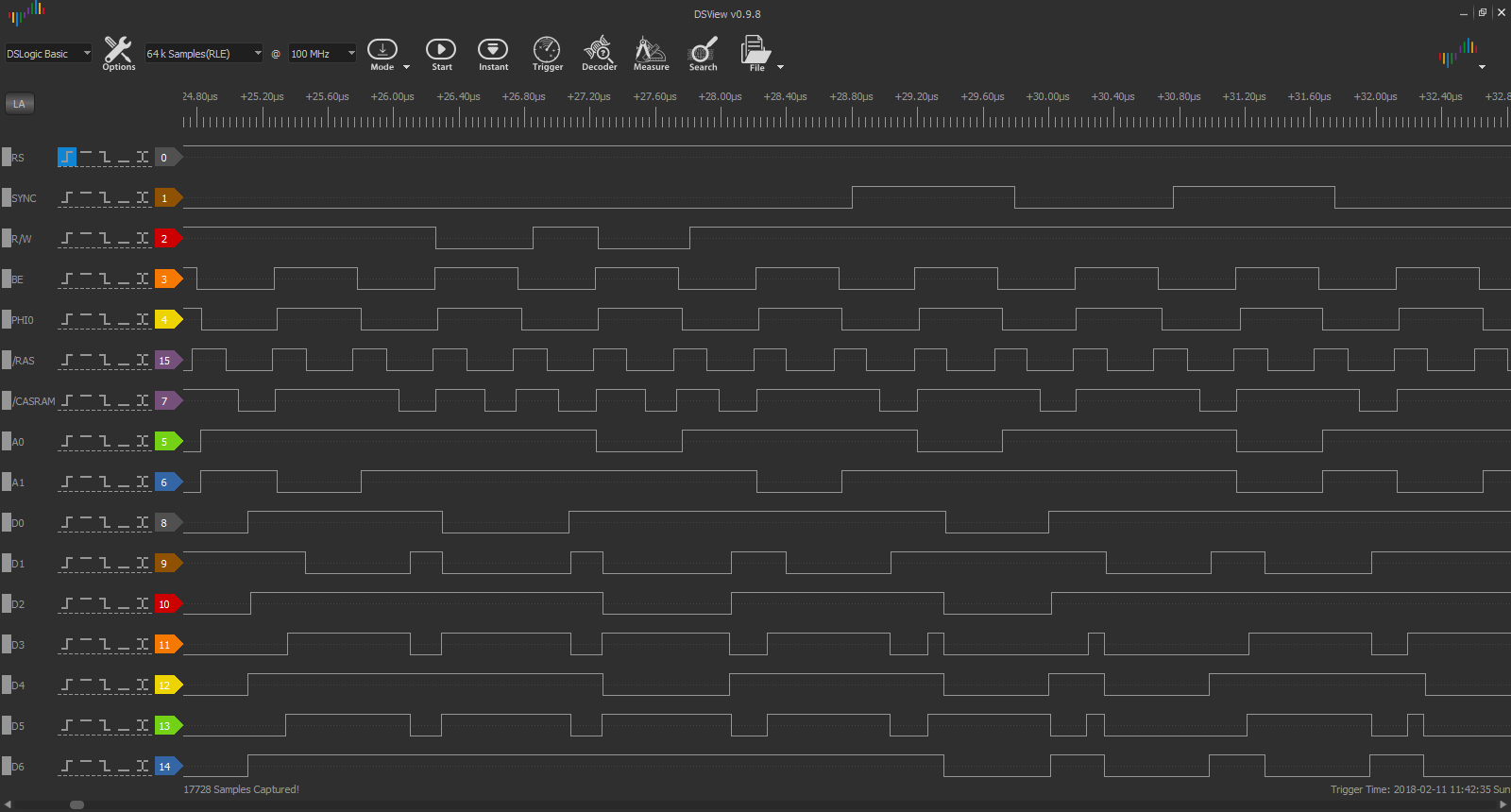

Certainly there is some movement there triggered by BE (AEC).
I had a peek at the C64 schematics. R/W goes directly to /WE for RAM, without being qualified. I don't know how dynamic RAM works, but according to this datasheet, the write cycle can be controlled by either /WE or /CAS. I am assuming it must be /CAS on the C64 since R/W is unqualified. Maybe a capture showing /CAS will clarify the timing?

IIRC the DRAM write cycle is controlled by /CAS, /CASRAM from pin 18 of the address decoder PLA that is.
Those glitches on the address lines pretty much are looking like that glitch in the R/W signal,
and I take this as a sign that OurCPU changes the address lines too fast after the falling edge of PHI0
before AEC takes effect. And I think this might be a bit "confusing" to those DRAMs.
Ok, forget tinkering with the AEC signal, try delaying the PHI0 input of OurCPU instead... maybe by 50ns or so.

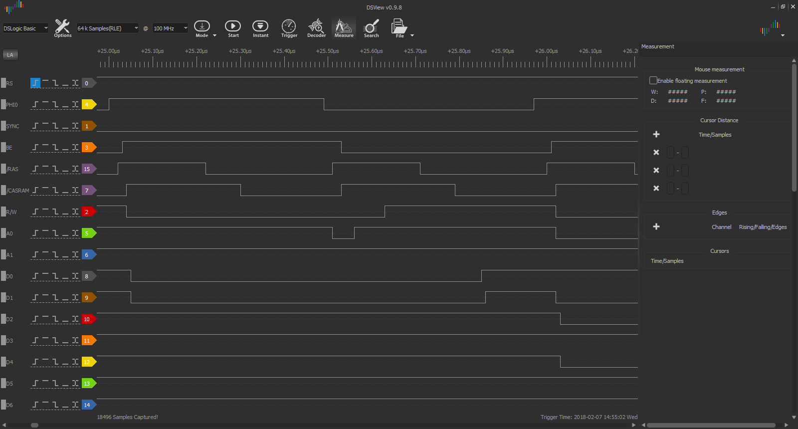

Had some time for a closer look. From the 4164 DRAM datasheet:
Address (A0 through A7)
Sixteen address bits are required to decode 1 of 65,536 storage cell locations. Eight row−address
bits are set up on pins A0 through A7 and latched onto the chip by the row−address strobe (RAS).
Then the eight column−address bits are set up on pins A0 through A7 and latched onto the chip by
the column−address strobe (CAS).
All addresses must be stable on or before the falling edges of RAS
and CAS. RAS is similar to a chip enable in that it activates the sense amplifiers as well as the row

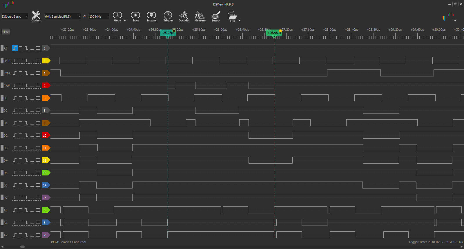

decoder. CAS is used as a chip select activating the column decoder and the input and output buffers.
Not sure I have this right, but it appears that the DRAMs have latches internally and capture the row and column addresses on the falling edge of /RAS and /CAS respectively. On my C64, the DRAMs are HM4864-3 ICs.
hm4864p-3 DRAM (C64).pdf [335.07 KiB]
Downloaded 162 times
For these DRAMs, the Row Address Hold Time (tRAH) is 25ns and the Column Address Hold Time (tCAH) is 55ns. The setup times don't seem to be an issue, so it seems everything should work if we meet the hold times. Here is a capture showing a relevant write-cycle:
The "glitch" on A0 is clearly evident, but it happens over 200ns after /CASRAM has gone low, and presumably also after both row and column addresses have been safely latched.
I agree that absent the internal latches, the timing is a problem (and of course, we do have a problem since the machine won't boot!). The glitch on A0 is clearly triggered by things happening "too fast" after the fall of PHI2 (btw, who knew "too fast" would turn out to be an issue!). If the address lines have to remain stable until /CAS rises, then for sure the glitch will "confuse" the DRAMs. Delaying PHI0 is a clever solution in that case (which would have never occurred to me!). Your estimate of 50ns for that delay seems about right based on the LA capture.
Of course, delaying PHI0 also means that the data to be read from the CPU has to be stable for a longer time
on the data bus, but I think for using the CPU in a C64 this won't be too critical.
Looks safe, but at the moment those glitches are the only hint we seem to have.
Timing in a C64 is a bit tricky, and if something is too slow or too fast the C64 won't be running stable.

I agree. The above capture shows that the data lines remain unchanged for quite some time after the fall of PHI2.
There should be plenty of time to grab the data on a read even with a delayed input clock.
I think that the problem is more related to the address bus than to the data bus.

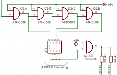

A nicer approach would be building a delay chain from 74AC (74ACT ?) logic and to tap into it by using DIP switches.
Here a picture from the schematics of Dennis Kuschel's MyCPU:
Would work with 74245 instead of 7408, too.

I spent some time tinkering with resistor values to delay the input clock to the CPU -- with mixed results.
First the good: the capture below shows that the address lines are now clean and steady through the write-cycles of the JSR.
A 2k resistor delays PHI0 just enough to be nearly co-incident with BE. As a result, the bus is in the hands of the VIC chip when the CPU changes the address lines after the fall of PHI0, and the glitches are gone. There are still some glitches on the data lines when BE rises, but there seems to be plenty of time for the data to settle. I'd say it looks pretty clean at this point.
On power-up, the screen now shows the standard border and square display area. It's in black and white and there is no text, but it still seems an improvement. Perhaps the VIC chip is a little happier with the timing.
Now the bad: the RTS still fetches an invalid address. :evil: It seems something else is messing up the works.
Not quite sure where to go next ... one possible line of inquiry is to look at what's happening closer to the DRAMs as the write is being executed. Up to this point, I've been tapping most signals at the CPU, but it may be that somehow things get messed up elsewhere. There are a pair of 74LS257s on the address lines that switch between the ROW and COL addresses as /RAS and /CASRAM are pulsed (top left here). It might be revealing to take a capture of the signals there with the CPU and the 6510 in turn. Perhaps that will catch this elusive little gremlin in the act! We'll have to see ... :)
