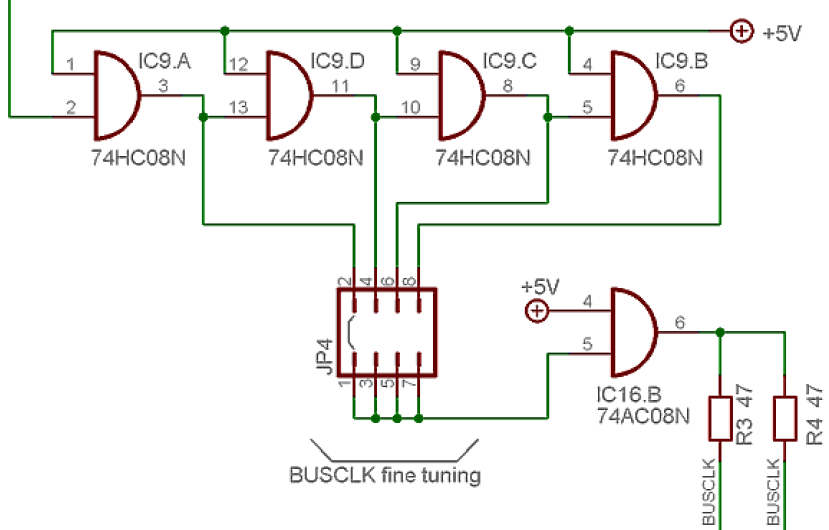

About delaying PHI0:
The simplest/crudest way to go is to "experimantally" change the value of R37 on the 'Card A_Registers' PCB,
which forms a low pass filter together with the input capacitance of IC17 (74ACHT132).
A nicer approach would be building a delay chain from 74AC (74ACT ?) logic and to tap into it by using DIP switches.
Here a picture from the schematics of Dennis Kuschel's MyCPU:
Would work with 74245 instead of 7408, too.
Maxim is building delay lines, DS1135 looks nice.
Unfortunately, DS1124 delay needs to be set by SPI.

I spent some time tinkering with resistor values to delay the input clock to the CPU -- with mixed results.
First the good: the capture below shows that the address lines are now clean and steady through the write-cycles of the JSR.
A 2k resistor delays PHI0 just enough to be nearly co-incident with BE. As a result, the bus is in the hands of the VIC chip when the CPU changes the address lines after the fall of PHI0, and the glitches are gone. There are still some glitches on the data lines when BE rises, but there seems to be plenty of time for the data to settle. I'd say it looks pretty clean at this point.
On power-up, the screen now shows the standard border and square display area. It's in black and white and there is no text, but it still seems an improvement. Perhaps the VIC chip is a little happier with the timing.
Now the bad: the RTS still fetches an invalid address. :evil: It seems something else is messing up the works.
Not quite sure where to go next ... one possible line of inquiry is to look at what's happening closer to the DRAMs as the write is being executed. Up to this point, I've been tapping most signals at the CPU, but it may be that somehow things get messed up elsewhere. There are a pair of 74LS257s on the address lines that switch between the ROW and COL addresses as /RAS and /CASRAM are pulsed (top left here). It might be revealing to take a capture of the signals there with the CPU and the 6510 in turn. Perhaps that will catch this elusive little gremlin in the act! We'll have to see ... :)
