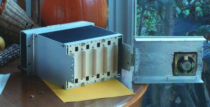

Not really. I have my slots at 2x(0.8") intervals, ie, 1.6", so I could use double-width standard panel blanks if I decide to, and I'll have plenty of room between for WW boards. (I have the 96-pin DIN connectors in WW too.) My card cage is only half rack width, but I don't anticipate ever putting more than three or four cards in it, so I can have plenty of room to put even 3.2" (minus board thickness) between the surfaces of two boards if necessary for probing without extension cards, for debugging. The card cage has removable top and bottom panels, so you can reach in for probing or for plugging in more things.
Here's the portable rack, standing on end, looking at the bottom. The perforated top and bottom panels come out. The card guides snap in and out easily. The front panel will hold the LCD and keypad. It is on hinges, and is held down with thumbscrews during transport to protect things.
Here the panel is hinged up where it sits at an angle:
Here's the back, open, before I wired up the backplane (which the processor's own buses will not go out on) and before I added the battery holders for portable operation and connectors in the back for external power, RS-232 ports, printer port, external speaker, and reset button:
...and closed, again before I added connectors and reset button:
I'll get some more-updated pictures later.
