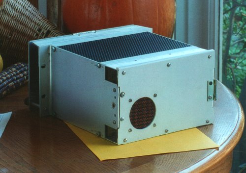

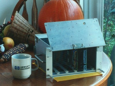

Here's the portable rack, standing on end, looking at the bottom. The perforated top and bottom panels come out. The card guides snap in and out easily. The front panel will hold the LCD and keypad. It is on hinges, and is held down with thumbscrews during transport to protect things. Here the panel is hinged up where it sits at an angle: Here's the back, open, before I wired up the backplane (which the processor's own buses will not go out on) and before I added the battery holders for portable operation and connectors in the back for external power, RS-232 ports, printer port, external speaker, and reset button: ...and closed, again before I added connectors and reset button: I'll get some more-updated pictures later.
