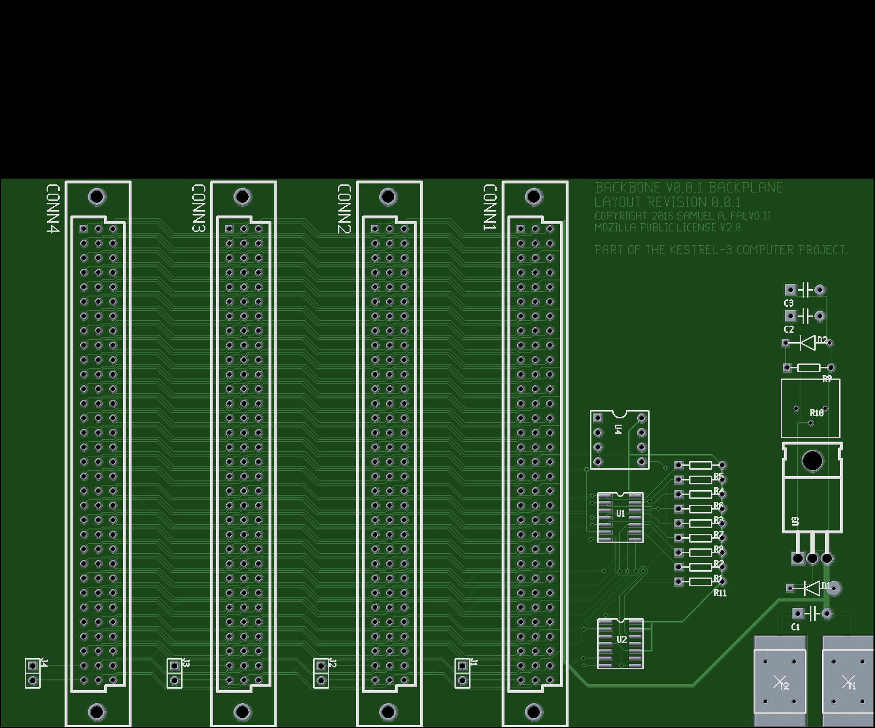

Well, thanks to the advice from Garth on how to pack things in between the pins of the DIN connector, I finally ended up with a PCB layout like so: Image
This is, of course, just a preview of what the finished board would look like. The reverse side is boring: just a grounded copper fill with a few necessary traces to avoid jumpers on the top-side.
The power supply section is in need of manual rework; I think some of the traces are too small. Not that it matters for my immediate needs (I'm just driving two LV-TTL chips), but I think some of those traces should be thickened and re-routed by hand. It's the only section that I used auto-routing on, and that was only to clean up the display while I hand-routed the DIN connectors and TTL logic.

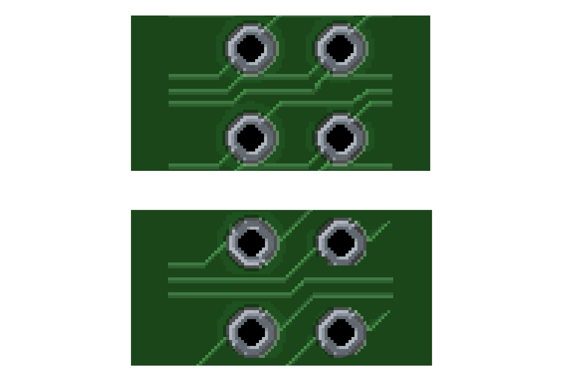

Hi Sam -- nice PCB! :) Reminder, though: It's a bit easier (and better) if you attach images to your posts, rather than hosting 'em off-site.
kc5tja wrote:
Well, thanks to the advice from Garth on how to pack things in between the pins of the DIN connector, I finally ended up with a PCB layout like so: [...] This is, of course, just a preview of what the finished board would look like.
Hmm, maybe you already noticed, but it seems that, for the final version, those zig-zags could advantageously be moved a bit -- horizontally I mean. (Original and modified motifs shown below.) It's just a suggestion; I realize the Design Rules may be satisfied as-is.
Is the back side intended to act as a ground plane, then? Connector pins that're grounded attach to it? (Just asking. I hope those traces you mentioned are short.)

Yes, I started writing Thursday night, then put it aside, thinking what I wrote sounded too picky. I'm sure it'll work as is, and it does look nice so don't let this come across as negative.
Wow, it sure looks like you already got boards made; but how could it be so fast? It looks nice.
If that's just a super good simulated picture and they're not made yet, I'd say you could further improve the spacing between traces and pads by removing the lock to 45-degree increments so you can use any angle, then come out of every row-A and row-C pin away from the connector at nearly 0 degrees instead of 45, and making the traces spaced more equidistant rather than grouped in threes. If the rise times are fast enough to matter, you'll get less cross-coupling between traces if their separation, relative to the distance to the ground plane (which in this case is the thickness of the board), is increased.
Related, for my next picky point, I notice in Jeff's second picture that the traces come to pads with angles of less than 90 degrees. I would make it so the last segment of each trace heads straight for the center of the pad. PCB manufacture seems to have improved enough over the years that it may not be a problem anymore, but the smaller angles tended to be harder to wash the chemicals out of in the manufacturing process, leading to problems in long-term reliability. I still try to have no angles of less than 90 degrees.
It's a simulation, rendered by the PCB tool. It's also a fairly low resolution render too; some traces come very close or even overlap with some pads in the simulation, but they meet DRC rules in the actual gerbers.
I tried it originally, and it results in traces for even numbered slots overlapping traces for odd-numbered slots. I even tried alternating side-to-side, and I still get the same problem. The only way they'll all fit is if I bunch them up like that.
That said, the center trace is either ground or +5V, and the reverse side is a ground plane, so I'm hoping that will compensate for this design.
And they will be; I'm working with FPGAs with I/O pins capable of 250MHz or faster rates, remember. ;)

My slots are spaced at 1.0" centers for easier access to the bus-grant jumpers and perhaps for sticking o'scope probes inside.
This backplane is not intended to sit in a rack, nor is it VME compatible. Its purpose is to let me break the Kestrel-3 into different components, so I can work on them in isolation. Once everything is done (where done is defined as, "I have a working computer with working video display and keyboard input"), I'd like to place everything onto a single board.

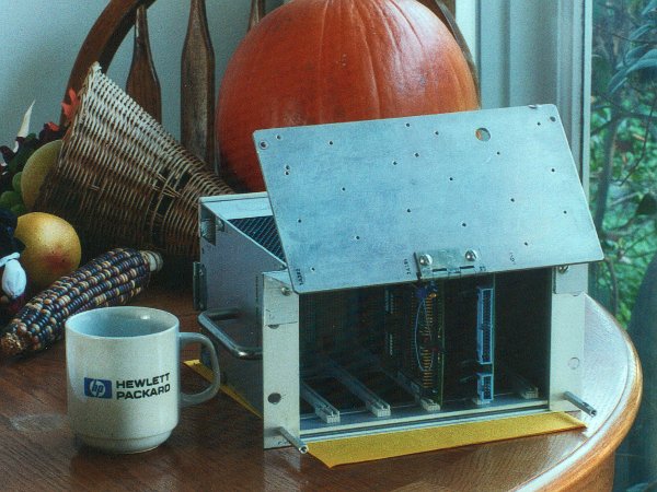

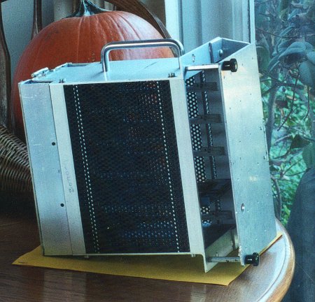

Not really. I have my slots at 2x(0.8") intervals, ie, 1.6", so I could use double-width standard panel blanks if I decide to, and I'll have plenty of room between for WW boards. (I have the 96-pin DIN connectors in WW too.) My card cage is only half rack width, but I don't anticipate ever putting more than three or four cards in it, so I can have plenty of room to put even 3.2" (minus board thickness) between the surfaces of two boards if necessary for probing without extension cards, for debugging. The card cage has removable top and bottom panels, so you can reach in for probing or for plugging in more things.
Here's the portable rack, standing on end, looking at the bottom. The perforated top and bottom panels come out. The card guides snap in and out easily. The front panel will hold the LCD and keypad. It is on hinges, and is held down with thumbscrews during transport to protect things.
Here the panel is hinged up where it sits at an angle:

Putting the slots at 1.6" centers would roughly double the cost of the board (doubles the surface area), and would lead to traces >4", thus requiring termination (instead of it being merely a recommendation). Also, card cages seem to be optimized for 100mm x 160mm Eurocards. I'm looking "cards" that are closer to 3.5" x 1.5" in size (give or take space needed for external ports). Again, looking to RC2014 computer for inspiration. The backplane is intended to carry the main CPU bus.
PostPosted: Sat Jun 11, 2016 11:32 pm
Posts: 1706
Fixed last known batch of bugs in the PCB layout, and I've now placed an order. Here's hoping everything works when I put it all together.
