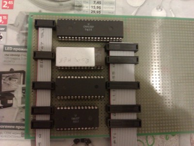

VGEORGIEV
Posts: 3
Joined: 09 Dec 2013
Location: Sofia, Bulgaria
Re: AVR Based Apple II Emulator
Post by VGEORGIEV »
Hi guys,
Thanks for positive feedback.
I got this Basic from here.
It states it is EhBasic 2.2. Not sure it is MS basic.
The reason I got this is because it is easy to deal with input and output.
When it wants to write a character to the console, it writes the byte to memory location $F001.....
It keeps reading from memory location $F004, where you should have the next ASCII character value from the keyboard waiting to be read. If there is no more input to read, it should return a value of zero.
Yesterday I put first two pages in AVR RAM. In fact I did some kind of cache memory.
This change increased the speed by 33%.
Later I will put XTAL on AVR in order to run it at 16MHz.
My next project will be almost the same but using ATmega32 or ATmega1284.
I need 40 ping DIP AVR in order to have 3 ports available for address and data busses.
I did keyboard and video interface for my 6502 emulator.
This is a web link where I got all the information I need. http://searle.hostei.com/grant/MonitorK ... index.html
BTW. I tried to run real 6502 SBC on a proto board. No success as of now.
May be due to the spaghetti wiring I did.

I tried to run real 6502 SBC on a proto board. No success as of now. May be due to the spaghetti wiring I did.
Is that the project shown in the 2nd and 3rd photos? To me, that wiring looks perfectly workable.
BTW, I'm intrigued with the approach of running ribbon cable on the component side as a means to implement a bunch of parallel connections. That hugely reduces the number of criss-crossed connections on the wiring side, making things a lot tidier than they'd be otherwise.
But there are problems, you say? I wonder if there might be some adjacent pads accidentally bridged together with solder. That would be an easy mistake to make, given the large, square pads on that board. (There'd be less risk of an undetected solder bridge with round pads that were a bit smaller.)
Other questions: are you using bypass capacitors on the supply and near the chips? I don't see any. Also, how long do those ribbon cables extend? Is there something else connected, not visible in the photo?

Indeed the ribbon cable solution was also very appealing to me as well. I like that approach. On the other hand you need to be careful which signals you put on the same ribbon cable. Never put the clock or select signals side by side to the Data or Address bus. I really wonder what the problem is that this system is not working. Perhaps you need to shorten the ribbon cables on the bottom edge on the last photo, it's only a guess as you can't see the real length on the photographs.
Posts: 3526
Be careful, I agree, since there's a risk of crosstalk. But if the conductors of the ribbon also include some grounds, the situation changes. The ribbon technique has potential to work in your favor, actually improving signal integrity.
  • There'll be minimal crosstalk between two signals lines if a ground line lies between them. That's because (among other reasons) the ground line acts as a shield against capacitive coupling.
  • For a less obvious effect, consider a two-conductor ribbon with just one signal and one ground. Crosstalk isn't an issue. But the nearby ground line lowers the inductance of the signal line, and thus tends to improve signal integrity. It's like the ground plane you'll find on an expertly-designed PCB. It works because the return current from the signal conductor "wants" to travel through a path that's close to the conductor. Catering to this reduces the loop area. But remember: you can't just use just a single connection to ground, and also not to just any old place on the board. The reason is simple. Since current is expected to flow, a single connection is insufficient. The ribbon ground needs to connect to local ground of the circuitry at the signal source and at the signal destination(s).
On a board like Vladimir's, we maybe don't need to worry about this stuff. But as a general topic it's worthwhile to talk about!
