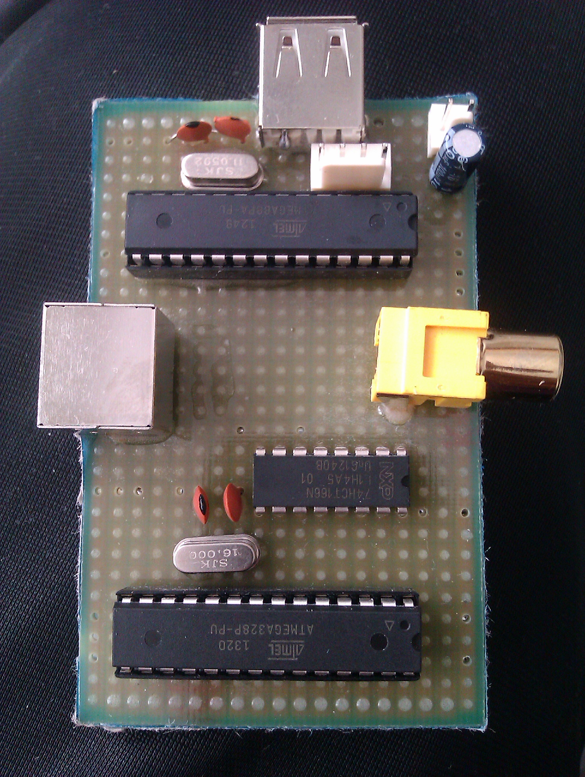

What you see here is already the enhanced version with the external generation of A16 for the memory mapping to emulate Main/Aux RAM of an Apple IIe. Which are the two top IC (74HCT574 and 74HCT251). One serial interface is the Character IO to the "6502" and the other serial interface is TX-only for debugging purposes. Down right is the SD-Card interface I'm currently working on.

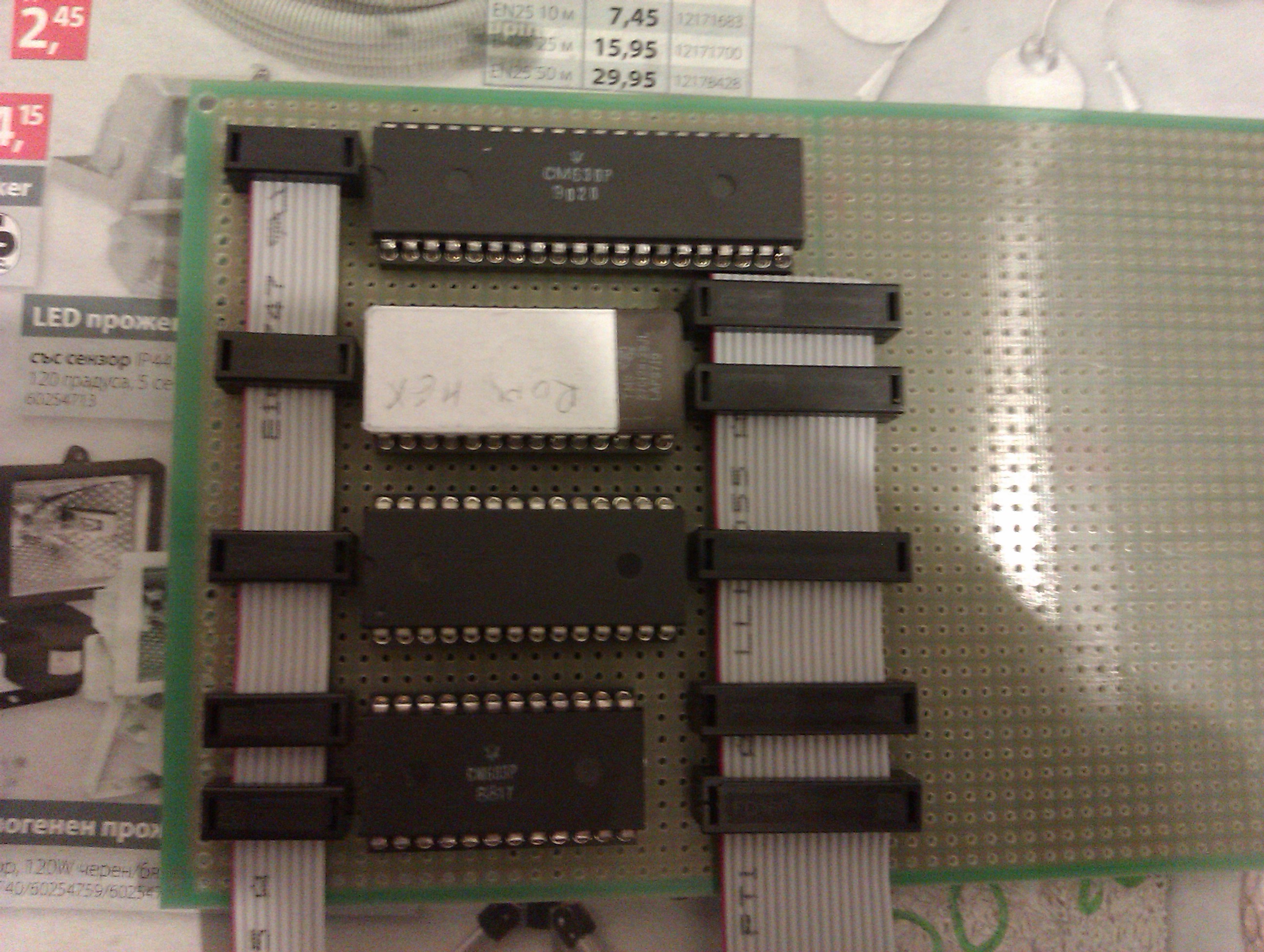

I tried to run real 6502 SBC on a proto board. No success as of now. May be due to the spaghetti wiring I did.
Is that the project shown in the 2nd and 3rd photos? To me, that wiring looks perfectly workable.
BTW, I'm intrigued with the approach of running ribbon cable on the component side as a means to implement a bunch of parallel connections. That hugely reduces the number of criss-crossed connections on the wiring side, making things a lot tidier than they'd be otherwise.
But there are problems, you say? I wonder if there might be some adjacent pads accidentally bridged together with solder. That would be an easy mistake to make, given the large, square pads on that board. (There'd be less risk of an undetected solder bridge with round pads that were a bit smaller.)
Other questions: are you using bypass capacitors on the supply and near the chips? I don't see any. Also, how long do those ribbon cables extend? Is there something else connected, not visible in the photo?
