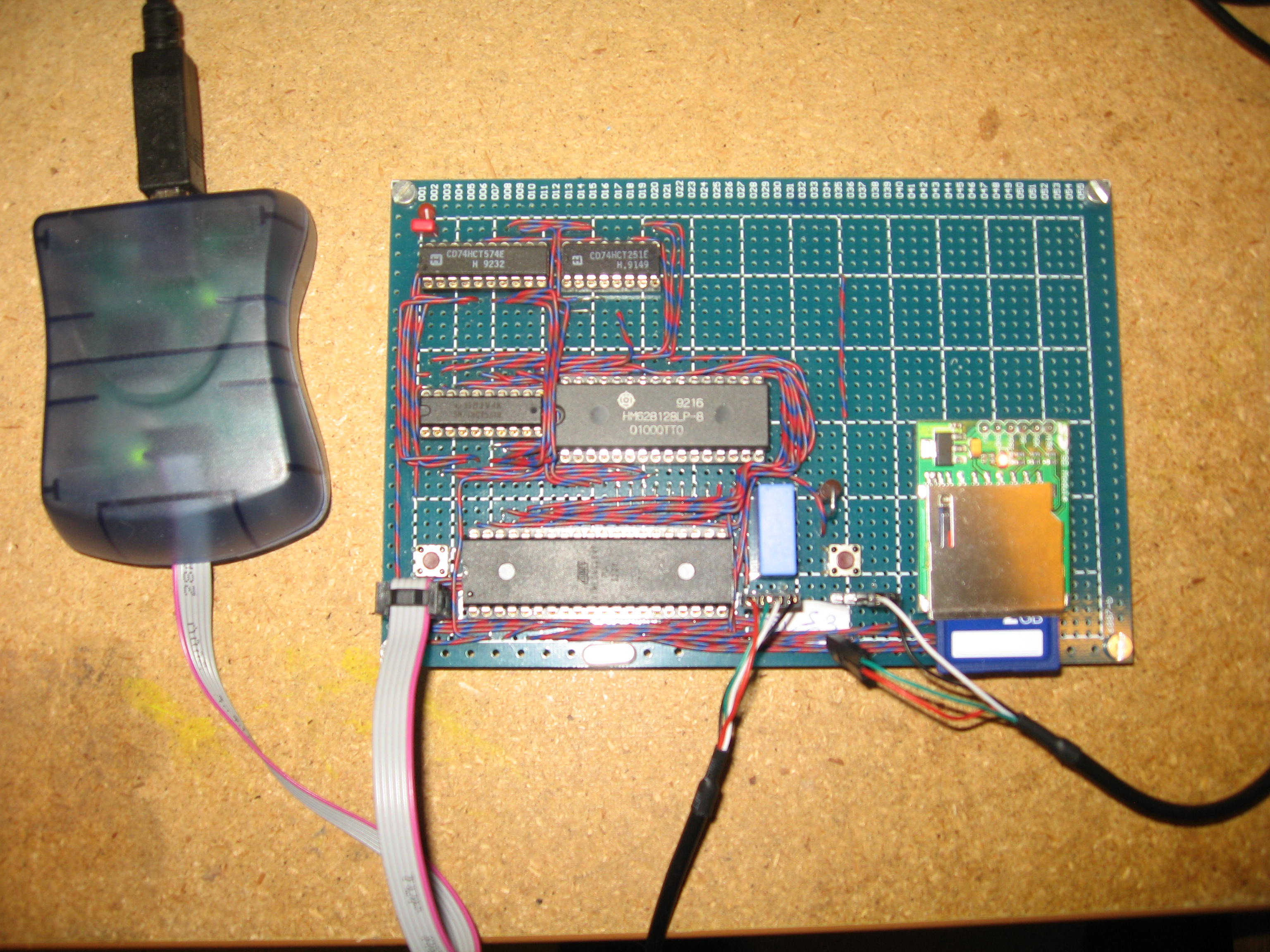

Hi,
many of my last projects were AVR based projects. But I like the 6502 processors very much, and previously many projects where 6502 based. I still have plenty of old 6502 chips even A and B versions. Later I mixed AVR and 6502 processors, for example one of the projects was a PS/2 keyboard interface for may Apple IIplus using a ATMega8 chip. But then I stepped over the AVR Based 6502 Emulator of Daryl. I was really impressed, especially because in another forum I regularly visited long ago I was once reading a thread in which many people were convinced that an AVR was not fast enough to emulate a reasonably fast 6502. Although the AVR in Daryls project is (moderately) over-clocked it had more than enough speed (>2MHz 6502). And there is also the 6502 Emulator of Klaus with the external RAM, so you can have more than is available in a AVR processor. (Read those threads as well, there is much information in them that let you better understand what I did).
So I thought that it must be possible to Emulate an Apple IIplus on a AVR using external RAM, and that's what I did. I took an ATMega1284P with a 128kbyte SRAM and a 8-bit Latch so I had a AVR with enough external RAM. Schematic is included in the archive (as Eagle-File and as PDF) I took the same processor as Daryl in order to be able to use his project as a starting point and to incrementally modify his project into an Apple IIplus emulator. I have no web-page so I just make my project available on Dropbox
https://dl.dropboxusercontent.com/u/320 ... ppleii.zip
The emulator runs first the bootloader code of Daryl, so you could overwrite the "6502 ROM" Image with your own, don't do that for the moment, it's not adjusted to my emulator. Just press return to jump right into the Apple II Emulator. The current status implements a redirection of video output (COUT) to the UART. So you will not see the "Apple ][" Message, as the autostart ROM writes directly to the Text RAM but all further input and output are received/sent via the AVR UART0 (the emulator contains an emulation of KBD input that links the the RX side of the UART0). So you can start to play around with the ""Apple II""
It's working but not finished yet, as I want to add several functions. Especially Video and Disk (using SD-Cards) is on the agenda.

Just updated the code, especially changed the 6502 IO Routine for Video and Keyboard. With UART0 connected to a VT100 (Emulator) it implements now all AppleII Output and Input Features except for Windows other than the full screen. The zip file now also contains the complete ROM include file.

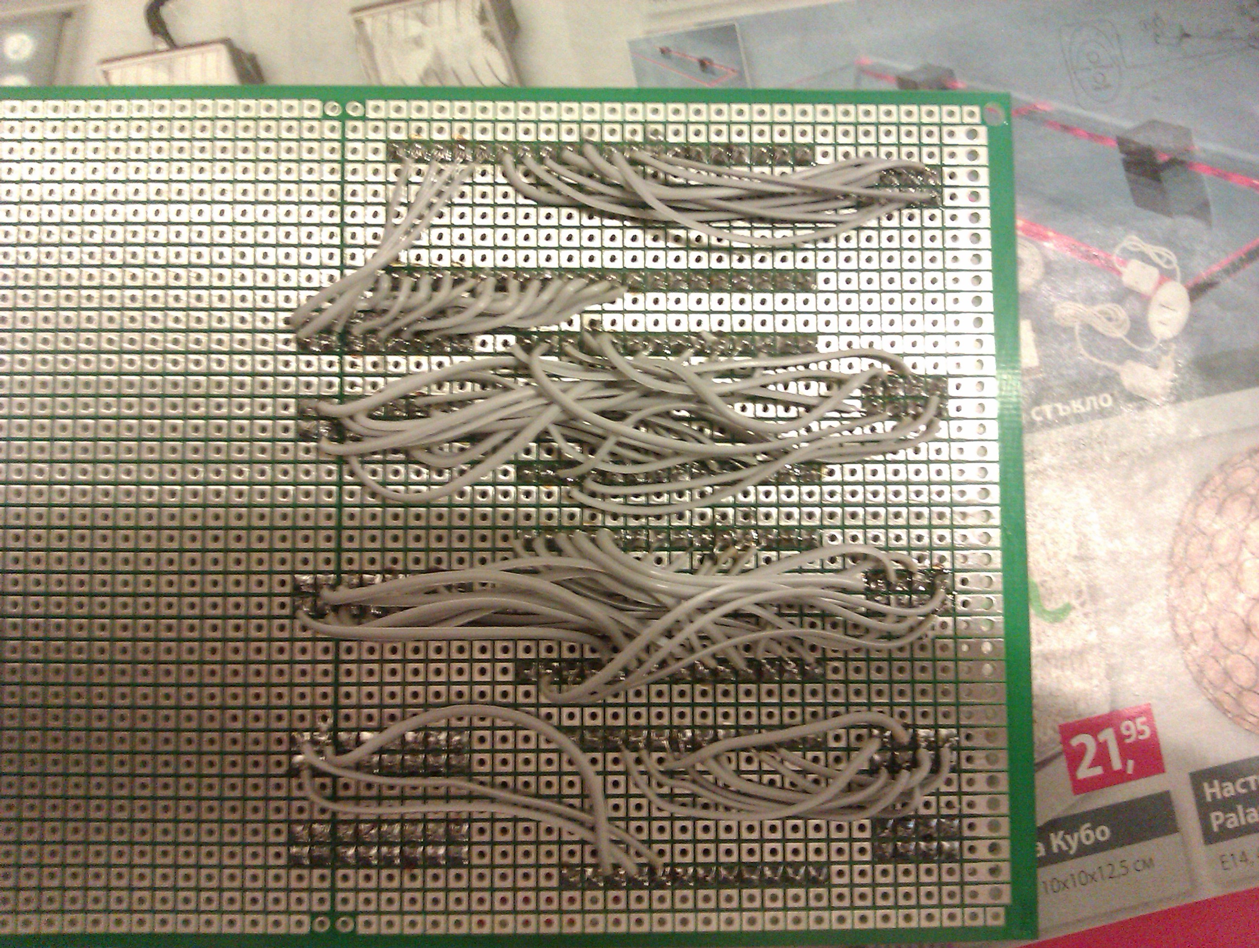

Hi guys,
Thanks for positive feedback.
I got this Basic from here.
It states it is EhBasic 2.2. Not sure it is MS basic.
The reason I got this is because it is easy to deal with input and output.
Yesterday I put first two pages in AVR RAM. In fact I did some kind of cache memory.
This change increased the speed by 33%.
Later I will put XTAL on AVR in order to run it at 16MHz.
My next project will be almost the same but using ATmega32 or ATmega1284.
I need 40 ping DIP AVR in order to have 3 ports available for address and data busses.
I did keyboard and video interface for my 6502 emulator.
This is a web link where I got all the information I need. http://searle.hostei.com/grant/MonitorK ... index.html
BTW. I tried to run real 6502 SBC on a proto board. No success as of now.
May be due to the spaghetti wiring I did.

I tried to run real 6502 SBC on a proto board. No success as of now. May be due to the spaghetti wiring I did.
BTW, I'm intrigued with the approach of running ribbon cable on the component side as a means to implement a bunch of parallel connections. That hugely reduces the number of criss-crossed connections on the wiring side, making things a lot tidier than they'd be otherwise.
But there are problems, you say? I wonder if there might be some adjacent pads accidentally bridged together with solder. That would be an easy mistake to make, given the large, square pads on that board. (There'd be less risk of an undetected solder bridge with round pads that were a bit smaller.)
Other questions: are you using bypass capacitors on the supply and near the chips? I don't see any. Also, how long do those ribbon cables extend? Is there something else connected, not visible in the photo?
Re: AVR Based Apple II Emulator
Indeed the ribbon cable solution was also very appealing to me as well. I like that approach. On the other hand you need to be careful which signals you put on the same ribbon cable. Never put the clock or select signals side by side to the Data or Address bus. I really wonder what the problem is that this system is not working. Perhaps you need to shorten the ribbon cables on the bottom edge on the last photo, it's only a guess as you can't see the real length on the photographs.
- There'll be minimal crosstalk between two signals lines if a ground line lies between them. That's because (among other reasons) the ground line acts as a shield against capacitive coupling.
- For a less obvious effect, consider a two-conductor ribbon with just one signal and one ground. Crosstalk isn't an issue. But the nearby ground line lowers the inductance of the signal line, and thus tends to improve signal integrity. It's like the ground plane you'll find on an expertly-designed PCB. It works because the return current from the signal conductor "wants" to travel through a path that's close to the conductor. Catering to this reduces the loop area. But remember: you can't just use just a single connection to ground, and also not to just any old place on the board. The reason is simple. Since current is expected to flow, a single connection is insufficient. The ribbon ground needs to connect to local ground of the circuitry at the signal source and at the signal destination(s).
