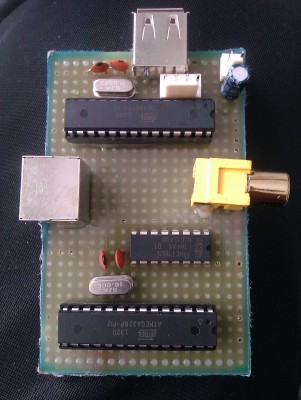

However I think Jeff is overestimating the effort to put parallel RAM. A 8-bit Latch and a normal SRAM is all you need. It's just more wires and it does not matter which address pin on the AVR is put to which address pin on the SRAM. The data pins as well don't need to be wired in the order if PIN names. The RAM does not care. Of course you need more Pins and hence a larger ATMega in a 40-PDIP. There you have the choice of using a ATMega with external RAM interface. When you let the AVR run at the internal 8MHz clock, access time is not an issue. A latch with tpd=25ns or less and a RAM with tacc=100ns or less is all you need. Or you do as I did, you build your own parallel interface logic using the same 8-bit Latch and SRAM. And as an ATMega1284p has more than enough flash you can put the 6502 ROM in flash. This runs faster of course. The Basic program runs in less than a second for one full sine-wave. Here is my current setup. Even using the worst wiring technique for a SBC it runs flawless and it worked out-of-the box, i.e. I never had to debug the hardware setup.
What you see here is already the enhanced version with the external generation of A16 for the memory mapping to emulate Main/Aux RAM of an Apple IIe. Which are the two top IC (74HCT574 and 74HCT251). One serial interface is the Character IO to the "6502" and the other serial interface is TX-only for debugging purposes. Down right is the SD-Card interface I'm currently working on.
Peter

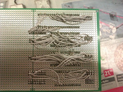

BTW. I tried to run real 6502 SBC on a proto board. No success as of now.
May be due to the spaghetti wiring I did.

I tried to run real 6502 SBC on a proto board. No success as of now. May be due to the spaghetti wiring I did.
Is that the project shown in the 2nd and 3rd photos? To me, that wiring looks perfectly workable.
BTW, I'm intrigued with the approach of running ribbon cable on the component side as a means to implement a bunch of parallel connections. That hugely reduces the number of criss-crossed connections on the wiring side, making things a lot tidier than they'd be otherwise.
But there are problems, you say? I wonder if there might be some adjacent pads accidentally bridged together with solder. That would be an easy mistake to make, given the large, square pads on that board. (There'd be less risk of an undetected solder bridge with round pads that were a bit smaller.)
Other questions: are you using bypass capacitors on the supply and near the chips? I don't see any. Also, how long do those ribbon cables extend? Is there something else connected, not visible in the photo?
