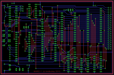

This is my MARC-1 SBC.
With the PCB layout I started over three times. But I think I’ve got it right now.
It’s pretty simple in address decoding and features. Only an ACIA for I/O.
This is mainly for experimenting and interfacing with the breadboard and will replace my current prototype.
The ATtiny delivers a clock of 3,6864 MHz. This is divided to 1,8432 MHz. for the ACIA and 0,9216 MHz. for PHI2. With a jumper, PHI2 can also be set to 1,8432 MHz.
There are buttons for reset, CPU stop and single instruction.

 Post subject: Re: My MARC-1 SBC
PostPosted: Mon Oct 28, 2013 7:08 pm
It looks like some vias are really close together. Did you run a design rule check ?

Hi Arlet,
I’ve used EAGLE’s default design rules, it only gives me some errors with drill sizes of the vias. Do you have any suggestions?
BTW. I used the technique you suggested to apply two polygon layers and assigned them to one level. Before there were 42 air wires, and after there were only 4 left.
Could I use smaller trace width’s for home etching, now I use 0.016”. and for power 0.024”?
Marco
PostPosted: Mon Oct 28, 2013 9:52 pm
I was looking at these 3 vias in the middle. What's the space between them ?
Also, some vias can be easily avoided, like the two on the left, by letting the red trace go horizontal for a little bit.
It’s 0.01”. I made some room between them.
Can I reach the upper side for soldering on the sockets? If so, there could be a lot more vias omitted.
PostPosted: Tue Oct 29, 2013 6:48 am
Ah, I didn't think about the fact you were going to etch these yourself and don't have plated through hole. I don't know about sockets, but if you solder the IC in without a socket, it's much easier to reach the top side. For cheap ICs that may be a good option.
If you get some sockets now, you can practice soldering the top side on a piece of perfboard, and see if its possible. Or maybe somebody else has more experience with sockets and can tell if there are suitable ones that can be soldered on the top.

Here is a picture of the result. What’s not pretty is that the copper already begins to corrode.
BTW, I don't see a bypass capacitor near the EPROM. An EPROM generates a large transient when /OE is asserted.
Something else to consider is that fill planes (aka ground pours) are detrimental to high speed digital circuits.
