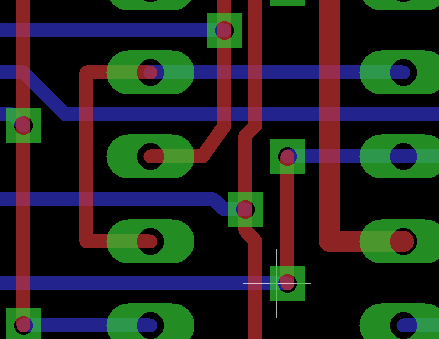

It looks like some vias are really close together. Did you run a design rule check ?

I’ve used EAGLE’s default design rules, it only gives me some errors with drill sizes of the vias. Do you have any suggestions?
BTW. I used the technique you suggested to apply two polygon layers and assigned them to one level. Before there were 42 air wires, and after there were only 4 left.
Could I use smaller trace width’s for home etching, now I use 0.016”. and for power 0.024”?

I was looking at these 3 vias in the middle. What's the space between them ?
Also, some vias can be easily avoided, like the two on the left, by letting the red trace go horizontal for a little bit.
It’s 0.01”. I made some room between them.
Can I reach the upper side for soldering on the sockets? If so, there could be a lot more vias omitted.
Ah, I didn't think about the fact you were going to etch these yourself and don't have plated through hole. I don't know about sockets, but if you solder the IC in without a socket, it's much easier to reach the top side. For cheap ICs that may be a good option.
If you get some sockets now, you can practice soldering the top side on a piece of perfboard, and see if its possible. Or maybe somebody else has more experience with sockets and can tell if there are suitable ones that can be soldered on the top.

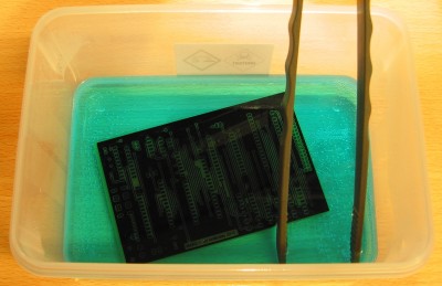

While etching my board, a topic showed up which just fits in here!
viewtopic.php?f=4&t=2760
Arlet, your new Sandbox design looks so clean and easy, I know it’s not...
I’m glad with your advice, it just pushed me over the edge. Here is a photo shoot of the results:
I use a technique described here:
http://thomaspfeifer.net/platinen_aetzen.htm
It’s in German, but I have some similar links in English.
http://www.riccibitti.com/pcb/pcb.htm
http://fullnet.com/~tomg/gooteepc.htm
http://www.dr-lex.be/hardware/tonertransfer.html

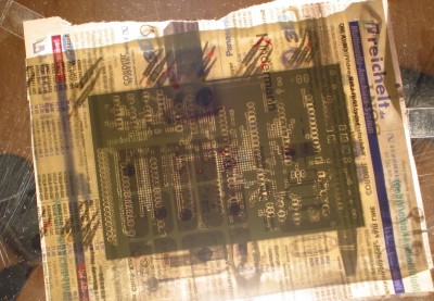

The paper I use is from an electronics catalog. I print the bottom layer normal and the top layer mirrored.
Then I glue those two sheets together with one side open like a pocket.
This way I can slide the double sided print in. For melting the toner onto the copper I use a hacked laminator. It regulates at a temperature of ca. 200 deg. Celsius. And heats at both sides simultaneously.
The vias I drill with 0,5mm. I keep the vias at open places to be able to solder a wire through it. Also when I can reach the upper side of the solder pad, I can use it as a via.

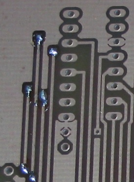

Phew, after some days I finished soldering. Unfortunately, Atmel decided to update their Atmel Studio, and my AVRISP-mkII Clone stopped working.
Here is a picture of the result. What’s not pretty is that the copper already begins to corrode.
Marco
