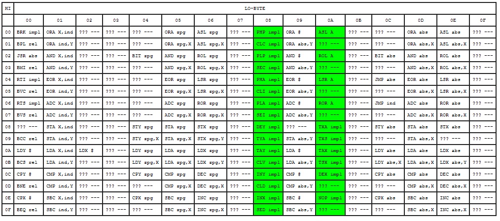

Completed Predecode logic simulation.
Predecode has two outputs : /TWOCYCLE and /IMPLIED.
Predecode determine whenever instruction takes 2 cycles to execute or it has no operands (implied).
Two-cycles instructions are actually all implied (except push/pull) + ALU operations with immediate operand.
I attached screenshots with list of 2-cycle and implied 6502 instructions.
6502 addict
