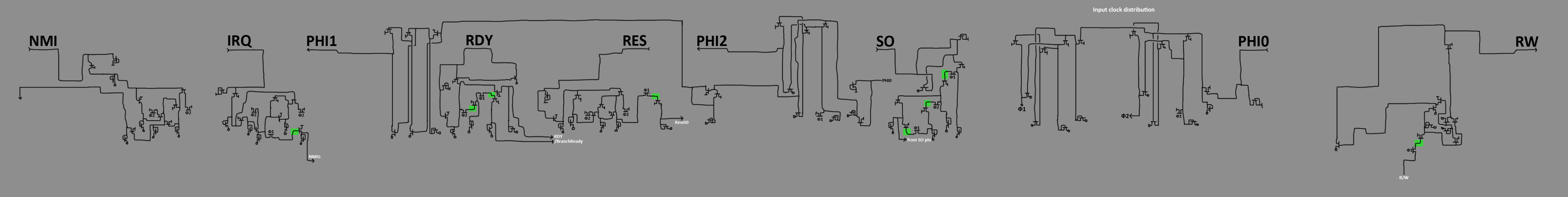

I try to explain my simulation of whole /NMI pin logic.
Overview:
So I simulate output as follow:
        b = NOR ( NAND(NOT(NMI_PAD), PHI2), NMI_LATCH);
        NMI_LATCH = NOR ( NAND(NMI_PAD, PHI2), b );
        OUTPUT_LINE = NOT(NMI_LATCH);
(b is temporary value)
I drawn NAND/NOR counterpart of trigger on picture. So I think we need those "~".
As output I'm getting following data:
L N Ф  L*O
0 0 0 | 0 1
0 0 1 | 0 1
0 1 0 | 0 1
0 1 1 | 1 0
1 0 0 | 0 1
1 0 1 | 0 1
1 1 0 | 0 1
1 1 1 | 1 0
Where :
L - latch value before iteration
N - NMI pin level
Ф - PHI2
L* - latch value after iteration
O - output line
And it even worse, if you try to simulate /IRQ. It has additional PHI1 transfer gate + latch as output. In that case I'm getting only '1's on out.

It's not a nor of a NAND: it's a nor of an and.

Indeed, this is NOR of ANDs, I just checked truth table, thanks ))) Now everything works good )
Transition states of /NMI output line:
L I Ф |L* O
0 0 0 | 0 1
0 0 1 | 1 0
0 1 0 | 0 1
0 1 1 | 0 1
1 0 0 | 1 0
1 0 1 | 1 0
1 1 0 | 1 0
1 1 1 | 0 1
Transition stated of /IRQ and RES lines (both have additional output static latch):
L I P |L* O
0 0 0 | 0 1
0 0 1 | 0 1
0 1 0 | 0 1
0 1 1 | 1 1
1 0 0 | 1 0
1 0 1 | 0 0
1 1 0 | 1 0
1 1 1 | 1 0
Simulation can be found here:
http://code.google.com/p/breaks/source/ ... SRC/MISC.c
(I added some convenient macros like NAND / NOR, to increase source code readability)

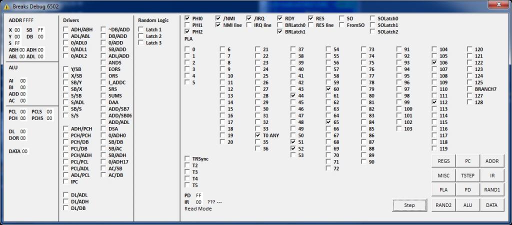

Also I started my 6502 debugger:
It may look more complicated, than other 6502 debuggers you've seen before :)

Have you tried to run your Breaks6502.exe on Linux using WINE? I'm willing to try it if you make the exe available (maybe in a zip file)
PostPosted: Fri Oct 05, 2012 6:39 am
Posts: 201
It should run under WINE without any trouble. I'm using plain winapi.
Here:
http://code.google.com/p/breaks/source/ ... runk/Build
6502 addict
PostPosted: Fri Oct 05, 2012 7:00 am
Online
Thanks - it does open the front panel and another window! Some but not all checkboxes work, and the Step button causes the clocks to toggle and produces some output on the console. (I don't see anything in the second window)
$ ./Breaks.exe
Debug console opened
IR unchanged: PHI1=0 / fetch=0
IR unchanged: PHI1=1 / fetch=0
This is a good sign, I think, for Linux users.

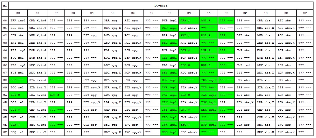

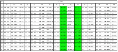

Completed Predecode logic simulation.
Predecode has two outputs : /TWOCYCLE and /IMPLIED.
Predecode determine whenever instruction takes 2 cycles to execute or it has no operands (implied).
Two-cycles instructions are actually all implied (except push/pull) + ALU operations with immediate operand.
I attached screenshots with list of 2-cycle and implied 6502 instructions.
