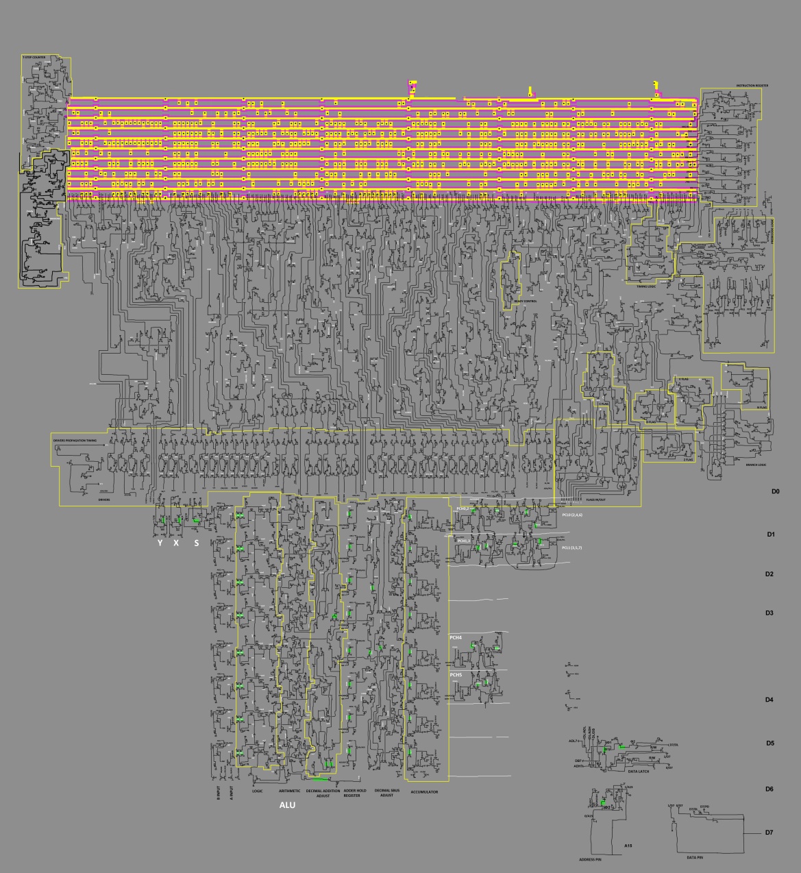

PostPosted: Mon Sep 17, 2012 12:55 pm
Posts: 201
I have a small break due to HDD failure, but thanks to Google Drive, I quickly restored all data.
Now I can present complete 6502 rev. D schematics. This part of my job is done here:
Image Image
High-resoultion images can be found on google code project.
I uploaded photoshop sources here : http://ogamespec.com/6502/sources.zip (~200 MB)
And updated most interesting parts (ALU and random logic) by recent changes:
http://ogamespec.com/6502/ALU.psd
http://ogamespec.com/6502/LOGIC.psd
(remember, this is not WIP anymore)
6502 addict
