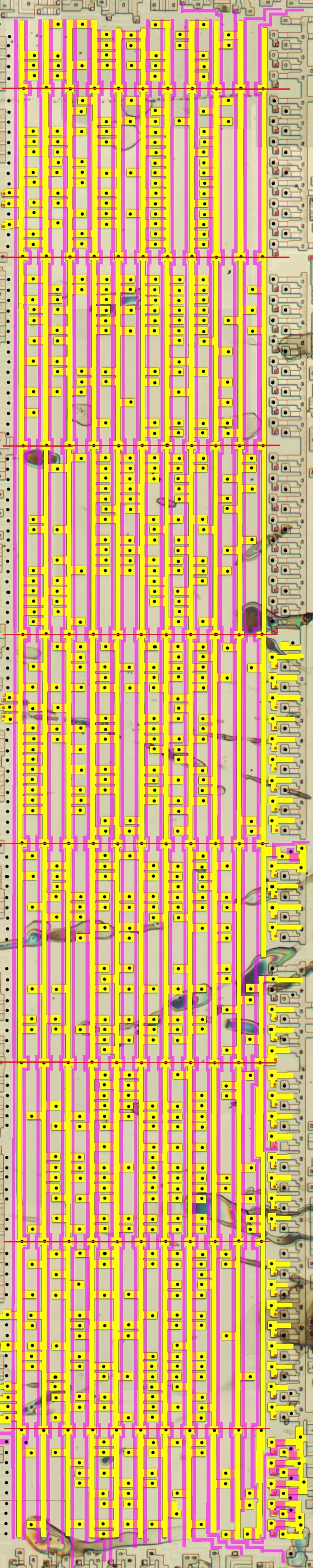

Posts: 201
Added missing R/W distribution tri-state, which goes from random logic to data latch.
(attached)
- More clear picture of PLA for double-checking
- Started complete 6502 schematics (WIP)
- Complete PLA simulation here:
http://code.google.com/p/breaks/source/ ... /SRC/PLA.c

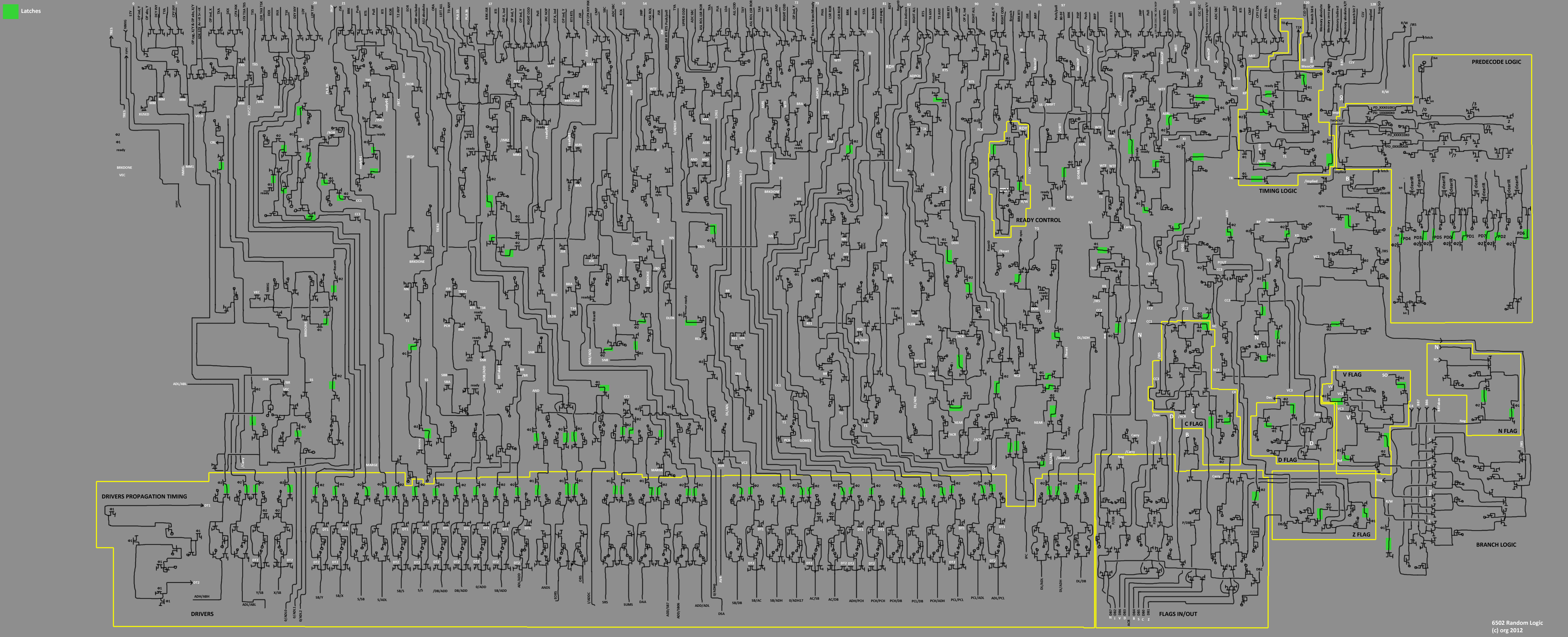

PostPosted: Mon Sep 17, 2012 12:55 pm
Posts: 201
I have a small break due to HDD failure, but thanks to Google Drive, I quickly restored all data.
Now I can present complete 6502 rev. D schematics. This part of my job is done here:
Image Image
High-resoultion images can be found on google code project.
I uploaded photoshop sources here : http://ogamespec.com/6502/sources.zip (~200 MB)
And updated most interesting parts (ALU and random logic) by recent changes:
http://ogamespec.com/6502/ALU.psd
http://ogamespec.com/6502/LOGIC.psd
(remember, this is not WIP anymore)

PostPosted: Mon Sep 17, 2012 1:31 pm
Online
Very nicely done!
