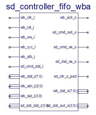

ElEctric_EyE wrote:
OpenCores.org is back up so these are the cores I am going to try to fit:
I2C
PS2
SD Card
They all have wishbone interfaces.
The SD Card controller looks like it's fairly big. At the cost of some more software overhead, you can also replace it with a simple SPI controller, and some GPIO lines for card detect/write protect. Here is a good web page with hardware/software descriptions: http://www.roland-riegel.de/sd-reader/. It's written in C, but it gives a nice working implementation of getting the cards to initialize (which is a bit tricky with all the different kinds of cards now).
Most of that code is for the FAT filesystem. I don't know if you were planning to have that too, but it's going to be quite big on the 6502. Alternatively, you can just treat the SD card as a big binary block, and use 'dd' on a linux host to access the raw data.

PostPosted: Tue Jan 11, 2011 2:12 pm
Arlet wrote:
...The SD Card controller looks like it's fairly big...
There's a smaller version of the full featured 32-bit core. It's a FIFO core that has an 8-bit WB interface. Although, it only supports SD 4-bit mode. Still looking for documentation of this smaller core, but I did run it through ISE using the XC3S400, which I decided to stick with since I spent $50 on the adapter socket for it.
There seems to be many speed ratings for SD cards, with the read speeds being much faster than write speeds, but...
What I need to focus on now is bootstrapping the 6502 core, and lose the EEPROM altogether as Arlet suggested. I never worked with ROMs inside an FPGA, but I do think I remember seeing the options, now that I'm typing this, when I was trying to INIT some flip-flops to 1's in another thread... The 2 things I do know is the font data is 2K (128charactersx8bitsx2fonts), and the actual code is less than 1K. I think I could trim the font data...
