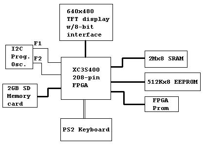

Nothing is even on paper yet, but my little mind's eye is picturing 5 IC's:
The XC3S400 Spartan 3
The FPGA PROM
A 2Mx8 SRAM
A 512Kx8 EEPROM
An I2C programmable oscillator
Here's a block diag of what I'm thinking. As in the PWA, the "OS" will be copied from slow EEPROM @F1(2.5MHz), and run from SRAM @F2(20MHz+). The 2GB SD will hold "test data". I'm thinking bitmap pic info that can be readily copied from the PC to the SD card. Then plugged into 6502SoC and outputted to the display to test the SD core.

Well, if you're interested, I don't think it would be too hard to add a VGA interface directly in the FPGA. I already have some verilog lying around from some earlier projects that I could clean up and donate. See below for a picture of my spartan-3 eval board, hooked up to a test board with a QVGA panel, showing some test font.
The frame buffer is stored in an SRAM chip (included on spartan-3 board). The SRAM interface ran at 100 MHz, but the pixel clock was only 25 MHz. I only had a simple state machine instead of a CPU to write the data. It would be an option to raise the pixel clock to 50 MHz, which would allow something like 800x600, combined with a 50 MHz 6502, alternating access cycles on the SRAM.
Lower speeds are possible too, of course.
ETA: advantage of a home-built VGA controller is that you can implement different color modes, or implement some 2D acceleration features like a bit blit.

On the boot rom front, it would be tempting to ditch the conventional EEPROM and use an i2c EEPROM - 256kbit for $2 especially if you have an i2c port already, and an SD card interface nearby. The EEPROM only has to contain a bootstrap which should be small and stable, just enough to load application or OS code from SD. Actually if the bootstrap is small enough you could place it inside the FPGA, which is even simpler.
 Post subject:
PostPosted: Tue Jan 04, 2011 6:30 pm
Yes, there's plenty of room inside the block RAMs, and you can preload them with code, use as a bootloader, and afterwards use them as regular RAM.

All in good time my friends. I'm not as advanced as you guys might think! I have to start from a 'known' foundation. However, it's nice to throw ideas out there, so I will do the same.
As far as VGA, looking at some of the cheapest LCD monitor prices on newegg.com, it may be worth looking into as it would be more universal.
I've seen some HDL code for a VGA controller on FPGA4Fun website, and it looked pretty short. Not sure how to interface it to the 6502 though? What about your code Arlet? I could use the display I'm now using for development purposes, and have the VGA part as an add-on later...
I haven't tested I2C core yet, so I need to start small with that DS1085 programmable freq. generator. As far as RAM though, how much block ram would be available? Maybe I could get rid of the external 2Mx8 SRAM?

The XC3S400 you mention has 16 block RAMs of 2KB each. Each block RAM is a dual ported memory, and can be configured as 9, 18, or 36 bits wide. You can combine multiple blocks to make deeper or wider RAMs.
If you want on-board VGA controller, you'll need external SRAM for graphics frame buffer. If you just want text, you can run VGA from block RAM. Here's one of my very first projects with my Spartan-3 eval board, using 2 block RAMs. One for text buffer, the other for character ROM: http://ladybug.xs4all.nl/arlet/fpga/text2.jpg, because all block RAMs are dual ported, the other port is free for easy CPU access.
With my graphics version of the VGA controller, the data comes from external SRAM, and the 6502 can write to same SRAM. This is done with a dual port SRAM controller. From the 6502's perspective, part of the memory map would be mapped to the video memory. As you store data in that memory, it'll show up directly on the screen.
What kind of hardware are you planning to use ? Some standard FPGA board, or something home made ?

I didn't think it would have been that limited. The SSD1963 LCD controller has 1.2MB of built in RAM. I'm sure it's some sort of FPGA. It's only 144-pin QFP... But anyway, that scraps the VGA idea. Only because I intend to eventually have 4-layer 3.5"x2.8" mini-pro boards made by ExpressPCB. So chip count needs to be as low as possible at this point.
Arlet wrote:
...What kind of hardware are you planning to use ? Some standard FPGA board, or something home made ?
Home made using wirewrap. I already experimented soldering the XC3S400 208-pin QFP using a PGA adapter and wire wrap headers. Been sitting on an anti-static pad gathering dust!
