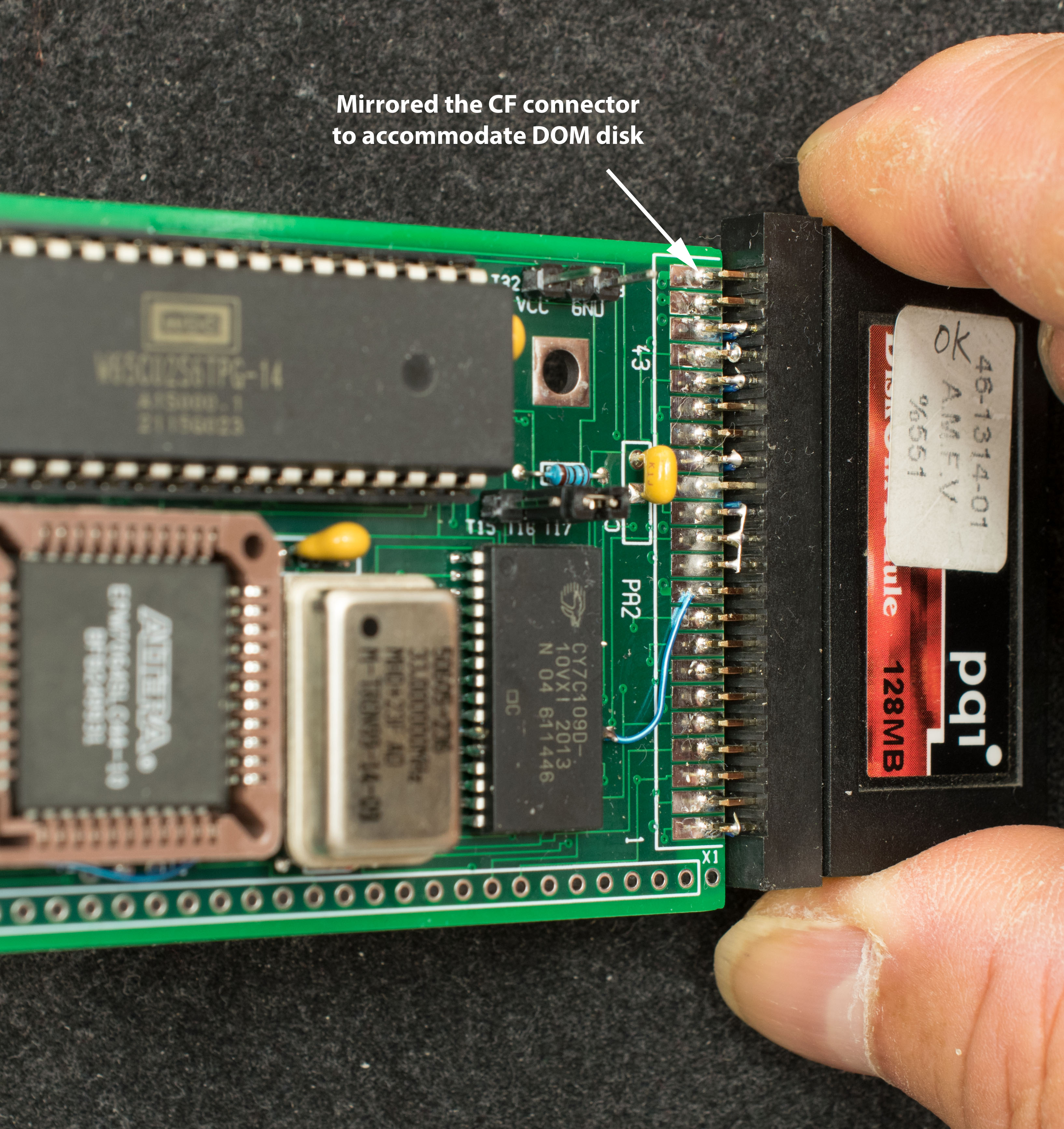

Thinking about the speed improvements of the overclock prototype and how it can be transferred to pc board design, I thought I would take an intermediate step and implement half of the improvements on the existing CRC65 pc board and see what improvement can be achieved. The speed improvements for existing pcb are:
* fast 10nS RAM
* fast decoding of RAM (chip select always asserted)
* buffered clock
* fast DOM interface.
The existing CRC PC board will still have DIP40 W65C02, parallel port with extra loading of address/data/control signals, and long traces between RAM, CPU, CPLD, parallel expansion, and CF interface.
So here is CRC65 rev2 PCB (a 4-layer PC board) populated with 10nS RAM with its chip select pin cut out and grounded. The DOM interface is mirrored image of CF interface, so it requires some hand-wiring to mirror the connector, but fortunately that was accomplished with few short wires. The clock line is cut and one or two 74LVC1G14 is inserted. (74LVC1G14 is an inverter, so depending on the symmetry of the clock, either inverted or non-inverted clock may achieve the most speed improvement.) The small CPLD is already 100% utilized so I have to sacrifice the I2C pins in order to have extra logic for bigger clock divider.
Here is the result: 33MHz operation is good and stable; 36MHz is occasionally achieved but seldom last more than a minute. The clock buffers, either inverting or non inverting, do not seem to make a difference, so clock buffers are not used in the end.
So intermediate PC board solution is not optimal; it is worse than a wired prototype. A dedicated PCB design is needed to get the most speed improvement.
