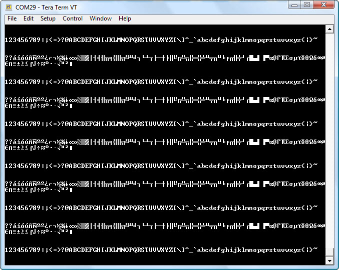

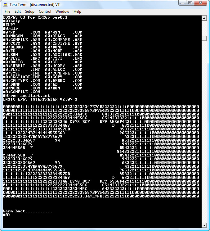

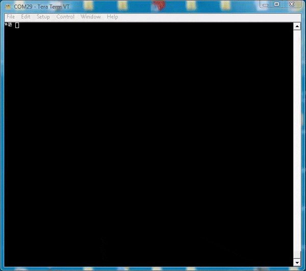

Well, I think I have a working 36MHz 6502 computer! DOM installed, run fine at 5V with 217mA current consumption. It will power up and load DOS/65 from DOM's system track. The software in DOM was for 14.7MHz system so the initial serial bit-bang transmitter is putting out garbage. It can be easily fixed by change couple variables in memory.
Here is a 20-second video of 36MHz 6502 hardware booting DOS/65 and run ASCIIART benchmark.
0:01 Power applied, retrieve program from DOM system track, gibberish output because the bit-bang transmitter is not set correctly for 36MHz.
0:05 started the TeraTerm macro script
0:07 transmitter was set to correct output at 36MHz clock
0:08 booted into DOS/65 and displayed directory of drive A
0:10 ran ASCIIART benchmark
This is still the CRC65 CPLD design so I need to change the memory map to maximize RAM space; I'll need to adjust software for 36MHz operation and after that I'll do pc board layout for a couple designs trying to get even more speed out of this design. I'm shooting for 40MHz operation.

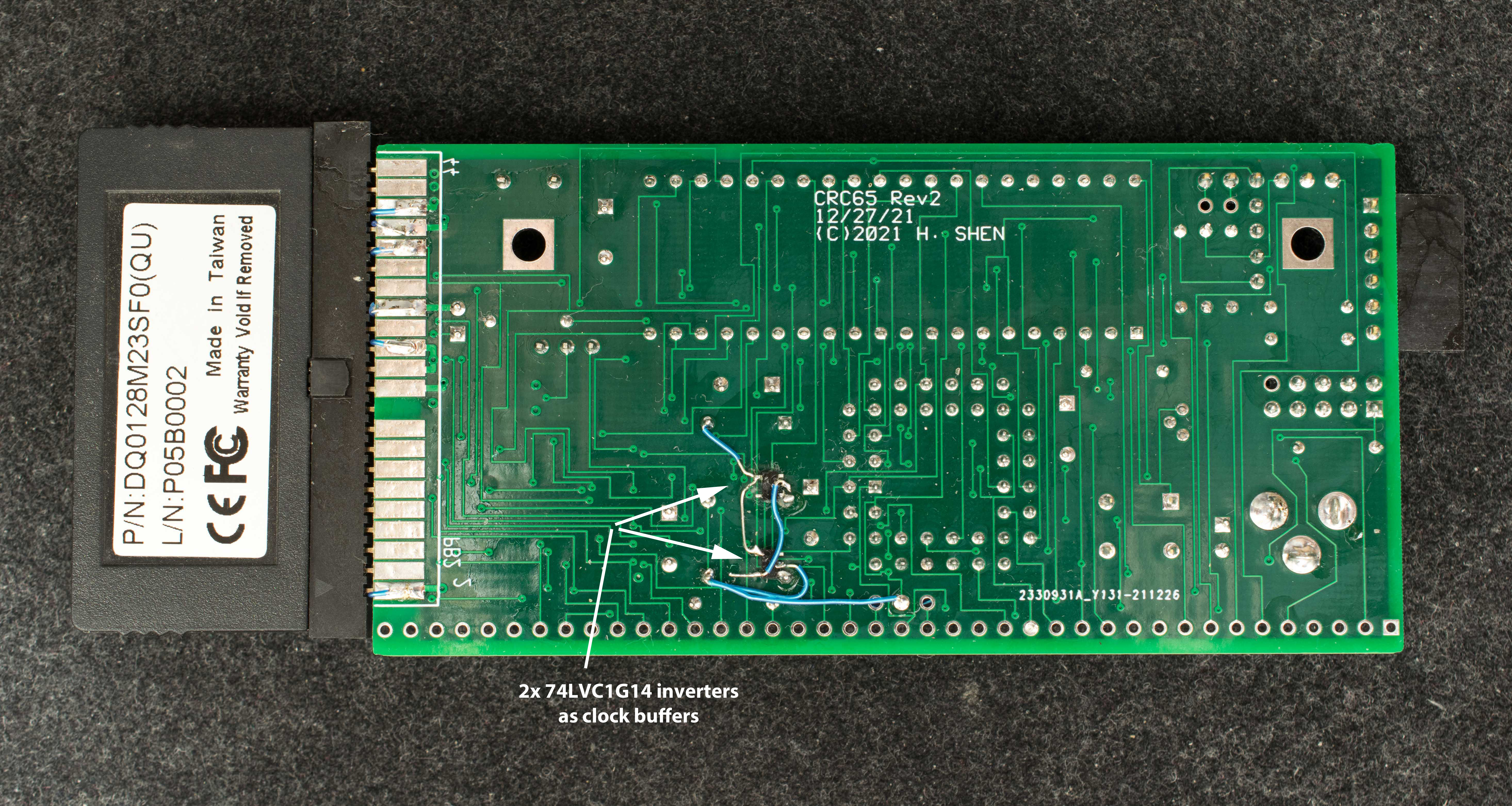

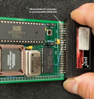

Thinking about the speed improvements of the overclock prototype and how it can be transferred to pc board design, I thought I would take an intermediate step and implement half of the improvements on the existing CRC65 pc board and see what improvement can be achieved. The speed improvements for existing pcb are:
* fast 10nS RAM
* fast decoding of RAM (chip select always asserted)
* buffered clock
* fast DOM interface.
The existing CRC PC board will still have DIP40 W65C02, parallel port with extra loading of address/data/control signals, and long traces between RAM, CPU, CPLD, parallel expansion, and CF interface.
So here is CRC65 rev2 PCB (a 4-layer PC board) populated with 10nS RAM with its chip select pin cut out and grounded. The DOM interface is mirrored image of CF interface, so it requires some hand-wiring to mirror the connector, but fortunately that was accomplished with few short wires. The clock line is cut and one or two 74LVC1G14 is inserted. (74LVC1G14 is an inverter, so depending on the symmetry of the clock, either inverted or non-inverted clock may achieve the most speed improvement.) The small CPLD is already 100% utilized so I have to sacrifice the I2C pins in order to have extra logic for bigger clock divider.
Here is the result: 33MHz operation is good and stable; 36MHz is occasionally achieved but seldom last more than a minute. The clock buffers, either inverting or non inverting, do not seem to make a difference, so clock buffers are not used in the end.
So intermediate PC board solution is not optimal; it is worse than a wired prototype. A dedicated PCB design is needed to get the most speed improvement.

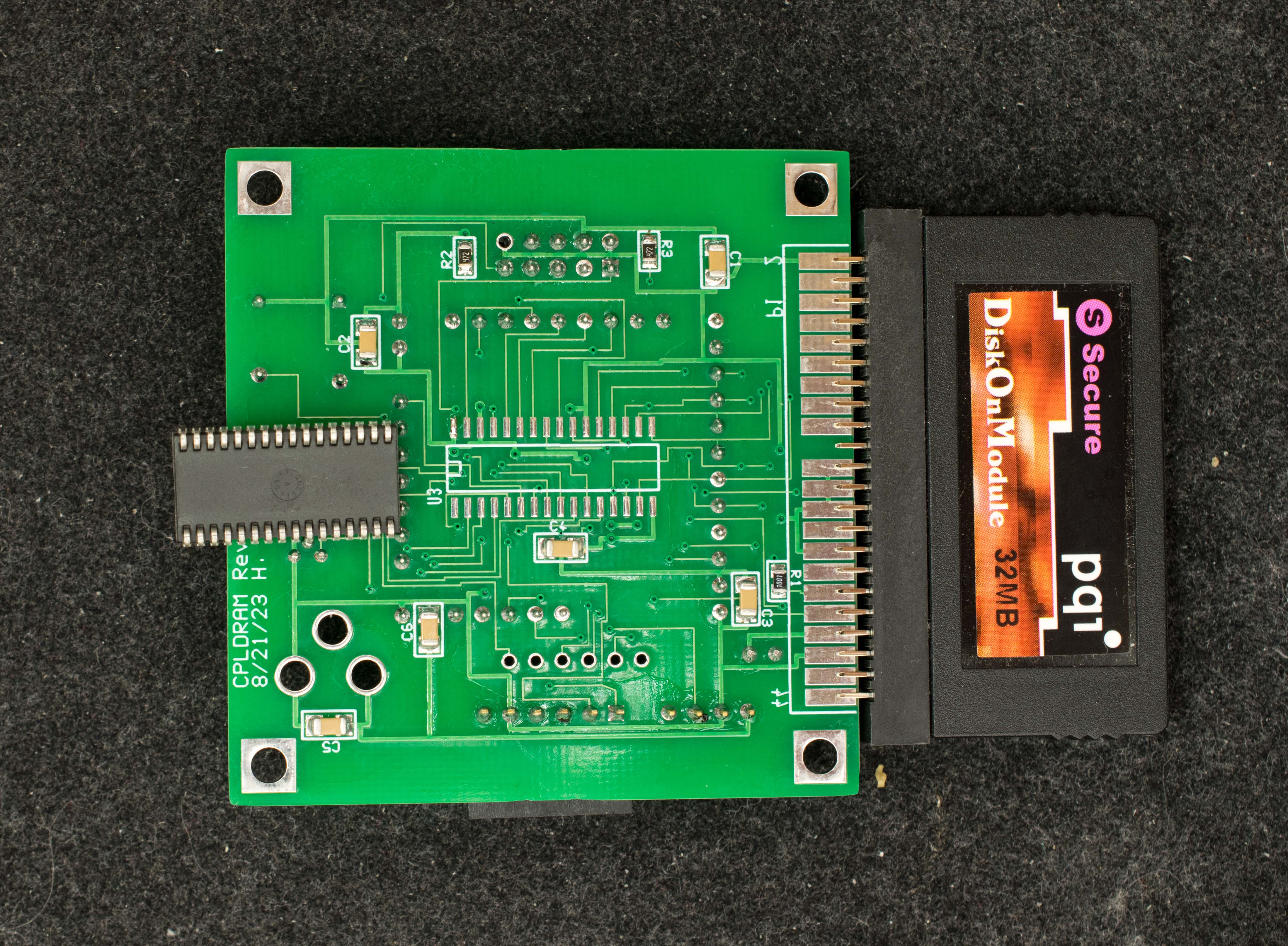

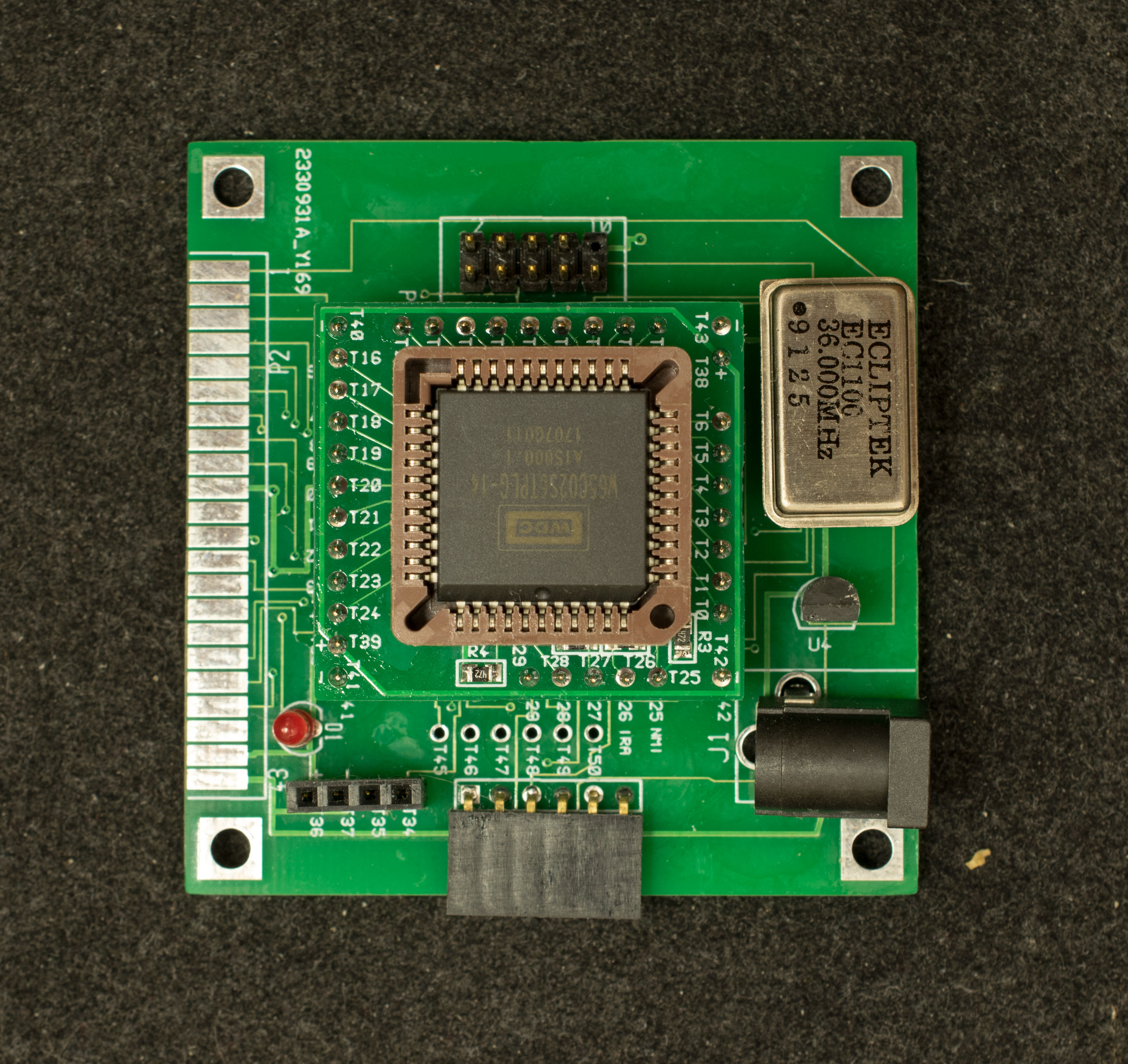

This is my idea of a fast (maybe the fastest) production 6502 computer. It is two board stack such that a PLCC W65C02 carrier board plugs into the sockets arranged as a square on the base board so to minimize connection lengths. The base board has oscillator and EPM7128S CPLD on top and a 128Kx8 fast RAM at the back. It has IDE44 interface, serial port, I2C port and run DOS/65. Except there is a problem: The 128Kx8 RAM is 400mil SOJ32. I used the wrong library of 300mil SOJ32. Oops!
Some creative wiring are needed.

I probably will bent out 16 J leads and solder that to one side of SMT footprint and then connect the other 16 J leads with discrete wires. I was planning to use 10nS CY7C109, but I'll use 25nS CY7C109 instead.
Lots of testing can be done without RAM, just between CPLD and 6502. So I'll do these tests first before getting the RAM patched in. In fact, I'm checking out other boards to identify potential mistakes so I can get several boards corrected on next iteration of pc boards.

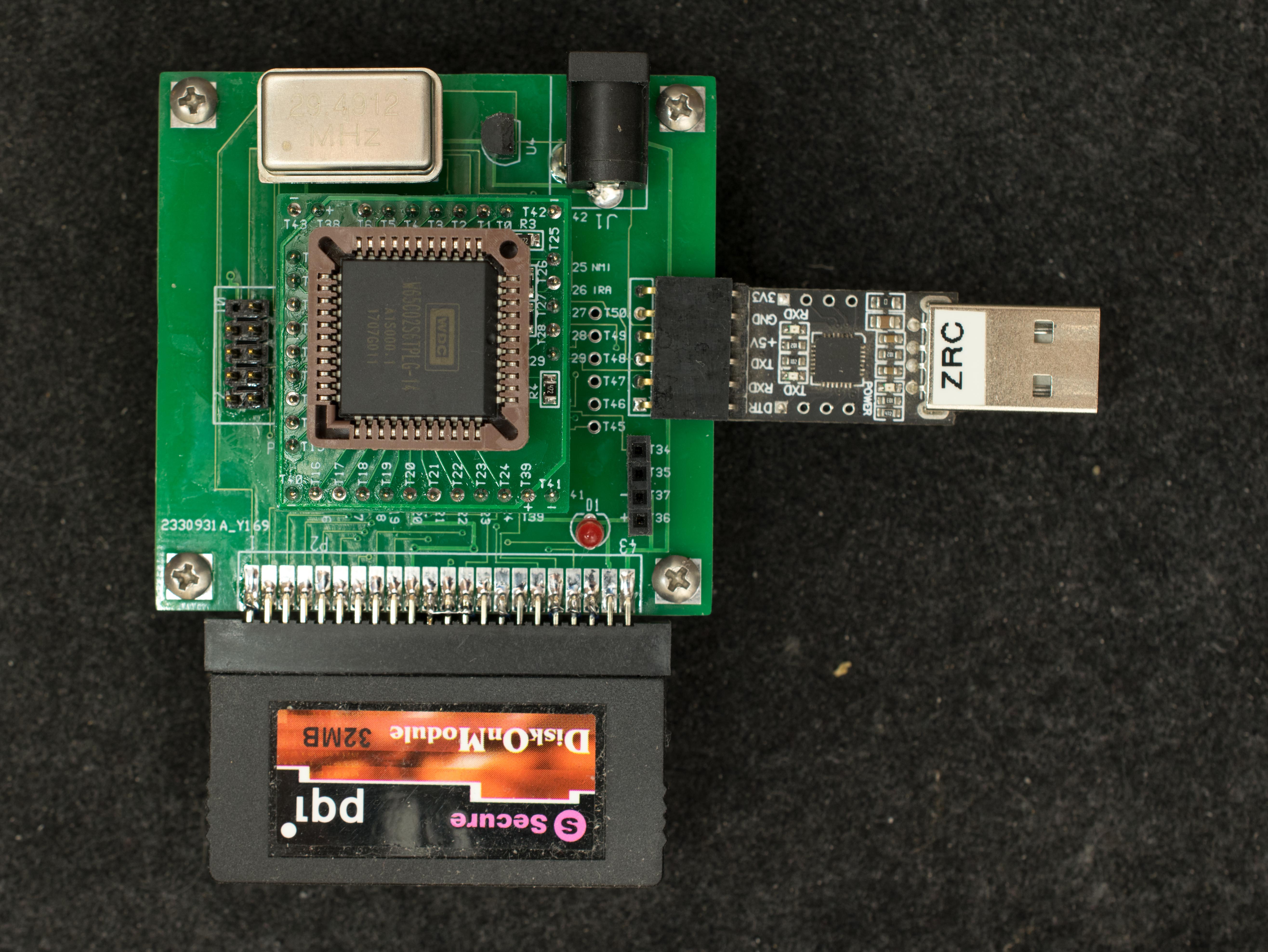

This picture shows a W65C02 mounted on small carrier board plugged into the base board. I have not installed the RAM so right now this is just 6502 interacting with CPLD. In the CPLD is a bit-bang serial transmitter and a small bootstrap program that increment reg A and bit-bang reg A out to the serial port. There are no RAM so the program needs to operate with reg A, X, and Y only. I am able to run this at 36MHz and output the incrementing reg A to serial port at 115200 bps. Unfortunately this won't work at 40MHz, so I may have hit the wall at 36MHz.
Now I will bodge the RAM and see what it can do.

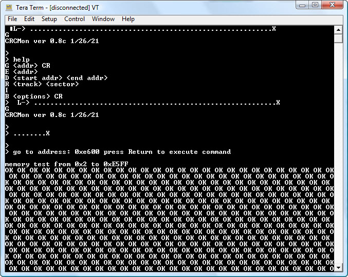

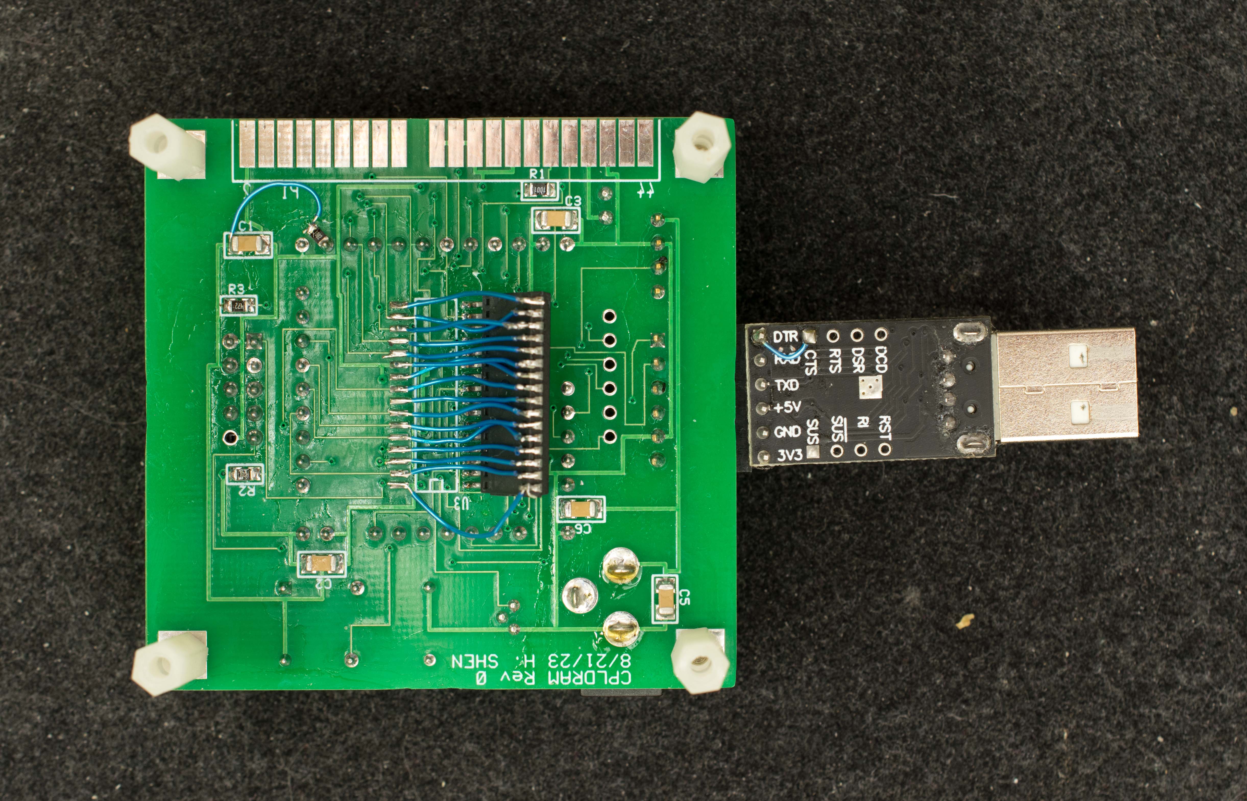

Here is the RAM bodge. I used 25nS RAM. I bent legs on one side of SMT so they can reach the SMT pads and solder the 16 bent legs to the corresponding SMT pads; then I jumpered the other 16 pins with short wires. I added standoff so the bodged RAM is protected. It is not pretty, but it does work. This is at the nominal 14.7MHz where monitor program is loaded and RAM diagnostic ran without errors. Since it is 25nS RAM, I don't expect it to work past 30MHz.

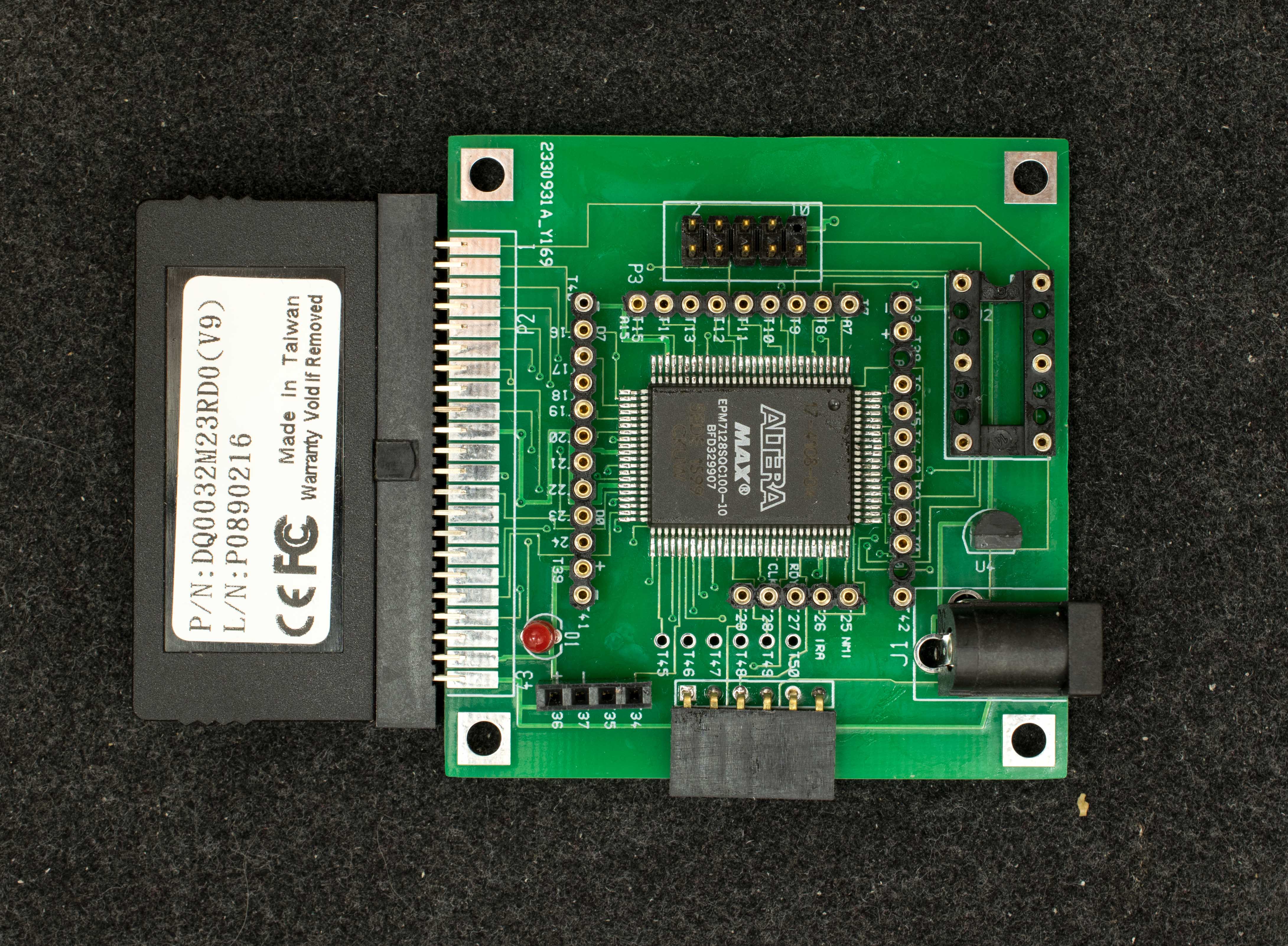

Last update for rev0 pc board:
Added the DOM disk interface. It boots DOS/65 and run BASIC compiler. It will also run at 29.5MHz. So I'm at the limit of what 25nS RAM can do. This concludes the rev0 pc board tests. I'll need to re-spin the pc board to accommodate 400mil SOJ32 RAM.
