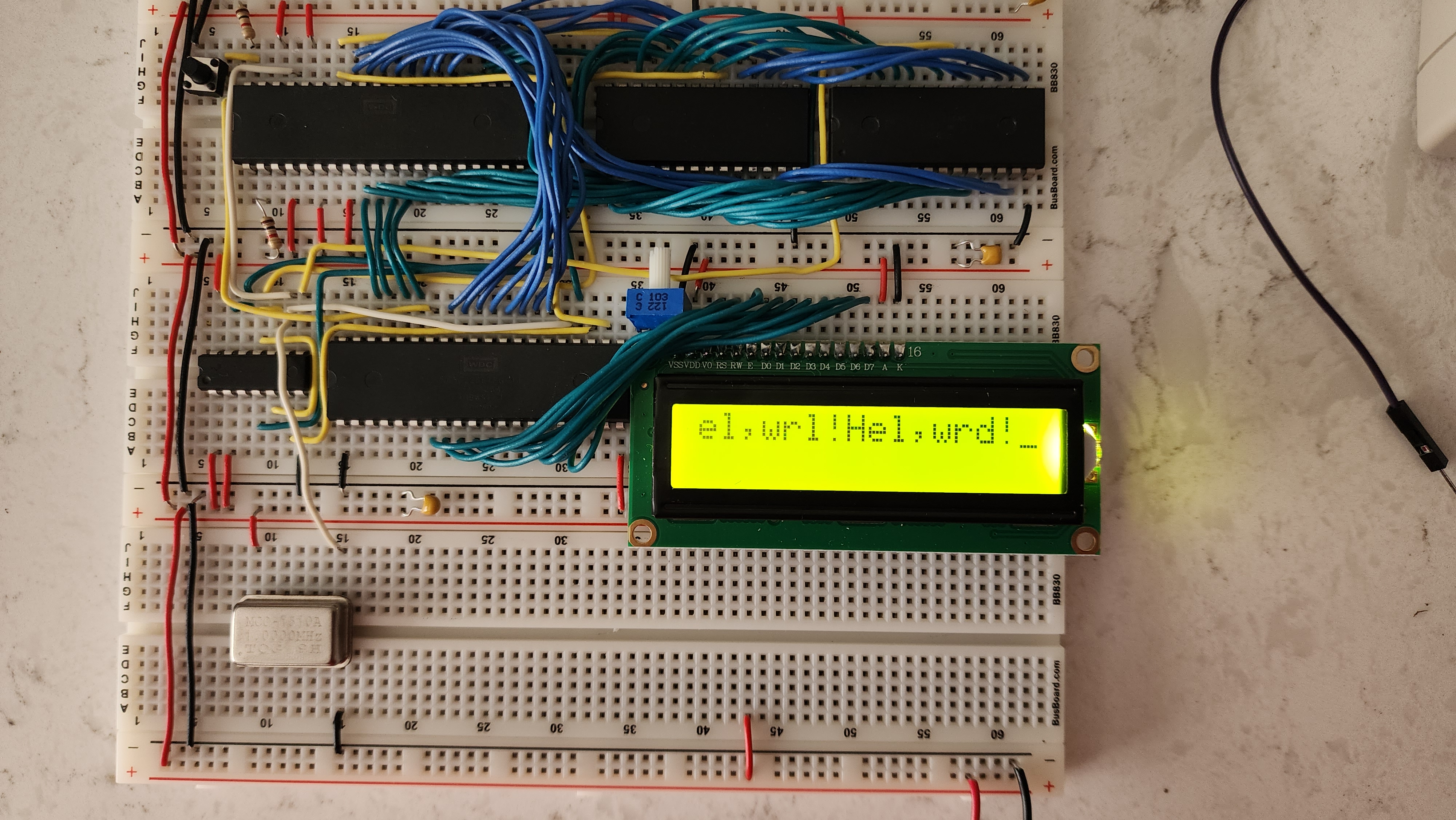

Hi everyone, I recently finished my 6502 build, but am running into some issues with Ben's hello-world and hello-world-final programs. It's running the original hello world program and the LCD text appears jumbled, and sometimes it doesn't show up at all. Additionally, when I run hello-world-final nothing on the LCD shows up. I'm pretty sure everything is wired correctly, however it's certainly possible I screwed something up. I suspect it has something to do with the crystal clock, but that's just speculation on my part. I don't have the timer module to test the computer at slower speeds.
I'm a bit new to this, so sorry if this is a silly question. Also, I know my wiring is a bit messy, and sometimes I stipped a bit too much but I plan to clean it up a bit once I get these issues sorted out.

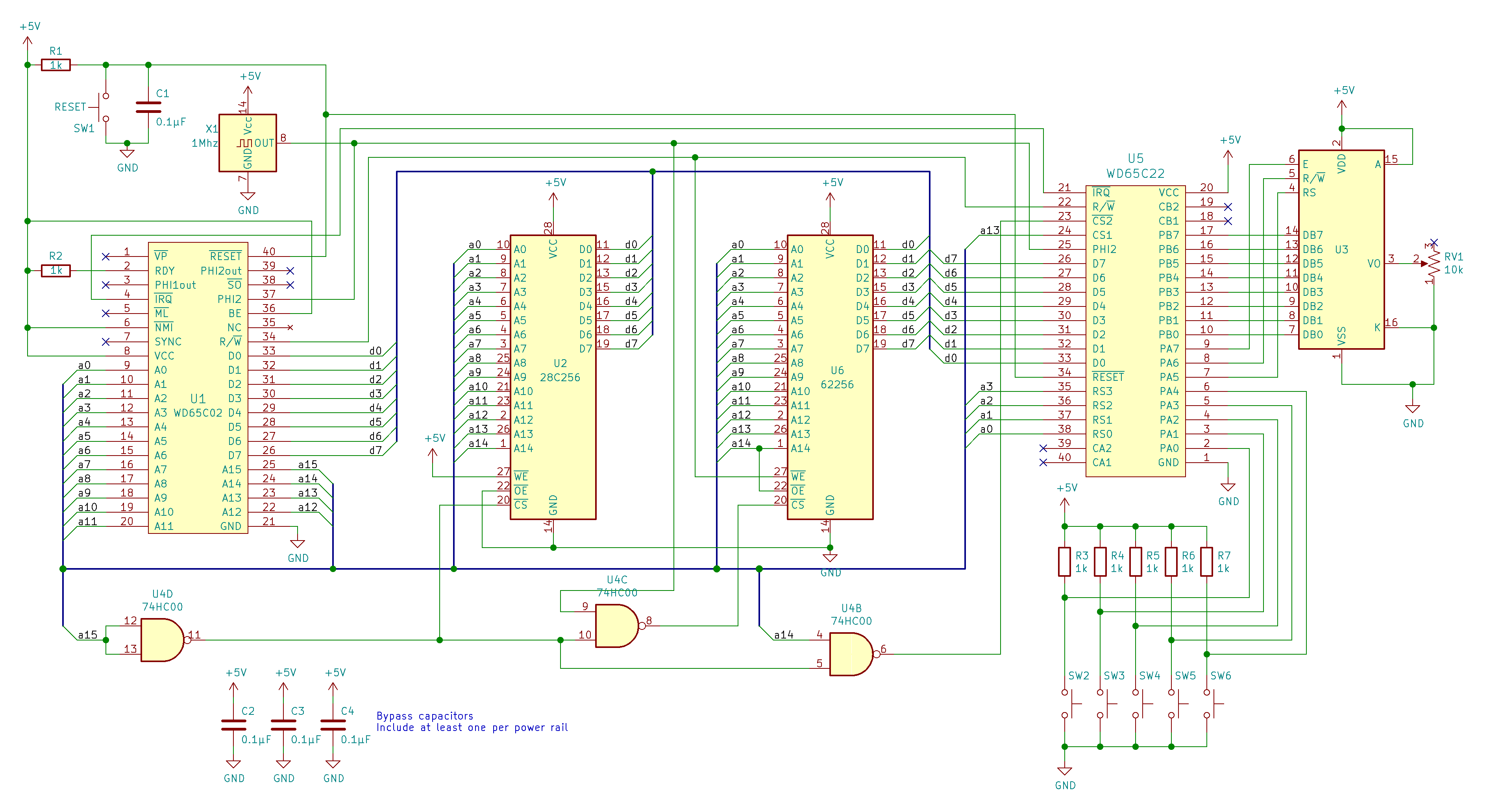

Can you please post a schematic for what you've built (doesn't have to be beautiful), and a link to the code you're trying to run? it will be difficult to help you without that info, I think.

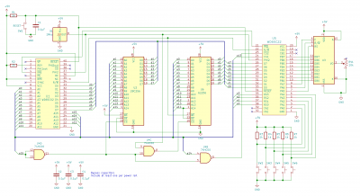

Thanks for posting the schematic. Some folks prefer monochrome, so I've taken the liberty of providing that for you. Cheers,

Well, that's Ben Eater's machine (nicely made too) and his code, so its not the code in error. I'm going to be really cute here and say "its a wiring problem"
Exactly what is wrong is anyone's guess (I suspect not the address lines but it could be
I think step one is go through it wire by wire, connection by connection with a simple multimeter and check good continuity on all wires from where you expect to where you expect and also to where you DON'T expect. Make sure you test from chip pin to chip pin and not just "contunuity" but good continuity i.e. very low resistance. I had a bad time with breadboard so this is the voice of experience!

It's true. Low-quality breadboards -- which unfortunately are all too common -- have been the source of a lot of grief. Our own breadboard wizard, Radical Brad, recommends those made by Twin Industries.

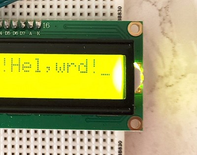

On a different topic, what happened to the circuit board for the LCD ?!
It looks as if a hole was drilled in it, which very possibly could have severed some of the traces. If so, that could explain the difficulties you're experiencing. It looks to me as if your project is 95% working... but something's gone awry in the very final stage, ie -- displaying the output.
I think it'd be helpful to see a photo showing a rear view of that LCD assembly.

Welcome, besser435. There are several possible sources of the trouble, one being the construction method being on solderless breadboards. See more about that in the applicable section of the 6502 primer. (Do go through the whole 6502 primer though, as it addresses the many aspects of making your own computer, including many that the beginner would never have thought of to even ask about. The sections are logically organized, so I recommend going through them first in order, rather than skipping around.)
The problem with the display could also be something we ran up against at work decades ago [1], and after wasting a lot of time, we got a some information from an applications engineer that fixed our problem, information that is continually lacking on these hobby websites. I put LCD source code, in several forms, at http://wilsonminesco.com/6502primer/LCDcode.asm . A reliable reset and setup requires writing the function set three times as shown there; and if you don't do that, you can sometimes get problems like you're talking about.

I note two things that could be problem-causers:
As the others noted, a system constructed on a solderless breadboard is often a hit-and-miss affair. Your unit could be wired exactly to design and still be unstable or DOA due to reactive effects associated with those long, curving wires. Also, with the bypass capacitors so far away from the chips, I doubt they are doing anything for you. That, and you need to get the oscillator a lot closer to everything so the signal that arrives at the chips has a vague resemblance to the signal leaving the oscillator.
- Your reset circuit is insufficient for use with the WDC 65C02. The WDC C02’s reset input is not Schmitt-triggered—you will not get a clean reset with what you have. I suggest you use a Maxim DS1813 reset controller, or implement something like the reset circuit shown on Garth’s website.
- SO on the MPU is floating. SO is an input and must be terminated, usually by being connected to VCC. Left floating, noise pickup on SO could cause the V bit in the status register to randomly set, triggering possible errors in sections of code that use the BVC or BVS instructions.

It might be a wiring problem, but I hope you've duly considered Garth's remarks re writing the function set three times... ie; a software problem. And have you no comment about the damage I mentioned to the LCD assembly?
Of course I can't know for certain what's going on, but to me it's entirely plausible that all your wiring is correct and the computer is working properly... but the message is becoming garbled after it is received by the LCD assembly. Garth's theory could explain this, as could mine.

Jeff, I think that might just be a photo artifact and not a drilled hole. Looks like maybe the backlight is bleeding? Doesn't mean that the LCD isn't the culprit, though! Maybe it's loose.
besser435, you're building a known-working design to run known-working code. That makes your troubleshooting easier, in a way. Either the problem is hardware failure - you've received some component that is defective (pretty unlikely, but not impossible) - or you made a mistake somewhere along the way (much more likely). It's hard to diagnose a mistake from a photo of a breadboard build that doesn't look much different from (actually, it looks nicer than many of) the literally hundreds of other photos of the same kit floating around on Reddit.
The experts who are telling you not to leave CMOS input pins floating and that you need more bypass capacitors are totally right; you should read those links and learn about parasitic capacitance. What's more, it's an easy fix. Adding a bypass cap and a ground return loop to each chip will probably take less than 5 minutes. It might even fix your problem! But I doubt it; Ben's kits usually work in spite of cutting some corners on best practices.
