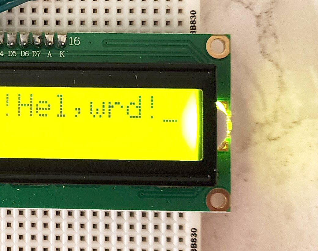

Hi everyone, I recently finished my 6502 build, but am running into some issues with Ben's hello-world and hello-world-final programs. It's running the original hello world program and the LCD text appears jumbled, and sometimes it doesn't show up at all. Additionally, when I run hello-world-final nothing on the LCD shows up. I'm pretty sure everything is wired correctly, however it's certainly possible I screwed something up. I suspect it has something to do with the crystal clock, but that's just speculation on my part. I don't have the timer module to test the computer at slower speeds.
I'm a bit new to this, so sorry if this is a silly question. Also, I know my wiring is a bit messy, and sometimes I stipped a bit too much but I plan to clean it up a bit once I get these issues sorted out.
File comment: All screwy. Ignore the messy wires

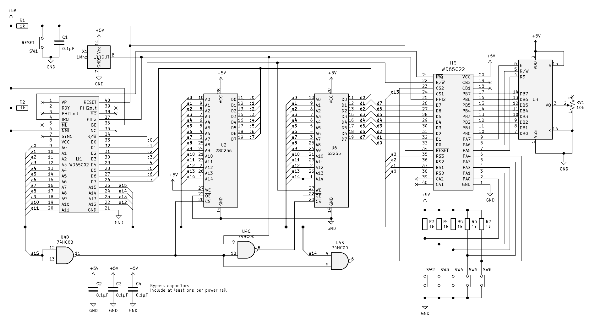

Sorry, I forgot about that. The code can be viewed as plain text here: https://eater.net/downloads/hello-world.s

Thanks for posting the schematic. Some folks prefer monochrome, so I've taken the liberty of providing that for you. Cheers,

It's true. Low-quality breadboards -- which unfortunately are all too common -- have been the source of a lot of grief. Our own breadboard wizard, Radical Brad, recommends those made by Twin Industries.
On a different topic, what happened to the circuit board for the LCD ?! :shock: It looks as if a hole was drilled in it, which very possibly could have severed some of the traces. If so, that could explain the difficulties you're experiencing. It looks to me as if your project is 95% working... but something's gone awry in the very final stage, ie -- displaying the output.
I think it'd be helpful to see a photo showing a rear view of that LCD assembly.

On a different topic, what happened to the circuit board for the LCD? :shock: It looks as if a hole was drilled in it
Well spotted! That's usually where the LED backlight is.

Thanks, Jeff, for publishing the monochrome schematic.
I note two things that could be problem-causers:
  • Your reset circuit is insufficient for use with the WDC 65C02. The WDC C02’s reset input is not Schmitt-triggered—you will not get a clean reset with what you have. I suggest you use a Maxim DS1813 reset controller, or implement something like the reset circuit shown on Garth’s website.
  • SO on the MPU is floating. SO is an input and must be terminated, usually by being connected to VCC. Left floating, noise pickup on SO could cause the V bit in the status register to randomly set, triggering possible errors in sections of code that use the BVC or BVS instructions.
As the others noted, a system constructed on a solderless breadboard is often a hit-and-miss affair. Your unit could be wired exactly to design and still be unstable or DOA due to reactive effects associated with those long, curving wires. Also, with the bypass capacitors so far away from the chips, I doubt they are doing anything for you. That, and you need to get the oscillator a lot closer to everything so the signal that arrives at the chips has a vague resemblance to the signal leaving the oscillator.

It might be a wiring problem, but I hope you've duly considered Garth's remarks re writing the function set three times... ie; a software problem. And have you no comment about the damage I mentioned to the LCD assembly?
Of course I can't know for certain what's going on, but to me it's entirely plausible that all your wiring is correct and the computer is working properly... but the message is becoming garbled after it is received by the LCD assembly. Garth's theory could explain this, as could mine.
If the problem is due to the mechanical damage, you'd need to either test the existing display in another computer, or (better yet) get a new display to test in the existing computer.

Jeff, I think that might just be a photo artifact and not a drilled hole. Looks like maybe the backlight is bleeding? Doesn't mean that the LCD isn't the culprit, though! Maybe it's loose.
Doh! -- of course. Now that you mention, I can easily imagine there's some sort of clear substance acting as a lens. Thanks.
