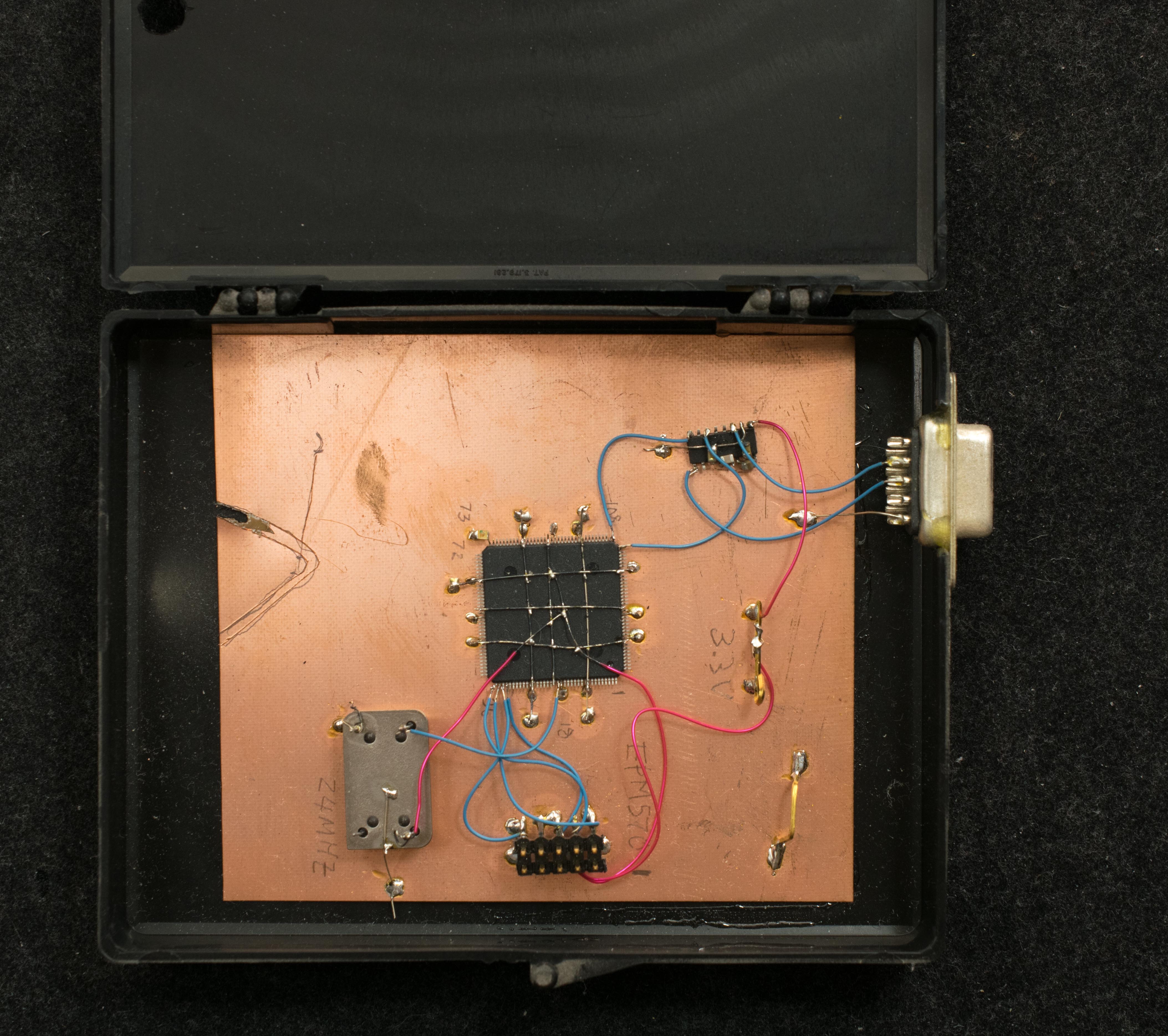

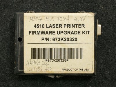

I've also purchased many boxes of recycled plastic anti-static shipping boxes. The inside dimension is 3.5" X 4.5". It makes great enclosure for electronic projects. Sadly I can't find them cheaply anymore.

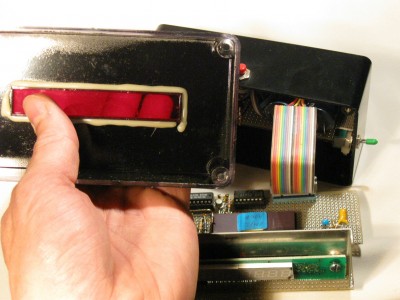

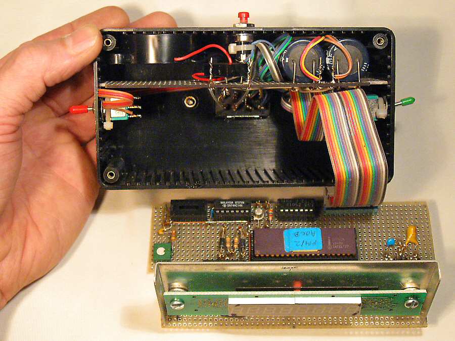

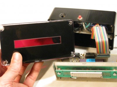

Hammond Manufacturing has project boxes with the front half transparent and the back half not, so I chose one of those. The LED display I was using has a red filter which I detached and located on the inside of the front half of the box. Then I applied black paint, also on the inside of the front. Then glue. With all the pieces assembled there's nothing visible but the LED display.
(What is the project, you ask?
