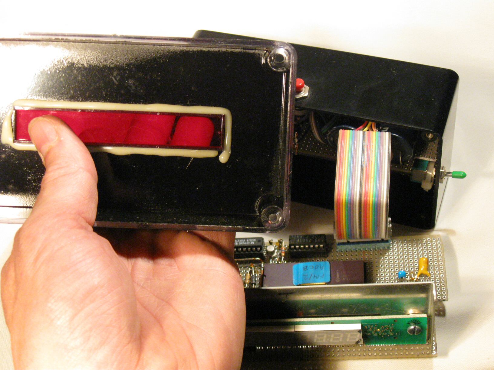

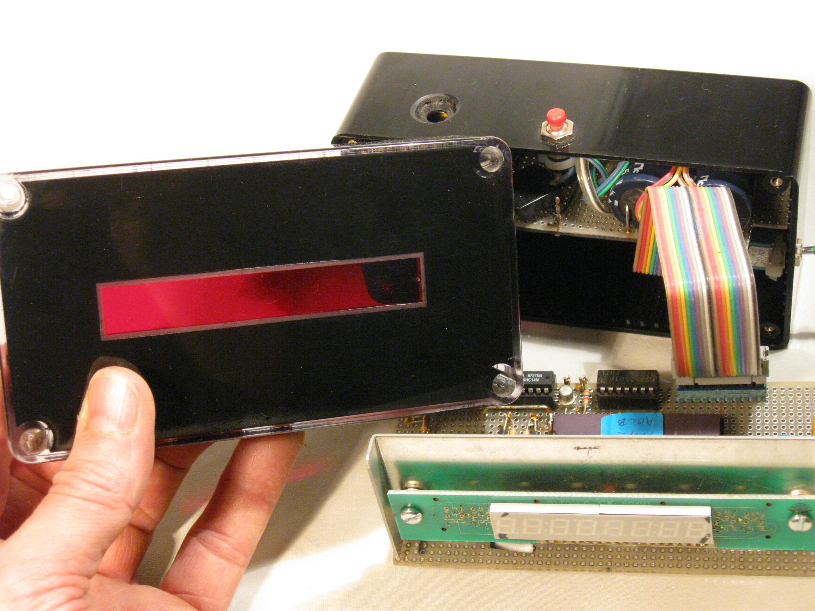

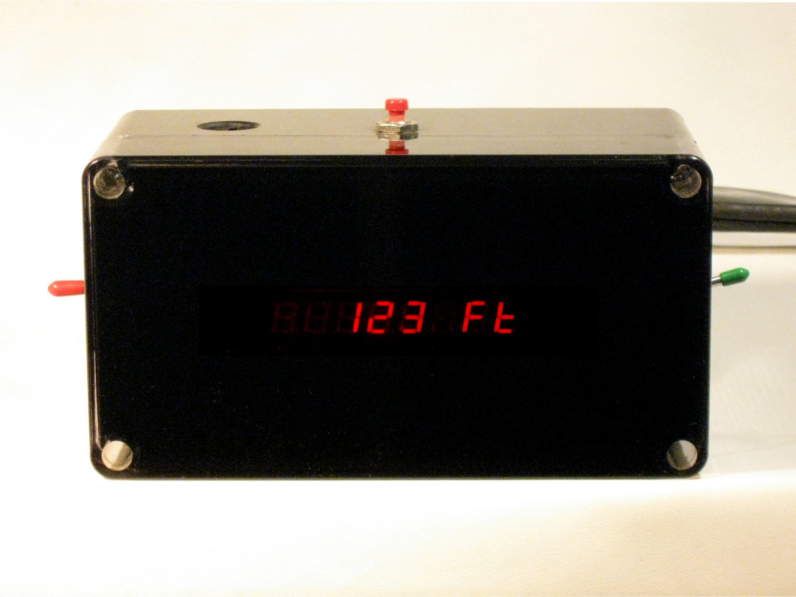

Back in the 20th Century I had a project that featured an LED display. But the thing was for sale to a customer and, for the sake of appearance, cutting a window was something I wanted to avoid.
Hammond Manufacturing has project boxes with the front half transparent and the back half not, so I chose one of those. The LED display I was using has a red filter which I detached and located on the inside of the front half of the box. Then I applied black paint, also on the inside of the front. Then glue. With all the pieces assembled there's nothing visible but the LED display.
(What is the project, you ask? :) See here.)
