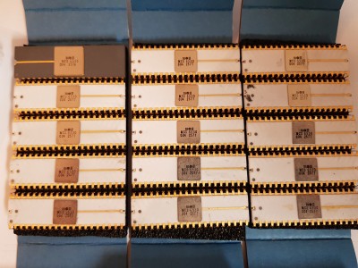

I still have a few 6530-004 left:
That’s probably most of the world’s remaining supply, and ceramic too. I’ve been trying to find some Rockwell branded ones but they are impossible to get.

Did Rockwell also produce 6530-004? I've got a few (ceramic) 6532 from Rockwell.... but no 6530
They did. Their TIM manual appears to be the best reference for TIM boards, but I think they moved on soon after to put a lot of effort into the AIM-65, which appears to be based on the KIM-1 type boards but went way further. There was quite a lot of software for the AIM-65 and you could get video and disk interfaces.

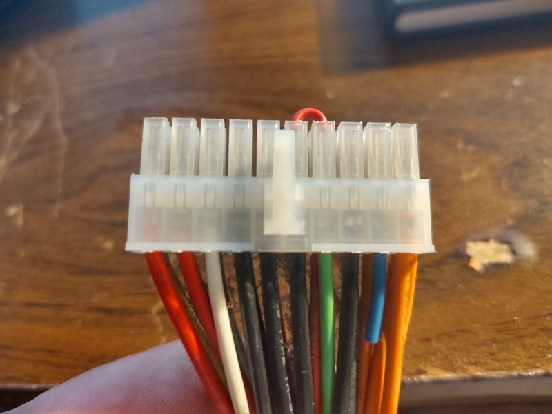

Could you use a PC-type PSU for this? You'd need to find one that doesn't have a no-load shutdown, but it'll provide +12, +5 and -12 safely in a nice big metal box.

... in a nice big metal box.
Not so big. Even the oldest PC SMPS's.
A PC type power supply is a great suggestion. You just need to put a jumper between the green and black wires to bypass the no-load shutdown. Then it'll run as soon as you throw the switch.

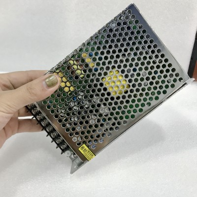

I haven't looked, but I think you could find an inexpensive wall wart or table-top triple power supply with +5V and ±12V. The ±12V (very non-critical, and doesn't even need to be regulated) is useful for a lot of things that might go on a computer board.
Every electronics hobbyist should have a triple bench power supply. I used to recommend the Global 1300 and 1310 which were inexpensive, but they've quit making it. Now they only have much bigger, more expensive ones with far more power than we need for these projects, so I need to find another one to recommend.

I think that is the conclusion I am coming to, that one of these switching power supplies is a good realistic choice, but is also a bit like the old metal box power supplies that the AIM-65 used, or even at a stretch it's similar to the Apple ][. I found a Mean Well unit that had +12 and -12 and I could regulate from there. I don't need -5 and the +-12 is only for the serial port. In a modern design you could do away with that too by going direct from 5V to USB. At the time it was up to the user to provide a power supply in most cases, the power supply not being a part of the system.
Thanks for the suggested units, I hadn't found most of those.
