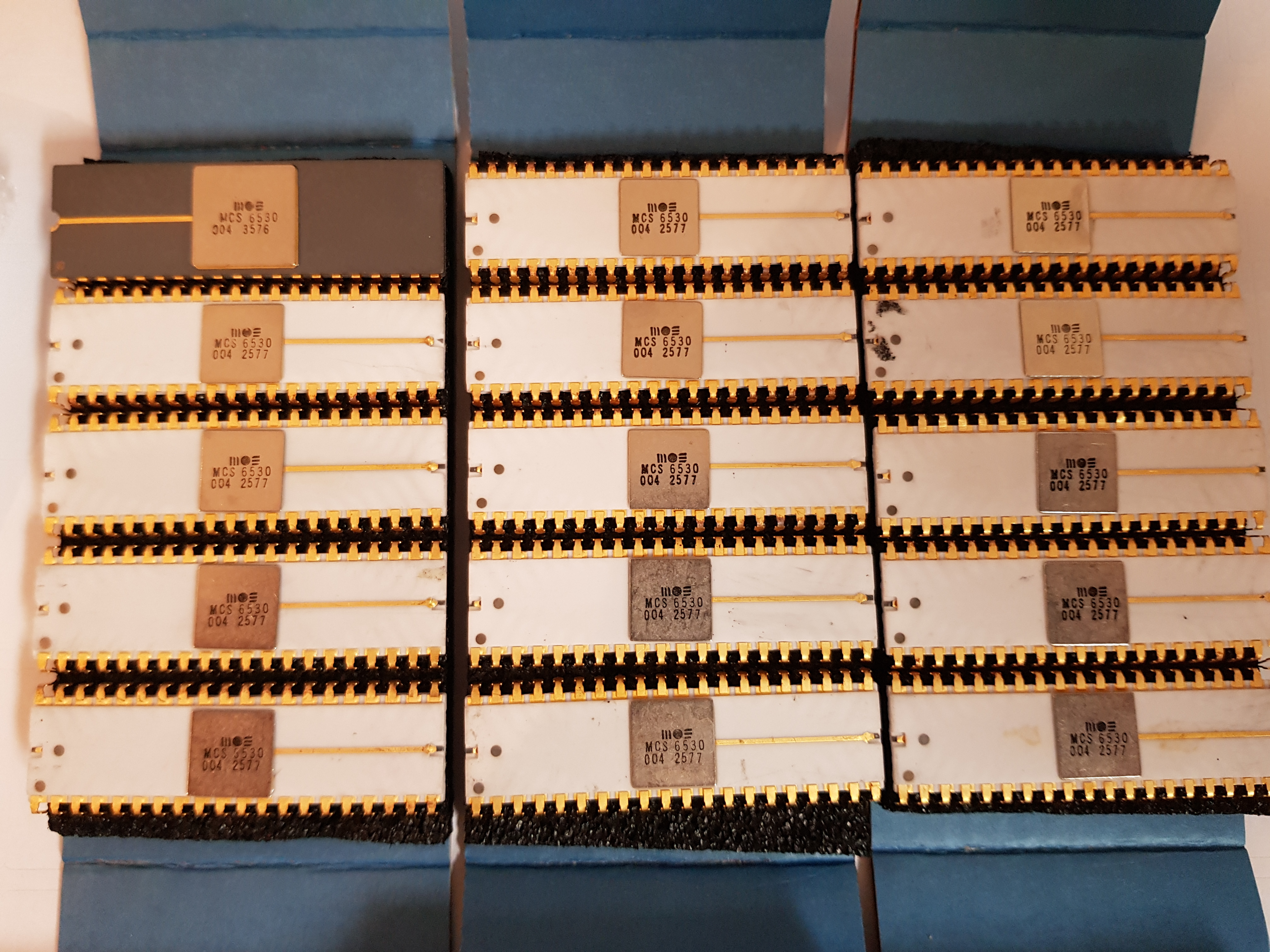

I still have a few 6530-004 left:

Did Rockwell also produce 6530-004? I've got a few (ceramic) 6532 from Rockwell.... but no 6530
Re: [Contest] TIM history
