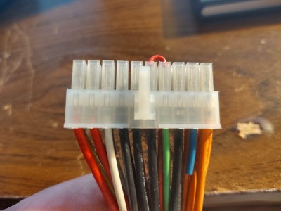

Could you use a PC-type PSU for this? You'd need to find one that doesn't have a no-load shutdown, but it'll provide +12, +5 and -12 safely in a nice big metal box.

A PC type power supply is a great suggestion. You just need to put a jumper between the green and black wires to bypass the no-load shutdown. Then it'll run as soon as you throw the switch.

So far nobody's given any suggestions that don't involve giving up period accuracy. If you are going to abandon that, certainly a modern PC power supply is workable, but you also need to remember that it's not unusual for these supplies to require a minimum load, as well as needing to have the internal switch shorted. And the smaller they are, the noisier the fan. Personally, I'd go with Garth's idea of just sourcing a smaller and quieter switching PSU. There are plenty out there that provide a half amp of -5V and -12V, 1-2 A of +12V, and 4 A or more of +5V. Examples from AliExpress include this, this and this.
