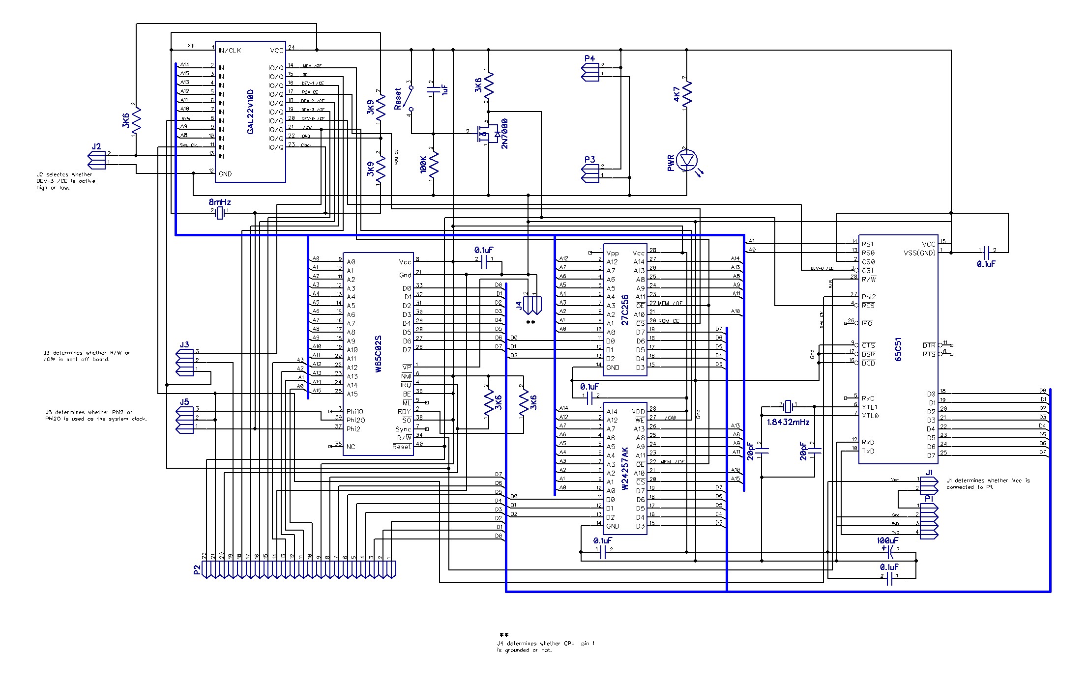

HI All,
This one really has me scratching my head.
This is a different design than before. A much simpler and smaller system with a different intent. It kind of go it's start with a discussion on these boards about a minimal system for running EhBASIC and morphed into a minimal but versatile system. In any case, I'll get into more detail on that when I can get this thing running with the W65C02.
Here is the behavior. It runs absolutely fine with and NMOS or old Rockwell CMOS CPU. In fact, it behaves well over clocked with either of those.
With the W65C02 (for which I implemented the 'lessons learned' from the previous project) it sort of works. It will boot and run the EhBASIC initialization to the READY prompt. From there I can load or enter and edit programs. It will execute the LIST command with or without arguments and it will execute the PRINT command, but only without arguments.
I have tried different ways to select RAM (with and without a short delay on A15) as well as different ways to implement /OE on both the RAM and ROM chips (tied to ground, tied to /CE or tied to !R/WR [inverted R/WR]) to no avail. Delaying the A15 line for RAM select make matter worse. The other changes make no difference.
Any help would be appreciated.
Here is the schematic:
Here is the CUPL Code:

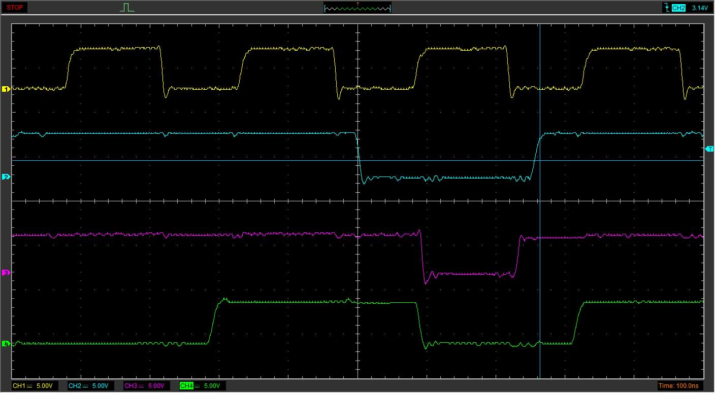

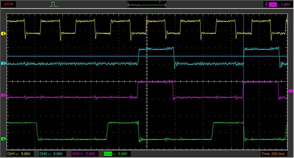

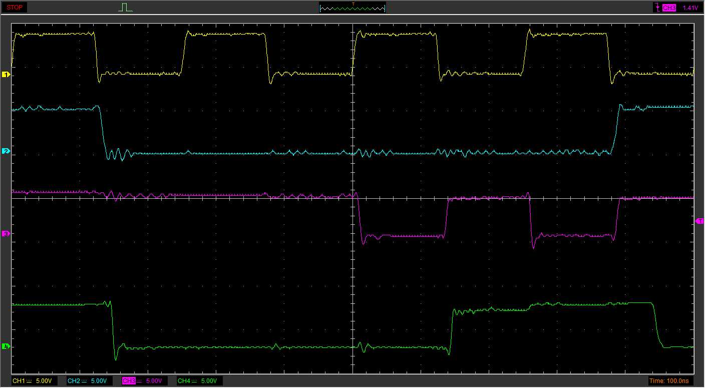

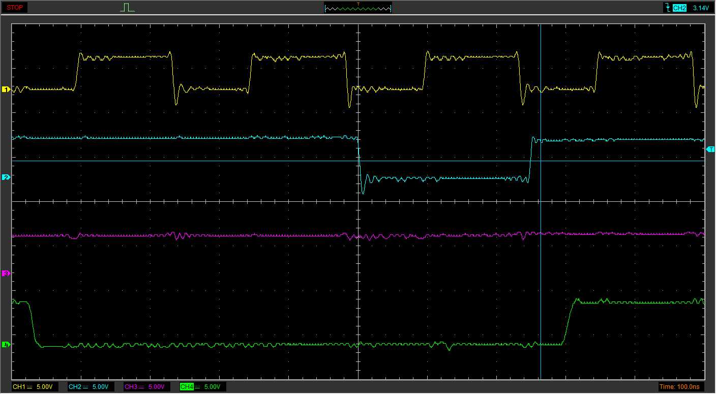

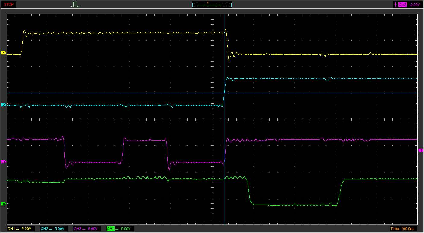

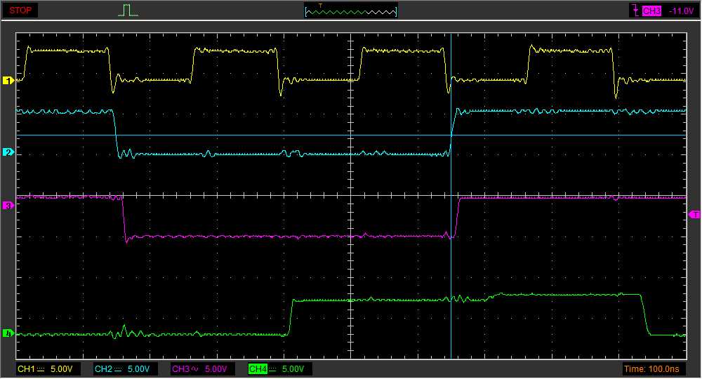

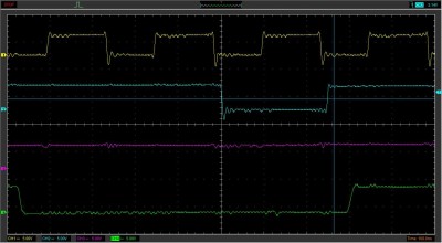

Here are some timing diagrams.

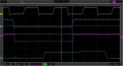

Here are I/O timings. The traces are as follows: Yellow=Phi2 (system clock), Blue= I/O CE, Red=qualified R/W, Green=DB
I/O Read using the Rockwell:
I/O Read using the WDC:
I/O Write for the Rockwell:
I/O Write for the WDC:

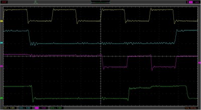

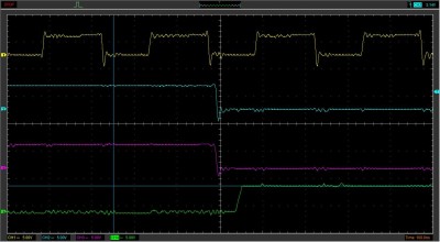

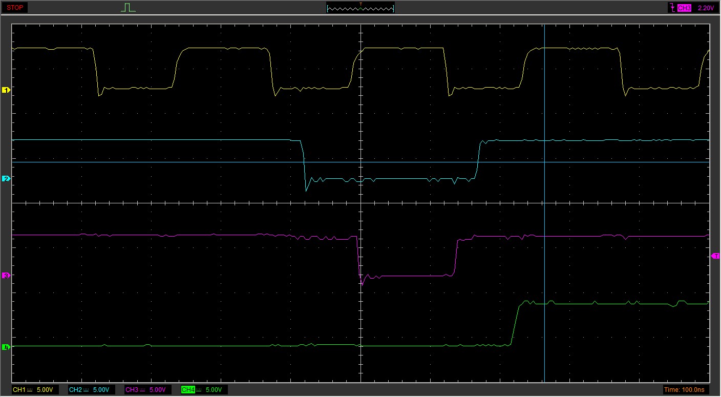

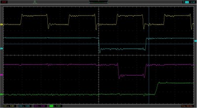

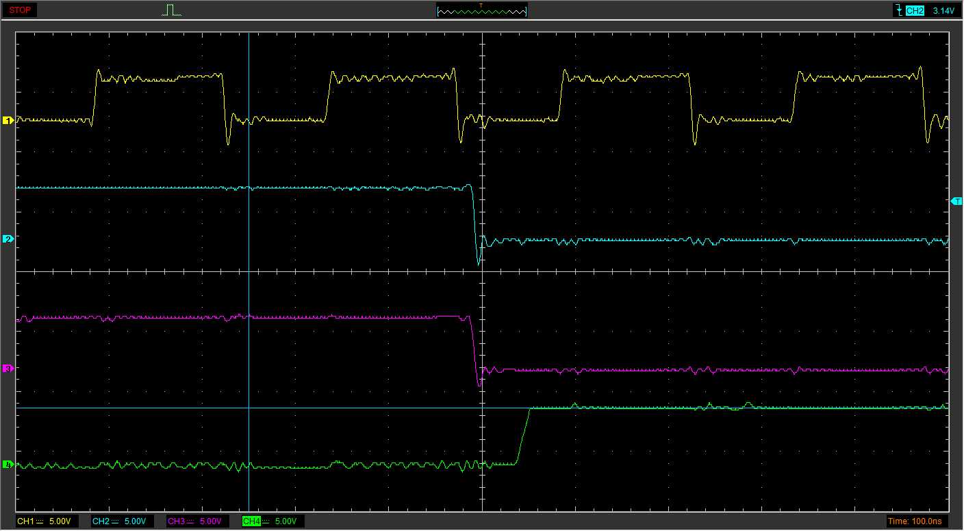

The following are ROM Read timings. The traces are as follows: Yellow=Phi2 (system clock), Blue= ROM CE, Red=/OE, Green=DB
For the Rockwell:
For the WDC:

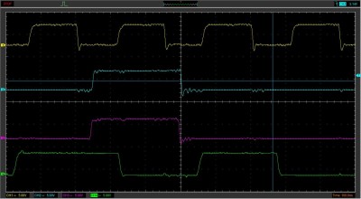

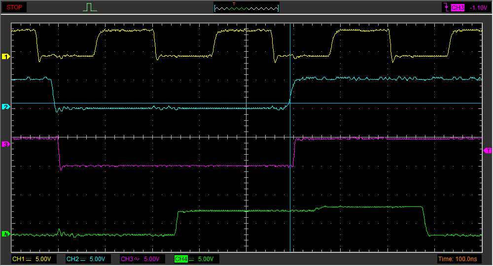

The following are RAM read timings. The traces are as follows: Yellow=Phi2 (system clock), Blue= RAM CE, Red=/OE, Green=DB
For the Rockwell:
For the WDC:

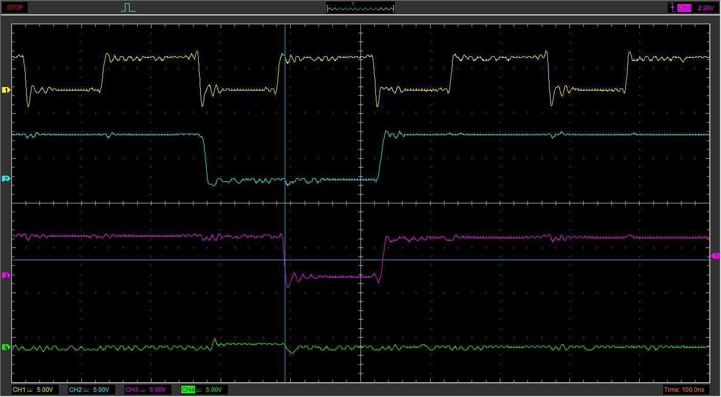

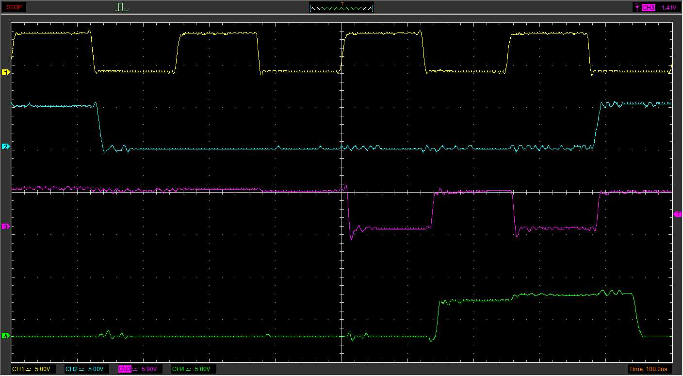

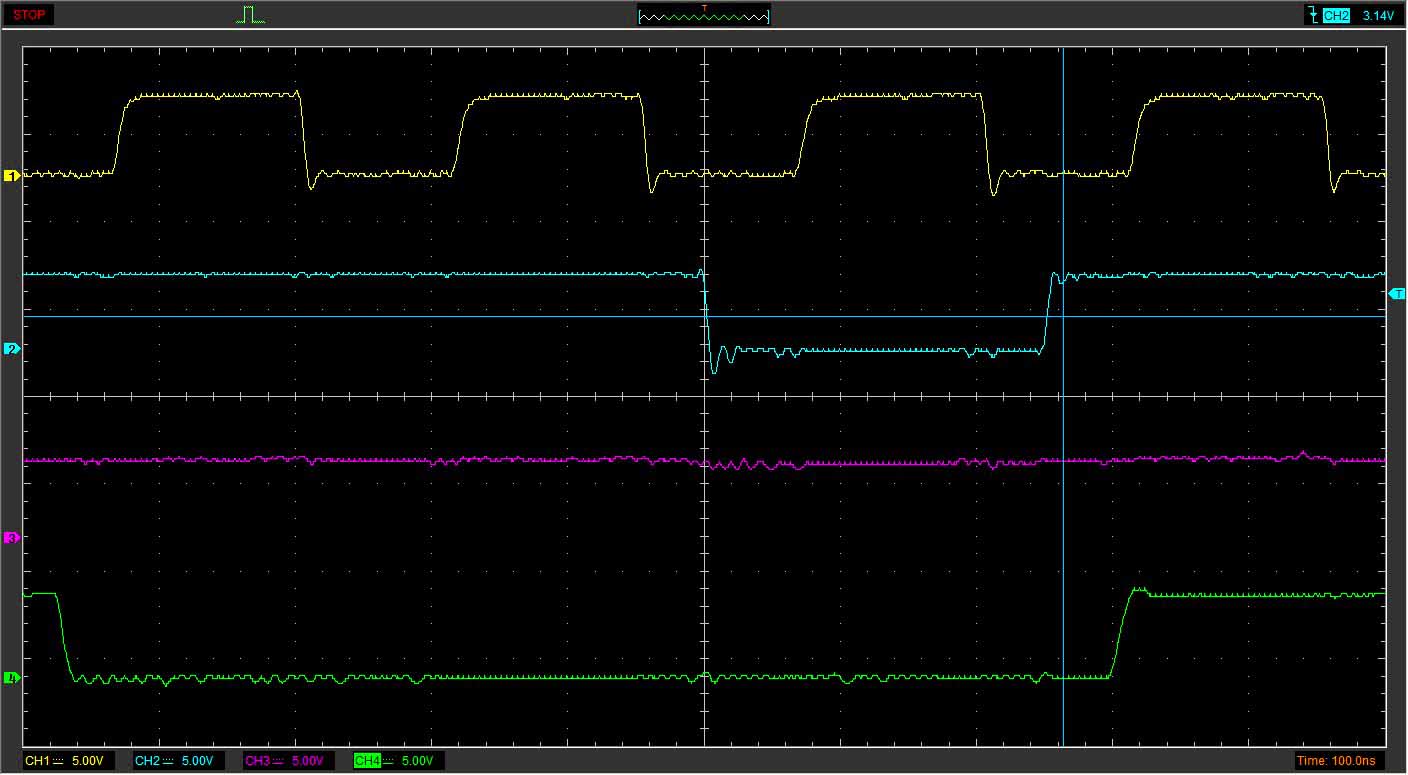

The following are RAM Write timings. The traces are as follows: Yellow=Phi2 (system clock), Blue= RAM CE, Red=Qualified R/W, Green=DB
For the Rockwell:
For the WDC:

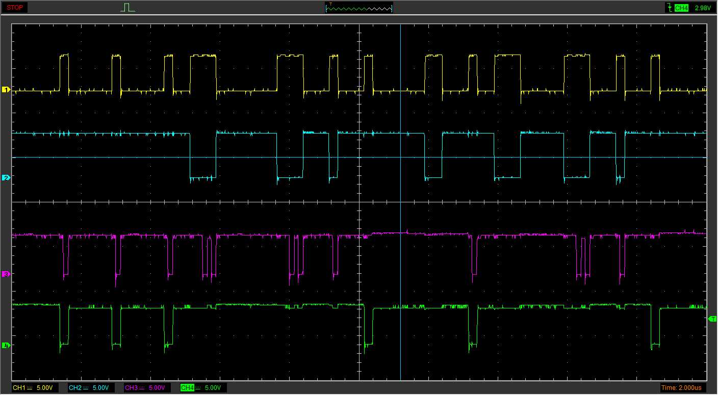

This is an additional view of the WDC RAM Write timing. The traces are as follows: Yellow=/OE, Blue= RAM CE, Red=Qualified R/W, Green=DB
And this final one if a general view of all the Chip Selects when running the WDC chip - just to ensure that no two devices are selected at the same time. The traces are as follows: Yellow=ROM CE, Blue= RAM CE, Red=Qualified R/W, Green=I/O CE.
EDIT - Schematic updated with more labels and notes.

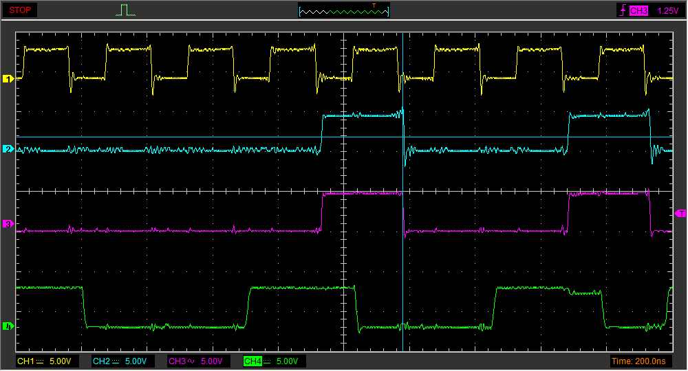

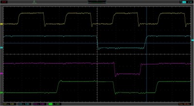

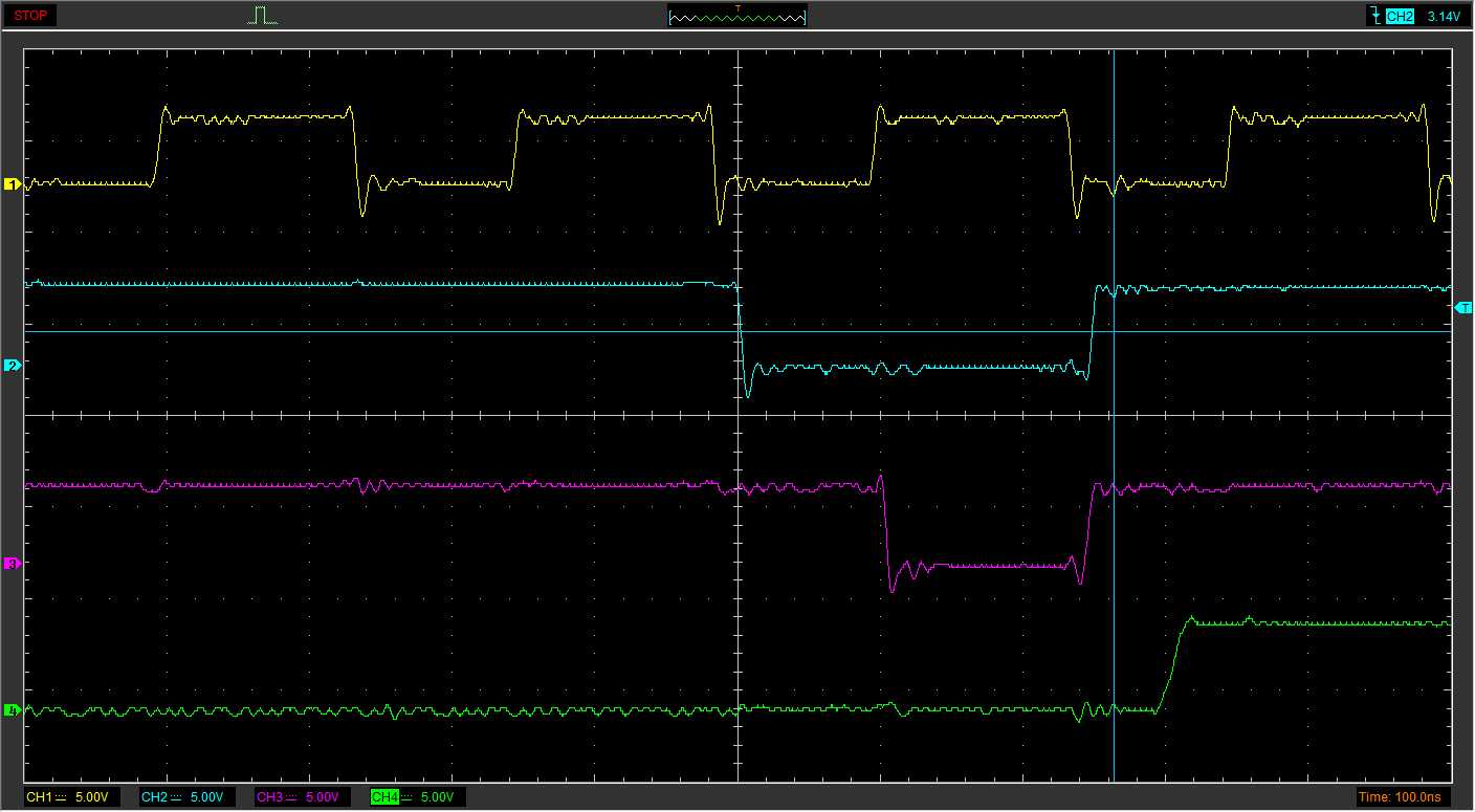

Here are a couple more ROM Read timings: Yellow=Phi2 (system clock), Blue= ROM CE, Red=/OE, Green=DB
Rockwell:
WDC:
Here the data hold time seems much better with the WDC. Go figure...

I'm not getting a warm and fuzzy feeling seeing that raggedy Ø2 clock signal, plus I'm wondering why you choose to generate Ø2 the way you did.
Aside from being asymmetric (not a deal-killer at lower Ø2 rates), Ø2 has got a bit of noise and ringing riding on it. WDC MPUs are noted for being somewhat fussy about clock quality and you may well be perturbing the MPU with the signal it is getting.
WDC strongly recommends the use of an oscillator to generate Ø2, not a crystal circuit. I've got a suspicion your clock is your culprit.

A lot of the ringing comes from scope grounding issues, but it is worse on the clock. I can use a function generator (or even hack in an Oscillator instead) to run the clock. I have tried using the function generator, through the GAL, to supply a symmetric signal - this did not help. However that effor did not 'clean' up the ring on the clock signal.
My next effort will be to hack in an oscillator.

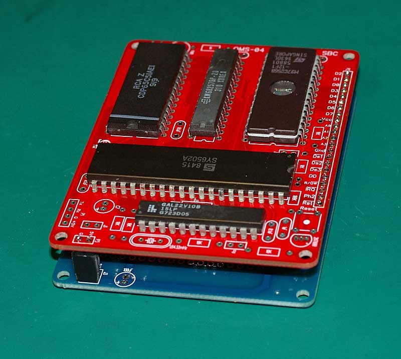

To reduce chip count and real estate consumption. However, I have determined that, if I can get the other things working, I can used a smaller GAL and (barely) fit a 1/2 can oscillator. I am trying hard to keep all the components through-hole. It is supposed to be an easy, minimal, do-it-yourself project that still has some useful expansion capabilities. Think plug on boards - ala Arduino.

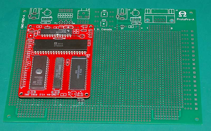

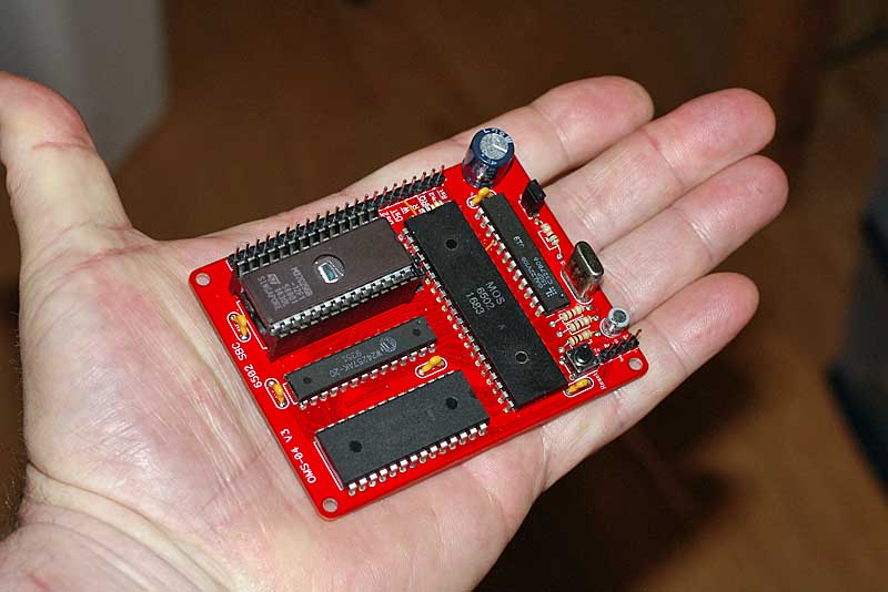

EDIT: Here are a picture of an early prototype and a couple of mock-ups of the application concept.

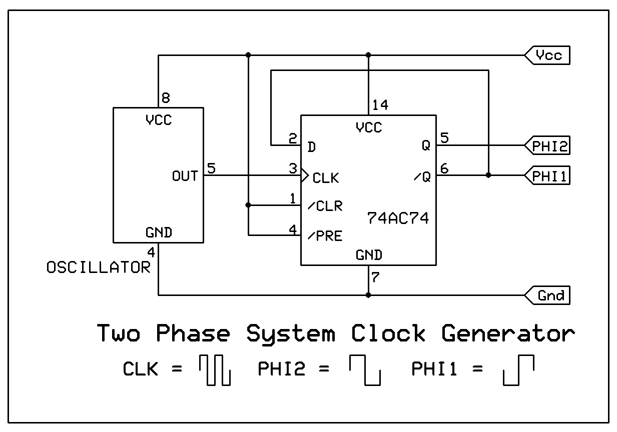

BillO wrote:
I'd like to see the schematics for the system clocks of some working projects.
Two-Phase Ø2 Generator
Above is what is in my POC units. I don't actually use the PHI1 output—I illustrate it for anyone who might need it.
