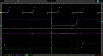

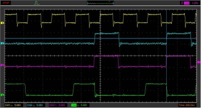

Here are some timing diagrams.
Here are I/O timings. The traces are as follows: Yellow=Phi2 (system clock), Blue= I/O CE, Red=qualified R/W, Green=DB
I/O Read using the Rockwell:
I/O Read using the WDC:
I/O Write for the Rockwell:
I/O Write for the WDC:
The following are ROM Read timings. The traces are as follows: Yellow=Phi2 (system clock), Blue= ROM CE, Red=/OE, Green=DB
For the Rockwell:
For the WDC:

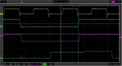

The following are RAM Write timings. The traces are as follows: Yellow=Phi2 (system clock), Blue= RAM CE, Red=Qualified R/W, Green=DB
For the Rockwell:
For the WDC:
This is an additional view of the WDC RAM Write timing. The traces are as follows: Yellow=/OE, Blue= RAM CE, Red=Qualified R/W, Green=DB

Here are a couple more ROM Read timings: Yellow=Phi2 (system clock), Blue= ROM CE, Red=/OE, Green=DB
Rockwell:
WDC:
Here the data hold time seems much better with the WDC. Go figure...

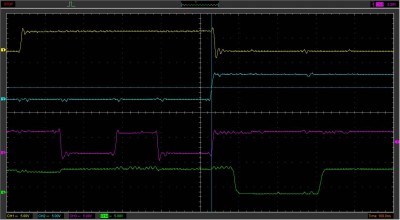

PostPosted: Fri Jun 15, 2018 2:03 pm
Posts: 1007

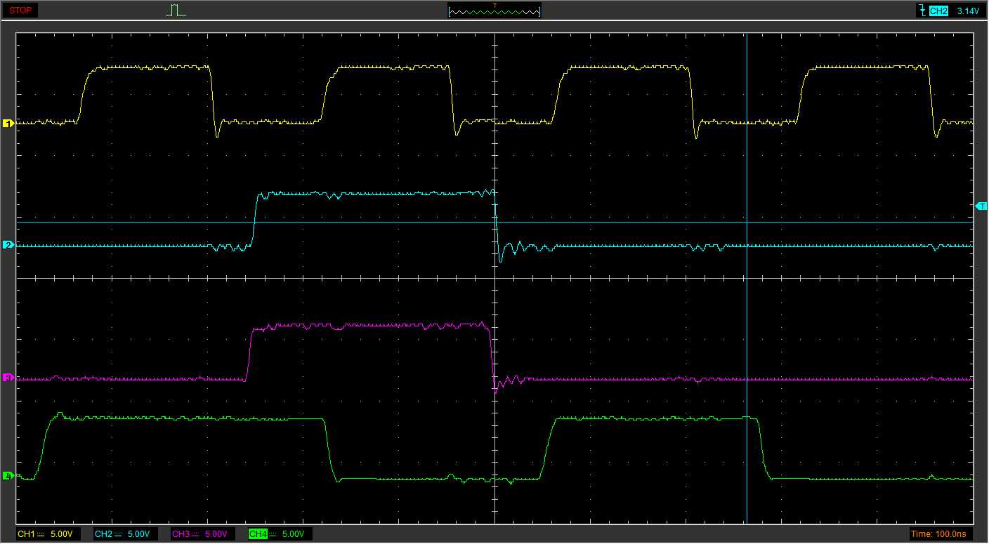

Using an Oscillator didn't help. Still the same behavior - won't run a program, won't execute PRINT with an argument.
However, it did clean up the clock signal. You can see from the following scope shot that the ring is no worse than /QW (red) or the data bus (green).
I'm fairly sure most of the remaining ring is in the scope grounds as all the fast signals have about the same amount. The RAM /CE signal (blue) has a much lower slew rate which I believe will reduce (but obviously not eliminate) the amount of ringing.
EDIT:
Okay, I went ahead and scrounged up one of those little spring pig-tail grounds for my best scope lead and used that on the clock. You can see in the following scope shot the clock is nice and clean.

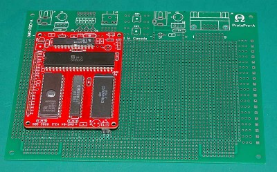

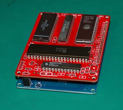

To reduce chip count and real estate consumption. However, I have determined that, if I can get the other things working, I can used a smaller GAL and (barely) fit a 1/2 can oscillator. I am trying hard to keep all the components through-hole. It is supposed to be an easy, minimal, do-it-yourself project that still has some useful expansion capabilities. Think plug on boards - ala Arduino.
EDIT: Here are a picture of an early prototype and a couple of mock-ups of the application concept.

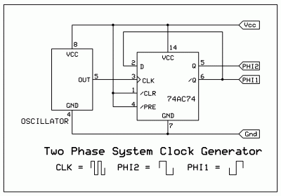

BillO wrote:
I'd like to see the schematics for the system clocks of some working projects.
File comment: Two-Phase Ø2 Generator
Above is what is in my POC units. I don't actually use the PHI1 output—I illustrate it for anyone who might need it.
