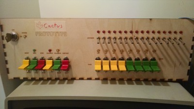

Greetings! I'm surprised I didn't visit this forum sooner. I'm not really sure where to start with all of this so here goes the short story of The Cactus.
Front panels are pretty
A few years ago, I saw an OSI-300 on display at VCF East. I had never seen a 6502 machine that was so spartan, and more importantly was using toggle switches and LEDs instead of a hex keypad/display, with a ROM to help you out. Other processors commonly had front panel interfaces, but why not 6502's?
I wanted an OSI-300, but I knew they were prohibitively rare. I briefly thought I could make my own, but the lack of a schematic and the awareness of my own ignorance made the task a bit too daunting. The good news was that within 6 months, a mini OSI-300 kit was available so I bought a pair. It was eye opening and fun, but the tiny switches made it tough for me to use for more than a few minutes. I figured I could make a few changes to it and improve the usability.
Some time later, I saw Grant Searle's low-chip count 6502 design with serial and BASIC aboard and wondered if the two concepts could be united, Altair 680 style.
That idea spiraled out of control. I started designing schematics for a complicated front panel interface that had features I figured would be nice. Things like:
  • Hopping to an address location, then incrementing with the press of a button.
  • Viewing, modifying, and re-entering bytes on the data bus, without having to re-enter the entire byte. Say you mistakenly entered 2C instead of 2D? Rather than clear the entire byte Kenbak-1 style, just change the bit that you messed up.
  • Set/Clear momentary switches, like an HP-1000 which I got to experience at VCF MW last year.
  • Observing the data and address buses while the CPU is running for maximum blinkenlights.
  • Features like Deposit, Deposit Next, Examine, and Examine Next.
  • Modular cards, to allow easy improvements.
  • Slow clock speed, right around 1MHz to allow use of older components.
  • Single stepping the CPU (the one thing I know is considered to be the most unlikely goal on a 6502)

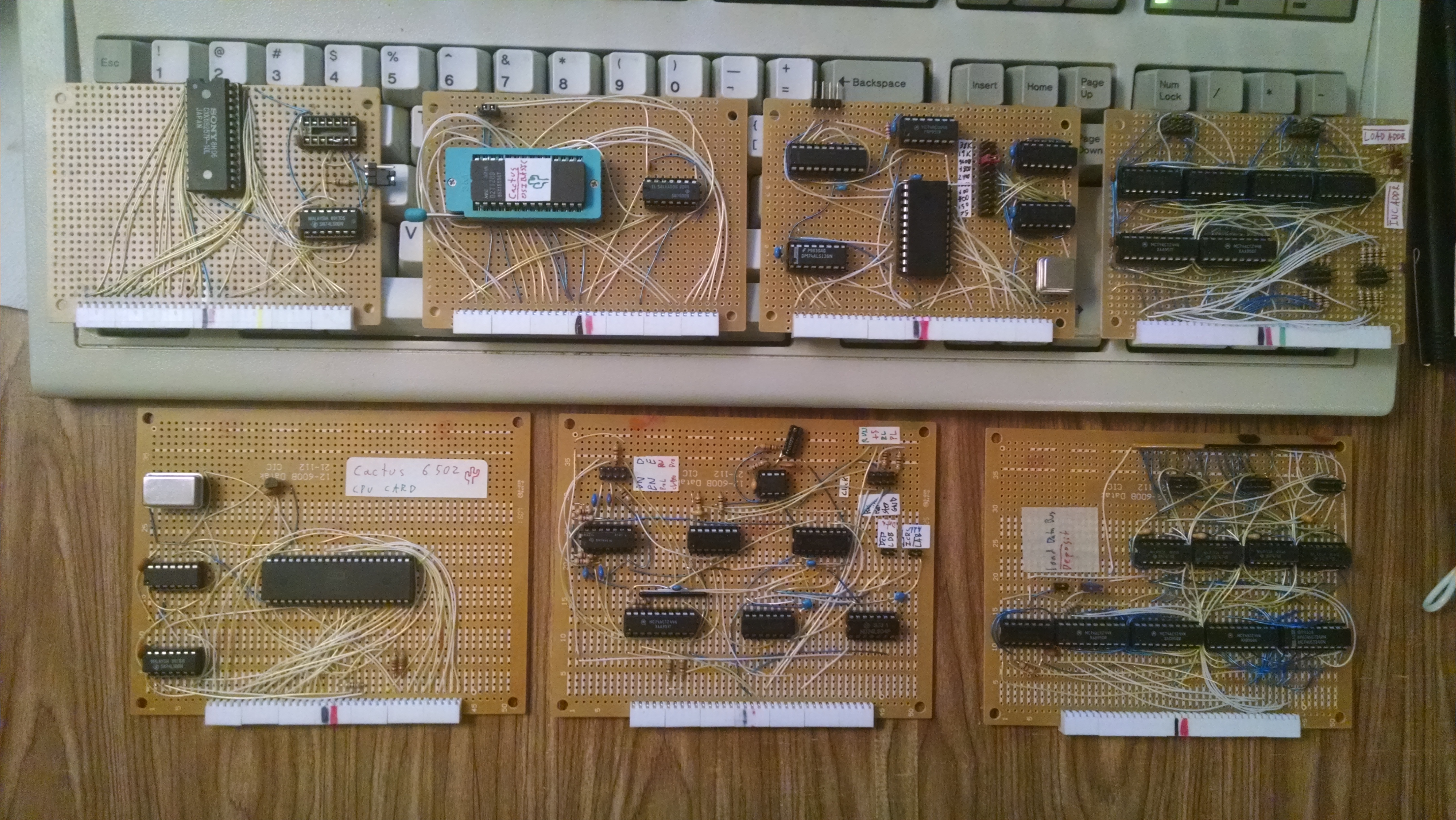

So for the last year, I've been hard at work designing and building my machine, piece by piece. My starting point was to separate Grant's design into individual cards and put them on a backplane. I breadboarded his design as a test article, then modified it slightly to match the baud rates I would be using. I upgraded to a modern WD65C02S for kicks (from an old NMOS Commodore made 6502), only to discover that the modern ones have a Bus Enable pin, and a static core which might make my single stepping dream come true.
The 7 cards I've built so far.  Top row: 32K RAM, 16K EPROM, selectable baud rate serial card, address control card.<br />Bottom row: CPU card, status control card, data control card.
I constructed front panel interface cards, one at a time, resulting in 7 cards. 32K RAM, 16K EPROM, selectable baud rate serial card, address control card, CPU card, status control card, data control card. While the CPU is running, the front panel logic cards are supposed to sit quiet and observe the bus but not interfere. When the CPU is halted, they are to unlock and let you visit addresses, observe and modify data, and otherwise play... that's the idea anyway.

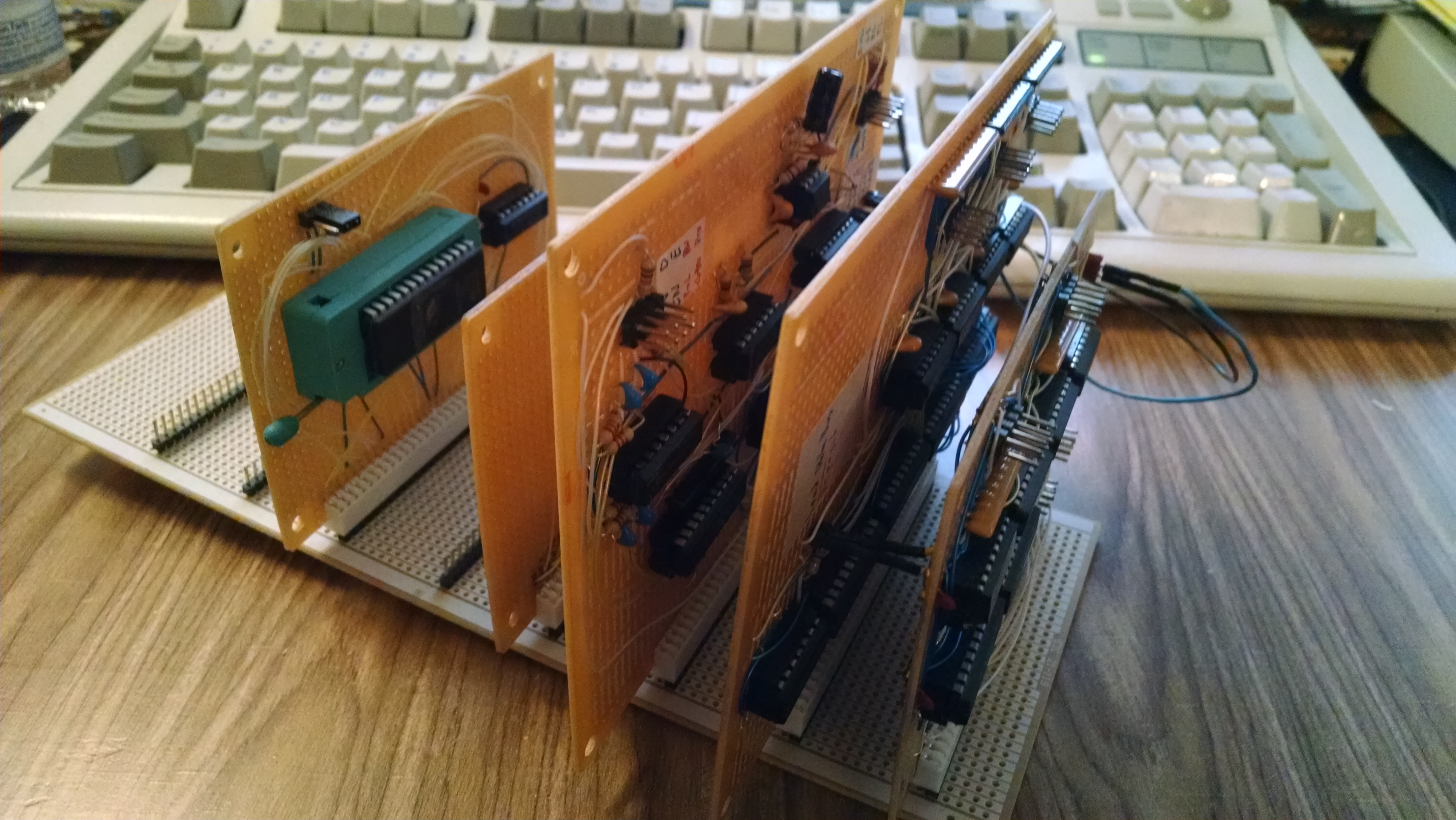

Cards on a bus
Cards on a bus

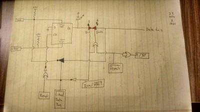

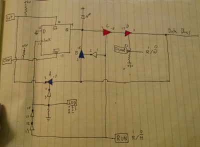

Onto the front panel control cards!
In theory, they should be self sufficient enough where if you had a device on the bus with an address, you could view the data on that device, with or without a 6502 sitting on the bus. In practice, I've fouled up something well enough that each card works fine on it's own on the test stand, then fails to work find in concert while connected to the bus, talking with other cards.
Data Control Rev 6
Data Control Rev 6
Data Control Card
Here we see the fundamental element of the data control card which is far more complicated than it needs to be. This has to be like revision 6 by now. There are effectively 8 of these, one per byte. Thus, there are 8 D-latches acting as RS flip-flops (7474's), and 8 of each tri-state buffer (3x 74244, 1x 74240). The inverters that control the buffers are not duplicated.
The idea is that we can load a value from the data bus into these D-latches. The load signal clears the flip-flop, and then lets any 1's populate their respective flop-flops. Say you made a mistake, and need to change a single bit, you use the set/clear momentary switches to make your changes. This will be visible on the LEDs, while not interfering with the data bus. When you are happy with the value, you can deposit it right back onto the data bus by twiddling the R/W line to make RAM overwrite the new value.
However, all of that is rendered dormant while the CPU is running. One buffer prevents this card from interfering with the data bus. while another buffer now allows the LEDs to directly view data bus activity. The flip-flops are cleared whenever the CPU is running.
Data Control Rev 8
Data Control Rev 8
I've managed to simplify the design a bit since this point for revision 8, but I'm holding off on building the improved version for the moment. Every time I think I've reduced the complexity on this card (while retaining the same functionality), someone consistently points out a new way for me to improve it (which I should note is more than welcome). Rev 8 doesn't reduce the chip count all that much, but it does reduce the total gates to 29, and eliminates quite a few wires, which makes me happy. I wish I had understood the 74245 sooner.

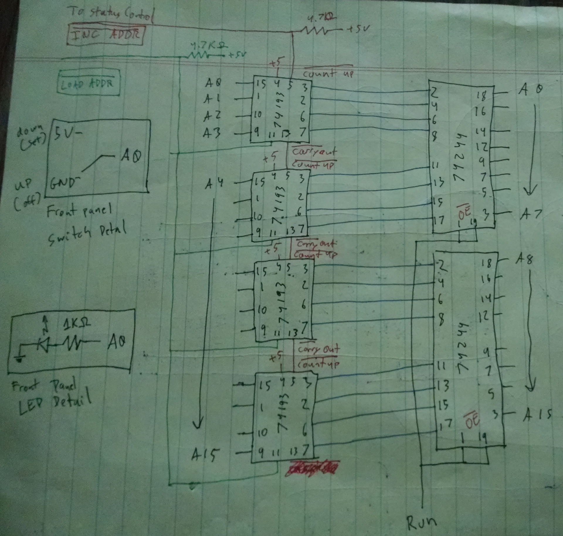

Address Control
Address Control
Address Control Card
This one is probably the most straight-forward card in the bunch. Want to hop to a specific address? Set the toggle switches, and load up that address. Then, you can increment from there to see what is in subsequent addresses. Again, this card has a run lockout to prevent interference when the CPU should be in control of the address bus. The LEDs here are always watching the address bus. Upon typing this, 8 months after assembling the card, I realize I should probably add buffers to prevent extending the address bus lines unnecessarily...

Here's a closeup of the bus itself.
I intend to do a hard-wired NOP test soon after adding those electrolytic capacitors, but I'm not entirely sure what I should be looking for other than the address bus jumping around.
