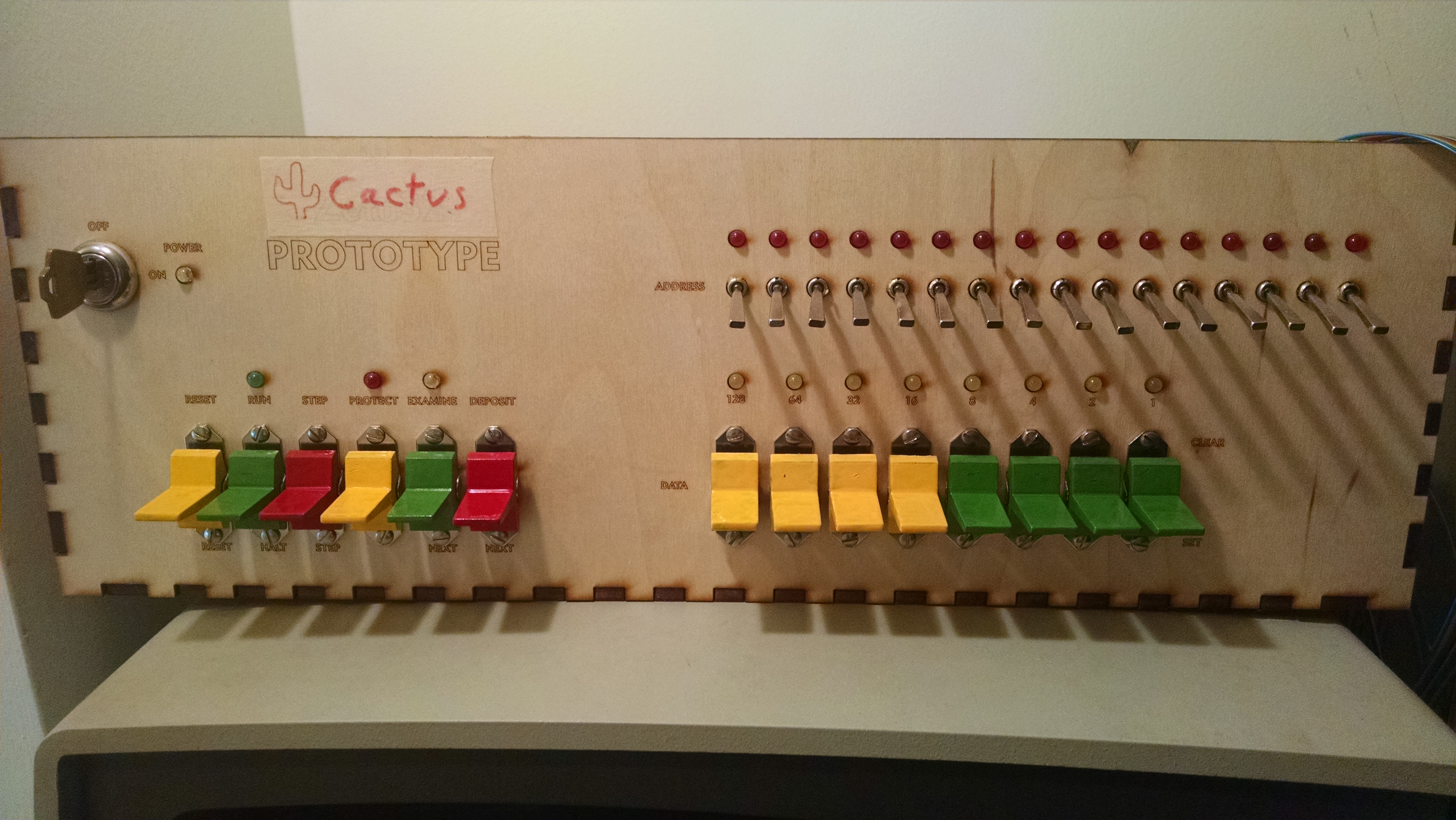

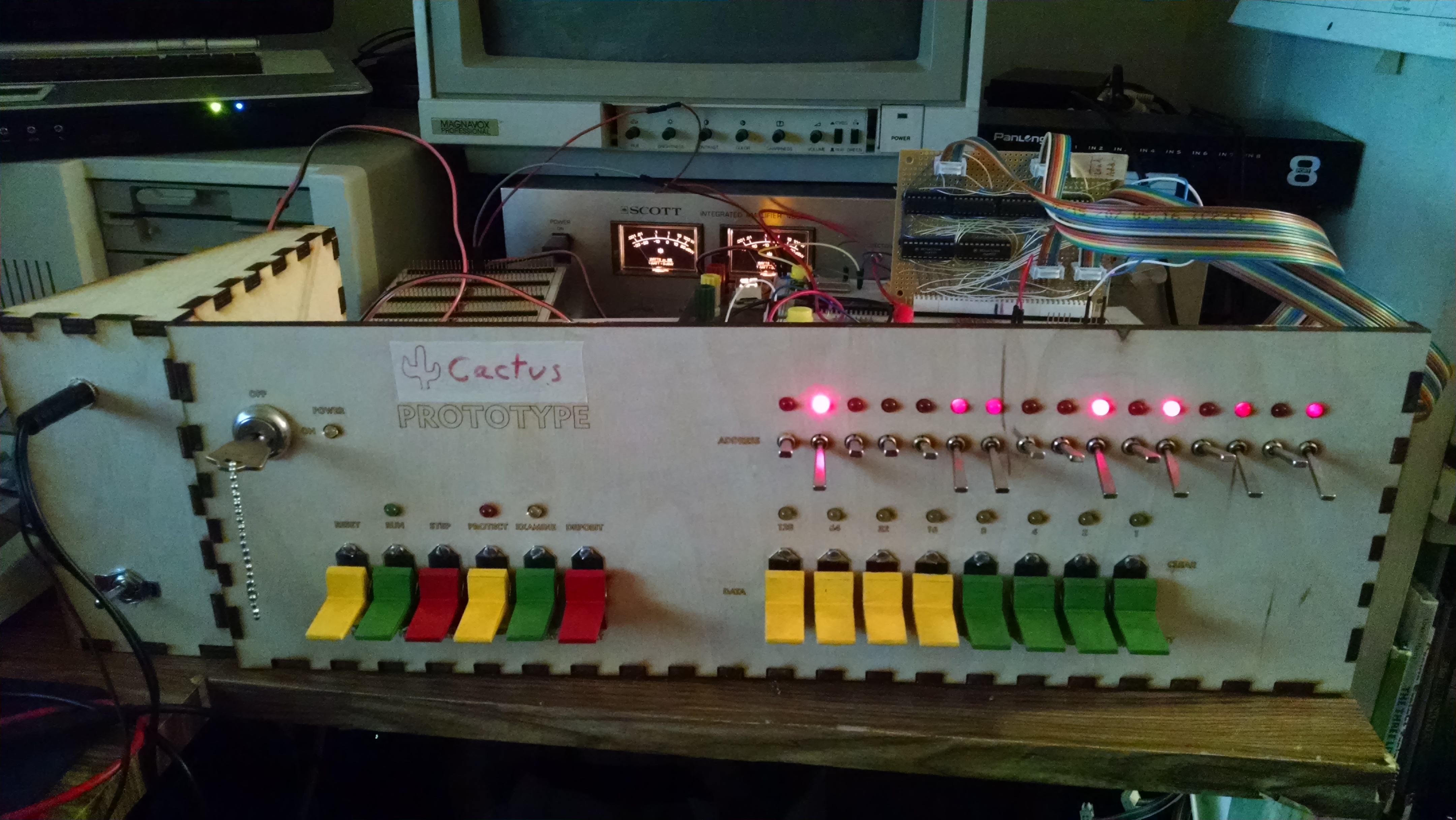

Greetings! I'm surprised I didn't visit this forum sooner. I'm not really sure where to start with all of this so here goes the short story of The Cactus.
File comment: Front panels are pretty
A few years ago, I saw an OSI-300 on display at VCF East. I had never seen a 6502 machine that was so spartan, and more importantly was using toggle switches and LEDs instead of a hex keypad/display, with a ROM to help you out. Other processors commonly had front panel interfaces, but why not 6502's?
I wanted an OSI-300, but I knew they were prohibitively rare. I briefly thought I could make my own, but the lack of a schematic and the awareness of my own ignorance made the task a bit too daunting. The good news was that within 6 months, a mini OSI-300 kit was available so I bought a pair. It was eye opening and fun, but the tiny switches made it tough for me to use for more than a few minutes. I figured I could make a few changes to it and improve the usability.
Some time later, I saw Grant Searle's low-chip count 6502 design with serial and BASIC aboard and wondered if the two concepts could be united, Altair 680 style.
That idea spiraled out of control. I started designing schematics for a complicated front panel interface that had features I figured would be nice. Things like:
  • Hopping to an address location, then incrementing with the press of a button.
  • Viewing, modifying, and re-entering bytes on the data bus, without having to re-enter the entire byte. Say you mistakenly entered 2C instead of 2D? Rather than clear the entire byte Kenbak-1 style, just change the bit that you messed up.
  • Set/Clear momentary switches, like an HP-1000 which I got to experience at VCF MW last year.
  • Observing the data and address buses while the CPU is running for maximum blinkenlights.
  • Features like Deposit, Deposit Next, Examine, and Examine Next.
  • Modular cards, to allow easy improvements.
  • Slow clock speed, right around 1MHz to allow use of older components.
  • Single stepping the CPU (the one thing I know is considered to be the most unlikely goal on a 6502)

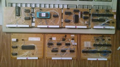

So for the last year, I've been hard at work designing and building my machine, piece by piece. My starting point was to separate Grant's design into individual cards and put them on a backplane. I breadboarded his design as a test article, then modified it slightly to match the baud rates I would be using. I upgraded to a modern WD65C02S for kicks (from an old NMOS Commodore made 6502), only to discover that the modern ones have a Bus Enable pin, and a static core which might make my single stepping dream come true.
File comment: The 7 cards I've built so far. Top row: 32K RAM, 16K EPROM, selectable baud rate serial card, address control card.
Bottom row: CPU card, status control card, data control card.

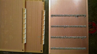

I constructed front panel interface cards, one at a time, resulting in 7 cards. 32K RAM, 16K EPROM, selectable baud rate serial card, address control card, CPU card, status control card, data control card. While the CPU is running, the front panel logic cards are supposed to sit quiet and observe the bus but not interfere. When the CPU is halted, they are to unlock and let you visit addresses, observe and modify data, and otherwise play... that's the idea anyway.

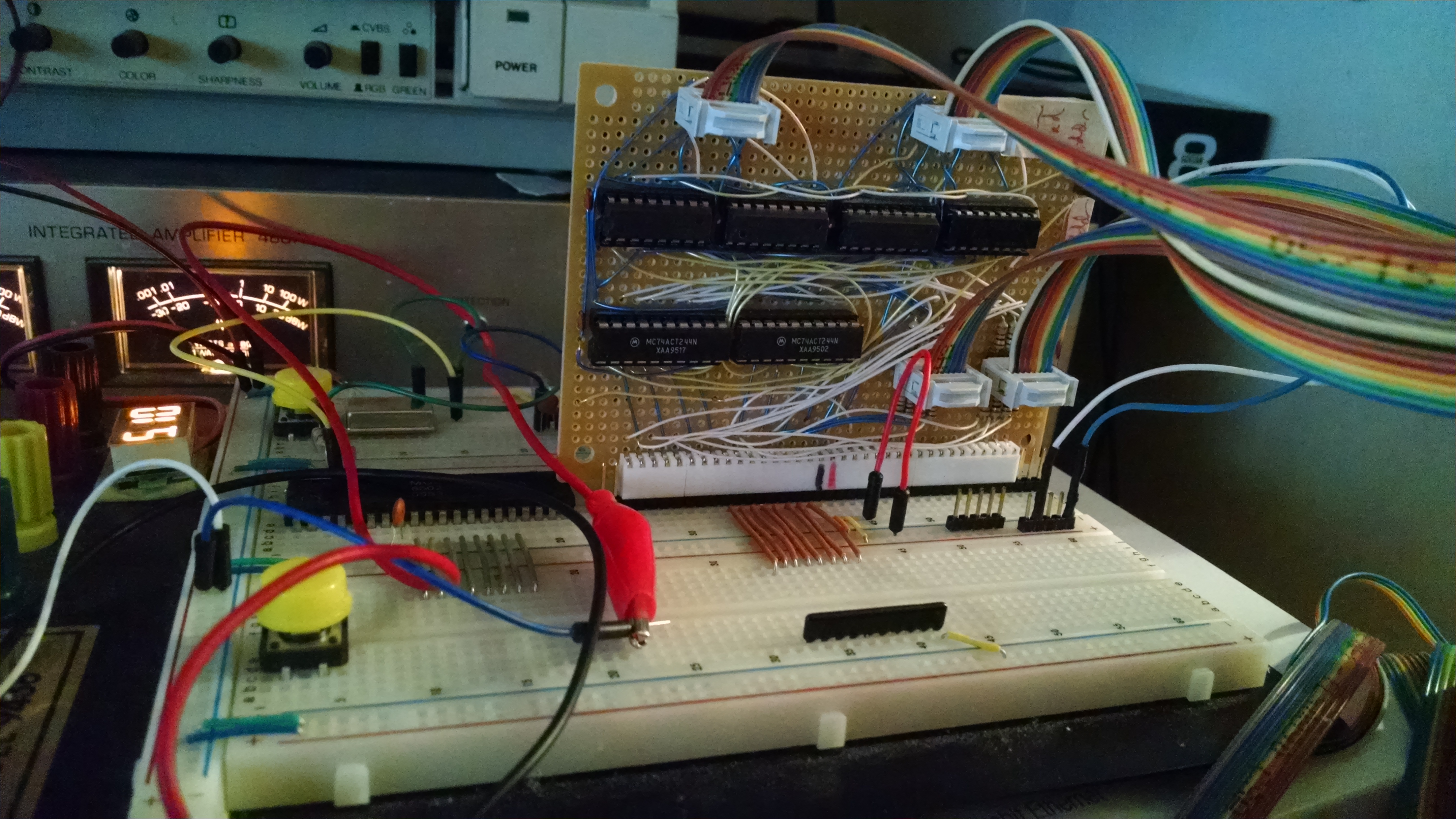

In practice it doesn't go that well. While testing the data control and address control cards individually, they seem to work fine. In integration testing, they fail to do their jobs, and produce phantom operations. The status control card is another story, that thing is riddled with problems, but it can be bypassed for the moment. Other tests have involved just the CPU, RAM, ROM, and serial, with all of the extra features disabled. For these tests, things like the single step is hard wired out, along with the more precise address decoding of the serial card. Effectively, it's supposed to be just the breadboarded Grant Searle design but on my backplane & cards. No dice. Every time, it looks like it gets just past checking the reset vector and then produces inconstant results on each test run.
I know there are aspects to the implementation and design process where my knowledge is lacking. I'm walking into a world where I have never tread before, and thus there is much to learn. I've discovered much but hit a bit of a road block. Right now, my current plan of attack is to observe most of the bus with a simple logic analyzer, and see where the hiccups are. I've also got a hunch that the bus signals are ringing, and thus possibly poorly terminated, but I don't have enough evidence to back that up or what I would do about it. I'm not really sure where to go from here. I'm glad to answer any questions about my flawed design, and hopefully I can get pointed in the right direction because I'm determined to move forward with the Cactus.

Welcome! I do like a front panel - and that's a nice build.

First thing to look at probably is the power supply: you'd normally have an electrolytic capacitor on each board, good connections between boards, and a decoupling capacitor near each chip's supplies.
If you haven't already tried to run a NOP test by tying off the databus, that might be a first step.
If you have a logic analyser with at least 10 inputs, even a cheap and cheerful one, then you can probably make use of hoglet's code which observes the databus and reads out what the CPU is doing on each cycle. He has a thread here

You left out the most important part -- WHERE DID YOU GET THOSE COOL PADDLE SWITCHES???
Yes, they are good aren't they? I always think the right switches really make a project.
Also, how are you interfacing the front panel to the CPU etc? I plan to have a front panel for my machines, but currently my plan is to cheat and have an AVR µcontroller handling it.

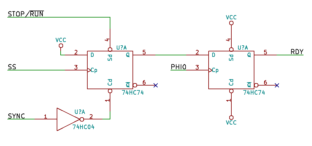

I studied a few approaches to single step logic for the 6502, from Woz's Apple I manual suggestion, to an old MOS document (couldn't tell you which one), until I found a post here from a few years ago from Thrashbarg. Just so happens that we both frequent another internet haunt. We discussed it, and I was offered a modern circuit which I have implemented on my CPU card. For the moment, my single-stepping system has been disabled, and a 1.2MHz clock is the only thing feeding the CPU -- one step at a time, yes?

Its high speed is likely what's keeping your circuit from working though. It's not just the clock rate that's important, but the slew rates that can get you into trouble with construction like you show with long connections. There's more about that in chapter 9 of the 6502 primer, at http://wilsonminesco.com/6502primer/construction.html .
Almost everything has a decoupling capacitor, however I have not included electrolytic capacitors on each board. I can try a hard-wired NOP test for sure.

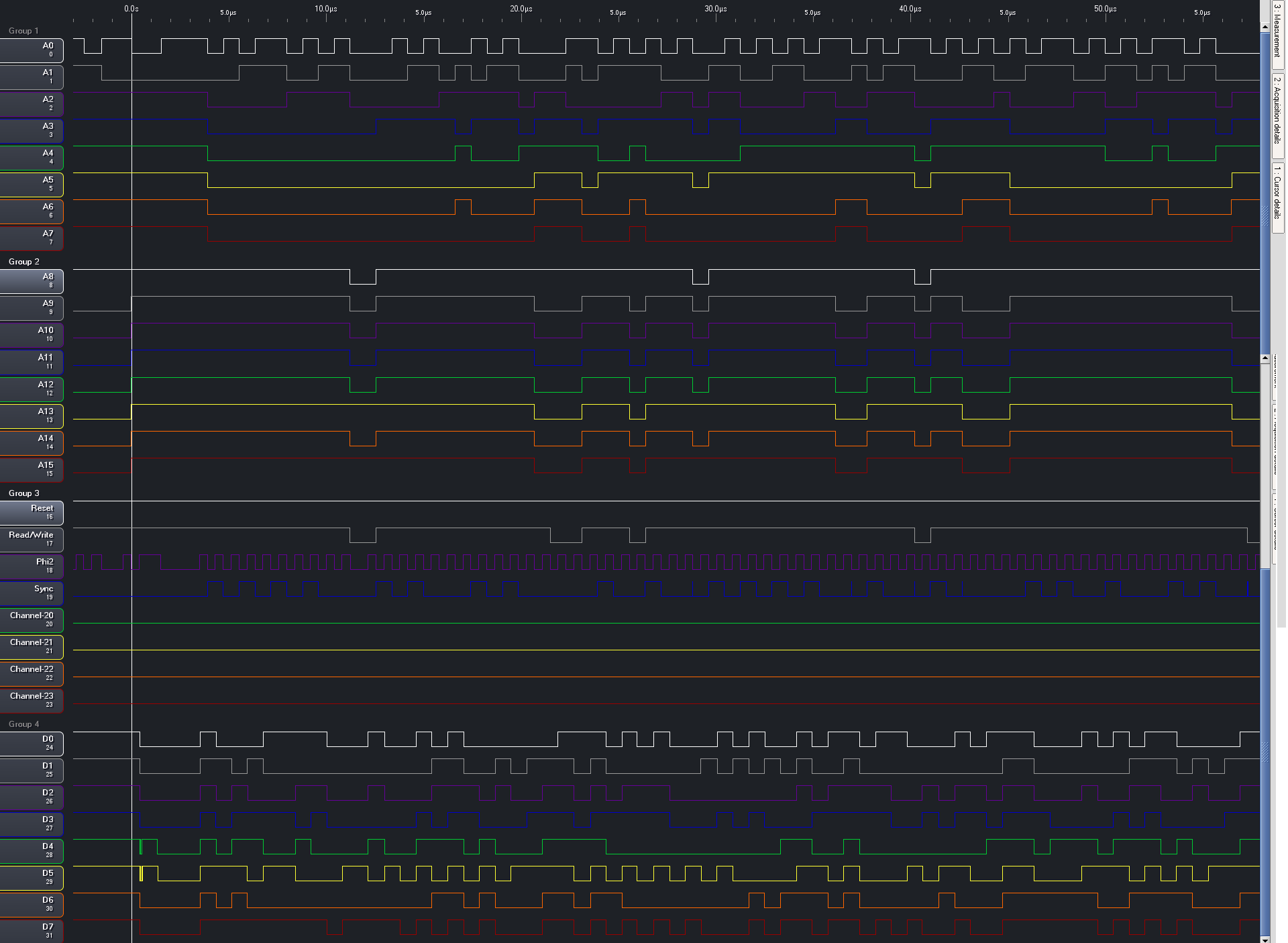

I certainly do, just got it last week. I have an OpenBench Logic Sniffer with 32 channels. Here's a test using it on my breadboarded test article.

speculatrix, I believe I'm following your project progress already through the wire. The Zolatron is cool.

The larger plastic paddle switches came from Electronic Goldmine some time ago, and I'm pretty sure I bought the last ones they had in that batch. They're C&K dual momentary switches, requiring latches to do anything of value within the context of the data bus or maintaining a status state. I wanted pretty colors, so I painted them a few months ago.

The singe-step circuit using RDY and SYNC (which you show) might tend to be more useful for debugging software because it stops once per instruction, whereas the single-cycle circuit would tend to be more useful for debugging hardware, as it lets you stop and look around for every cycle of every instruction, potentially finding things like address-decoding problems in your I/O for example. The former is because the SYNC output identifies only those cycles during which the microprocessor is fetching an op code, not operands.

I hadn't thought of using it for hardware debugging -- just for software debugging. It never crossed my mind that single stepping could be used for hardware diagnosis until you mentioned it.

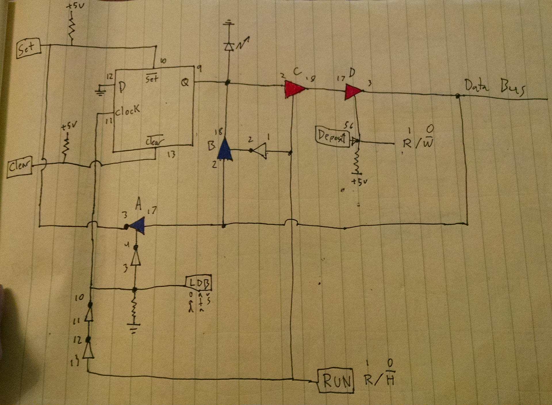

Data Control Card
Here we see the fundamental element of the data control card which is far more complicated than it needs to be. This has to be like revision 6 by now. There are effectively 8 of these, one per byte. Thus, there are 8 D-latches acting as RS flip-flops (7474's), and 8 of each tri-state buffer (3x 74244, 1x 74240). The inverters that control the buffers are not duplicated.
The idea is that we can load a value from the data bus into these D-latches. The load signal clears the flip-flop, and then lets any 1's populate their respective flop-flops. Say you made a mistake, and need to change a single bit, you use the set/clear momentary switches to make your changes. This will be visible on the LEDs, while not interfering with the data bus. When you are happy with the value, you can deposit it right back onto the data bus by twiddling the R/W line to make RAM overwrite the new value.
However, all of that is rendered dormant while the CPU is running. One buffer prevents this card from interfering with the data bus. while another buffer now allows the LEDs to directly view data bus activity. The flip-flops are cleared whenever the CPU is running.

I've managed to simplify the design a bit since this point for revision 8, but I'm holding off on building the improved version for the moment. Every time I think I've reduced the complexity on this card (while retaining the same functionality), someone consistently points out a new way for me to improve it (which I should note is more than welcome). Rev 8 doesn't reduce the chip count all that much, but it does reduce the total gates to 29, and eliminates quite a few wires, which makes me happy. I wish I had understood the 74245 sooner.

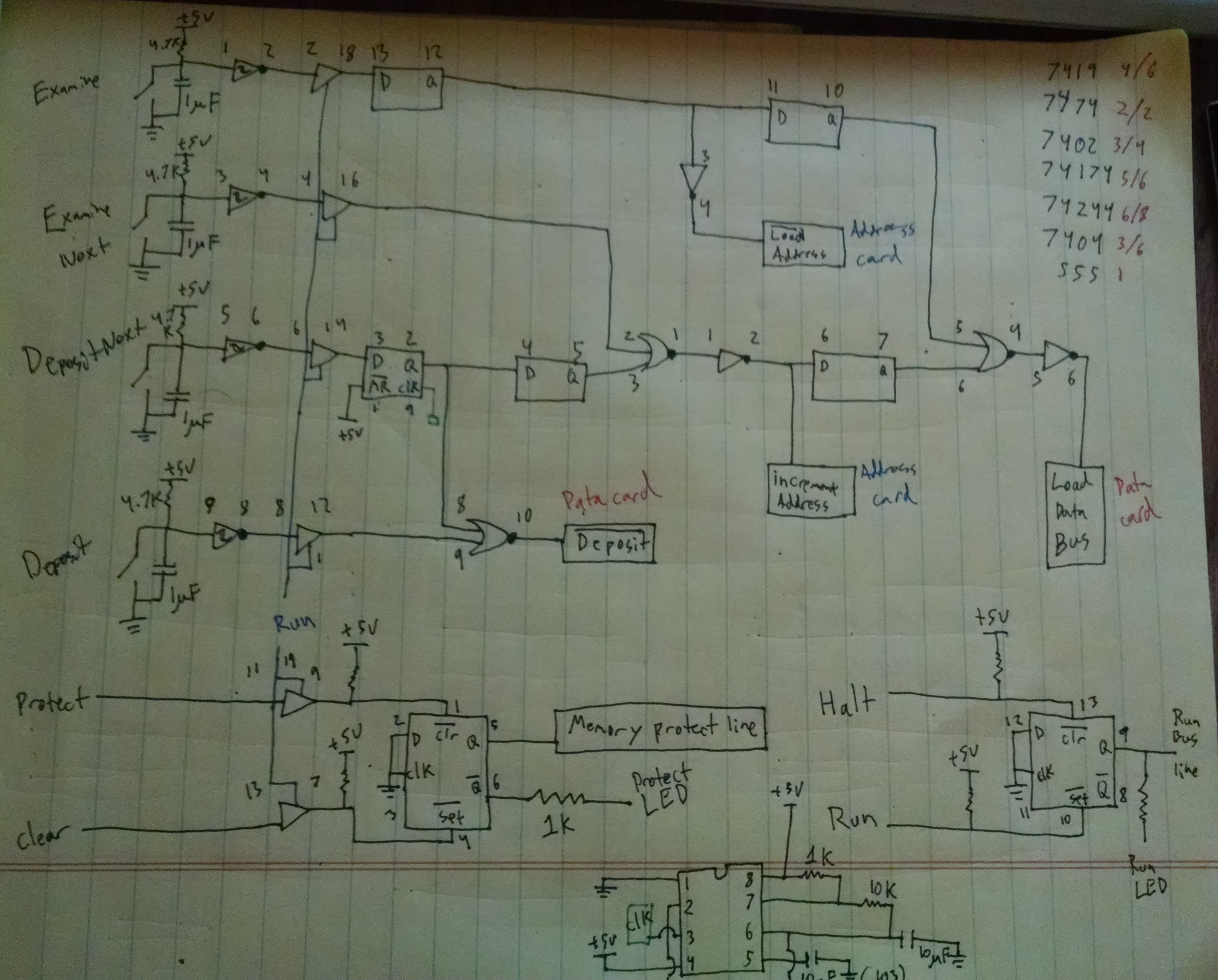

File comment: Status Control
Status Control Card
The status control card feels like a mess to me. It's been revised slightly since this schematic was laid down, but the fundamentals still apply, so for the moment it will do. The job of status control is to pass signals to the data and address cards, letting them know when to Deposit, load the data bus, load the address bus, and increment an address. It also controls weather the CPU is running or halted, as well as if memory is protected (not that this feature works right now). This card became a catch-all for the switches not specific to the data or address cards.
The Examine, Examine Next, Deposit, and Deposit Next momentary switches are all debounced using a simple RC circuit and inverting Schmitt triggers. I only have a cursory understanding of this circuit, as it was suggested to me a few months ago by a friend. Memory Protect, Protect Clear, Halt, and Run instead have toggles, and so I did not include debouncing circuitry. The Step momentary could do with a debounce circuit, but Reset has a DS1233 for the CPU to let it reset cleanly so I'm not worried about it right now.
The complex portion of handling status control is orchestrating the sequence of events needed for things like Examine, Examine Next, and Deposit Next to work right. The timing of these events is determined by a 555 timer and daisy chained D latches that are supposed to ripple down the chain in order. Now that I have a logic analyzer, I want to watch this process happen, step by step.
  • Examine tells the address card to load whatever address is on the toggle switches, then tells the data card to load whatever is on the data bus value into the front panel registers to be viewed on the LED indicators. [Load Address] -> [Load Data Bus]
  • Examine Next doesn't load from the toggle switches, but instead tells the address card to increment the counters on the address control card, followed by loading the data bus for viewing. [Increment Address] -> [Load Data Bus]
  • Deposit Next is the most complicated one. First, the data value on the front panel is written to the data bus, then the address is incremented, then the data bus value at this new address is loaded into the front panel's registers. [Deposit] -> [Increment Address] -> [Load Data Bus]
  • Deposit is simple, and doesn't abide by the sequencing, allowing you to directly write a value from the front panel into RAM.
My understanding is that I'm performing Deposit Next backwards compared to an Altair 8800. Whereas the 8800 deposits that value into the location after the one you are currently viewing, mine deposits it into the current address you're viewing, then increments the address to show the value in there. This way if you're re-entering in data and don't wish to overwrite the value at that address, you can press Examine Next instead, and move on. Made a mistake, but only want to change a bit or two of that value, rather than all 8? You can do that too.
I hope I'm explaining this well enough. Feel free to ask whatever questions come to mind.

Thanks for sharing all that. I wasn't familiar with the 74xx193 - which is exactly what I've been looking for. I'm probably going to do a different set of switches, maybe a bit simpler. I just want blinkenlights and play value. I started off looking at the Altair (I have the Altair-Duino kit) and the PDP-8 (yup, I have the PiDP kit) and I think my solution will end up somewhere between the two.
It had also occurred to be to try to implement some kind of general-purpose front panel that could be used as a control surface for a number of projects.
I'll be studying your schematics carefully!

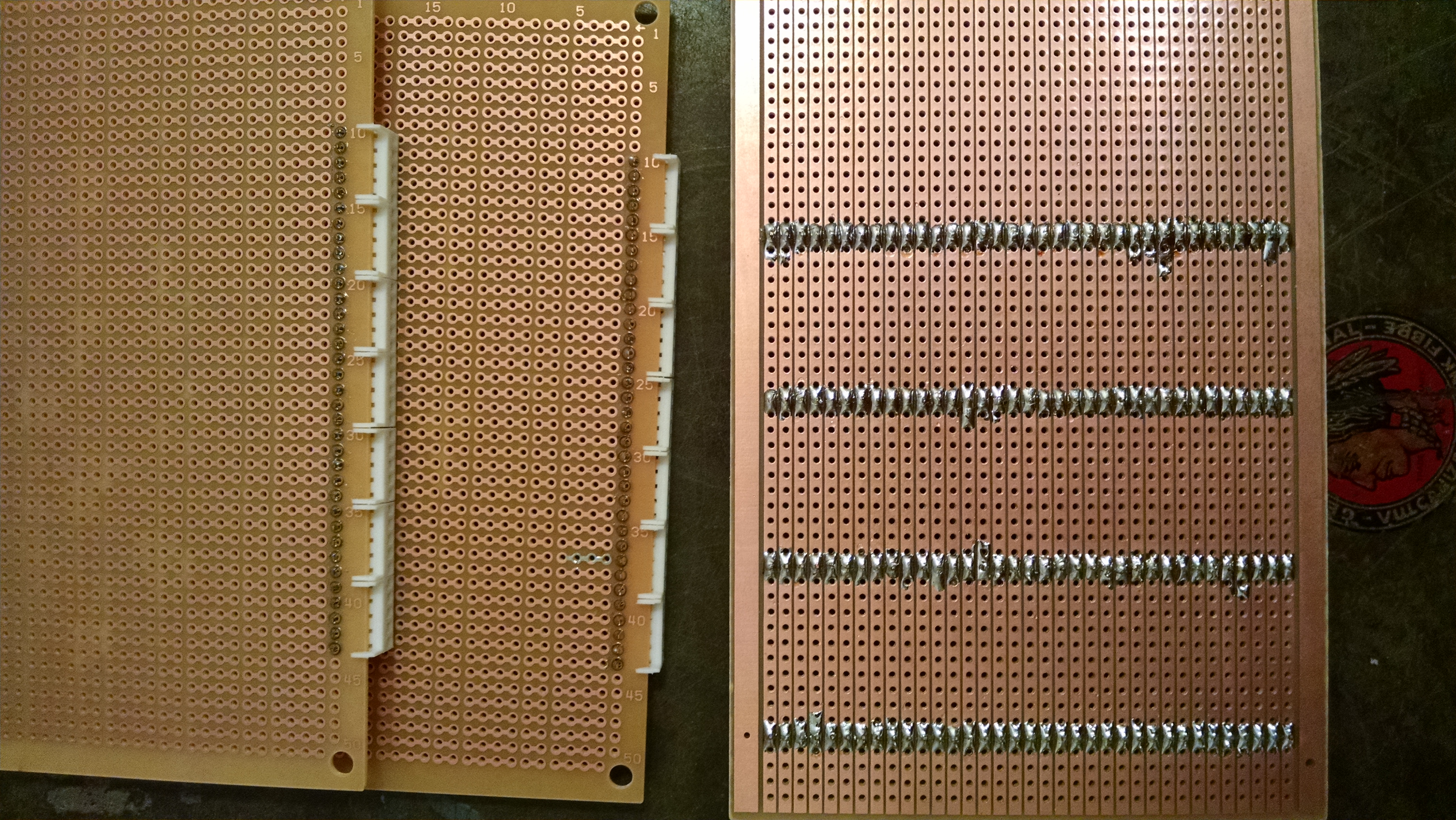

It took awhile to select the 74193 as the right sort of 4-bit binary counter. There are quite a few options, but this one had the features I needed for cascading together and loading a value. My schematics are admittedly dubious. Until I have something 100% working, I wouldn't trust my work as any sort of guideline.
Right now I'm selecting matching electrolytic capacitors to sit on each card's power rail to hopefully combat power dips. I'm thinking 47μF caps right now.
Here's a closeup of the bus itself.
I intend to do a hard-wired NOP test soon after adding those electrolytic capacitors, but I'm not entirely sure what I should be looking for other than the address bus jumping around.

If a computer doesn't work, there are a myriad of things which might be wrong, so the point of experiment is to try to narrow down what needs fixing.
For a NOP test to work, you need a working CPU, a good power supply and clock, and the various CPU lines tied off in the right way. If you can observe the address bus closely you can rule out shorts, opens, or unwanted reorderings. To a small degree you've also shown the data bus is OK. If you do the NOP tie off a long way from the CPU, you might be showing something about your motherboard or backplane too. As there are various values which can serve as a NOP test you can take it a little further, showing the databus is working as intended.
After the NOP test you might put a tight loop into a ROM and try running that, to show that the ROM is correctly wired up, correctly accessed and correctly programmed.
Then you can run something with JSR and RTS and show that RAM is working.
And so on.
