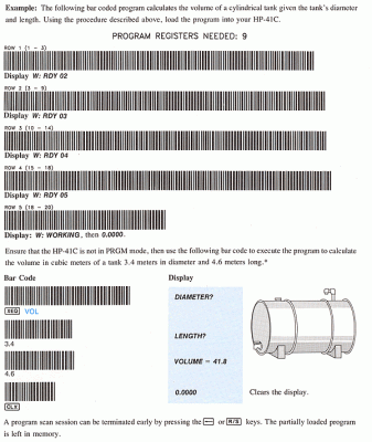

Making a manual bar-code wand could get around the need for timing if you go for a pair of photodiodes and run it over a pair of rows of black & white squares, if you make one to be for the clock and one for data, and have them go to a 74HC595 shift register.  The pushbutton on the wand which you press at the beginning of each line would clear the shift register.  The address counter gets initialized upon power-up.  Each 8-bit byte on the paper is preceded by a '1' bit which, when shifted all the way through the shift register with 9 clock pulses, tells the logic to write the shift register's parallel output to the next RAM location and increment the address counter.  This video shows a bar-code wand in use.  I'l try to find one of using such a wand to enter a program and come back and edit this.
[Edit:]  No videos, but here's a picture of a program to enter by bar code on the HP-41 calculator, added almost simultaneously with Mike's below:
(Regarding the nine program registers it says it needs, those are seven bytes each, so 63 bytes.)
Before the internet existed, user groups had magazines and newsletters, plus meetings where they actually got together (gasp!).  A nice thing about bar code was that you could distribute programs with nothing more than a photocopier, and it was much faster for the recipients to scan the bar code than to manually enter the program.
Now again envision having pairs of rows of squares to run your home-made barcode wand over to enter a bootstrap loader program with no ROM, the top row for clock and the bottom for data, perhaps done manually on quadrille paper, with each bit made much wider than what you see above.  Since it's synchronous serial, it would not matter how fast or slow you run the wand over each line, or whether you keep a consistent speed or not.  You should comfortably get about 50 bytes per 8½x11" page, in landscape orientation, ten lines of five bytes each.
