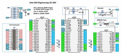

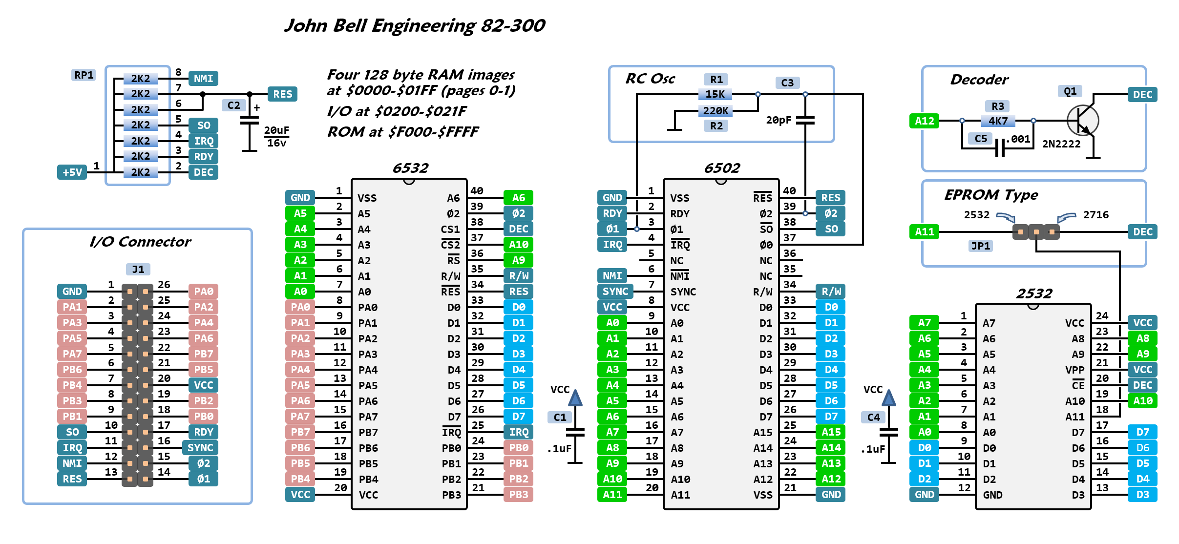

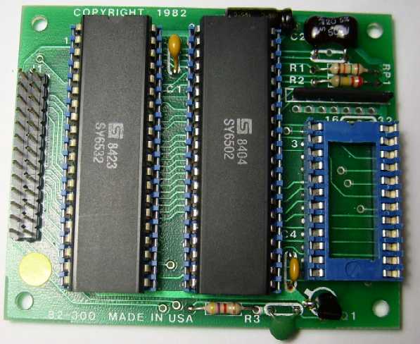

I'm fascinated by the little 3-chip(+) designs of the late 70's and early 80's that used a 6532 for 128 bytes of RAM plus I/O (like the Beta, CEPAC-6502, and EMUF-6504).
Last year I read about the John Bell Engineering "82-300" board which is the simplest design with a 6532 chip that I've seen so far. It uses an RC oscillator and the active components are a 6502, a 6532, a 2716 (2K) or 2532 (4K) EPROM, and a transistor. I haven't found a Manual yet but someone was kind enough to send me a copy of the hand drawn schematic that accompanied the 82-300 board kit. I've attached my interpretation of that schematic for anyone who may be interested.

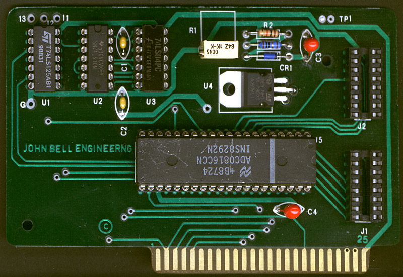

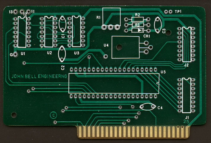

I just found this web site after searching for years. With this picture it was easy for me to buy the missing chip and heat the solder iron:
Look at the letters written on the original board and the Taiwan board! Funny taiwanese people
Regards, Ralf

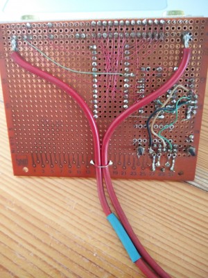

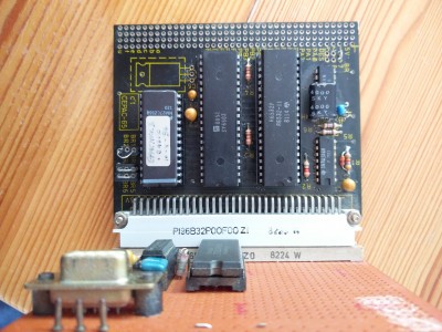

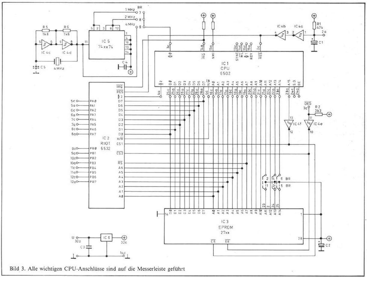

Hi Michael,
this is the CEPAC-6502 you mentioned. I call this thing SYMilar as it consist of a NMOS 6502, 6532, RAM, and ROM (but no 6522s) similar to the SYM-1.
It uses bit banging for serial I/O (like the SYM). And the monitor program is very similar to the SUPERMON. I added the RAM and the TTL<=>RS232 converter and used a 74LS138 (with 3 diodes forming an AND gate!!) to override the memory map. Now there is 24K (3x 8K) RAM, then 8K I/O (= 32x the 6532), and 32K ROM (last burned April 1996). The RAM, decoder, and RS232-level translator are built on a perfboard. There I used a wire pencil to connect the RAM to the VG-connector. This sort of wire is very thin and coated with a tough isolation that only melts away when soldered. This is a quick and dirty way of building a circuit and a very nasty one if you need to change something
In that time I managed to disassemble SYM-Basic V1.1 so far that I could transfer it to this board. Currently it is heavily computing prime gaps
Once I found the article to this board once published in the German monthly c't somewhere (bitsavers?) but I saved a PDF (sorry only German). Cheers.
edit(1):
+ There is a bug in the schematic around the 74xx74 dual-FFs. Michael post below shows the corrected version!
+ I used a 74LS139 (not 138 as stated above) to generate a /CS (via 3 diodes wired AND) with one half LS139 and a qualified /WE with the other half.

Very nice CEPAC-6502 expansion.
Please note there was an errata published in a later c't issue about an error in the schematic around the 74xx74 in the clock circuit. I edited the schematic to include the correction (below).

Re: John Bell 6502 "82-300" Board Info'
Thank you, Mike!
I edited my post to point to the corrected schematic.

- I bought a number of boards from John Bell including the 82-300. The first ones came with a hand drawn schematic and later ones came with a dot matrix printed schematic. I have attached a scan of both drawings I received with the 82-300 boards.
John Bell part numbering system was Year Designed-Day Number of Year, so 82-300 was the 300th day of 1982. They did not have a manual that I a aware of, they just delivered with a schematic. The product was listed in his 1984 catalog as "TCM Module."
