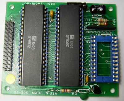

I'm fascinated by the little 3-chip(+) designs of the late 70's and early 80's that used a 6532 for 128 bytes of RAM plus I/O (like the Beta, CEPAC-6502, and EMUF-6504).
Last year I read about the John Bell Engineering "82-300" board which is the simplest design with a 6532 chip that I've seen so far. It uses an RC oscillator and the active components are a 6502, a 6532, a 2716 (2K) or 2532 (4K) EPROM, and a transistor. I haven't found a Manual yet but someone was kind enough to send me a copy of the hand drawn schematic that accompanied the 82-300 board kit. I've attached my interpretation of that schematic for anyone who may be interested.
Cheerful regards, Mike, K8LH

It's hard to find anything about the boards from John Bell Engineering. Some months ago I was looking for anything concerning to the AD converter. I remembered my board which I bought in 1990 from a dealer in Karlsruhe, West-Germany, who sold empty boards from Taiwan:
I just found this web site after searching for years. With this picture it was easy for me to buy the missing chip and heat the solder iron:
Look at the letters written on the original board and the Taiwan board! Funny taiwanese people :-)
Regards, Ralf

File comment: I bought a number of boards from John Bell including the 82-300. The first ones came with a hand drawn schematic and later ones came with a dot matrix printed schematic. I have attached a scan of both drawings I received with the 82-300 boards.
John Bell part numbering system was Year Designed-Day Number of Year, so 82-300 was the 300th day of 1982. They did not have a manual that I a aware of, they just delivered with a schematic. The product was listed in his 1984 catalog as "TCM Module."
I bought a couple of fully assembled boards and many bare boards which I populated. I designed a product for a local industrial company using this micro board and two more custom boards. A display board, an A/D and D/A and digital I/O board which I designed and made-up my system. I built many units and still have all the prototype development hand made units.
