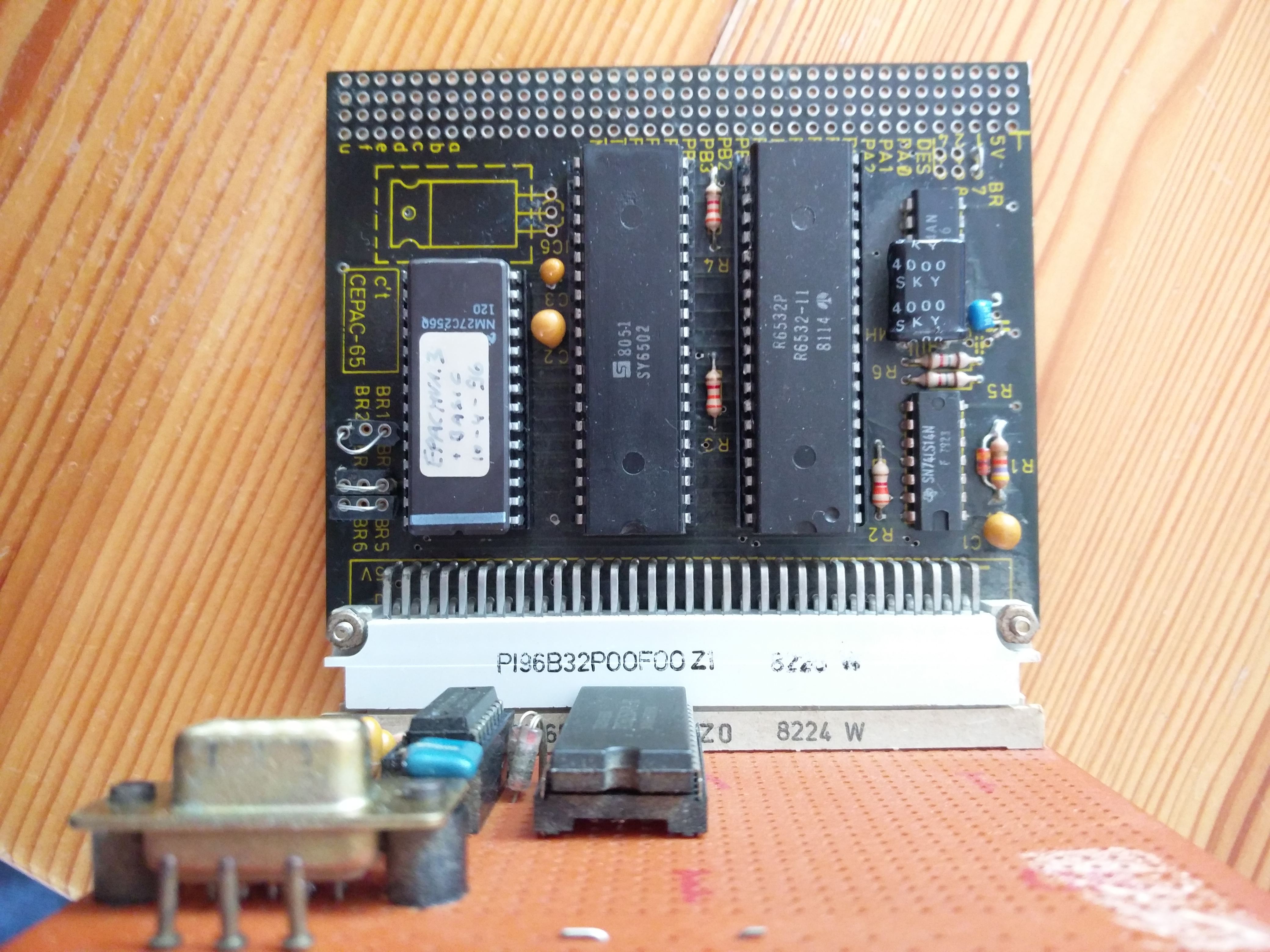

this is the CEPAC-6502 you mentioned. I call this thing SYMilar as it consist of a NMOS 6502, 6532, RAM, and ROM (but no 6522s) similar to the SYM-1.
It uses bit banging for serial I/O (like the SYM). And the monitor program is very similar to the SUPERMON.
I added the RAM and the TTL<=>RS232 converter and used a 74LS138 (with 3 diodes forming an AND gate!!) to override the memory map. Now there is 24K (3x 8K) RAM, then 8K I/O (= 32x the 6532), and 32K ROM (last burned April 1996). The RAM, decoder, and RS232-level translator are built on a perfboard.

Very nice CEPAC-6502 expansion.
Please note there was an errata published in a later c't issue about an error in the schematic around the 74xx74 in the clock circuit. I edited the schematic to include the correction (below).
