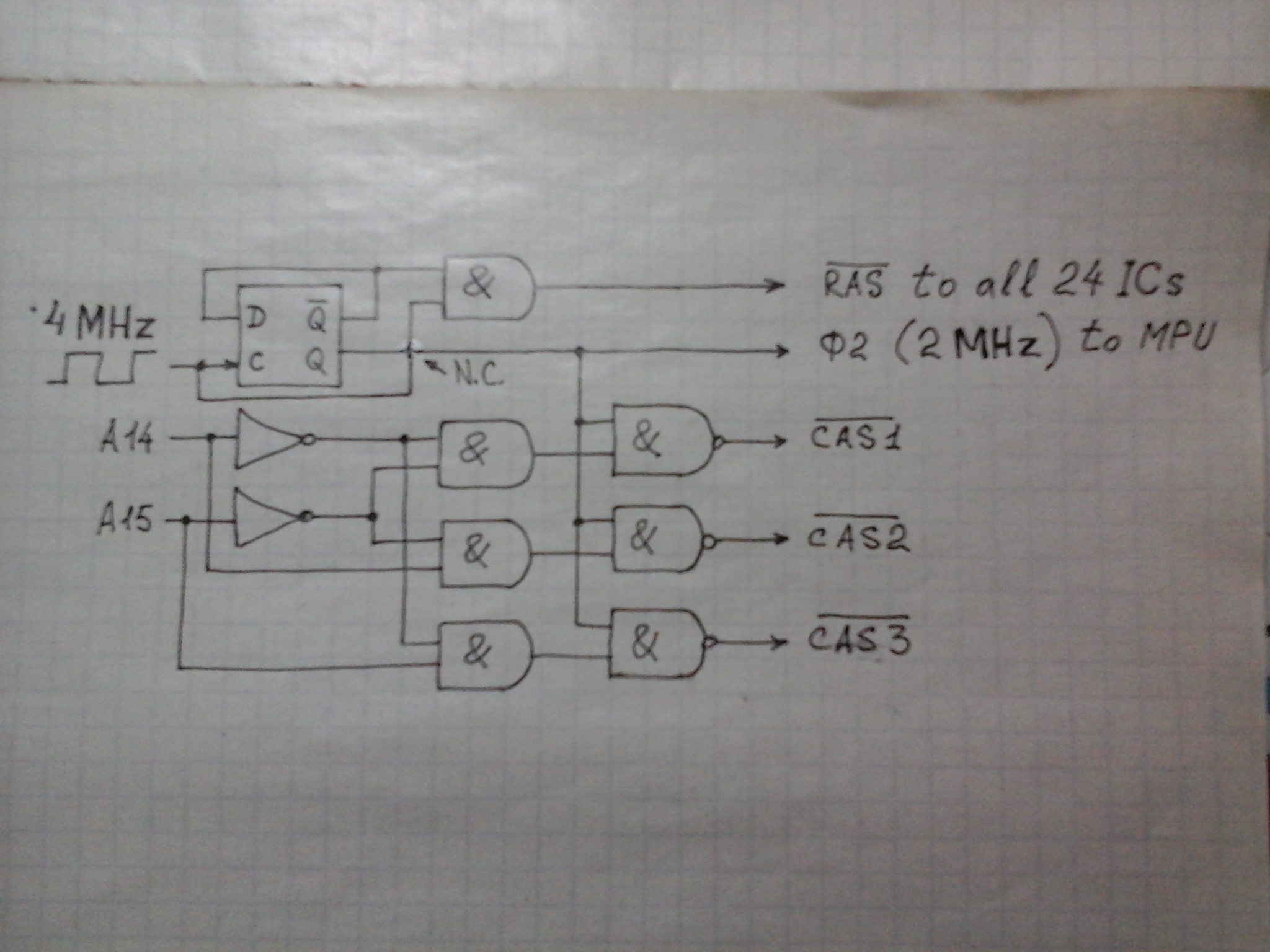

May be this should control DRAM...? Multiplexers (not pictured) should be switched by /RAS. R/W signal from MPU is connected direct to /W of all DRAMs. Address decoder included :wink:
EDIT: It seems, falling edge of /CAS comes too early, I will correct.

Nice. I haven't checked actual DRAM timing spec's, but the circuit looks like it should work.
It might be slightly smaller and easier to build if three-input NANDs (such as 74_10) were used to drive the CAS\ lines.
May be so is better?
The two-stage frequency division is needed to obtain a 62.5 nS delay between the rising edge of Ф2 and falling one of /CAS to wait until MPU put data on the data bus during the writing cycle. I did not want to deal with RC Charging Circuits to achieve the delay.
Everybody may check the circuit diagram for mistakes, I will try to fix.

It looks like I need now is multiplexing(?) the A0-A15 signals into the Column/Row
A0÷A13 only. Address decoder copes with A14 and A15. Don't worry about /WE. There is no need to enable/disable this signal (assuming MPU only drives this line).
The multiplexing is a simple thing. All you need is multiplexers. As switching signal you can try to use /RAS or Ф2 ( in correct polarity).
