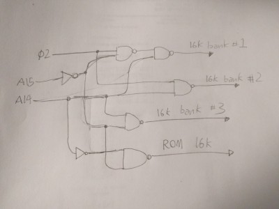

DRAM is mostly for the sport, and also because had a supply of it off-hand.
I saw the 32 K RAM/16 K ROM circuit earlier on your site, and it looked like the closest to what I need. That circuit gets everything divided into 3 sections, but I need some more comparisons to occur. Would this circuit work for 4 16k banks? It uses 5 NAND gates and two inverters. It may be completely wrong.

It has several problems. But first, how fast are your DRAMs, and how fast do you hope to run the computer? (I ask because it affects what types and how many levels of cascaded logic you can have. The thinner the timing margins, the harder it will be to meet them with fine-grained address decoding like having only 32 bytes for I/O.)
Welcome, pw132 -- nice to have you with us! :) It's clear you're off to a good start, and are getting a grasp of some of the basics. Your circuit still needs some work, though. For example, the NAND at the bottom (which drives the ROM) won't activate the ROM except when A15 and A14 are both low. But the only time A15 and A14 are both low is when the region 0 - $3FFF is addressed, and that's not what you wanted. One other detail I noticed is that you have the Φ2 signal connected as part of the circuit for bank #1 and #2, but not for #3 or the ROM. Is Φ2 needed at all in this part? Part of the reason I'm puzzled is because you haven't shown what the NAND's conect to. The DRAM's you're using have /RAS and /CAS inputs, both of which must be driven -- and with a defined timing sequence -- or else the DRAM won't respond.
There's also the issue of multiplexing. Have you planned what arrangement you'll use for that? (The C64 probably uses a pair of 74_257's, but I haven't checked.) And what do you propose in regard to a refresh scheme?
As Garth already mentioned, SRAM is far easier to use. Also, his web site provides lots of info and advice regarding SRAM. It's okay if you want to use DRAM's, but they are more complicated and also it will be somewhat harder to get info and advice.

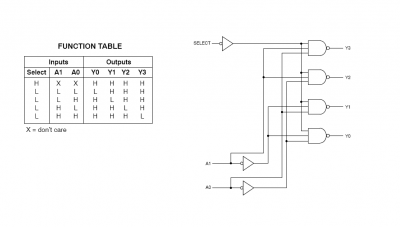

PostPosted: Sat Nov 12, 2016 4:44 am
pw132 wrote:
The first step in my mind was to get the 4-way split working.
The circuit below shows what a '139 contains, and the Function Table shows how it behaves. Note that the Select input and all the outputs are active low. IOW when low they are said to be asserted, or true. When high they are deasserted AKA false.
The Select input is pretty simple. Select must be true (L) or else none of the outputs can be true (L).
A1 and A0 are what control the 4-way split. It's important to notice that every NAND inputs either A1 or its complement, and every NAND inputs either A0 or its complement. Things are connected such that each NAND responds to one and only one of the four possible combinations of A1 and A0.
