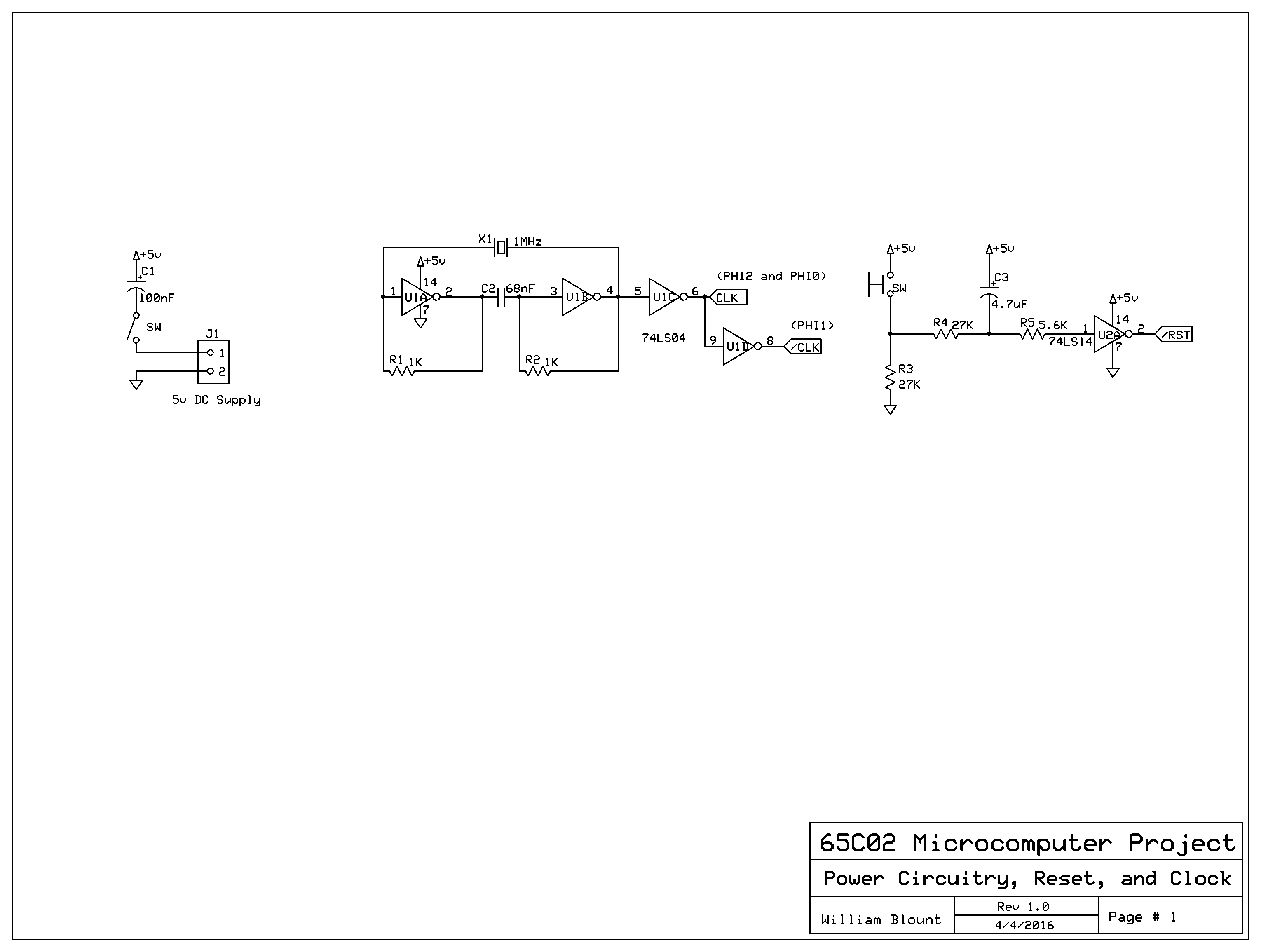

Which finally brings me to what little part of my schematic I have started on:
Any comments questions and such on any part of my design / design process would be much appreciated (I am mostly concerned about my schematic thus far).

Yes, bypass capacitors go as close as possible to the ICs' power & ground pins, with leads as short as possible. Monolithic ceramic ones work well.
SMT ICs with .050" lead spacing are pretty easy to solder with a little practice. You don't need a tiny tip on the iron either. DIPs are always easiest of course though.
Don't use 74LS. The reset circuit in particular won't work with it, because the series resistors cannot pull the inputs down anywhere near hard enough to qualify for a logic "0". Use CMOS, like 74HC or 74AC.
I don't plan on doing so, I was trying out ExpressPCB and only 74LS was available in the part library. I have since switched to DipTrace and am using the 74HC04 and 74HC14.

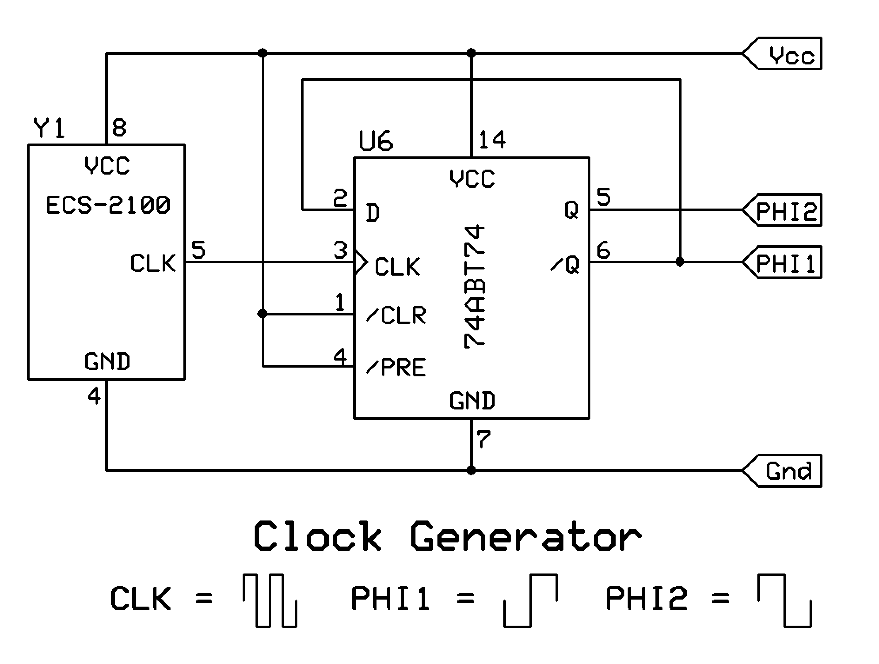

A note concerning clock oscillators for future reference. You need not concern yourself right now with this information, but may eventually find it useful.
In theory, a clock oscillator's output has an exact 50 percent duty cycle. In practice, most oscillators will be anywhere from 45 percent to 55 percent. At low Ø2 clock rates such output asymmetry can usually be safely ignored. As you push the Ø2 clock rate ever closer to the maximum rating of the clocked device, output asymmetry has the potential to violate device timing and may lead to mystery problems. Jeff Laughton (Dr. Jefyll) has a lucid discussion on timing at his website, which among other things, shows what can happen when clock asymmetry inadvertently bumps against device specs.
When I designed my POC unit I decided to run the clock oscillator's output through a flip-flop to eliminate asymmetry as a possible problem causer. Here's the circuit I used:
Ø2 Clock Generator
Ø2 Clock Generator
Due to the way in which flops work, the outputs at PHI1 and PHI2 have an exact symmetry, and are also exactly 180 degrees out of phase with each other. Also, the flop's output transition time is extremely short, producing a very sharp signal, and drive is strong. The frequency at PHI1 and PHI2 will be one half that of the oscillator.
As I said, this is not important right now, but will become so when you finally get to where you want to run the 65C02 at full speed (officially 14 MHz).

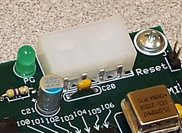

Furthermore, I place a 0.1µF MLCC as physically close as possible to the input bulk electrolytic (I generally use 100µF there, as I've got a bunch of them). Electrolytics often have poor high frequency performance and hence may not do an adequate job of bypassing high frequency noise to ground. The MLCC handles that for the electrolytic. The below image shows how I did this on POC V1.1:
POC V1.1 Power Input
The bulk electrolytic is C21 and the MLCC is C20. My concern was that switching noise not get out on the power supply connections, hence the tight positioning of C20 with respect to the power input connector.

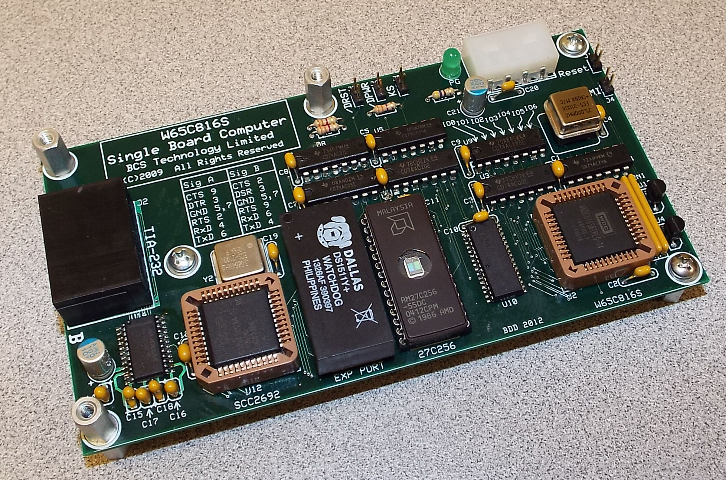

Each chip on the board has an MLCC bypass, as seen in the below image.
POC V1.1, Showing Bypass Caps
Here again, the MLCCs are placed as physically close as possible to the end of the device at which the VCC connection is present—you want the connection between the MLCC and the VCC pin to be as short as possible. Note that the clock oscillators are also bypassed—they can be a fertile source of noise.
It's best to think of bypass capacitors as like money: more is good! :D

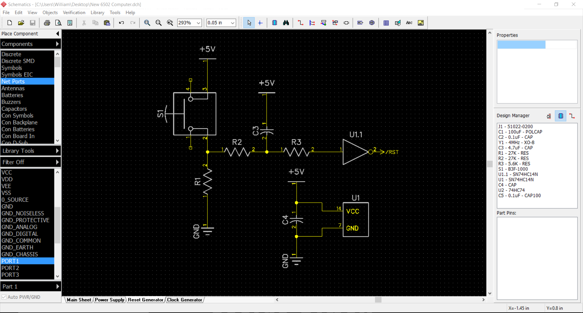

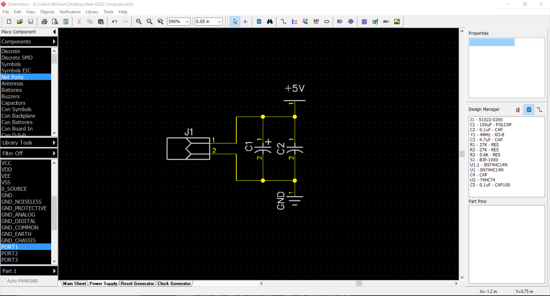

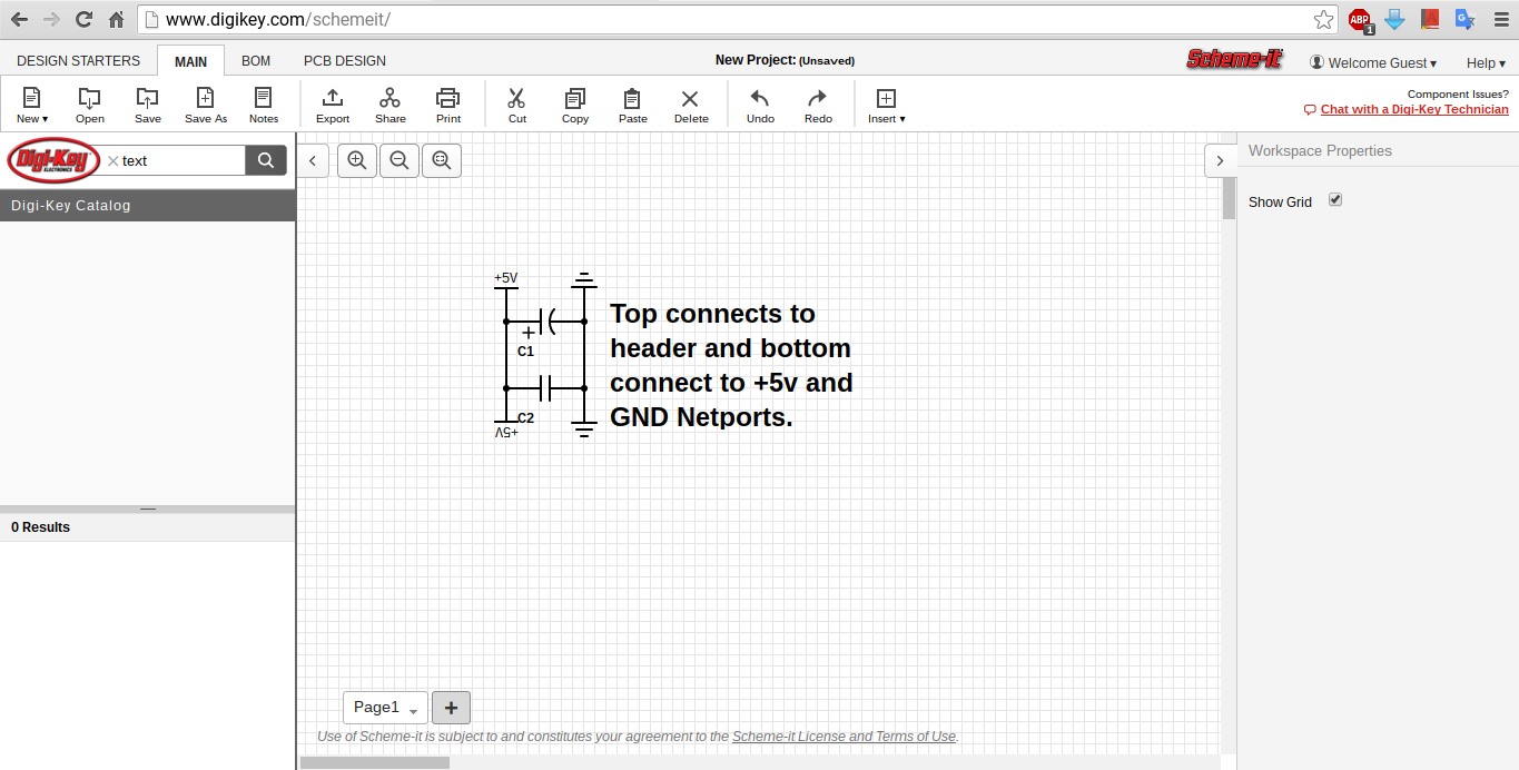

I am going to add the electrolytic and MLCC to my power supply schematic. Is the following schematic correct?
- Billy
Re: Finally starting the schematic for my first W65C02 SBC
Yes, that's good. Make the monolithic ceramic capacitor's leads as short as you can, since they have inductance.

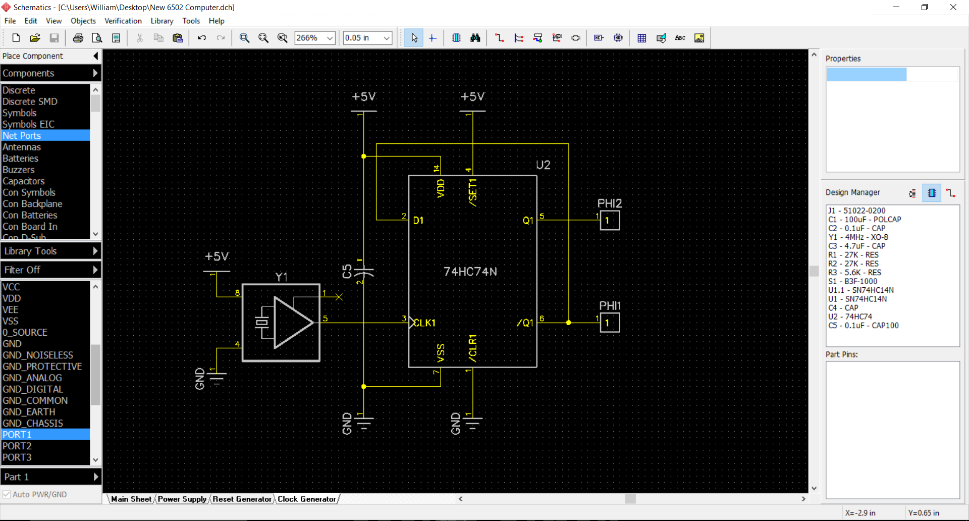

I have finally settled on DipTrace as my schematic editor and have reworked the power supply, clock generator, and reset generator.
New power supply (now with bulk and bypass caps):
New reset generator (no massive change other than the bypass cap on the 74HC14):
New clock generator (changed to 4MHz with flip flop down to 2MHz):
The next part will take me a while as I need to make schematics for almost all the other parts in my build.
- Billy
Posts: 9425
A couple of notes.
  1. The Maxim DS-1813 reset generator is a one-part solution to controlling /RESET. It is in a TO-92 package, so it has a real small footprint, and it requires no other parts other than a reset circuit pullup resistor to be functional. The DS-1813 automagically cycles /RESET low and then high when power is applied, plus repeats the cycle if something (e.g., a push button) pulls /RESET low.
    reset_controller_ds1813.pdf
    Maxim DS-1813 Reset Generator
    (206.15 KiB) Downloaded 166 times
  2. Both /CLR and /PRE (aka /SET) on a 74x74 flip-flop must be pulled high in order for Q and /Q to follow changes at CLK and D.
  3. The flop should be a 74AC74 or 74ABT74, not the 74HC74. The 74HC74's output transition time may not meet the 5ns maximum input transition time spec of the W65C02S (the tF and tR specs—refer to pages 25 and 26 in the data sheet). Despite the name ("HC" meaning "high speed CMOS"), 74HC devices are usually no faster than equivalent 74LS devices.
